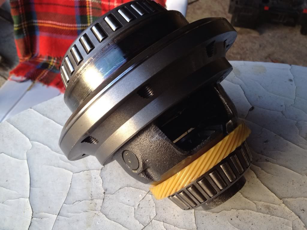

as above? Is this viscous limited slip differential? is it even possible to make it fit in normal UKDM gearbox? thanks
Matt Humphris seems to get LSDs to fit, i think he machines down the inside of the gearbox
Matt uses a specific LSD from Gripper for the RS5F30A and 41A gearboxes, no machining needed.

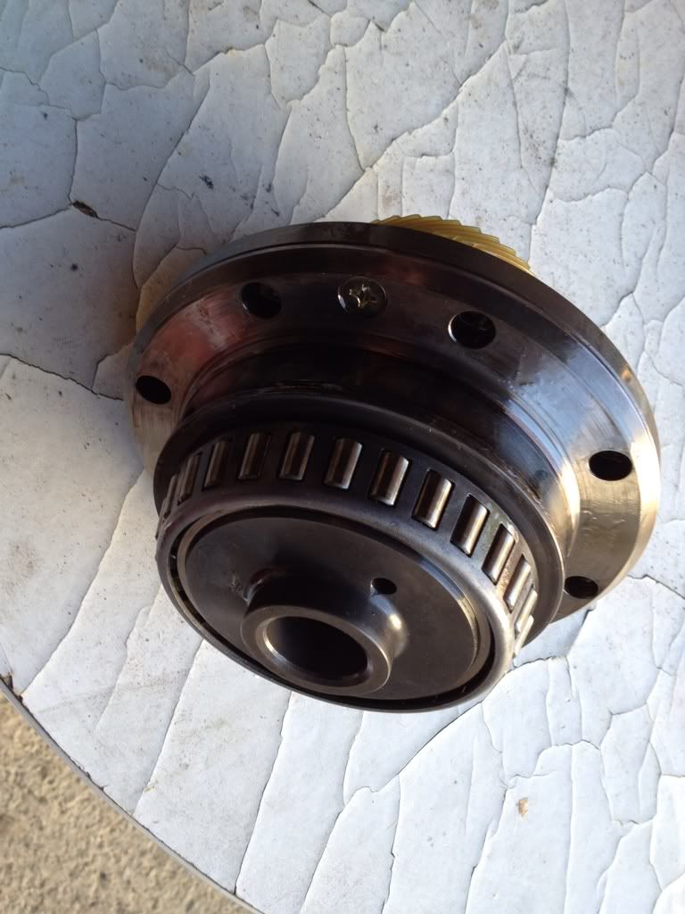

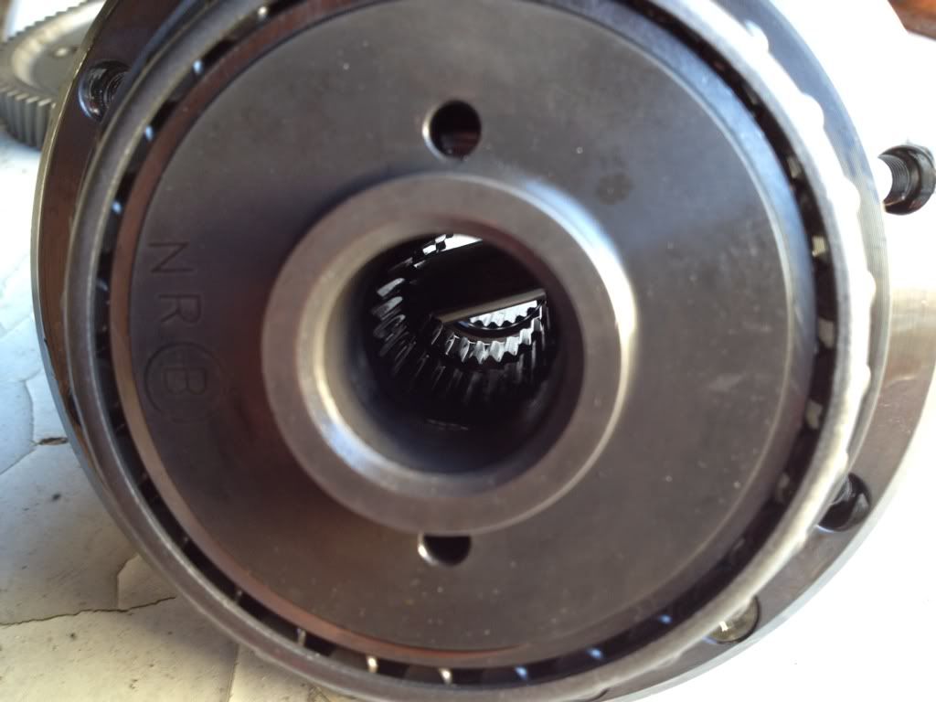

yep he sells by default on his pdf the normal full thickness (1 clutchpack on either side of pinion) type gripper LSD which is stronger & durable but you lose the speedo gear ring thats taken up by the clutches.
or if you specify u need the speedo gear, he can get gripper to machine a special one-sided clutchpack type like on mine.
both are on standard diff bearings so no extra machining needed
