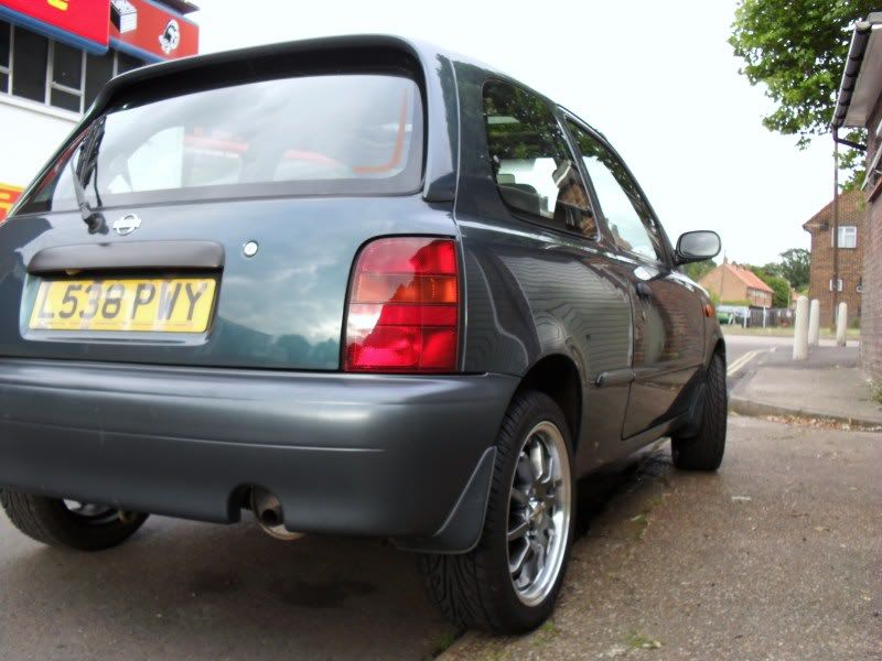

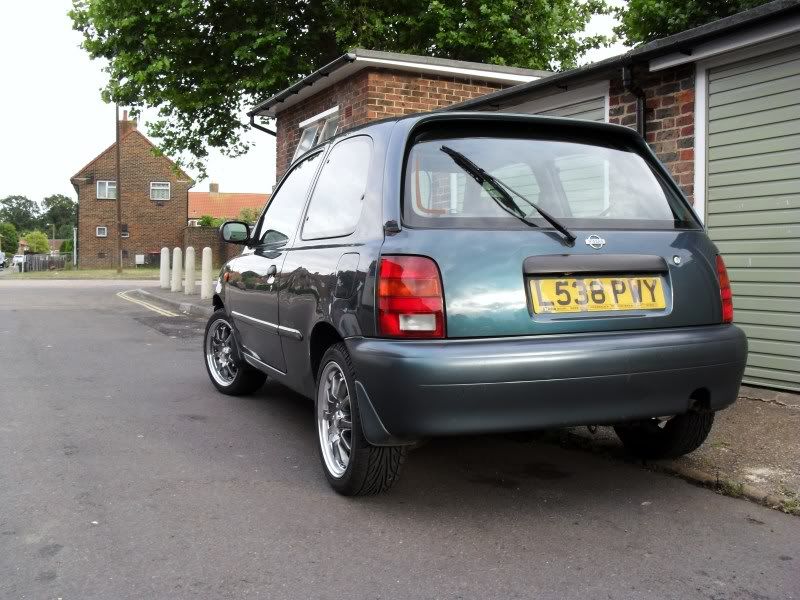

hey people i got the 15 inch alloys 195/50 and they fit nicely i think it would be better to have the 195/45 though
can you post up a pic of your 195/50s and a side pic...im guessing yours has been lowered as well, would a non-lowered be fine with them width wise (not sticking out past arches....at least not too much ;))

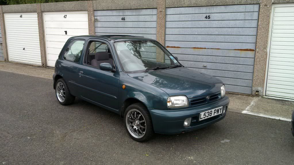

Ok folks, here for the first time on MSC .....
a picture of My car...........
Why am i so excited ? because this is the start of my mods
Its relavence here is that it is on 195 / 45 / 15s
so you will get an idea as to how they look on a standard Micra on correct offset rims. There are NO issues with clearance at all.
When picking this particular tyre size i calculated out the circumference of the standard 155 70 13 and compared tyre sises and sidewall ratio and found that the 195 45 15 gives the same circumference. therefore the speedo would still read correctly.
Hope that helps
Why am i so excited ? because this is the stat of my mods
Hope that helps

Sorry mate what "gap" is it that you have? :suspect:
Between arch and tyre... needs lowering! :grinning:
