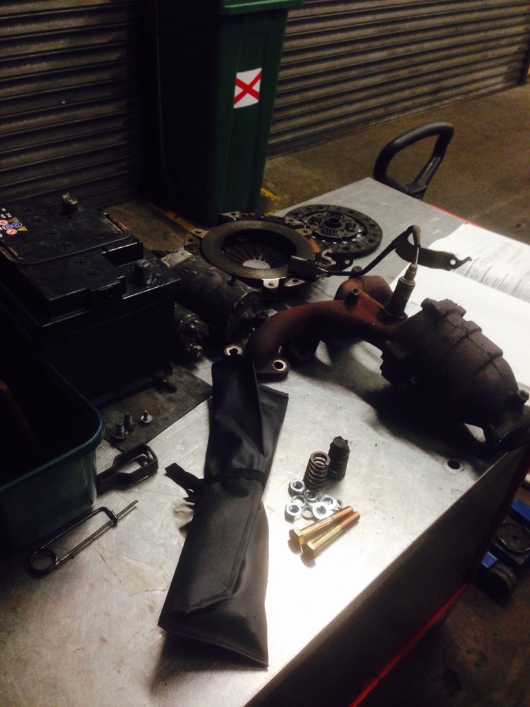

Good news - engine starts and runs. Took motor off and bench tested it to work a few things out. Did away with the blade earth terminal and it worked. Simple.
Bad news - makes a terrible noise. Part of the engine/box sandwich plate is bent and grinding on the flywheel teeth. Tempted to just run it until it stops. Investigating underneath and seeing where it is bent and where I can fix it.

Pretty sure it's the thin black metal sandwich plate mate :)
Because the dowels were badly corroded we did smash it up a bit with various levers and chisels and so on :)

The haynes says spring hub outwards, and it's definitely fitted that way.

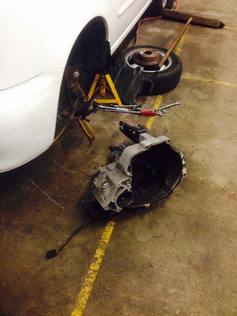

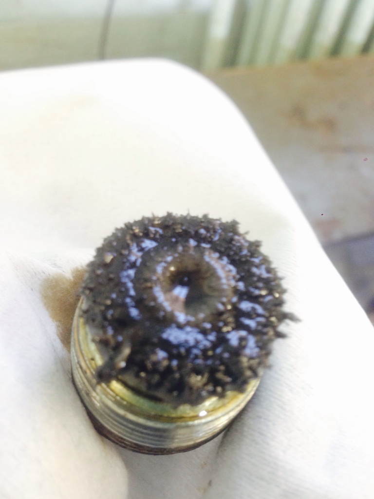

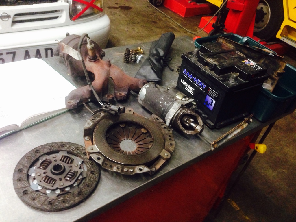

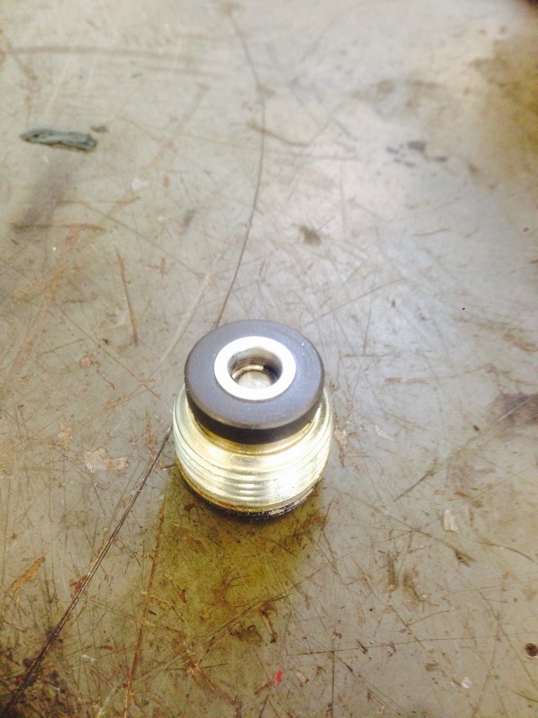

Here's my oil drain plug from the gearbox pre-clutch change, furry!
This is what it looks like clean

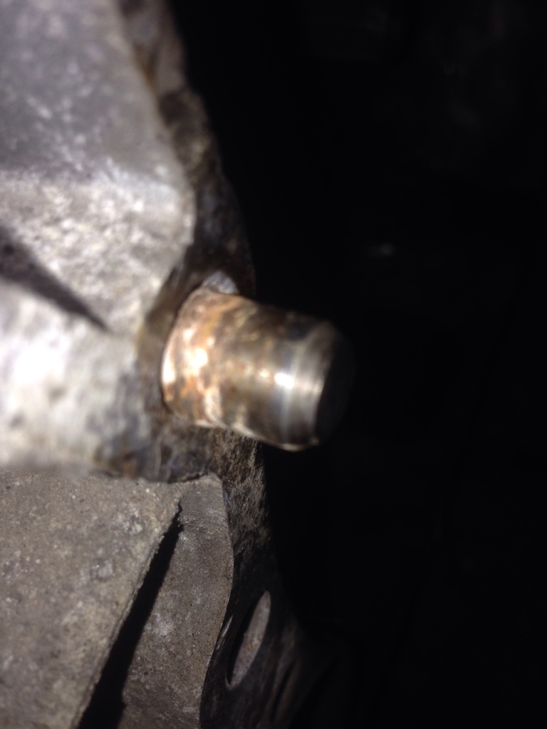

The next pic is of the very corroded and totally seized dowels which put up a serious fight!

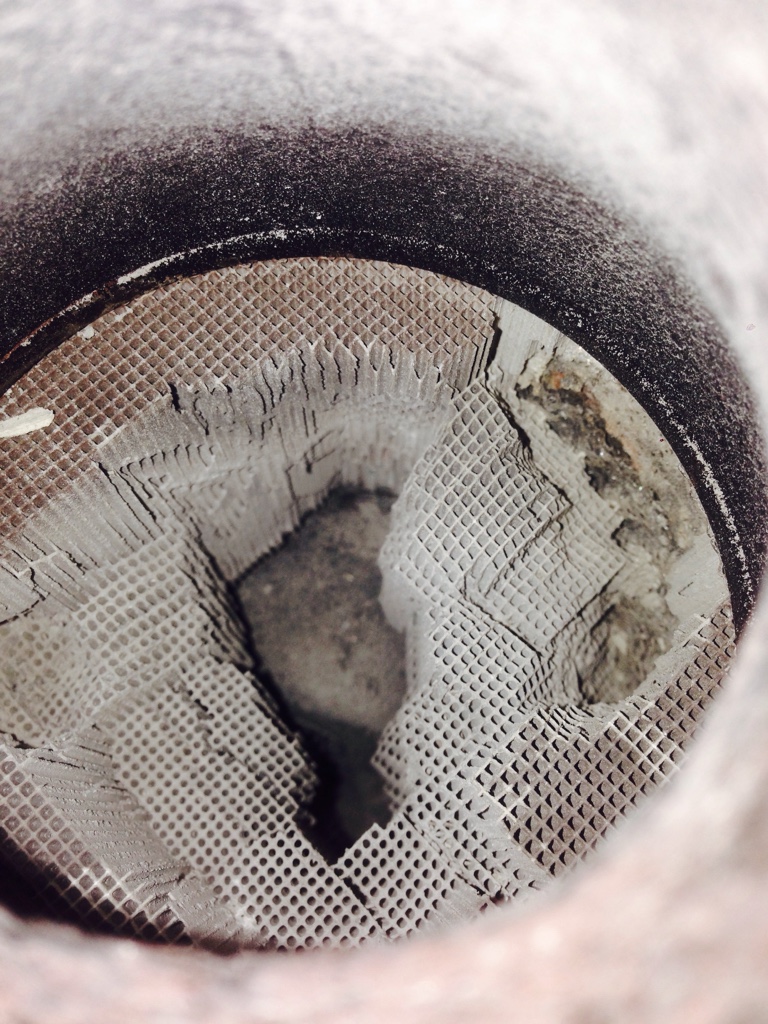

I also smashed the cat out of the manifold, here's a pic in the middle - I got rid of it all.

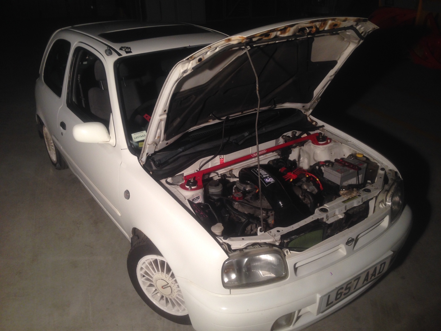

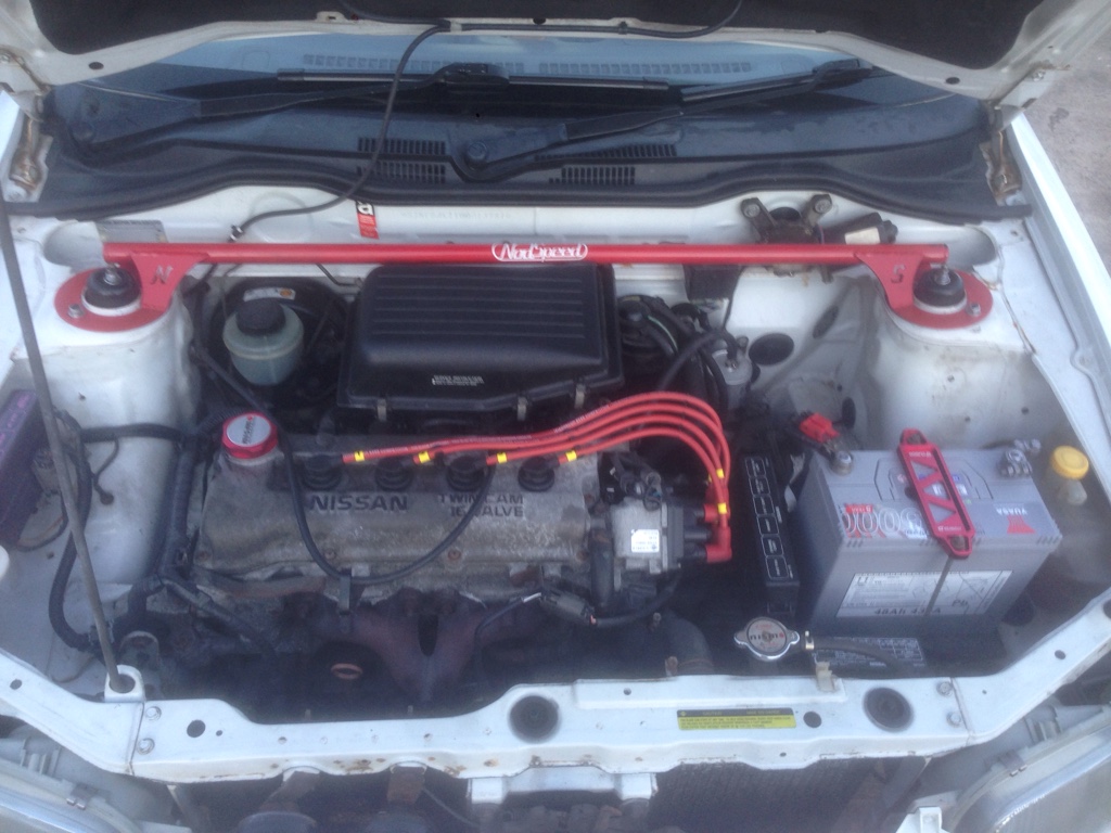

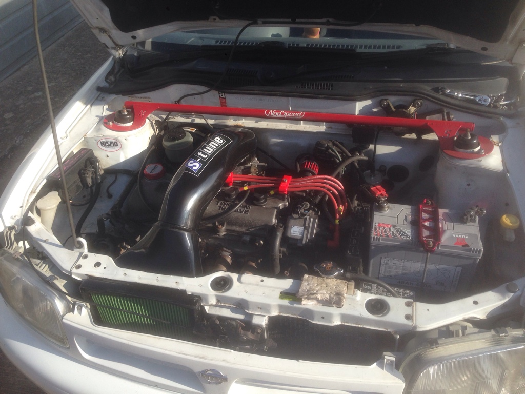

I added red ebay tacky stuff and some magnecor leads to spruce up the bay a touch.

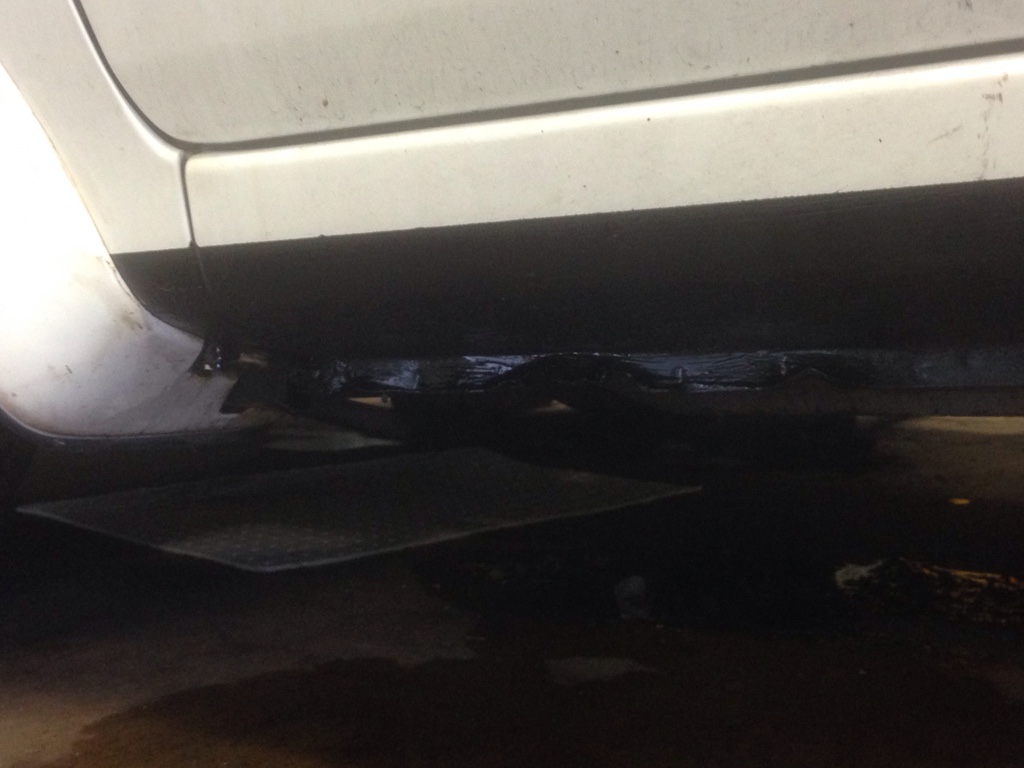

I also did some preservation of the sills and underside in general, hard work with the wire brushes, and some proper hammerite underseal. I also drilled through the sills and fitted extensions to the sunroof drain tubes.

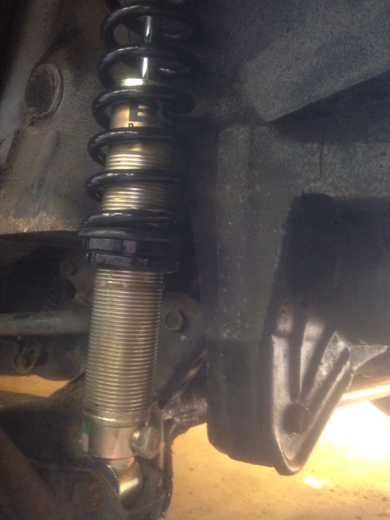

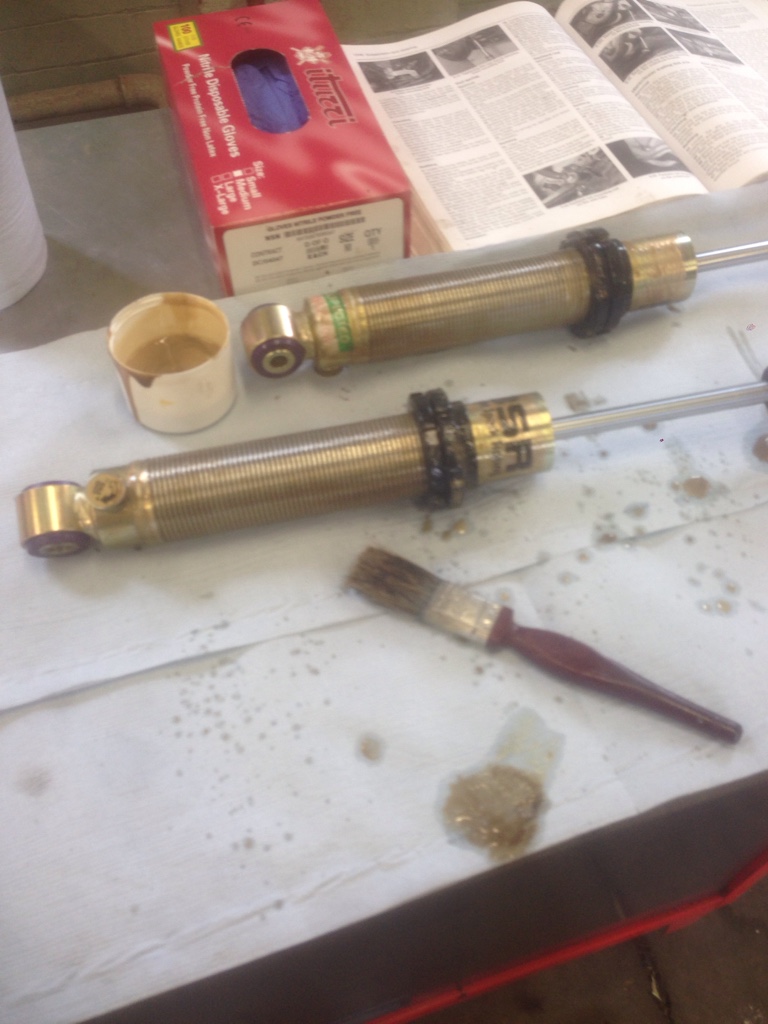

Fitted rear BSR Coilovers. GAZ Bodies and components, re-valved to suit the K11. Went fairly smoothly, took an afternoon overall.
I painted the threaded bodies with a sort of waxoyl type preservative. It dries to a tacky wax and has served the fronts well.

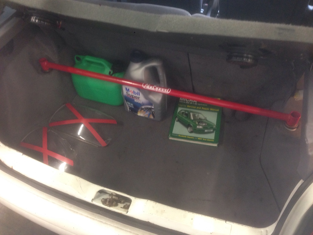

I also painted and fitted the rear strut brace. I'm trying to convince myself the boot space division is useful, you know, to stop stuff rolling around and that, but it is pretty restrictive haha.

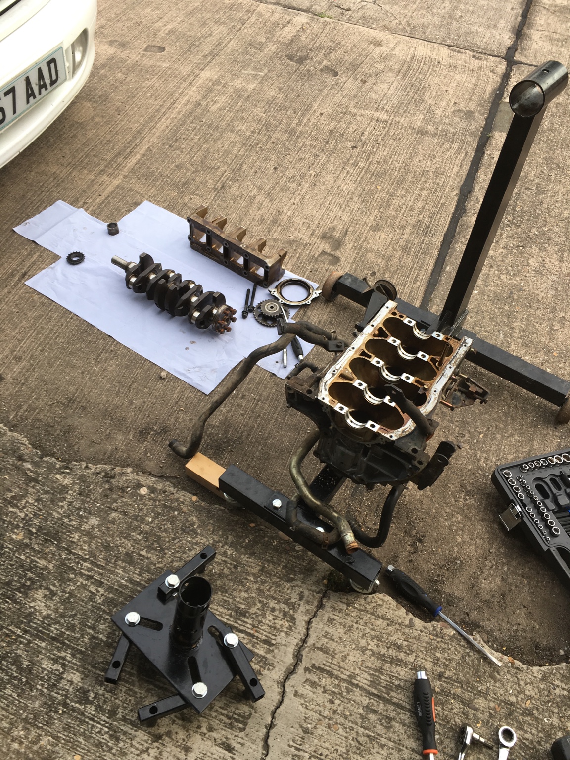

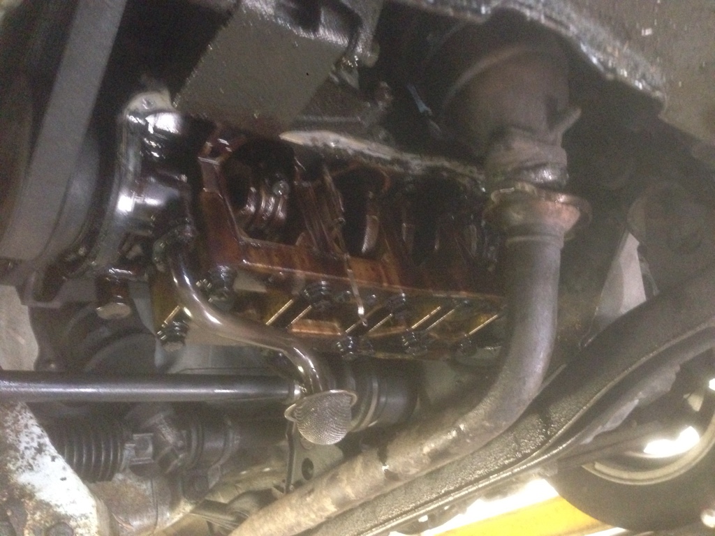

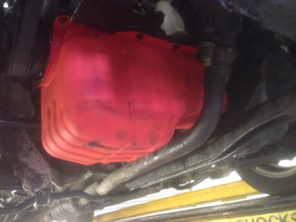

After that on Saturday, I spent Sunday trying to put an end to oil loss. The sump previously got a pinhole in it, so I used Araldite to plug it which seemed perfectly OK for a temporary fix. A year and a half later it was still strong and I hadn't bothered my arse.
The sump was definitely leaking though, bathing the alternator and the entire underside of the car in oil, leaving puddles and drips. Generally, it was in very crusty condition. So I formulated a plan...
I had a spare engine in the garage, who's sump seemed much better. Not perfect, but better. I'd take that, clean it up and paint it, then switcheroo and sort it out.
Old sump
Engine turny bits
And "new" sump, painted in Halfords High-Temp red, as it was the only suitable thing I had left.
However, on testing it leaked from the engine and gearbox mating side. I'm pretty confident that it's because I didn't seat the rubber semi-circle sealing strips properly, so next week I'm planning on sorting it out, for now, the car can lay quiet.

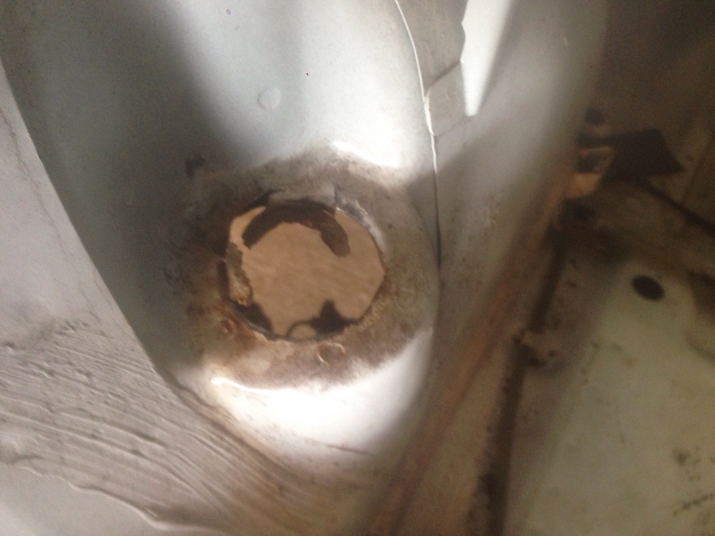

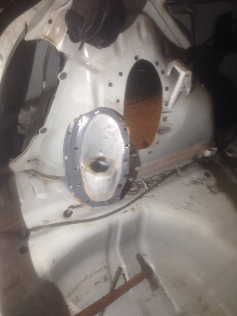

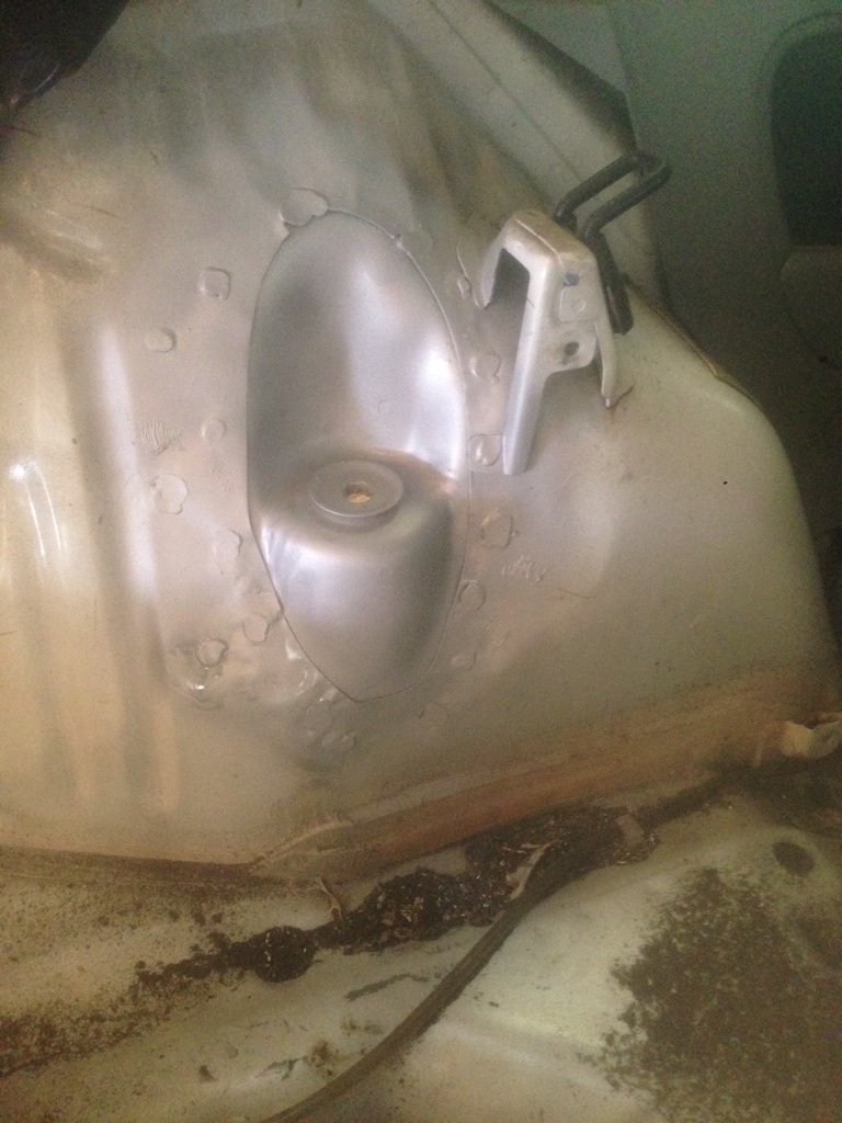

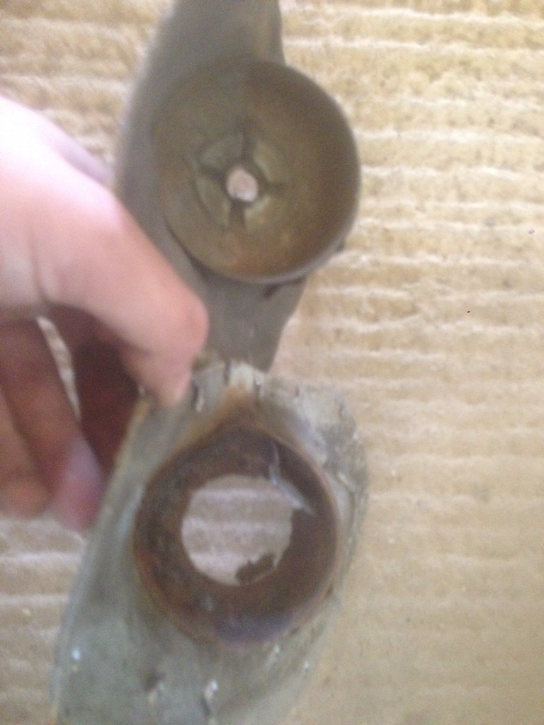

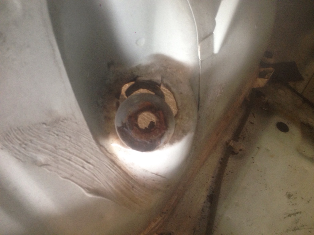

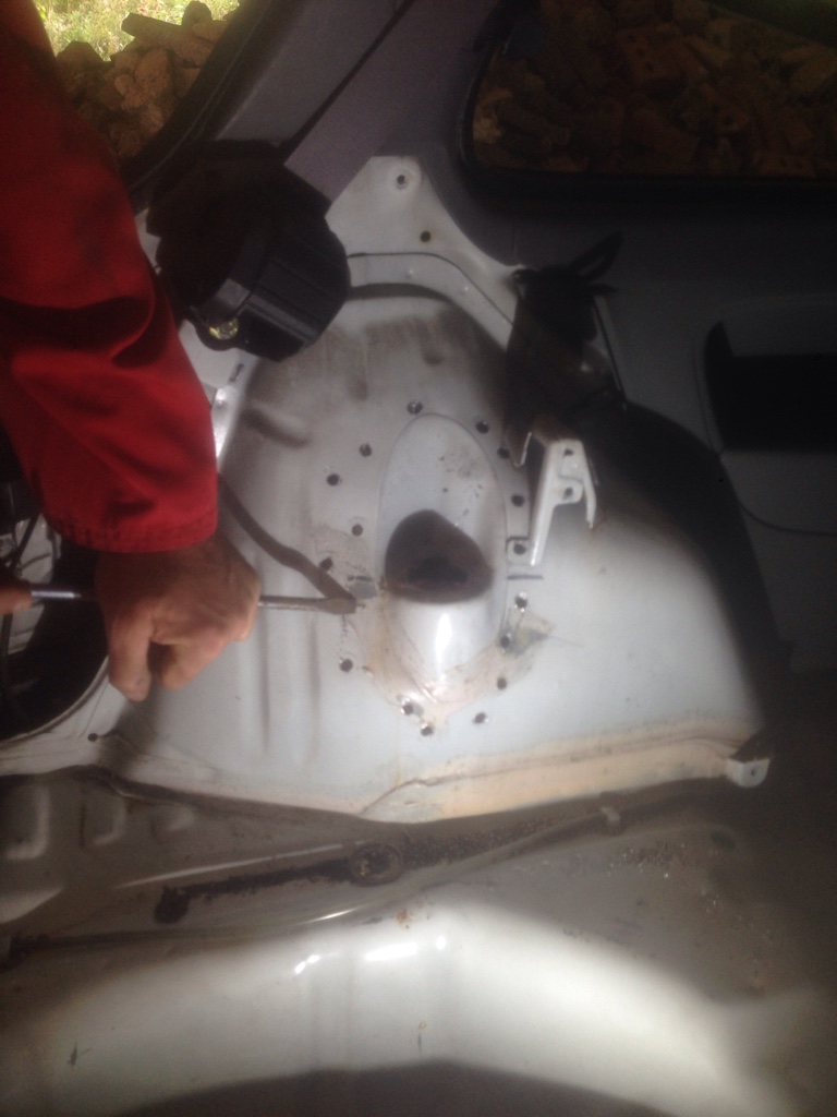

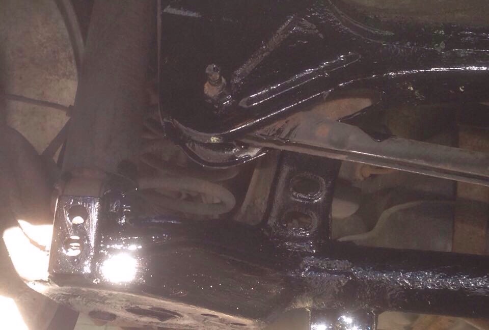

The rear damper mounting is essentially an inverted cup with a 10.5mm hole through the centre. A cup-shaped penny washer is tack welded to the top for the upper damper bush to sit in neatly.
Stock dampers have rubber boots which cover the exposed rod from dirt and stuff. These boots reach all the way up into the underneath of the mount and trap a lot of dirt and moisture around the top. This starts rotting out from the underneath. With how the washer is tacked on inside, it's impossible to see without removing the dampers and inspecting from underneath, hardly a routine task I'm sure you'll agree!

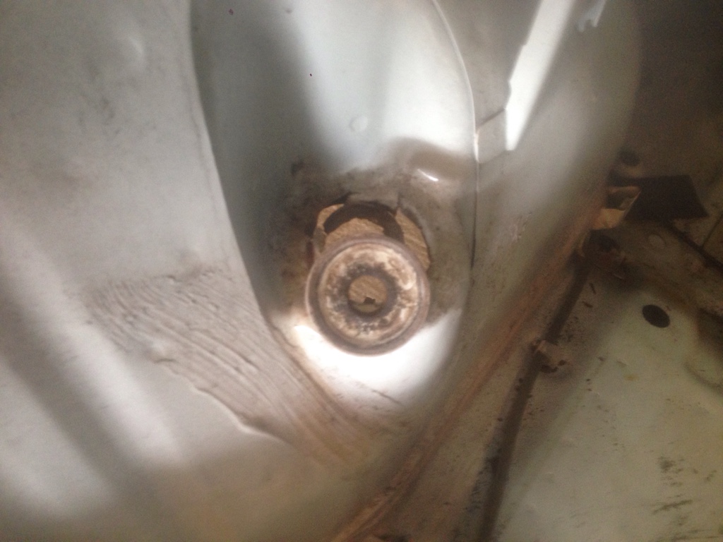

As such, this corrosion went undetected. Picture time!
Pretty bad, eh? I guess the combination of rust and then extra stress (I fitted coilovers, so the rear mount was now taking ALL suspension forces as there were no separate springs) just was too much for poor old Marceline. Yeah. That's her name.

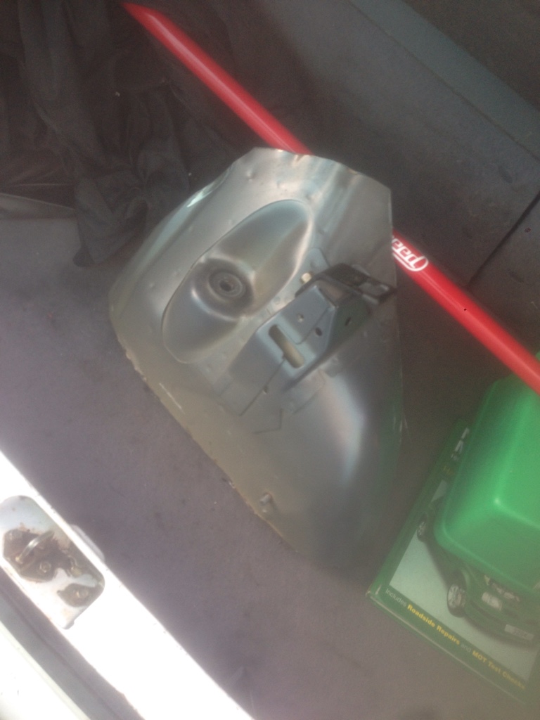

Fear not. The damper mount is spot welded in as part of a double thickness oval-shaped panel from factory. I went to the local yard and found a lovely rust-free number from a facelift Sport shell.
Using a petrol Stihl saw I cut the whole arch out, ready for the more delicate panel extraction back at base.
Using a pillar drill and a spot weld bit, which is specially shaped to remove material in a uniform way
(it's got a point for easy centring and the cutting surfaces are flat, to cut through the weld neatly and level)

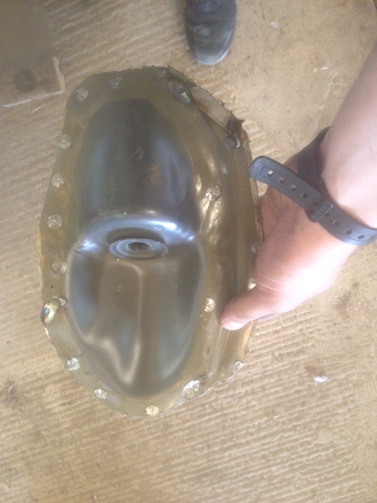

We removed the "new" panel from the surrounding arch.
Then using a battery drill and the same bit, we removed the rotten panel from the car. By using the special bit, you don't drill completely through and just take the weld away leaving the chassis of the car intact.
At this point you also have to gently work your way around with a lever, such as a sturdy flat screwdriver, to feel for any weld not completely removed, and prise off the factory panel sealant.
Et voila!
With the panel removed, it's quite interesting to physically feel the difference in metal strength. The oval damper panel is twice the thickness of the arch, plenty sturdy enough for suspension loading as long as it's not rotten!
Comparison shot from above as seen in the boot;
And what you see underneath;

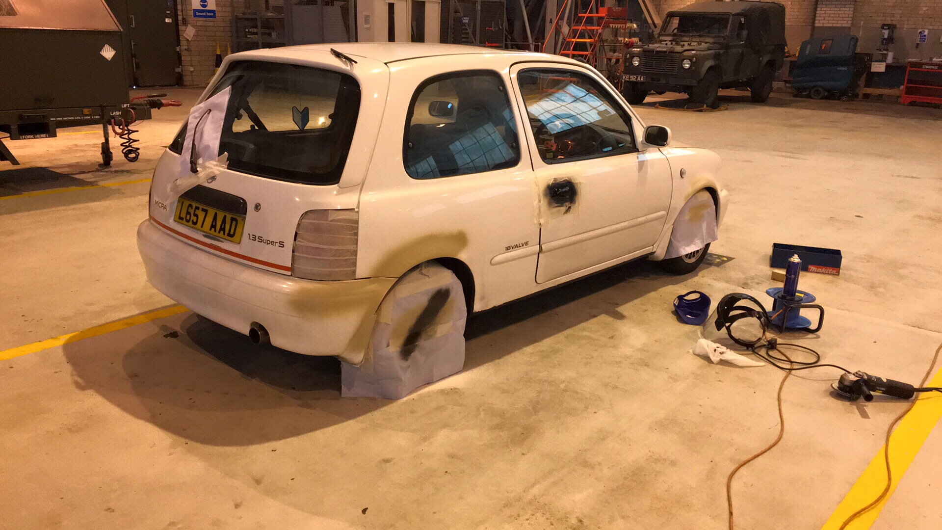

Finally we grind all the hole areas free of paint using a "flap wheel" to ensure good shiny metal for weld quality.

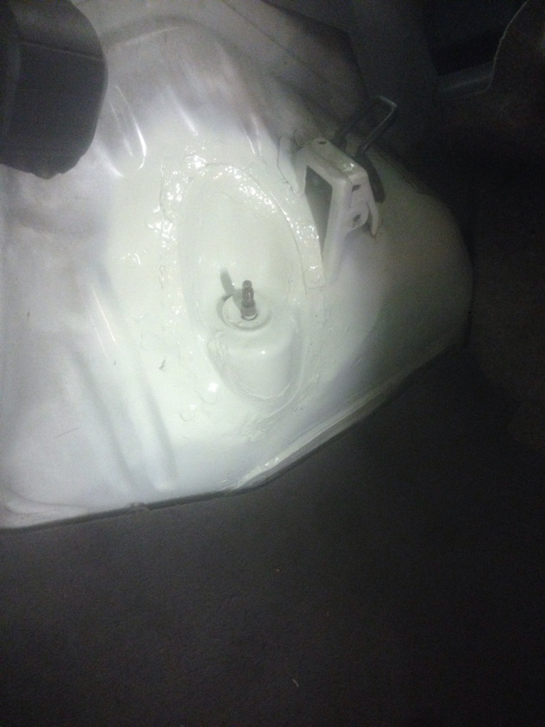

Before we start welding we disconnect the battery, and also the alternator. Some alternators have diode packs which are sensitive and can still be fried even with the battery disconnected. It's just a precaution really.
Also very important is to clear the area of fire hazards. As it's the passenger side, this includes the fuel filler pipe. Remove the filler pipe and withdraw, then seal the open tank pipe, we used a rubber glove and tape to seal secure. This prevents any unwanted explosions, death, maiming and injury. Carpet and back seats moved away too.
Keep an eye out for small, localised fires caused by the factory panel seal burning as you weld. Try to keep these under control, although they're not a massive problem.
To position the panel, you can make use of the factory paint lines. The lighter edge on the panel should be completely obscured by bodywork. An assistant will be required. Using a suitable long tool like a hammer or screwdriver, get them to apply pressure from the wheel arch side to keep the panel in place while the first few welds tack it in place.

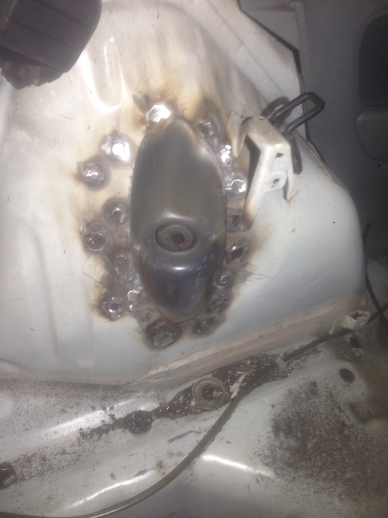

Apply weld from the outside of the holes inwards. Move around the panel in opposite directions, applying the weld and heat in different areas to minimise distortion and warping.
You may also need to do a few welds in the wheelarch if you have drilled through, or not all the holes line up. (Factory spot welds were done by eye and not machine, hence they're a little bit random between cars)
As soon as it's done, get some thick seam sealer brushed in there to protect your lovely handiwork. Primer, and paint. Waxyoyl or stonechip the underneath.
Finish!

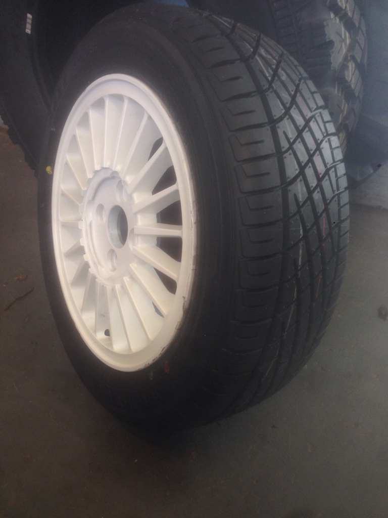

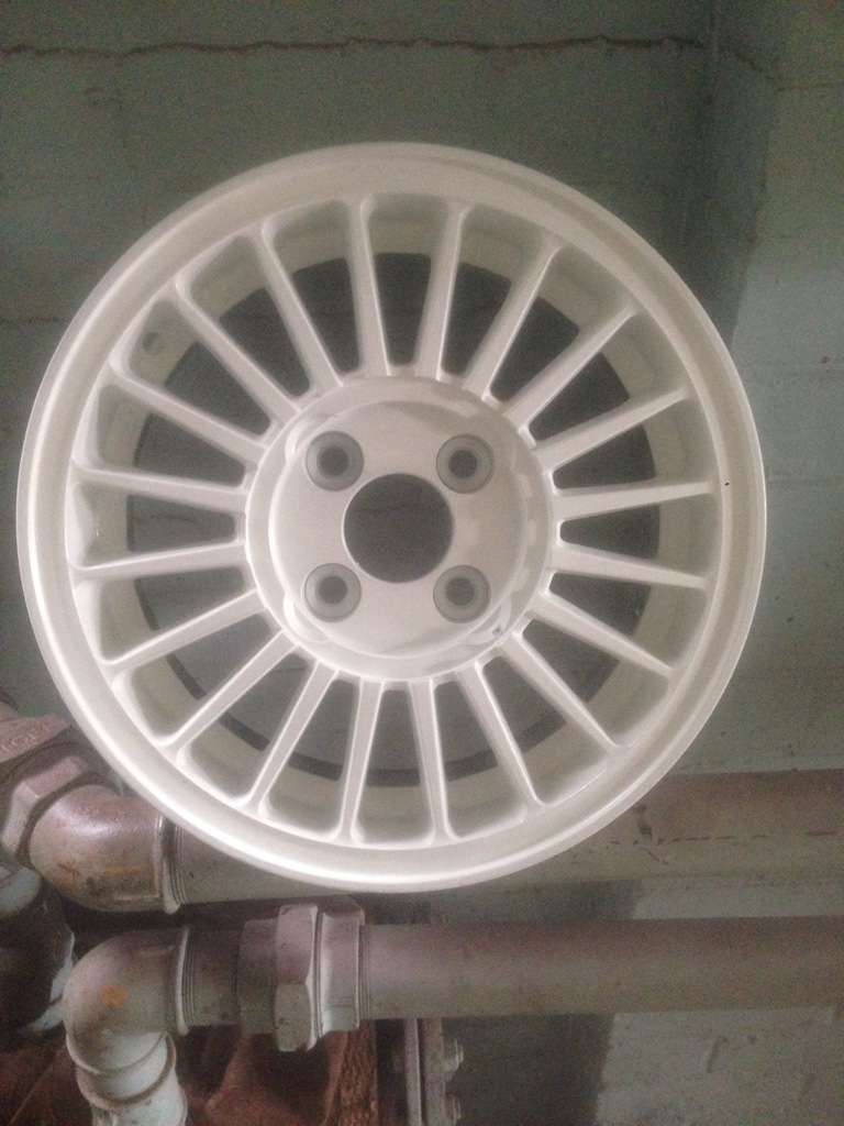

Paint all March wheels and fit new tyres ready for show,

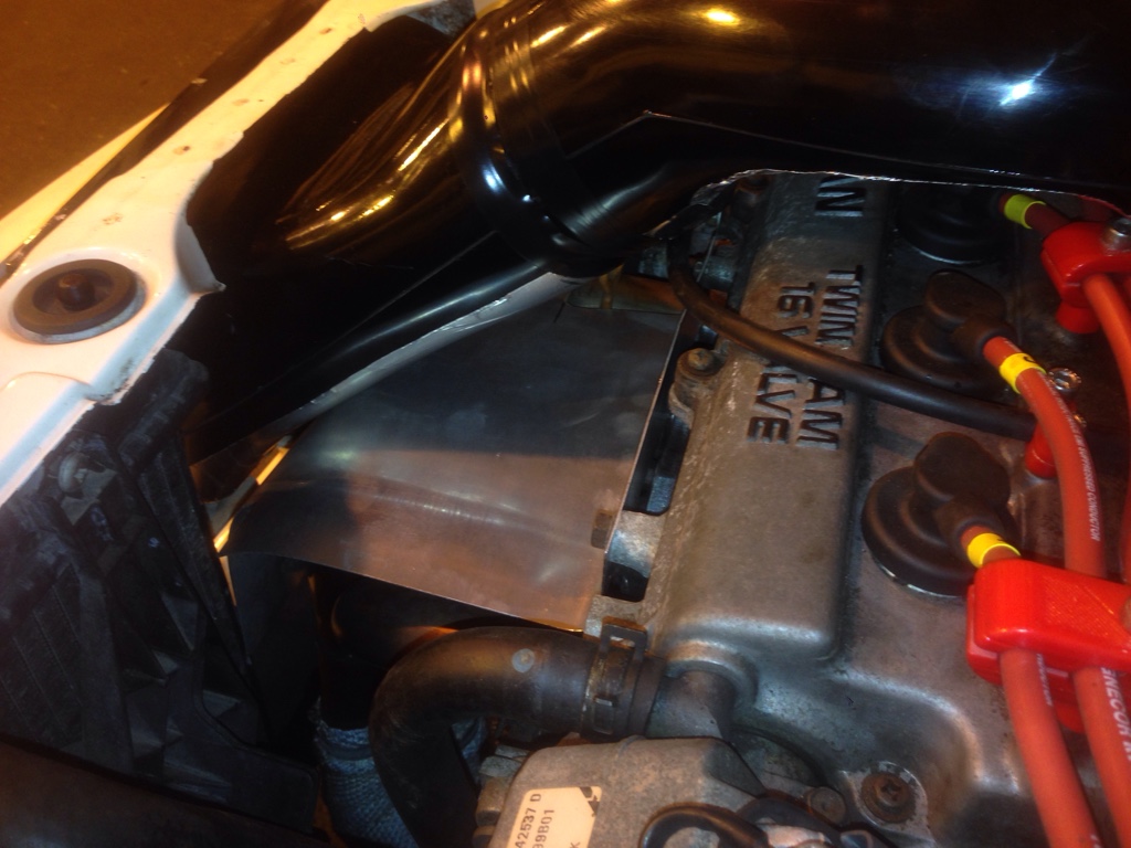

Initially, being designed for a Micra I thought it would be a straight fit, but it's not. You have to cut a lot of the slam panel away and also the bonnet catch backplate. It's not really a problem but was a pain, as I quite like my car and felt a bit bad about cutting bits off.

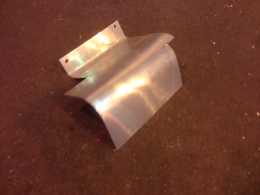

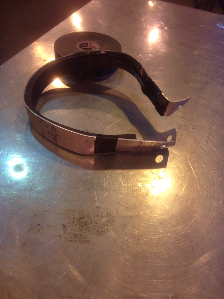

I got it squeezed in, and the Janspeed manifold is bulkier than the stock item, so it touched the bottom edge of the airbox and burnt it :(
Tried patching it and adding more shield tape but this did not work. A heat shield was necessary so I made one quite crudely.
The shield works lovely. I also made a bracket to hold the upper pipe to the throttle body more securely. Thin sheet aluminium with foam on the inner edge and wrapped in tape. It bolts on to the throttle cable holder/bracket.
There we are. Something like done on that job.

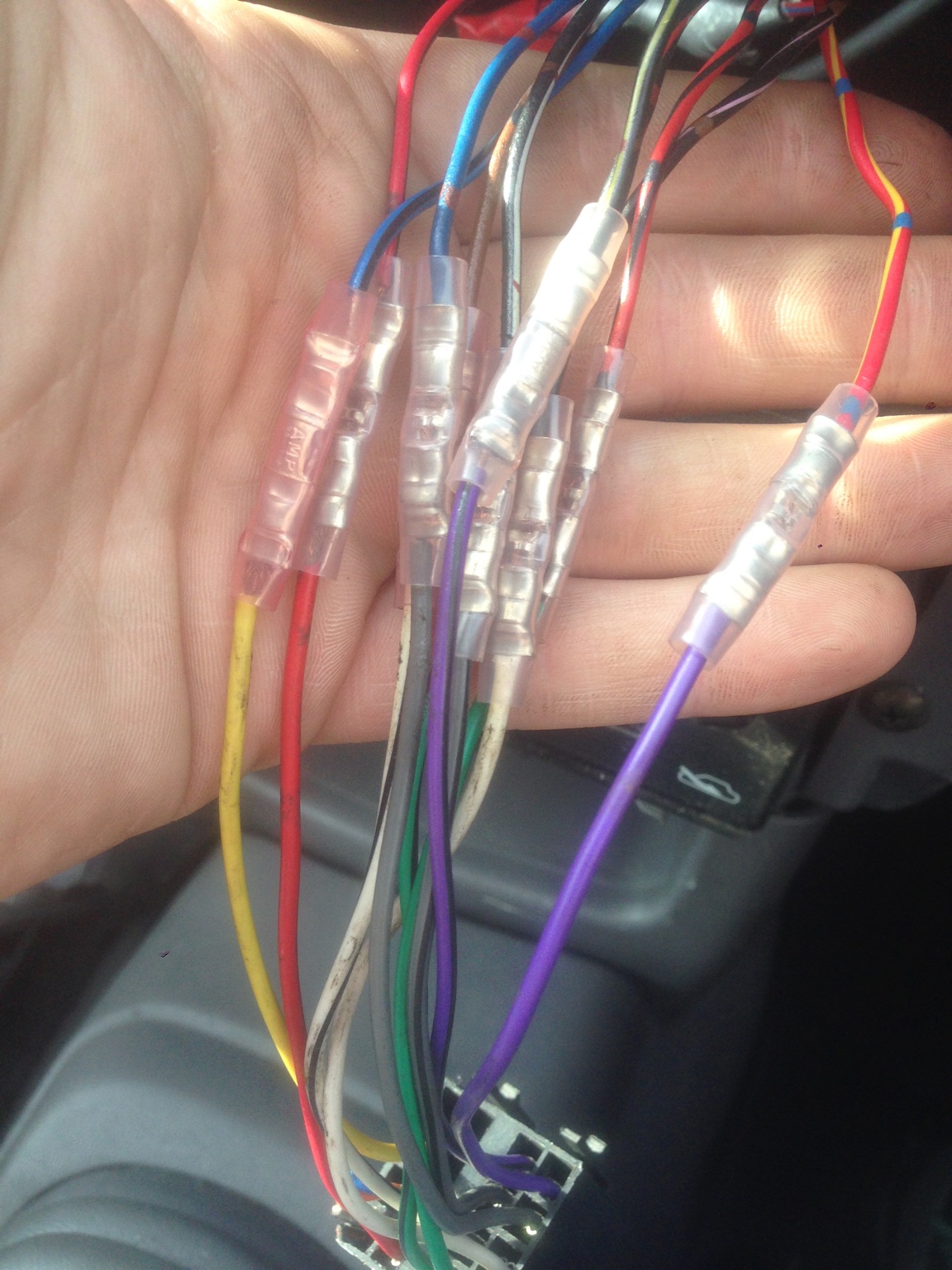

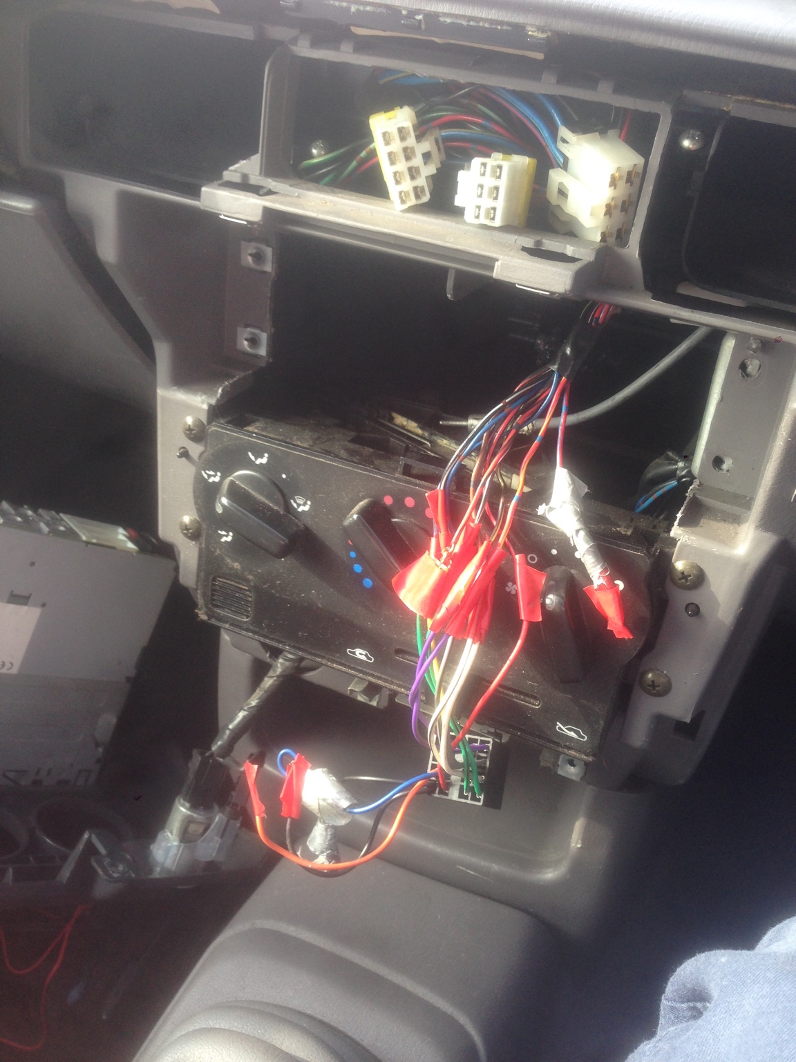

Also repaired horn wiring. I had an annoying fault where the horn would only work intermittently. I was convinced the problem was with the aftermarket horn button and steering wheel, as that was all I had fiddled with. On closer inspection I saw that the dual-horn had at some point been replaced, and the wiring was awfully bodged in. They had cut a middle section of insulation, and "tapped in" by badly soldering a piece on.
I cut all the wiring and crimped new connections in place. Working and much better.

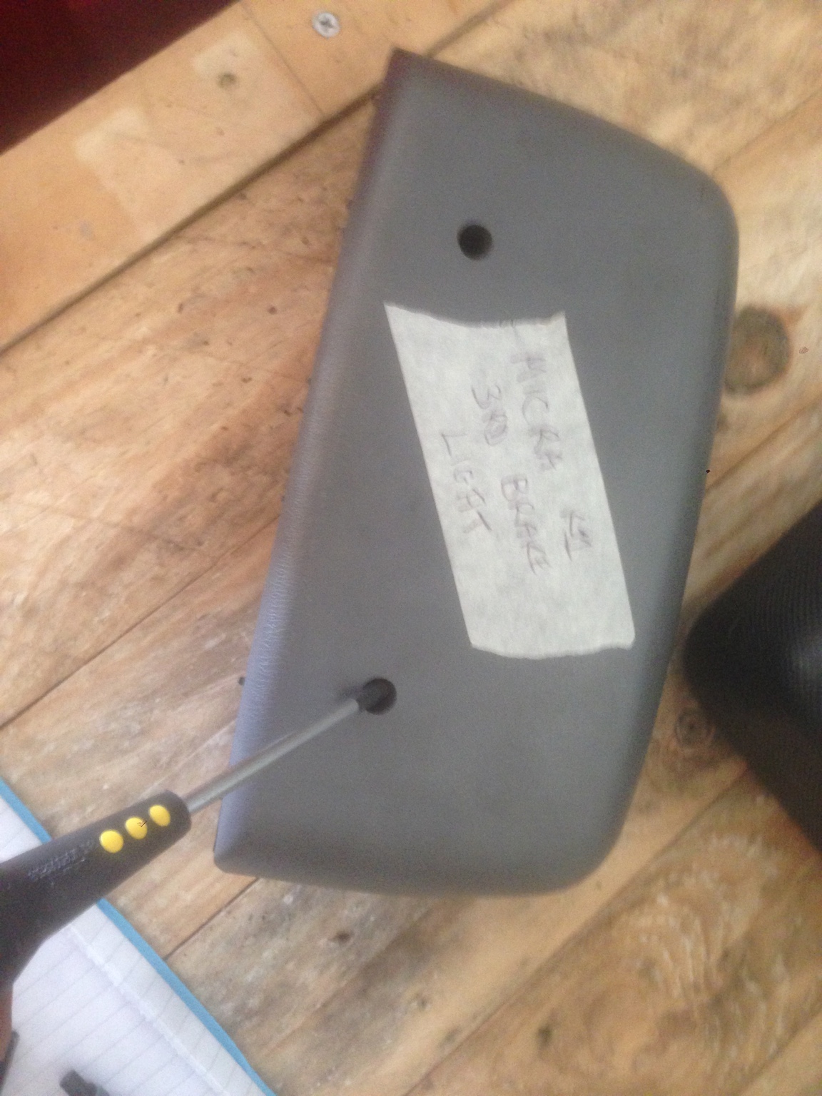

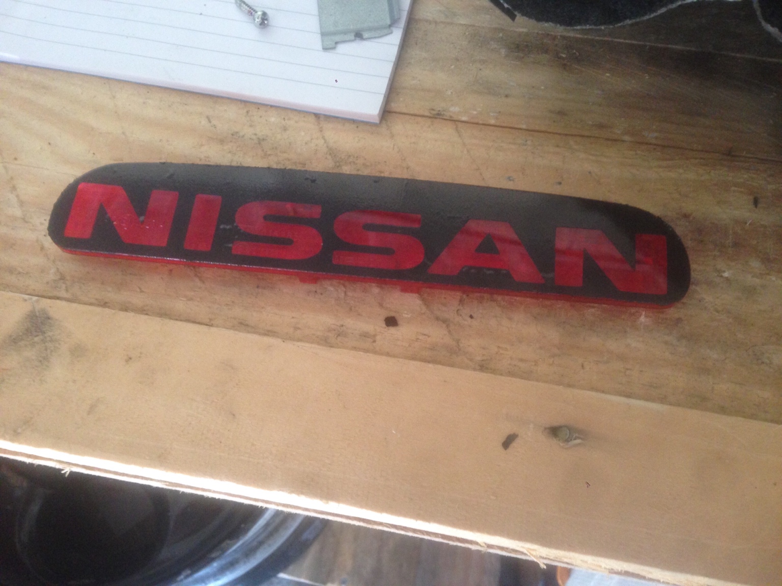

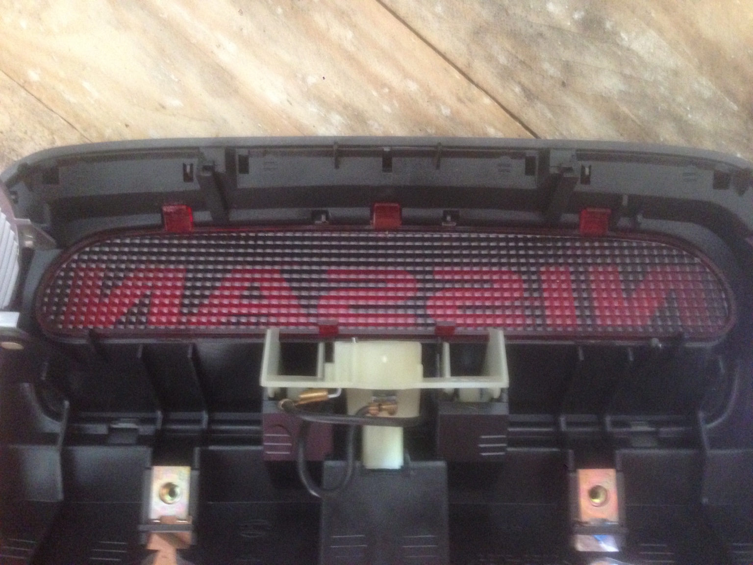

Weirdly my car had a cut out in the shelf for a third brake light but no light... Got one from a scrapper and wired it in, with totally badboy Nissan decal so people know what they've been overtaken by.

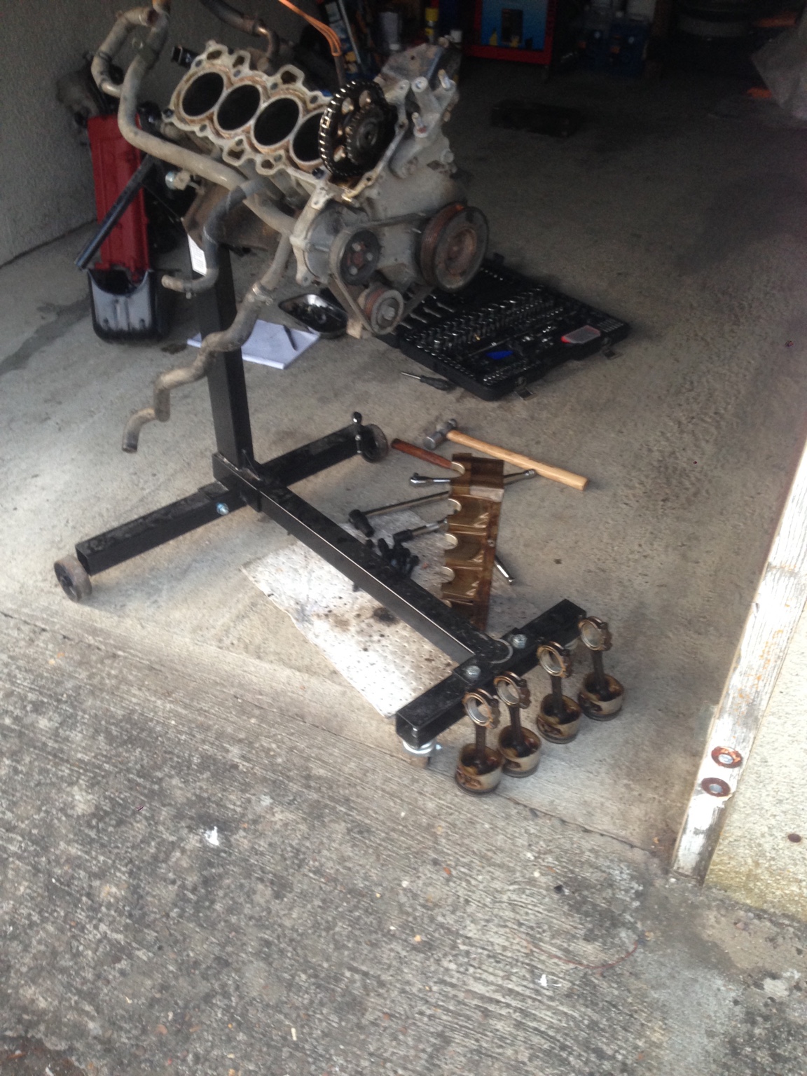

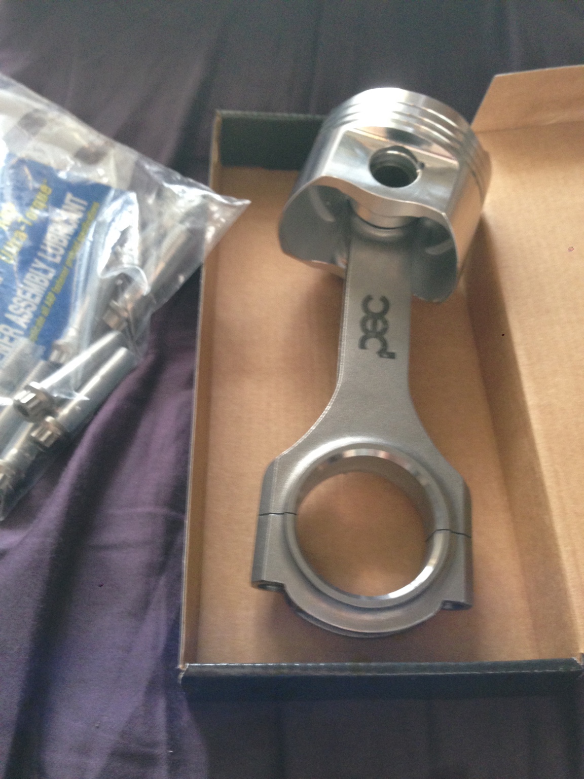

Also received my new kick ass conrods for the high compression screamer, with ARP Bolts and ultra-lube

Radio had been badly twist n taped by previous owner.
Fixed that

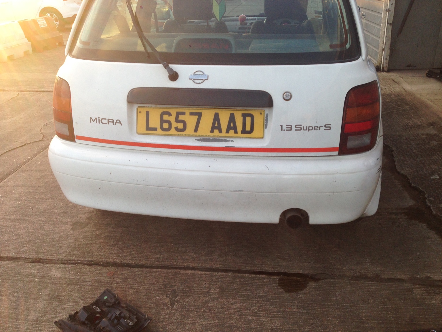

Fitted Euro spec drivers tail light to achieve symmetry. Used a red bulb in the reverse holder to keep Fog Light legal etc.

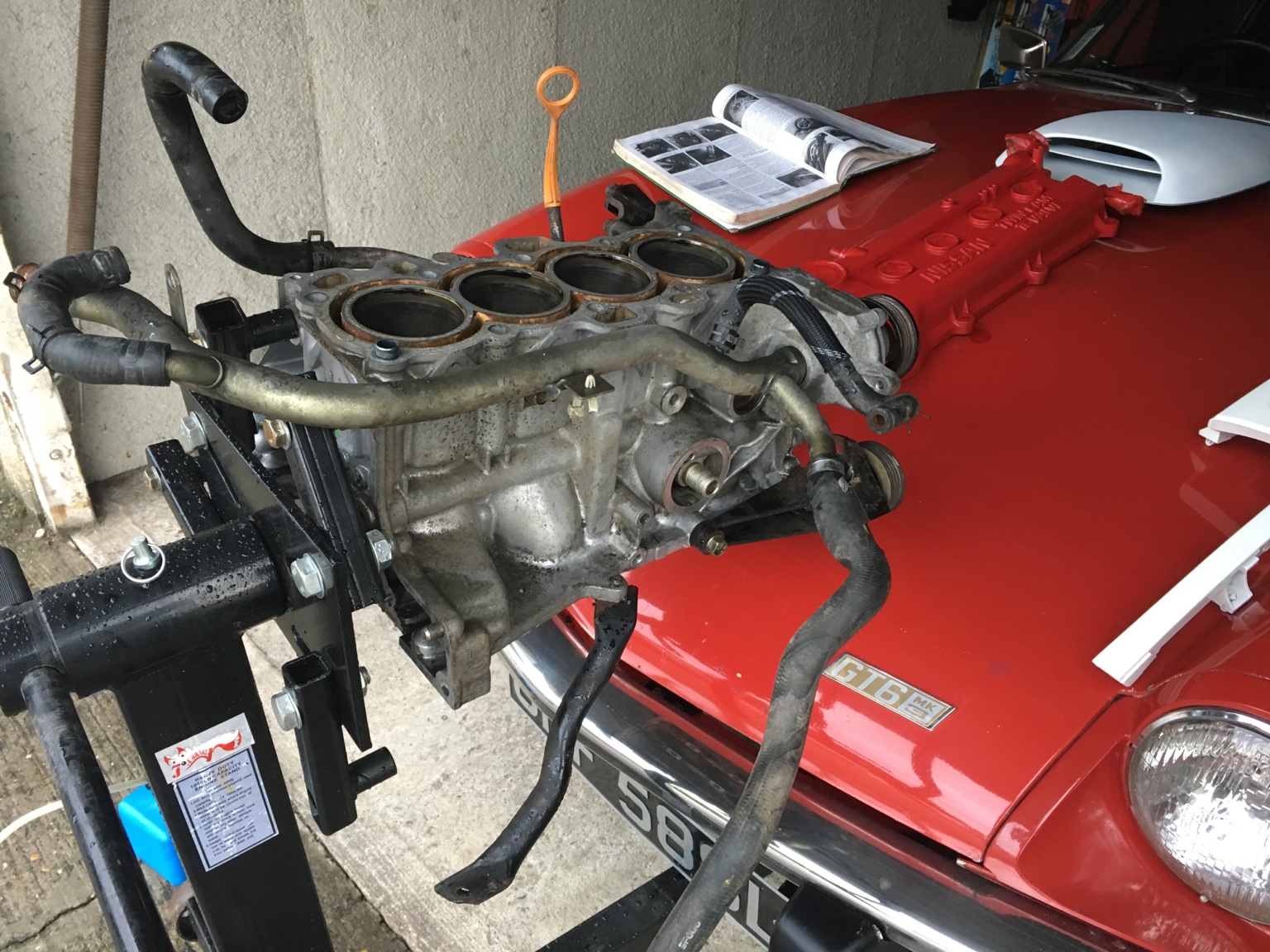

Removed old pistons. Found a chap who has a use for them, so he'll take them off my hands...

While doing the job mentioned above was looking around and checking stuff. Noticed passenger tyre worn close to the limit and odd pattern of wear. Booked car in for laser alignment. Garage showed me the screen. Both wheels were toe-ing left by 1 degree each!

Stripped a bit more of the block. Gonna check out the oil pump and order new bearings and stuff soon.
Main things I need are the head gas flowing and some camshafts. Settled on the billet items from PiperCams because I want this thing to run and run in the high revs. (6-10k rpm) then the engine will be mostly complete for the big bits.
Then I'll machine my rods down and balance the whole rotating assembly, double valve springs and knife edge the crank and stuff. In the right order, obviously.
Going to take a while to save up the funds like.
De rusted the arches for japshow. Lacquer is pretty dull. Hope it will polish up ok after a cut with the buffer.
Also painting a bunch of body parts like a midspoiler, grille and scoop.
