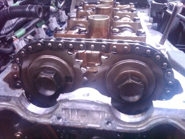

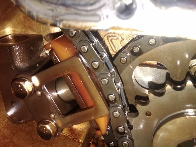

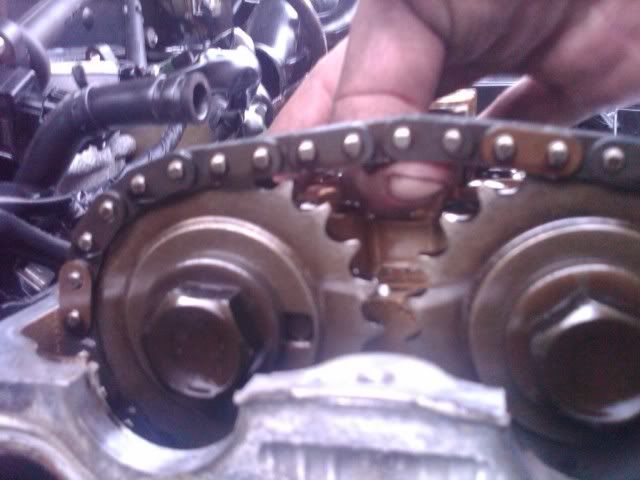

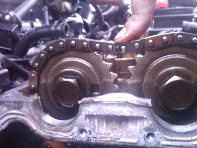

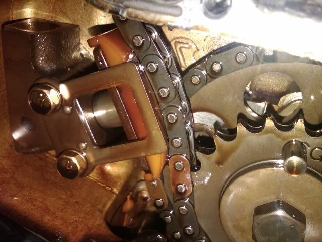

been out took the cam cover off and upper chain cover off. not to sure what im looking for to know if the tensioner is ok for the upper chain. so if anyone can have a look at the pics and see what you think.
also does the chain look to slack?

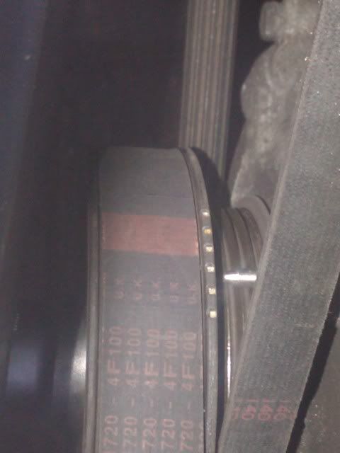

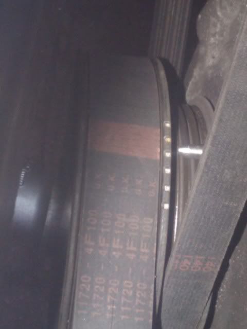

oh and one for frank, in one of the threads you said 3 notches on the crank means the chain is healthy and 5 is knackered, well im not sure if this counts as 3 or 4 when moving the crank with the cam still.
it started at the dot furthest away from yellow dot, bottom dot on plulley in pic and this is where it went too
then move crank back other way it went to here
frank
Club Member
looks fine to me andy (Y) you have to use some force to expel the oil from the tensioners eh (they are sprung and hydraulic)

just give the engine a full turn andy, the lower cover is a sump off/head off job :eek: my old super s had 1 really bad link on the top chain @ 100k, and the lower chain was still fine after 130k
