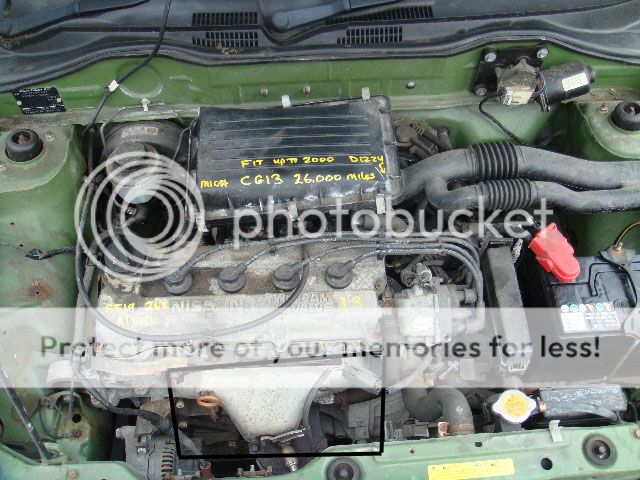

Sorry to double post, but my mate's getting a little bit fed up with the rattling coming from the Micra. I think it might be the top heat shield on the exhaust. Here's a picture of the one I believe is making the noise (I've put a black box around it as well)
Is it ok to remove this one? Are they a sod to get off? And what do I do about the object that is bolted to the front of it? (Could be a sensor for the CAT?)

yep the shield bolts usually rusted on so try undo with sockets or mole grips, else cut it off
the little bracket in front just holds the o2 sensor cable, just tie the cable somewhere away from the hot manifold

Cheers. What do you suggest I cut it off with, if I can't get at it with a socket? (As it's a pretty tight fit down there.........) And these are the "blind holes" I've been told about before, right? (I don't want to be fupping up the little Micra, before I'll little "project" has begun.......)

yeah those are blind bolt holes. u can either bend it back n forth till it fatigue snaps off with alot of effort or saw it off with junior hacksaw or personally i prefer my trusty dremel or angle grinder to grind the bolt head off
