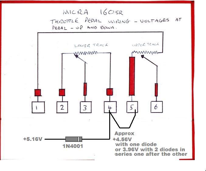

I have done a simple diagram of the connections, the red shows the resistors, i have drawn them so scale so you can see the difference in the sizes. both the wiper arms work at the same time and they start from left to right ( left is no gas )
Amazingly you have figured it out exact !! 10/10, you must know your stuff!!! Aah but there is a small error, the wiper shown from pin 6 should point to the right Pin 1, this is where the position would be relavent to the wiper position of the left set up. but still well done!!
as you can see from your own diagram, and the position shown by your wiper arrows is with the pedal in the up position, hence resistance between terminal 1 & 6would be at its lowest (with your wiper pointer (pin 6) switched to the right towards pin 1, and same again for the lower track, the resitance between 2 & 3 will be lowest,
So you really need to check what voltage you are getting at pin 6 and pin 3 which are the two wipers, and also see what voltages are at all other pins, with pedal in the up position and the pedal in the down position, all voltages measured against vehicle earth or ground reference. This should give you enough idea what to do or which pins to modify either by placing a series resitors or shunting voltages using a paralell resitor.
The trick was the two solid tracks which you said ran at the back on the top strip and the bottom strip, as they make the top strip and the bottom strip as a wiper point.
Just updated your diagram accept the wiper is now in the position it should be.
Pins 3 & 6 are the actual sensing pins, where the potential changes due to the pedal position, so I belive inserting a series resistor in pins 3 & 6 won't do the job as this will only effect the current and not the voltage, but I beleive that altering the resistors to the other pins of the potentiometer may alter the required response by adding or inserting a series resitor to any of the pins 1, 2,4 &5 but not the 3 & 6, as I strongly beleive the ecu senses the voltage rather than the current sense through this variable pedal control.
as you can see from your own diagram, and the position shown by your wiper arrows is with the pedal in the up position, hence resistance between terminal 1 & 6would be at its lowest, and same again for the lower track, the resitance between 2 & 3 will be lowest,
So you really need to check what voltage you are getting at pin 6 and pin 3 which are the two wipers, and also see what voltages are at all other pins, with pedal in the up position and the pedal in the down position, this should give you enough idea what to do or which pins to modify either by placing a series resitors or shunting voltages using a paralell resitor.

Well having studied all the parameters, I think you could change the pedal response by simply changing the +5V to a lower value, this will alter the wiper voltages in the same proportion, so no need to worry about resitor balancing,
So if you add for sake of argument a series resistor of say 1K then we must add a series resitor of 2 K in the other circuit.
to maintain the tracking ratio.
But an easy solution is to use a silicon diode in series with the +5V supply at pins 4 & 5 , this will reduce or drop the the +5V to 4.56V and so give a slightly lower value at the wipers proportionally in the same ration to each other.
You can try one or 2 or even 3 silicon diodes in series with the pins 4 & 5 which can be connected together and as they both require a +ve feed on them so by applying a lower +ve voltage of say 4V by using 2 silicon diodes in series, this should alter the pedal response.
But, there may be a snag, will the ECU detect that the idle accelerator voltage has gone down below the standard set value of 0.387 at pin 6, and twice this ie. 0.765 at pin 3. , since if you feed lower voltage into the pots it will give proportionally lower voltages all around.
In my view it shouldn't cause any problems, but we don't know, it might effect the engine idle speed, but I can only guess. If it does then we will have to find a way of keeping the minimum voltage points unaltered but alter the rest of the response using some other trick.
So please get hold of a few silicon diodes and experiment and report us the results. If this doesn't work you will have to get Ed to sort a look up table using a Pic !!! pics are my weakness!!

It is quite easy to predict the voltages when you alter the supply voltage, as all the voltages on a potential diveder network will fall proportionally, so for example if you dropped a +5V to 4.4V using a single silicon diode, then 4.4V is 88%, hence the voltages at pin 3 & 6 will also fall by the same % amount , so for a 0.387 it will be 0.340v at pin 6.
and for 0.765v it will be 0.673V at pin 3.
These figures maintain the same ration but the ecu may not accept them.

Hi, I have done some testing, I got all the bits from Maplins and I connected the diode as per the diagram, here are the results.
I connected the diode and the car started normally and ticked over at aprox 1000rpm which is normal I think, cant remember what it was before I started to mess with it DOH! any way, I think I notice the little dead spot that you mention, but only just. the dead spot is only just noticeable with careful pressing and listening. The rev response is the same as before. Then I took the diode out and tried again to check what the pedal felt like when back to normal, to see if it had a slight dead spot anyway. The first thing I noticed when removing the diode was the tick over went up to 2000rpm so it must have learnt the new value, then after a few seconds it re learnt it again and went back to 1000rpm ( clever little thing! ) the dead spot was gone I think but it was so hard to tell. I await your prognosis before I try any more diodes or resistors.
You won't harm the ecu by adding a few more diodes, add two and then study the response, and this will make the dead spot a little more, and the response will be slower, then try even 3 diodes or even 4 , but all diodes must face the same way (like batteries in a torch)
Also is there any way you can note the RPM v/s the pedal travel on some sort of cardboard scale held steadily next to the pedal, this a little more scietific way to find out what changes have occured to the response for the same amount of pedal travel, the reves should in my opinion rev slower.
Bear in mind that by adding more diodes the upper most voltage on the wiper pins will be lower than before and so under load the car engi8ne will not reach full revs, but this is to be expected with this method. This should not be an issue with learner drivers.

BTW I think a diode is a bad way of doing this. You never use diodes in voltage dividers in this fashion, only if your creating a ref. voltage say with a zennor diode.
every one has a way, I am not using diodes as a potential divider, so for a start you did not grasp the idea of using diodes, all the diodes are doing is providing a lower operating voltage for the potential divider network, so instead of having a scale from 0.7V to 4.5V from up position to the down position, using 4 diodes are removing
0.6 x 4 =2.4V from the 5 volt supply rail, so the potential divider network is now spreading lower span of voltage i.e 5.0-2.4 = 2.6v so this should give you roughly a voltage from about 0.3V to a maximum of about 2.5V on the wipers , hence the pedal travel scale has been alterd to a twice as slow response. And this will also limit the engine reves which may be benificial in the case of learner drivers.

Ed, please, by all means suggest an alternative circuit, and let us see what we need to do, any circuits, etc, and it will be intersting obviously.
saw the videos, quite intersting, and I saw the result when you used 5 diodes, uisng 5 diodes will take out 0.6v x 5 =3volts away from the original 5.0V supply across the potential divider network, and so you will get only 2V left across the potential network, so with 5 diodes it is gone too slow, keep 4 diodes and switch them in and out without making the circuit go open, in other words bridge the diodes with a switch wired across the diodes,
Blazerboy, being that you are a driving instructor, I feel bad having to tell you that in the video you are seeing an engine with absolutely no laod, not even the clutch when depressed imposes some load on the engine, so what i suggest that you actually try the mod in a real given situation by driving and don't forget when you get a biting point that is a load on the engine and stops it revving away freely, so please do a small test drive, and I don't ned to tell you if anything goes hay wire, i.e engine goes raving mad, depress clutch and brakes!!! lol.
honestly you will need to conduct real tests.

With all due respect Ed, you seem to think that we don't know what we are doing and that we are gussing all the way, well not quite true because our mods have been thought with a lot of consideration and has resulted in what we expeceted it to achieve.
You obviously have missed some of the posts in which we stated the pedal down and pedal up voltages. They have indeed been established.
For the sake of simplycity, what we have done is achieved half a throttle response when the pedal is fully deperessed, now you will find that for most normal driving one doesn't even fully push the pedal down to the floor, unless you are a boy racer, most learner drivers will probably not use more than a quarter of the pedal travel, still leaving plenty in reserve, and once we have sorted out the bias voltages that will make the mod switch in and out seamlessly.
Further to your comments about the ECU light having tripped in, this was nothing to do with the mods using diodes or anything for that matter, this happened when Blazerboy disconnected the pedal module from the ECU while the ignition was on or the engine was running.
Lastly please supply any evidence that the engine has been running badly, you might not have seen the 3 videos in which there is no sign of engine running badly, you are obviously missing something.
finally with regards to the ecu light, it will be reset after following instructions from a link in which it exlains clearly how to do that.
So why would this mod be any more dangerous than the car already is , just touch the pedal and it revs madly, thats more dangerous in my view.
I think your argumenet is based on irrational thinking or just some bad feelings perhaphs.
we have achieved what we wanted and it is very safe and the switch over will be seamless as well.
but as I said best mode would have been a more stronger return spring, this would have definitely made the pedal feel less responsive or much harder to press down to achieve the same respons than before . No hard feelings mate.

Hi, just a little info on why i would benifit from this mod. mostly all my pupils have no trouble with driving my 160 as they all started with my 1.2 k12. its just the NEW pupils that struggle. Imagine me sat at the side of the road with a pupil that has never pressed any pedals before, i am getting them to feel for the biting point for the first time, " press the gass a little, not too much" and yes you see what i mean now, there is a red k12 sat at the side of the road giving it death ,5000,6000 rpm then back down to nothing..lol when you see the video "standard" you can appreciate how difficult it must be for them, its hard for me or anyone if it isnt immeadiatly backed with a little clutch stright away. thay can take 10 seconds or so to find a bite when they dont know when it will come, they are nervous first time also, and they know its wrong when the engine makes all that noise and it puts them off.
i will test drive with 4 diodes today and report back very soon. Frazer
I can't wait to see how this turns out :) The diodes are reducing the output voltages across the whole range. WHY?? thats not the desired result is it!
Well, if you go back to the very 1st post on this thread, it clearly says what is to be desired or expected by Blazerboy, and I have come up with a very simple solution which literally divides the pedal range by half, with this set up for learner drivers, you would never see learner drivers belting around the streets with their foot right down !!

I'm not suggesting you don't "know your stuff". The diode idea is a bad one, it isn't a solution to the problem -> it won't work. As far as this thread reads, there is no indication that you: firstly know what the 2nd potentiometer is for and secondly know how the ecu treats the two voltage values. As such any suggestion you make is a guess - and seeing how we are talking about the throttle, i think this is dangerous and probably irresponsible. You questioned the damage to the car comment - The unburnt fuel comment may or may not be an example of this.
As far as I am aware, Ed is or has been a professional electrical engineer of some description.
The light has come on because the value is lower than the acceptable range, indicating a faulty part.
What blazerboy wants is the initial throttle (fully up) to be the same, and the final throttle (fully down) to be half what it is, with a linear ratio between the two.
I think you should take a step back and propose ideas for criticism before you recommend someone starts messing with a very important element of car control and safety.
Firstly, the relationship between the two potentiometers needs to be clearly identified. Once you/we have done that - its time to talk about a way to achieve the desired result.
Firstly, you said the diode idea is a bad one, how if I may ask you? explain to me why is it a bad idea? Did you even know why I am using diodes for? Have you any idea what is the intended purpose of these diodes in this particular senario? diodes aren't just used for reactification, but for lots of other purposes too, one of which being a thermostate sensor for a fridge!!
And why wouldn't it work? when the fact has been demonstarted on Blazerboy's video clips. What further evidence do you need to be co nvinced that my idea is actualy quite a simple one and very effective and very safe indeed, safer than the space shuttle!!
Secondly, why is it important to know what the two potentiometers do? we already know they generate two values one being twice that of the other for error detection, and to control the throttle, which is what we are trying to do, except we are fooling the ecu that we have only pressed the pedal half way when the fact is we are pressing it down fully, so what is the difference apart from limiting the engine revs to max 3000RPM under full load!
Thirdly, the em light came on when he disconnected the module from the ecu harness and turned the ignition on, that is before even carrying out any modifications. so please read the posts clearly and get your facts right, the em light has since stayed on and we will be resetting it and you don't know if the em light will come back on if the ecu detects the lower pedal voltage, again this won't be the case when we have given the ecu a minimum bias value,
Fourthly, you have got all your facts wrong, at no time did Blazer wanted the initial throttle (fully up) to be the same, so basically you haven't even grasped the problem so I don't think you are in any position to issue criticism when you haven't even fully grasped the problem to start with.
Fifth, you suggested that I take a step back and propose ideas for criticism before I reccomend someone to start messing about with a very important element of the car control and safety!!

The 4 diodes although did have a dead spot that doesent matter to me, did seam much easier to drive for sure. I did what you suggested and shorted the diodes out with out opening the circuit ( with the ing off ) and it still was upset due the the new values it had learnt.
with the standard setup, it is possible to put the revs where you want them but you need to do it by hand or practice to death as it is so sensitive, the fact that you can carfully set the revs,leads me to think that the solution is possible
MSG2 can you calm it down please, everyone is here to help and everyone has is entitled to their opinion on the best methods. Ed is an electrical genius, and i seriously would listen to the bloke!
yes as i wrote above - the diode idea wont work, as demonstrated by the 2nd graph. There is no clash of personality - msg2 is just wrong on this occasion.
The throttle when the peddle is fully up, i.e the car is idling, should be exactly the same as it was before any modifications where made.
The throttle when fully down, i.e full throttle, should be half what it is standard.
Every point between the two should be half what it is normally. That way every 1mm of throttle has half the effect.
Msg2 - using diodes doesn't achieve that does it.
Your explanation of the two sensors is incorrect. I posted above what the actual reason for them is.

The solution i suggested first: a divider op amp and a multiplier op amp saturated at the new maximum throttle voltage is still the easiest way to get the desired result - but maybe not the best?
Ok, it is good that you have plotted these and you have shown that with 4 diodes the curve has moved further down the pedal travel. in other words there is some dead area for the first few mm travel, which was predicted, but surely the rest of the curve cannot be the same as the curve without the 4 diodes.
Since the wipers of the potentiometer are getting half the voltage for the same amount of pedal travel, therefore the response curve has to be shallow and not the same as the curve without the diodes.
I suspect that the graph cannot be plotted accurately as there is no load on the engine, perhaphs you might bbe better of plotting again but have the engine under some load, which you can impose on it through having all your electrical gadgets on, such as the headlights, A/C, heaters, demisters, heated seats / whatever you can think of, this little load may yield a more accurate graph.
