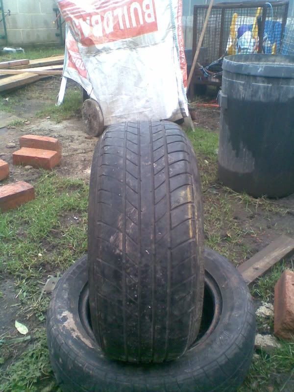

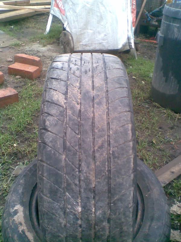

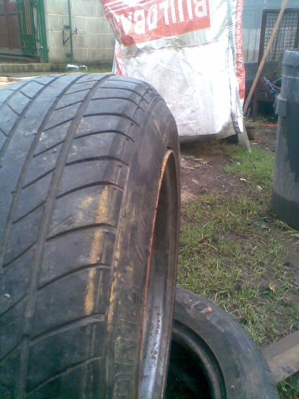

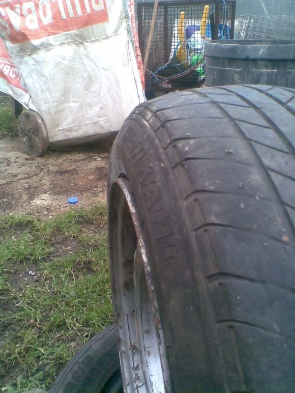

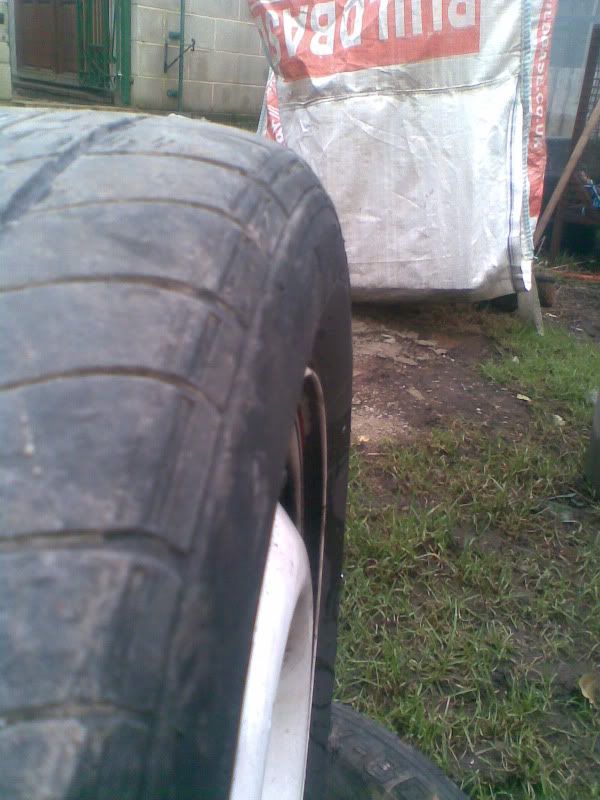

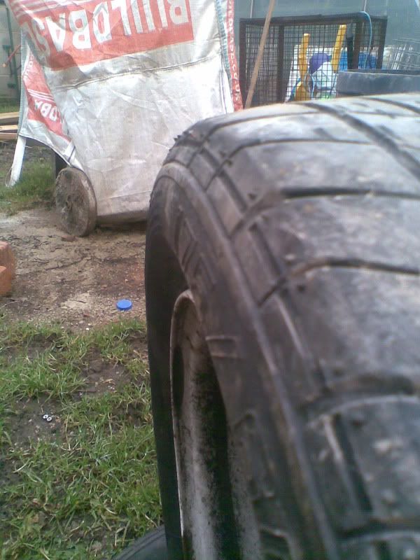

as promised, both tyres are 175/60/13, the tyres i will be fitting are 165/55/13,
they are in pairs, 5" then 7" respectively for comparison, just note that the 7" rim is not pumped up as there is no valve in the rim, if it were blown up it would seat better,
sorry for crap pics there off my phone

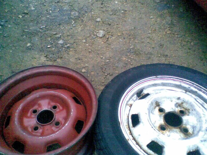

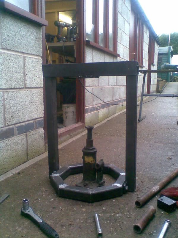

ive been experimenting with a steel wheel i had spare, ive always wanted banded steelies, minimum 7 inches.
done lots of research on the subject and done lots of practice welding,
anyway this is what i came up with, its the standard 5" steel cut in half, the center taken out and a 2 inch band welded in.
i did a few calculations on paper at roughly what i wanted the offset to be, i calculated an et+50 on the front would be best, as it is easier to measure from the front lip to the centre i calculated that the "front spacing" needed to be ~35mm.
so i pressed the center back in the now 7" wheel to get the 35mm, fitted the wheel back on and it looked like this
wasnt impressed, not enough pokey outy, thought, needs another 10mm, back in the press
press in another 10mm.
refit
alot better, could go another 5mm maybe, but ill blow a tyre on at some point and have another look.

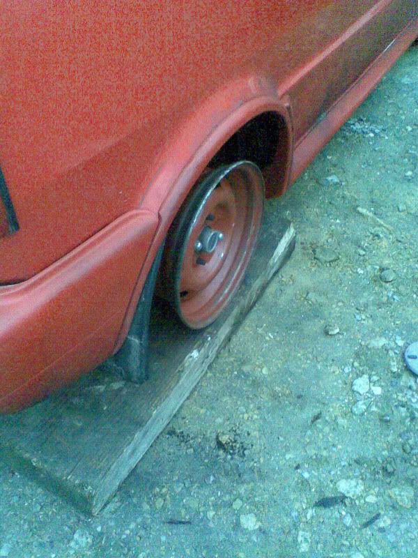

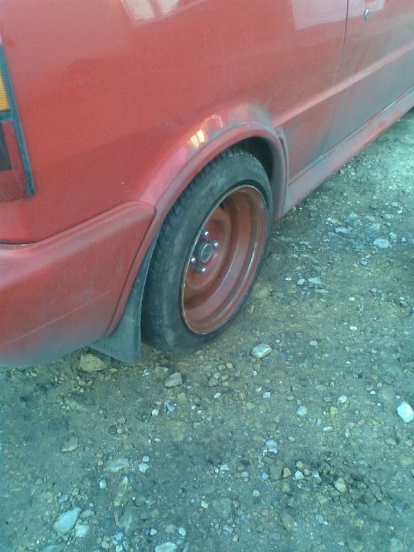

right onto the rear, fitted the same 45mm front space wheel, looked lost in there.
oh that needs another 20mm at least i thought, anyways back in the press
out it came with a front spacing of 90mm
trial fitted that.
lookes better, again could possibly go a bit more, but ill blow on a tyre and re-evaluate at the weekend hopfully.

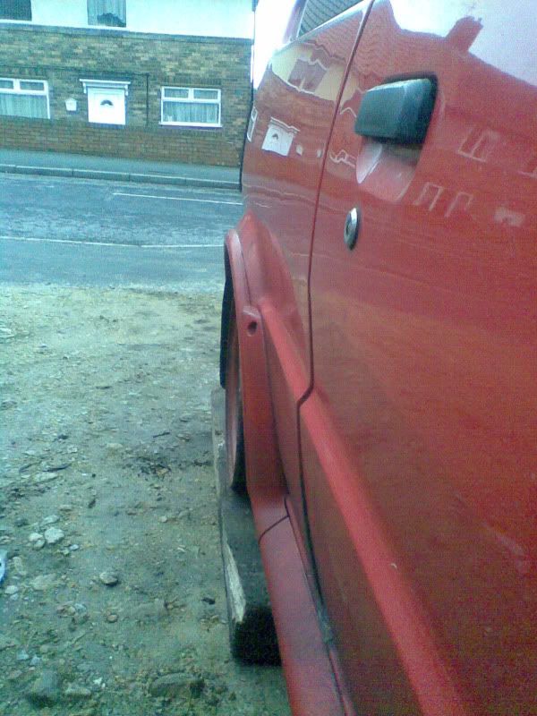

couple of pics of the 'dish' on the back one

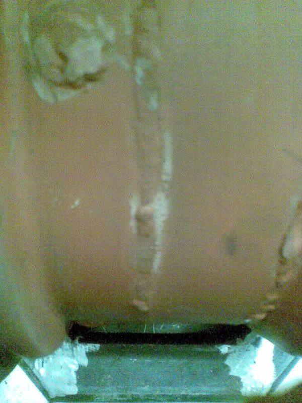

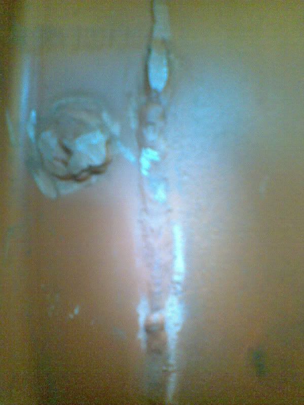

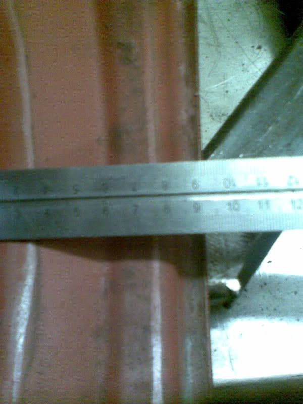

Nice work. You going to show off any pictures of the welding? How did you shape the hoops?
cheers mark, i did get a few pics the night i did the wheel, but it was gettign dark and the pics were all grainy, didnt realise till a came to trancser them off last night, and couldnt be bothered to go back out and take some more.
the hoops were tacked in place then seam welded in and out then the beads on the inside were ground flat so the centre woud go back in.

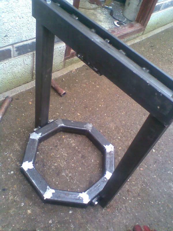

to roll the rings/hoops i made myself a ring roller, almost identical to this one
http://cgi.ebay.co.uk/Flat-Bar-Box-...emQQptZLH_DefaultDomain_3?hash=item3a5755f775
ill try and get some pics of that tonight too.

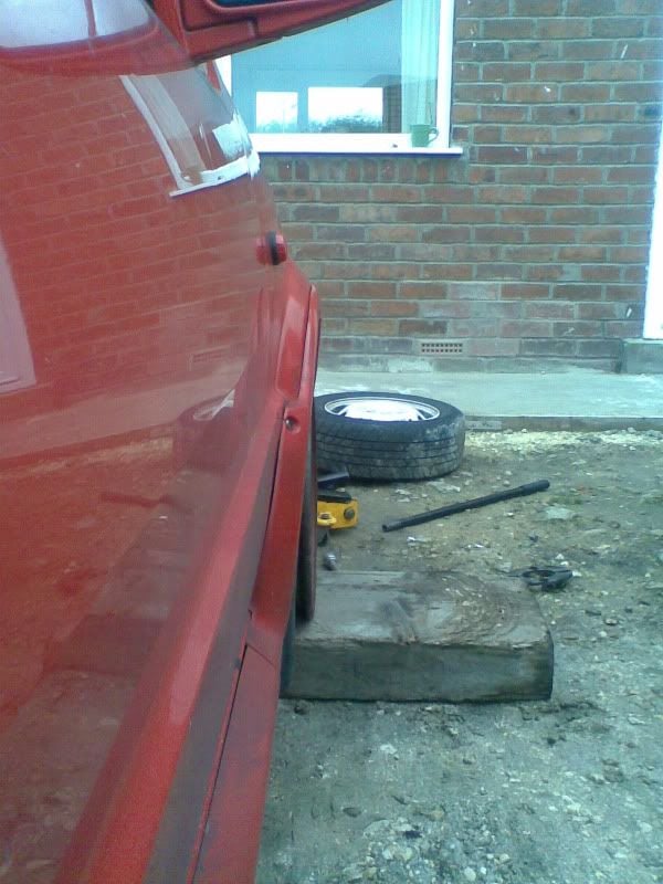

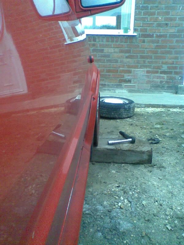

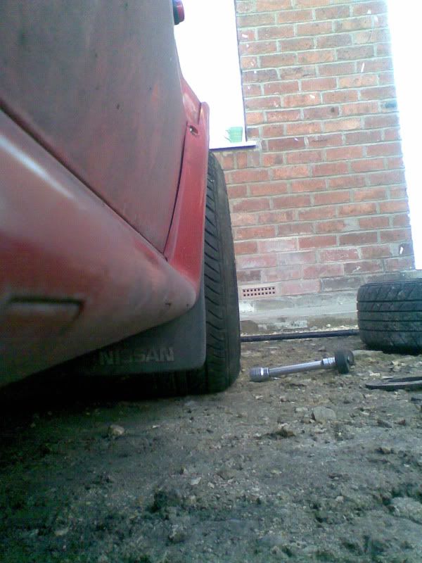

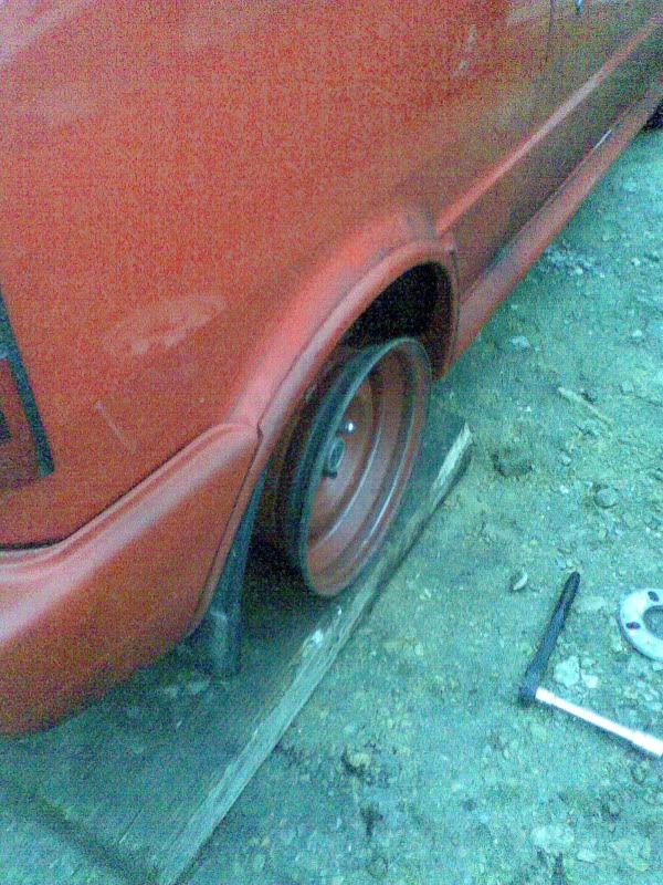

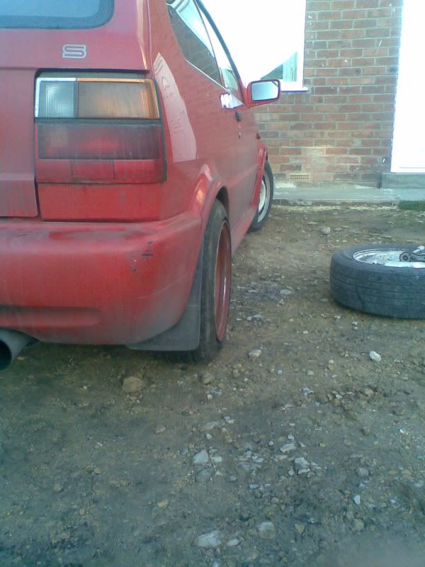

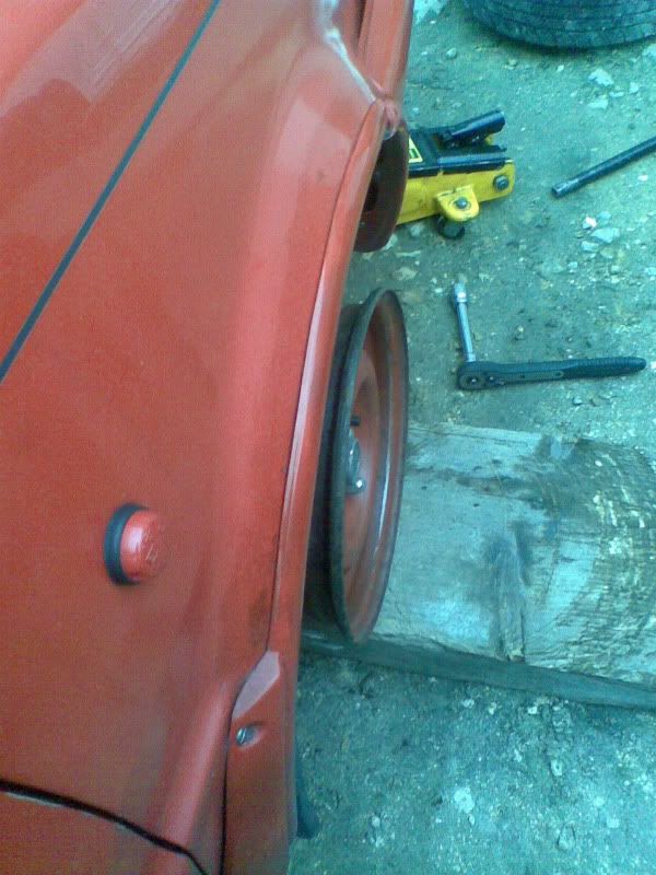

altered the offset of the rear wheel by 5mm as mentioned before, blew one of my 165/55/13 tyres on and had a trial fitting.
unfortunately it sticks out a little far it catches the arch lip and will rip the plastic trim off, i think it needs to go back in about 10mm.

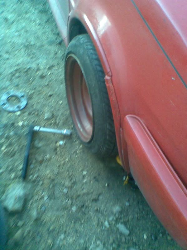

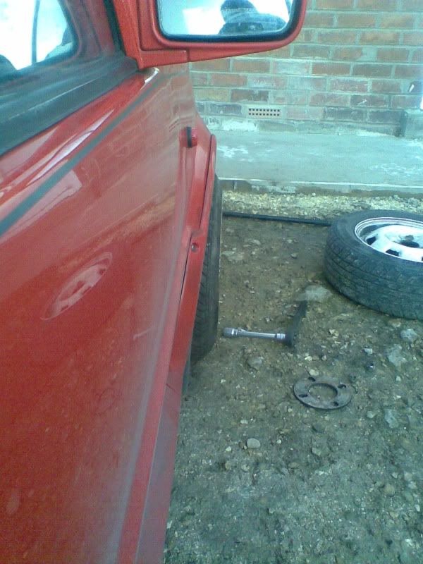

i then tried the same wheel on the front
sticks out a bit far for me but doesnt catch at all, so atleast i know i can make just one spare and hav it as universal fit.

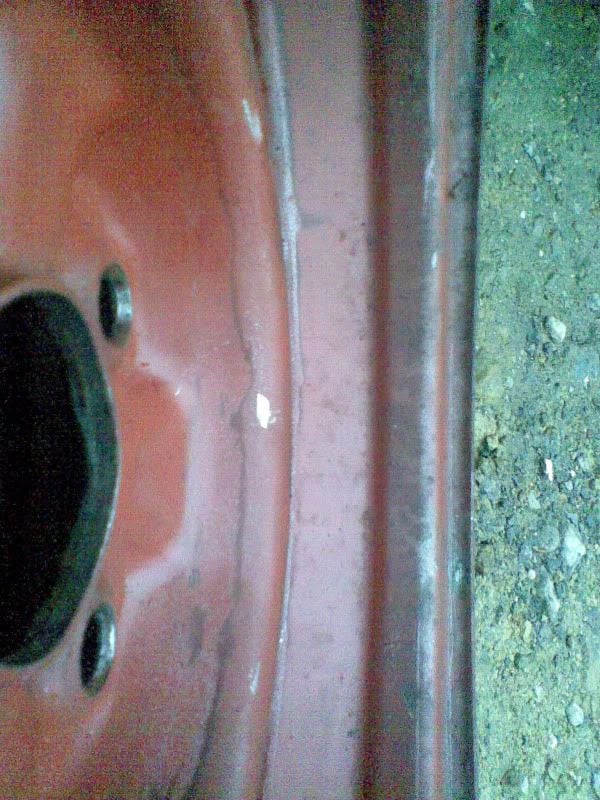

couple of the stretch involved
not great pics but a couple of the welding

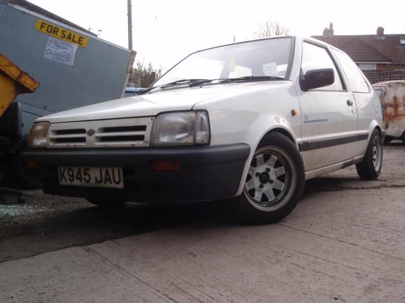

looks good! (Y) now for some criticism: wash your car! lol hate to see a nice car being filthy lol good luck (Y)
im on for a winner if the only criticism is to wash my car, lol.
this time of the year you wash it today, it needs doing again tomorrow, plus when i wash it shows up all the work that needs doing on it.
i know but it looks good clean! even for an hour lol
Nah, that's perfect, the tyres look just right, not too much inner lip & nice rounded stretch. Mod the arch lip not the offset! I would absolutely love to see this rolling on staggered offset banded stock steels, with exactly that tyre/arch relationship front and rear. And an inch lower without the plastic arch lip I'd be in micra nirvana!
Got that rolling on those wide steels and you sir will be a hero!
the plastic arch extension goes under the arch lip where ist supposed to fasten on with a screw, my arches are already rolled (hammer job years ago? so its only really the arch extension thats stopping it, as i want to keep them, as they go with the bumper and sideskirts, i think what ill do it modify them and then stick them on so there is no underhand with the arch.
