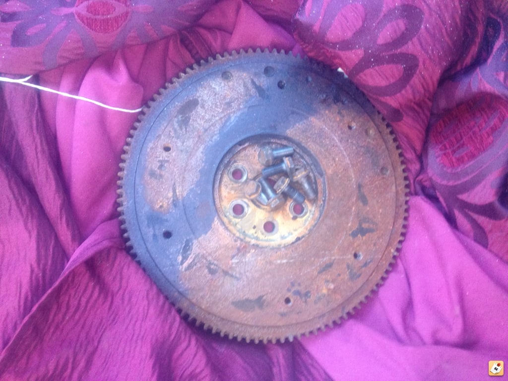

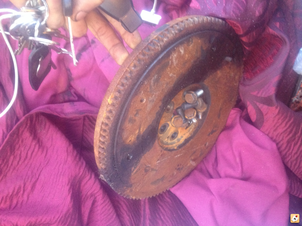

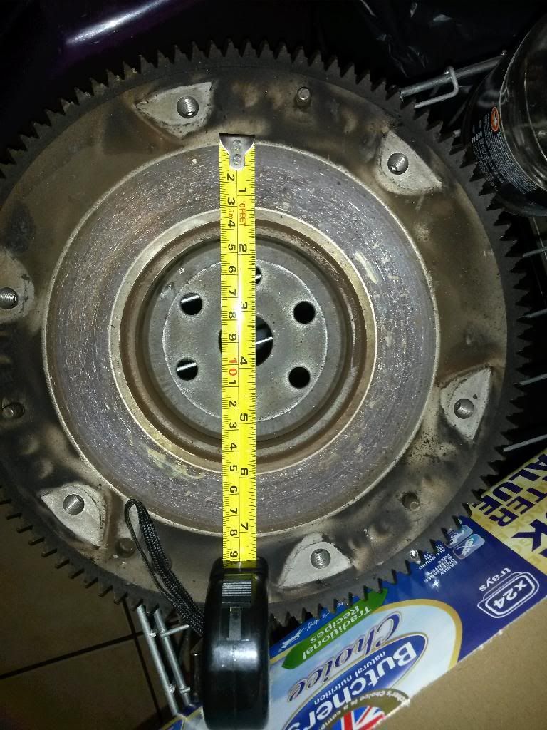

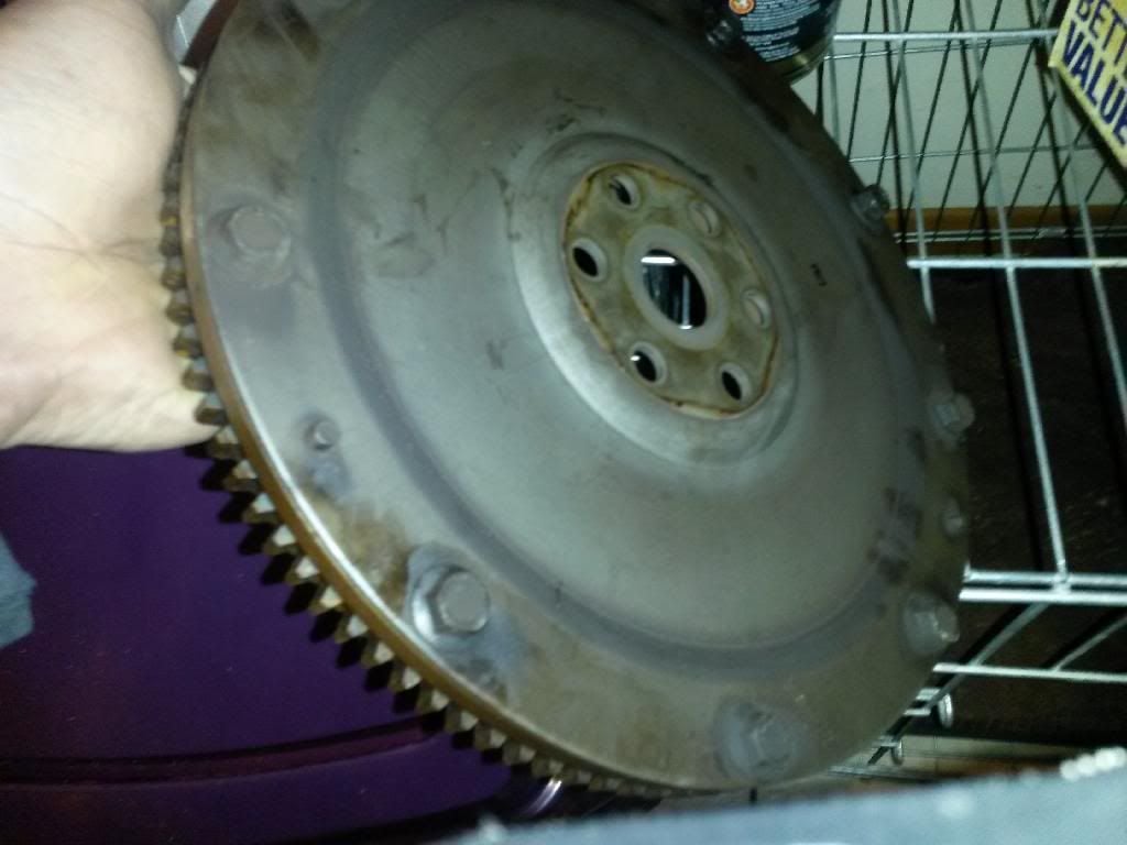

Ok today I have picked up my flywheel guessing it's for the 1.3 dizzy ?
that's fine Polly will it need a skim ? Can't I just clean it up with wet sand papper
If you don't skim you'll shred the clutch material and your clutch contact will be minimal and you'll not be able to put much power through it...

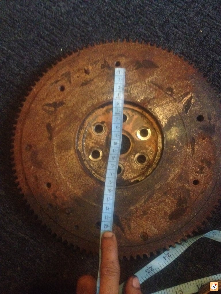

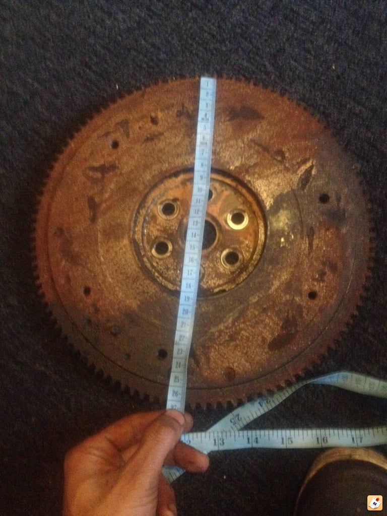

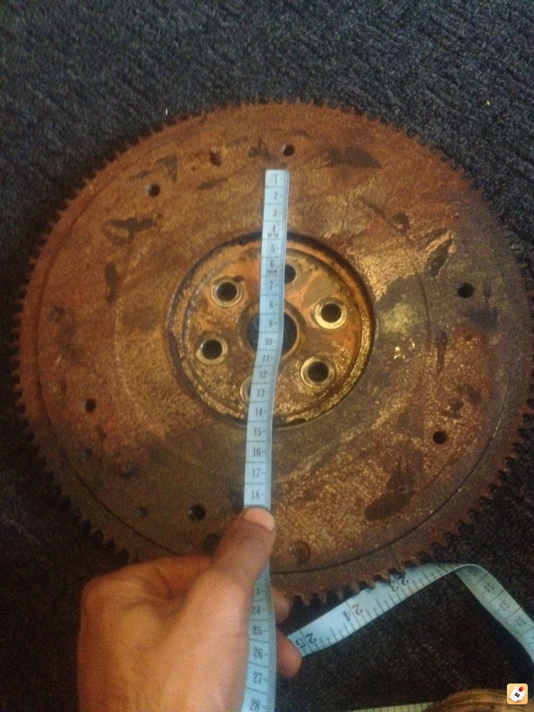

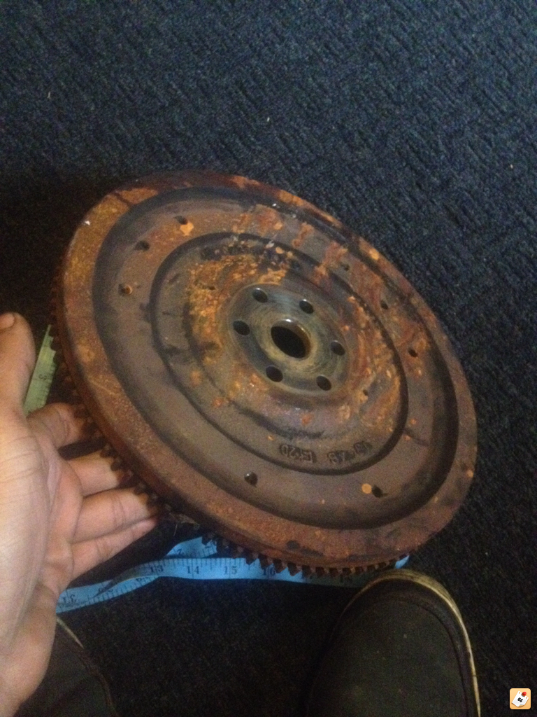

How can I tell frank coz theses scrappy ppl don't know there flywheel they just gave it saying it's from a 1.3
In the first pic you uploaded you can see a slight imprint/recess.
I would guess measure that across the middle. A few mm out shouldn't matter :)
