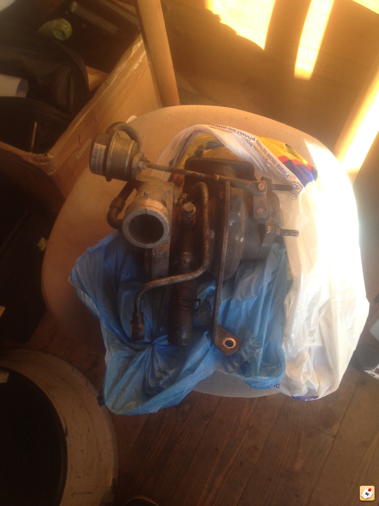

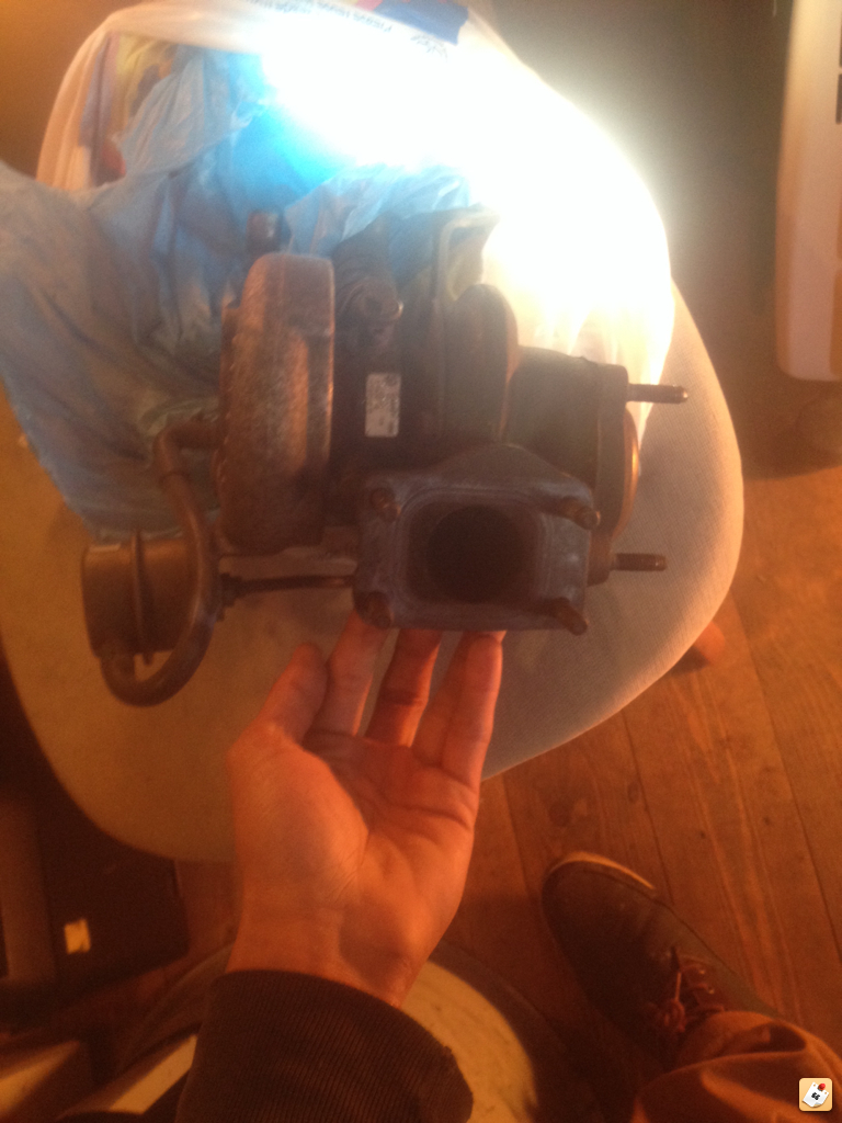

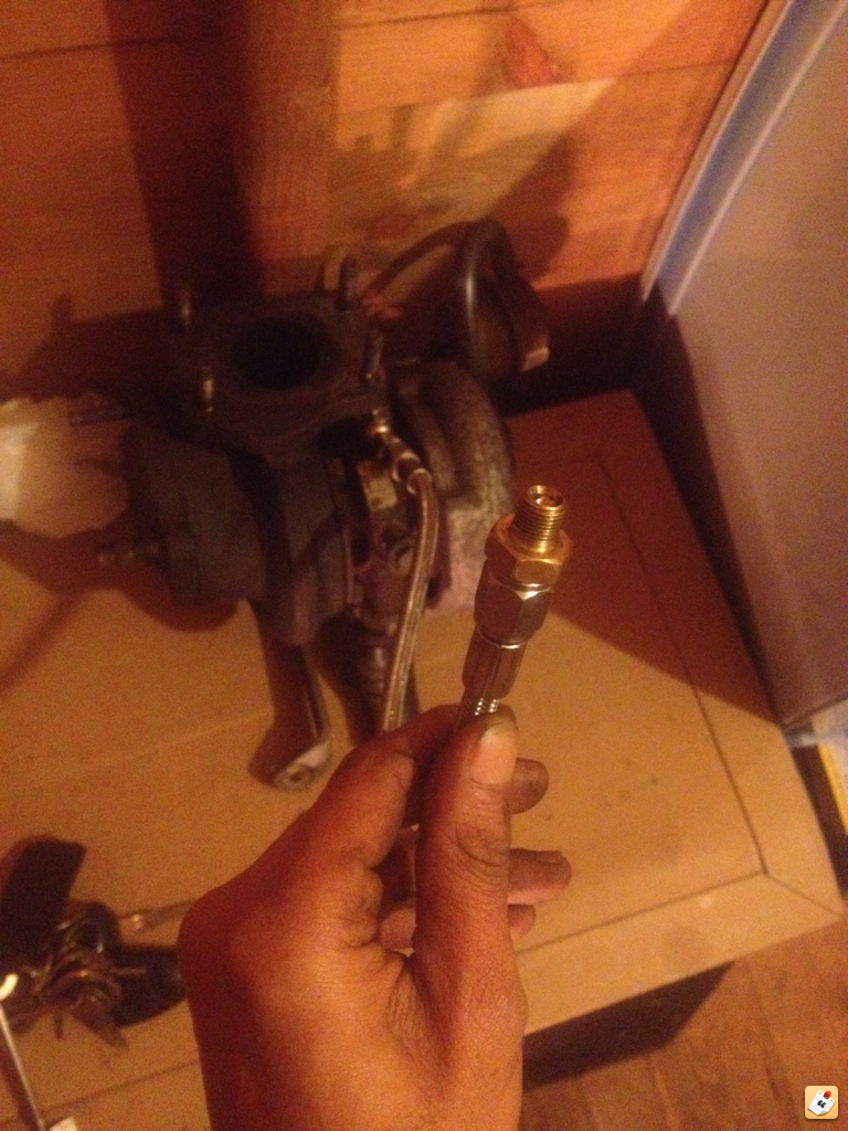

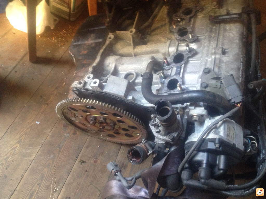

Here is my t25 turbo just getting all biTs together, Manifold as usual cut and tig weld a t25 flange on, I have bought a cg13de engine from eBay at 100 pounds claiming 48k low mileage, so took it, turbo cost me 98 pounds with 6 months warranty, and turbo oil line at 13 pounds, will get it all on engine then soruce a cheap 1.0 Micra

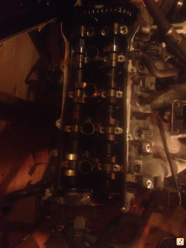

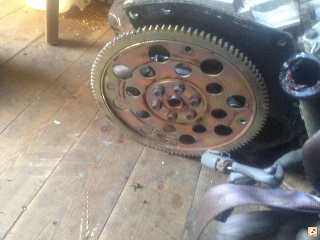

. After checking the engine it looks like a low mileage
by looking at the flywheel looks new, and not as rusty
OP
OP
Azzydot
Yeh that's wat I was thinking I will take it apart Tommow and inspect the cams and pistons, and start it from there

Is the auto engine cg13 ok ? and I haven't got the car yet that's a good thing, can I just get a 1.3 flywheel and manual gearbox and bolt it on? Does the engine fit in the manual micra as a swap with same mounts ?

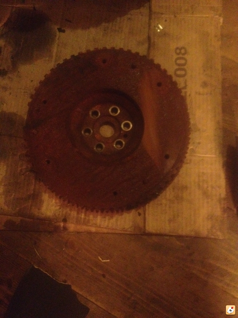

Ok after getting a flywheel to change over my auto engine I compare it and it's same size from auto and 1.3 flywheel, paid 25 pounds from scrappy and trying to sand of the rust while I was at it. Took 2 14mm nuts and others kinda rounded a bit so gona try a new socket 14mm with a long breakers bar might help. Cams will need taking off and cleaning them, anything I need to know if am doing it wrong ?

Frank I told scrappy I need 1.3 flywheel that's wat they had and gave ? What is the Diffrent ? Will a 1.3 gearbox fit on ?

frank what flywheel will I need which model will fit my cg13 as I will want 1.3 gearbox in, I can go Tommow and change the coil pack flywheel for Diffrent one,

i know, but if the 1.0 is a pre-facelift the running gear is different, if its a facelift then the 1.3 g/box and f/w will fit

Then you need a 1.3 non-coilpack flywheel, assuming the gearbox is from a non-coilpack car
OP
OP
Azzydot
right now I get you, so the flywheel I got is no good
and the flywheel I got today is from scrappy as frank said it's off a coil pack, so i need a none coil pack flywheel is that right ?
