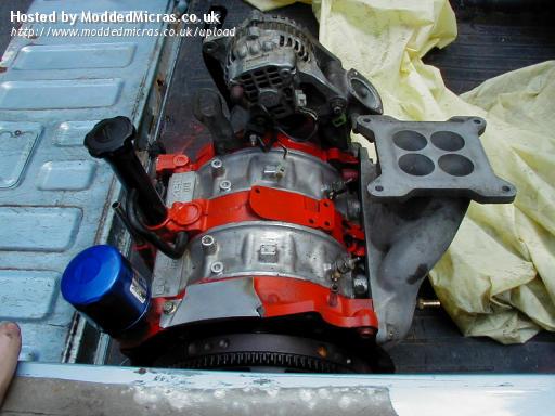

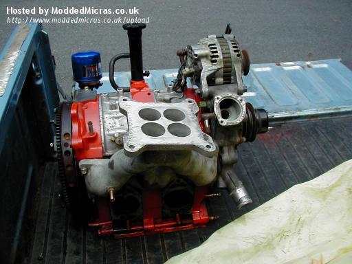

DoomPixie said:looks promising though i must say. depends on what size carbs you can get, if they are stupidly oversize then you can actually start looseing power because of it. or so ive been told, personally im not sure.
