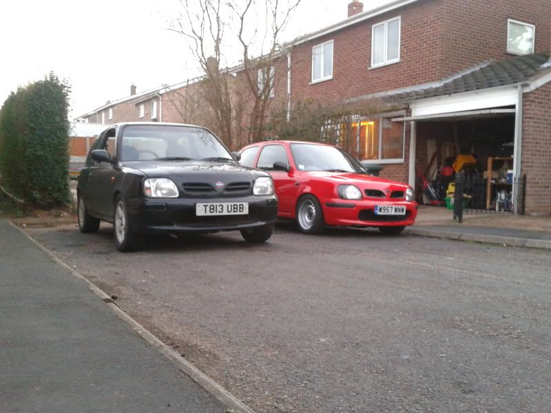

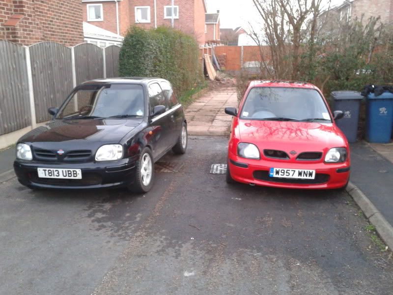

heres a picture of the black weight weenie next too me comparatively tank like red fatty.
Just too spur some interest.
