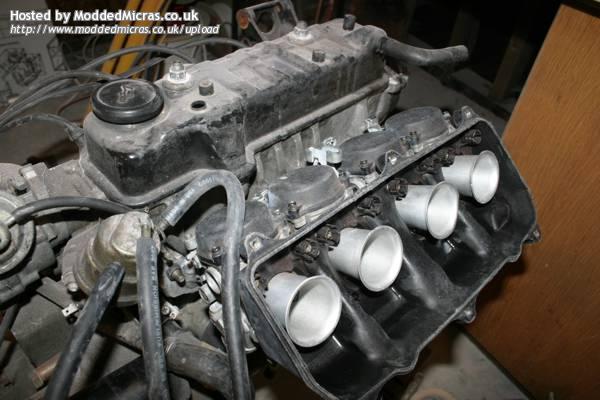

yeah i've seen a inlet manifold almost identical to that on ebay before,
can the original fuel pump flow enough fuel for 110 bhp? are there any clearance issues with the bonnet?
where did you get this manifold made?

i made the inlet myself and there is no clearance probs and the fuel pump can cope,
but you must remember that this is a race engine and not standard to produce 110bhp @ flywheel
when i put the inlet up for auction on ebay nobody was interest in it

how do i insert pics in these boxes and i will put some more pics in

Nice Action.
What else have you had done to the engine?
Reprofiled cam?
Larger Valves? Or are they big enough?
Stronger Valve springs?
What about the con-rod bolts? Are they holding up okay?
Any problems with head gaskets?
Do you run standard oil pressure or higher?
Any information about the rest of the car?
Which box do you use? And how is it and the clutch holding out?
What about suspension setup? Do you use nova suspension? What about anti-roll bars?
Good to see the micra being used for some sort of motorsport at last. How competetive is it?
