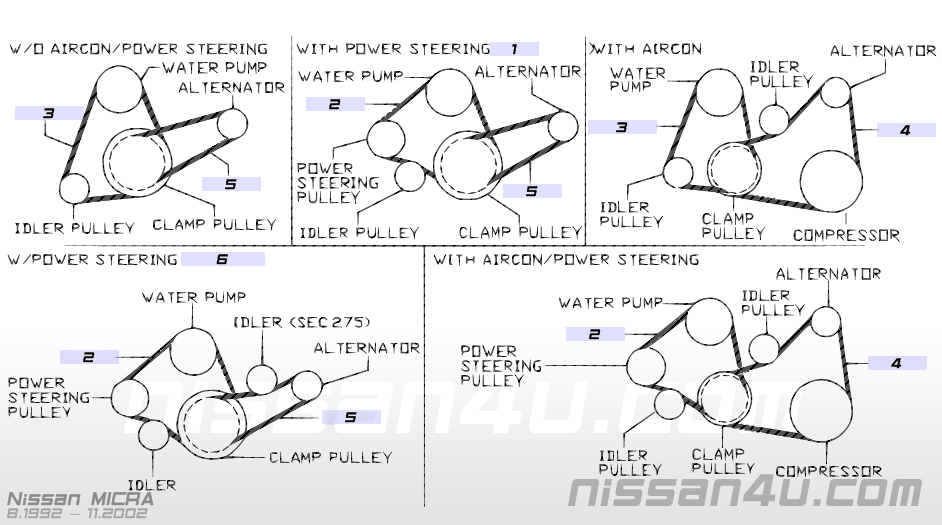

there's normally an idler pulley at the lower back of the engine that tensions the belt as seen in this illustration from nissan4u.com
note the PAS idler pulley Pushes to tension while non-PAS pulleys Pull to tension
