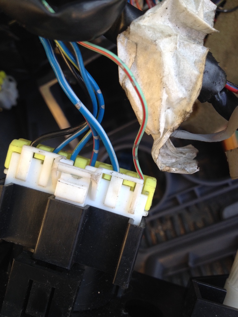

I found the wiper control plug, so jus need to find the heater control stuff thrn
Il be putting in a supercharged cg13, with redline developments ecu
that's it mate it's green \red wire that goes in the Ecu

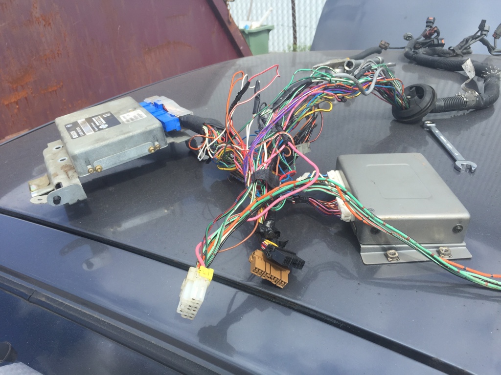

Jus found these
Ecu

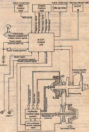

Auto tranny ecu stuff
There's quite a bit then I can chuck out, just gunna take a lot of licking apart I guess
