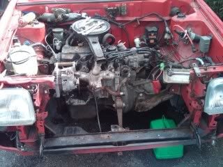

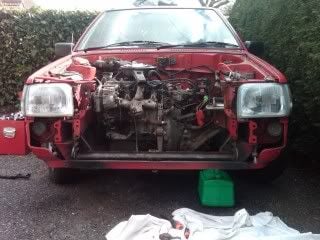

slowly getting there got the engine out sunday managed to drop it out the bottom and slide it out through the arch, inspection with a torch down the ports showed exhaust valve on no.4 cyl only partially sealed shut and no.1 completely off the valve seat and all four inlets where bent open :S will be hopefully getting the engine out of the donor MicRED next week and should hopefully have it in if not running this time next week :)

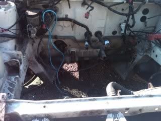

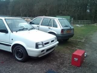

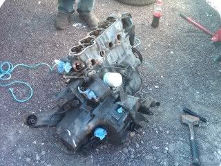

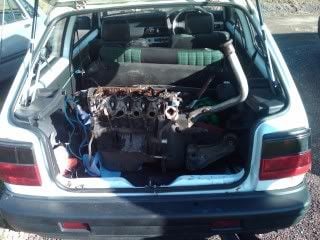

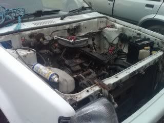

right been a while since an update progress has been slow due to me being adament that we could move/ lift the engine and gearbox by hand proved a little tricky. anyway as pictures show been busy cut the front of the micred donor to get it all out then over to the micrap to put it in started yesterday looking rather puzzled as how to lift it into place cue some playing with a scissor and trolley jack and its in! unfortunately the rear mount get bent when the engine fell over :eek: so took it off over engine and bolted it all up anyway by the end of play yesterday everythings now done just needs some fluids and a battery and fingers crossed should be running :laugh::laugh: started on a new grill today and spraying the mirrors should hopfully putting a decent exhaust on soon and then wait whilst i have the sill and paint redone and should be on the road again :) will be glad to have it back as a 1.2 nova just doesnt cut it like a micrap.
old engine
somethings missing
here it is
saw meets micred
how it stands now :D

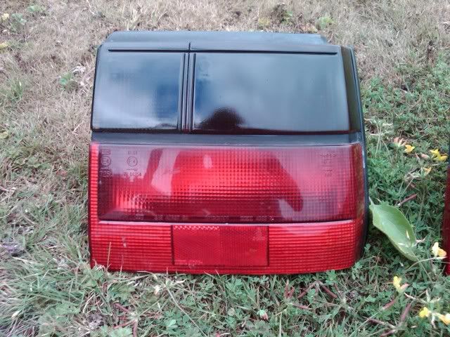

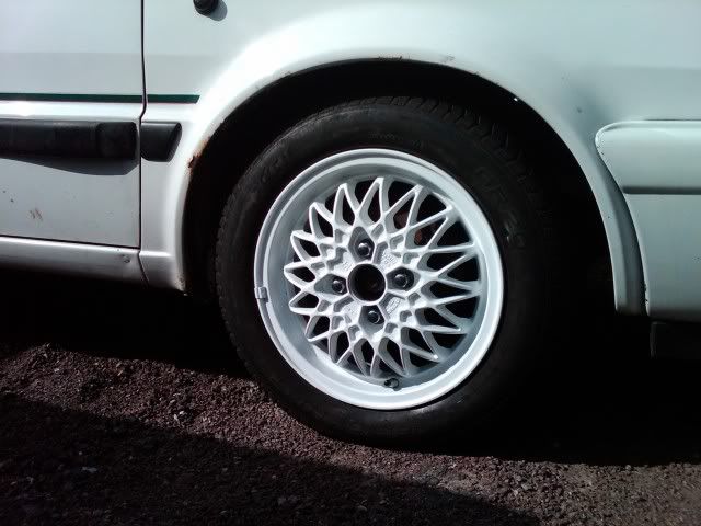

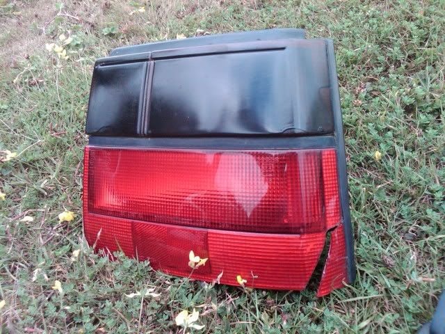

more progress put the alloys on today but i messed up :( i test fitted them on the front where they fit fine, but on the back they dont sit on the hub properly back to the drawing board also changed the broken rear light with decent ones also retinted them and did them much much better. also stripped out some more trim. next up is to get the rear wheels to fit, take it to a friends to get sill replaced then in for the mot then to the bodyshop for finishing touches :)
old rear light note rubbish spraying :(
mucho better!

well little progress. refurbed the steels as the alloys need serious work to fit, will probably give them a blow over in white at some point. also got the exhaust on although i couldnt get the 4-2-1 to line up and need to get it mot'd so have decided to leave the exhaust standard. all i need to do now is weld the drivers side sill and will be back on the road.

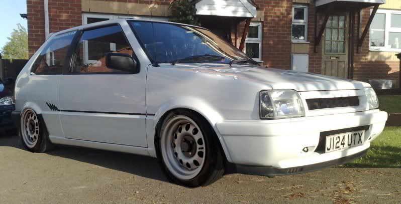

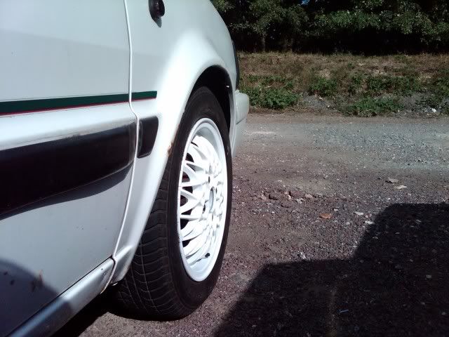

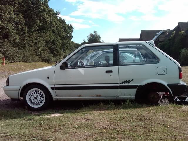

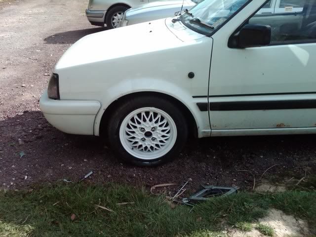

got some new wheels for it apparently they where off a k11 but match the 10 perfectly they where listed as 13x4.5 and was a bit worried about going narrower but when they arrived turned out to be 5.5j so win for me they need lower pro tyres and a blow over in white but im pleased. ill put it in for the mot in the next couple of weeks. i know its going to fail due to the drivers sill but at least ill know if theres anything else that needs doing as it hasent moved since january! once its t&t plan is to spray rear bumper fit some sunny zx box skirts ive got and remove any rust and spray . once thats done ill look into fitting the rear arb and 4-2-1 again. anyway pictures (please excuse the dirt lol)
^ need to sort the rust on this door and a patch of primer on the wing
^ will body colour the bumper and might fit an import plate and move the boot nipples inwards
^ have got a completely open mouth grill to fit and square plate
^ this side needs the most work sill needs replacing as does the front wing and bump strip
i'm confused with the pictures...
A few posts back it was looking clean de trimmed lowered with fat golf steelies on it??
...probably me being dim!
