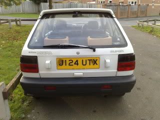

more progress put the alloys on today but i messed up :( i test fitted them on the front where they fit fine, but on the back they dont sit on the hub properly back to the drawing board also changed the broken rear light with decent ones also retinted them and did them much much better. also stripped out some more trim. next up is to get the rear wheels to fit, take it to a friends to get sill replaced then in for the mot then to the bodyshop for finishing touches :)
old rear light note rubbish spraying :(
mucho better!

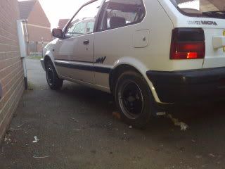

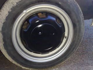

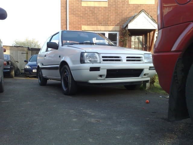

well little progress. refurbed the steels as the alloys need serious work to fit, will probably give them a blow over in white at some point. also got the exhaust on although i couldnt get the 4-2-1 to line up and need to get it mot'd so have decided to leave the exhaust standard. all i need to do now is weld the drivers side sill and will be back on the road.
got some new wheels for it apparently they where off a k11 but match the 10 perfectly they where listed as 13x4.5 and was a bit worried about going narrower but when they arrived turned out to be 5.5j so win for me they need lower pro tyres and a blow over in white but im pleased. ill put it in for the mot in the next couple of weeks. i know its going to fail due to the drivers sill but at least ill know if theres anything else that needs doing as it hasent moved since january! once its t&t plan is to spray rear bumper fit some sunny zx box skirts ive got and remove any rust and spray . once thats done ill look into fitting the rear arb and 4-2-1 again. anyway pictures (please excuse the dirt lol)

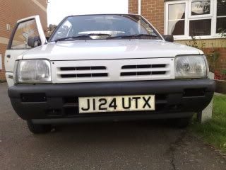

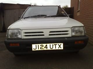

^ need to sort the rust on this door and a patch of primer on the wing
^ will body colour the bumper and might fit an import plate and move the boot nipples inwards
^ have got a completely open mouth grill to fit and square plate
^ this side needs the most work sill needs replacing as does the front wing and bump strip

well to update this neighbour dropped it off late xmas eve with new mot and welding done :laugh: :p unfortunately due to swinton wanting £190 to insure it for the final month of my policy i had to wait untill today when my policy finshed to insure it! my friends been borrowing it occasionally and it runs sweet as a nut and from the passengers seat can tell it handles much better although its eating fuel and seems down on power so something needs adjusting. the other thing is the crappy mixed budget tyres mean the drivers front wheel squeels at the slightest hint of a corner (makes me lol going gently round roundabouts in 3rd and watching everyone go wtf). the weldings been done fairly well once ive removed the surface rust from the welds and painted it should look as new! all thats left now is to finish tidying up the surface rust and get some tyres for the alloys :grinning::grinning::grinning:
