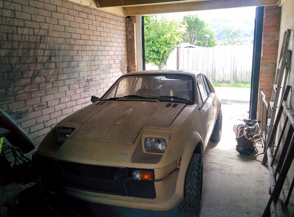

I now have a kit car :) saddly not a Marcos but a Midas, originally built by my father in 82 he sold it in 85 the new owner used it till 88 then stored it away until last month when he offered to sell it to me :-D
