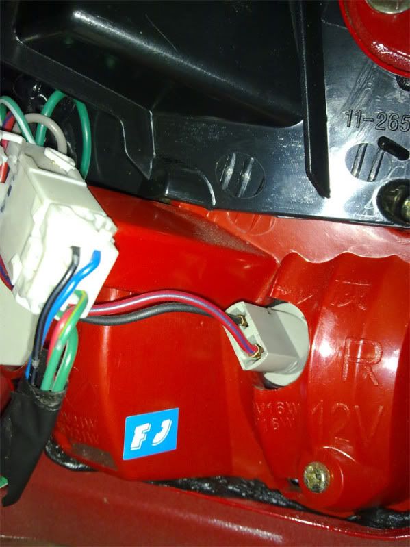

Heres the bulb holder on the back of the LED light:

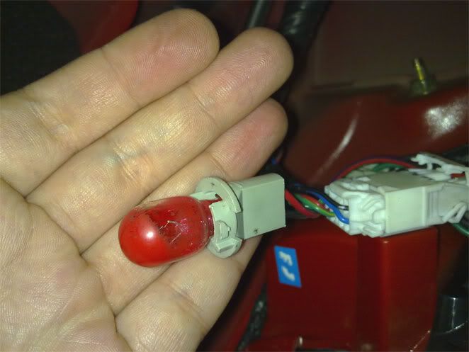

Heres the bulb removed from the LED light:

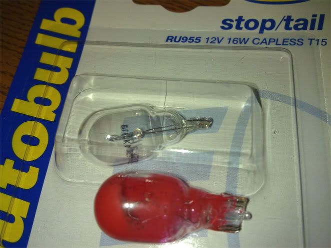

Comparison showing its definately a 955 bulb:

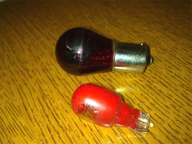

A comparison next to a Red 380 bulb:

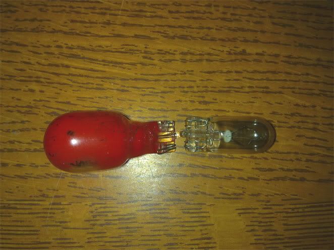

The 955 'head' is bigger than a 501...but the bottom 'spade connector' is the same size:
So yeah...in theory you could use a red 501 :)

Not really a 501 is a maximum of 5w where the 955 is 16w, Cheers for the Pics Chris. Looks like it's going to be a bit harder than I thought. Quick question though, the hole which the 955 goes in, is this hole big enough to withstand a normal 382 bulb? 26.5mm to be precise, lol.
I ask because I can get hold of plastic W2.1x9.5d caps (what the cap spec is of the 501/955) I could try and incoporate an LED 382 bulb and cement it to the 501 cap.
If not I'll tell you now Ring Automotive don't supply the 955 in any other colour.

The 382 is a bayonet type...while a 955/501 is a capless bulb. The hole in the holder for the bulb is a thin rectangle,enough for the capless bulb to push into

I was going to remove the bayonet and plonk a wedge base to it, but if the hole is only small I won't bother.
I have to ask hoodedreeper, did you paint the bulb red? When I bought my LED lights the fog light is clear, so now on the hunt for a 955 red fog bulb.
MicraPRO
Part Of The Furniture
They don't make them :( myself and Jay were both looking for them last year just don't exist. Paint works trust... I've tried all manner of led and nothing is as bright.
