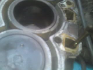

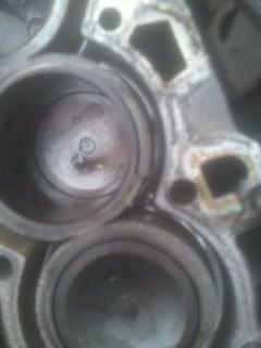

is the liner is ok, but the ally block cracked steve ?
yep in a nutshell frank seems a bit strange to me how can this happen! surely the cast iron is more likely

Since the gasket doesn't seal on that it does seem strange. I have 2-3 blocks though if you want to make me an offer on one.

That is really upsetting Steve. I sincerely hope you can get a solution sorted sometime soon. Personally I would probably get one of Ed's blocks and rebuiild it, trying to fix something like that could end up just being a waste of a lot of money.

sounds like a sound reason frank, never thought if it like that, so you think its the boost thats cracked the cylinder

go bimetal for sure, and get both the head shaved and the block decked to be straight. No matter what it wil be cheap compared to rebuild, motor in and out, run in.
what price were you quoted for the gasket?
does anyone use head studs eg arp to hold the gasket in place tighter? its obviously a weakness
