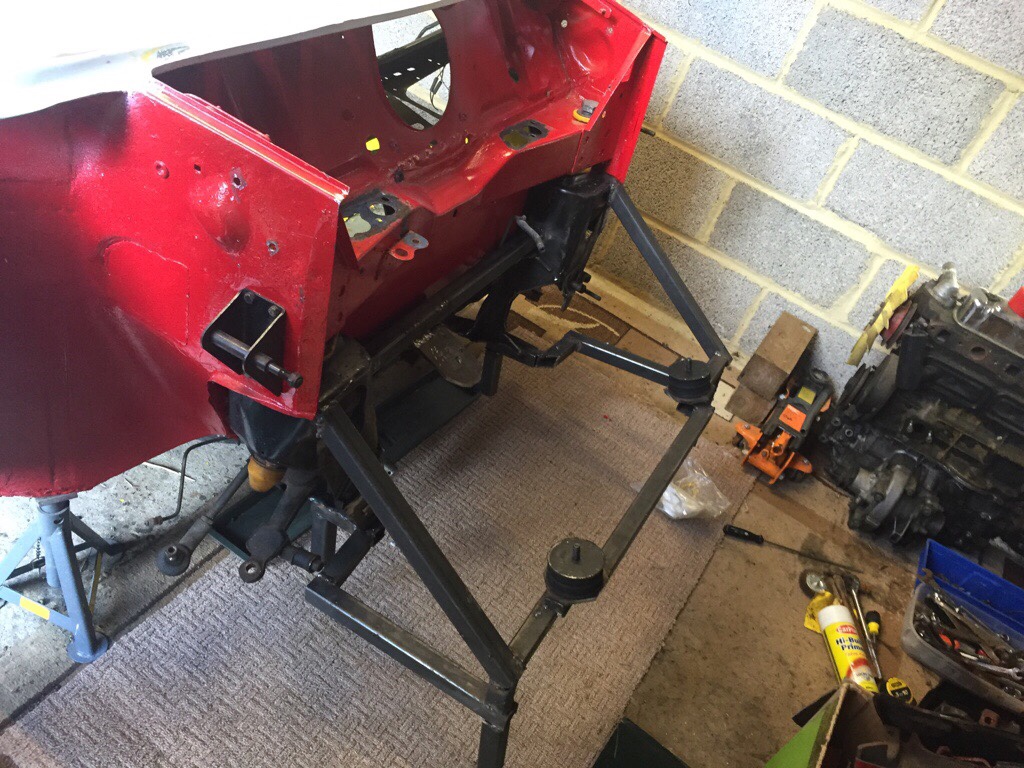

Remove subframe

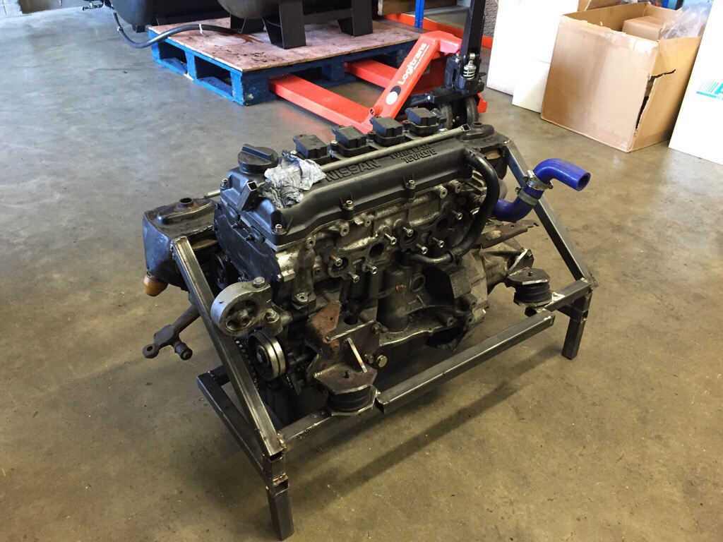

Chop and stock bits on to mount a cg13

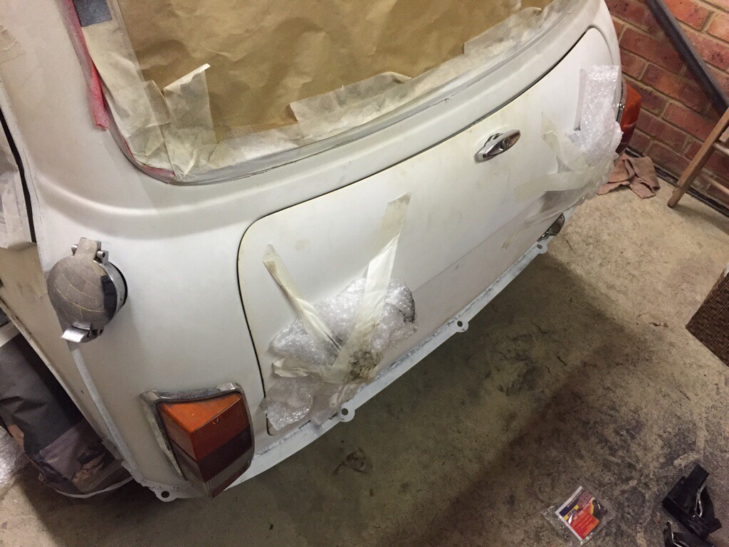

Add boot floor
Repair rear subframe

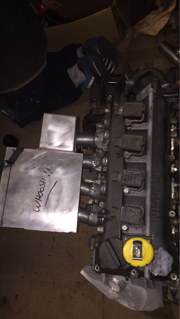

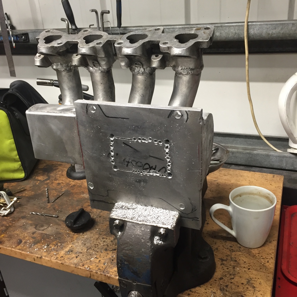

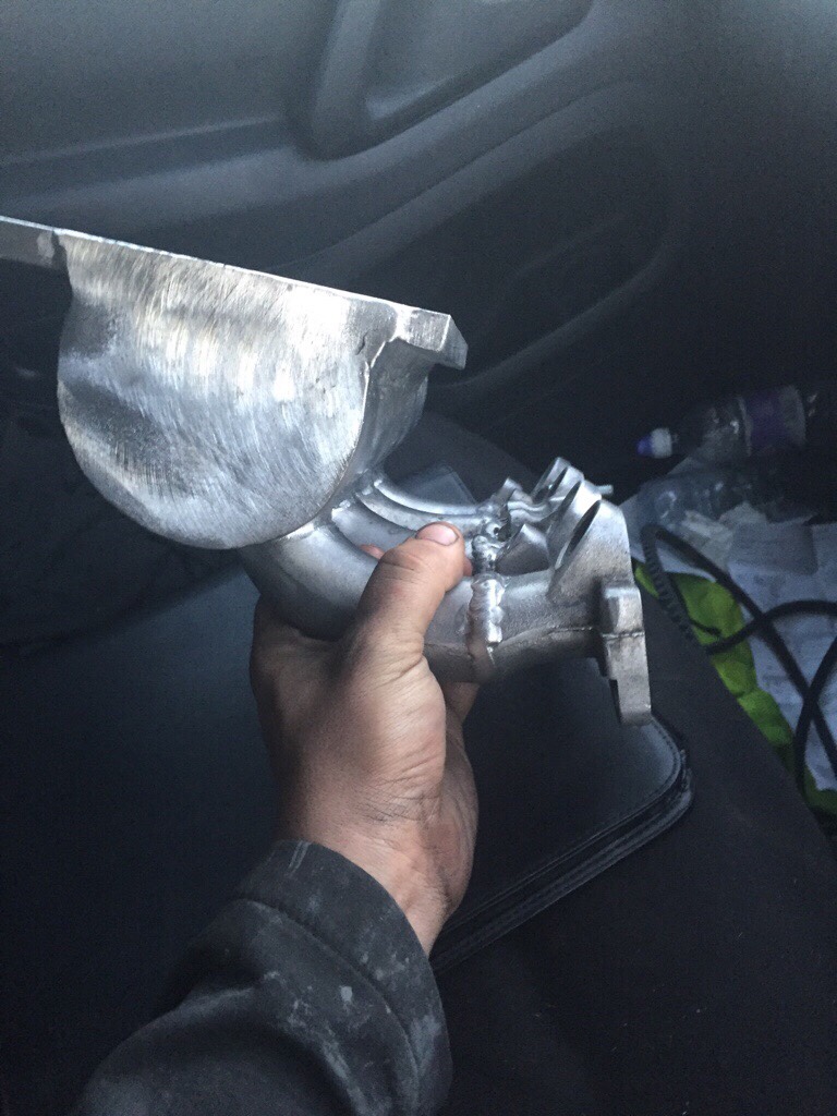

This is how I'm mounting the charger:

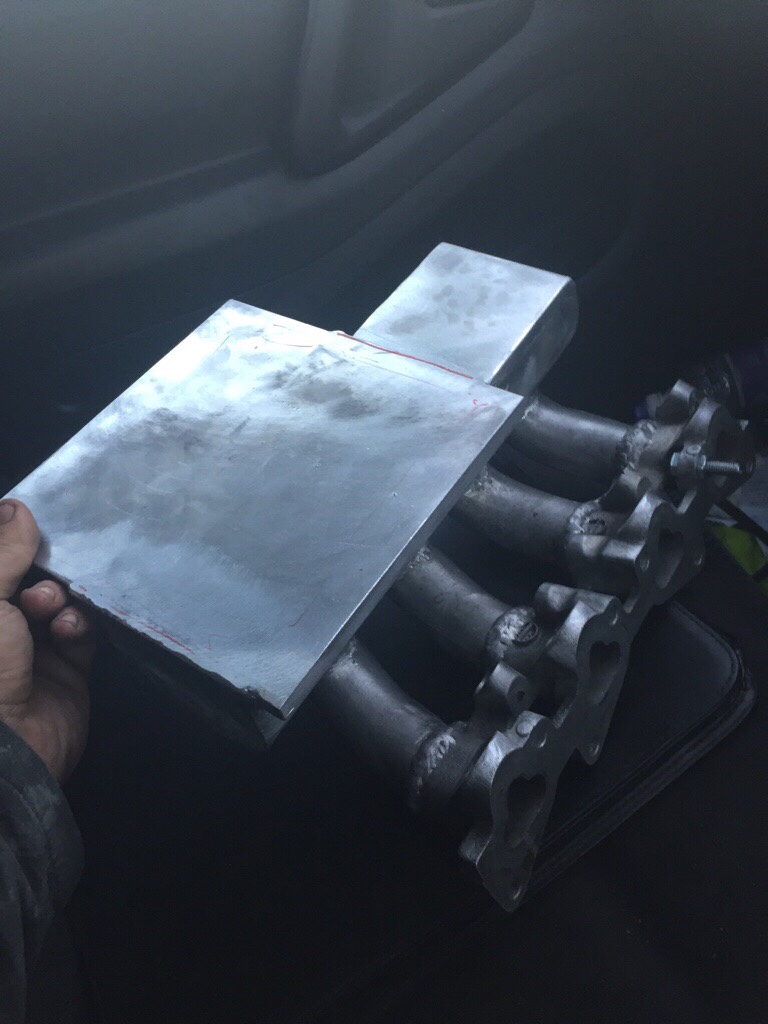

Chop up an old inlet
Bit of big alu pipe
Then stick together

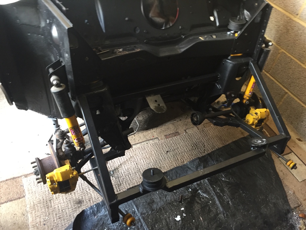

From subframe finished

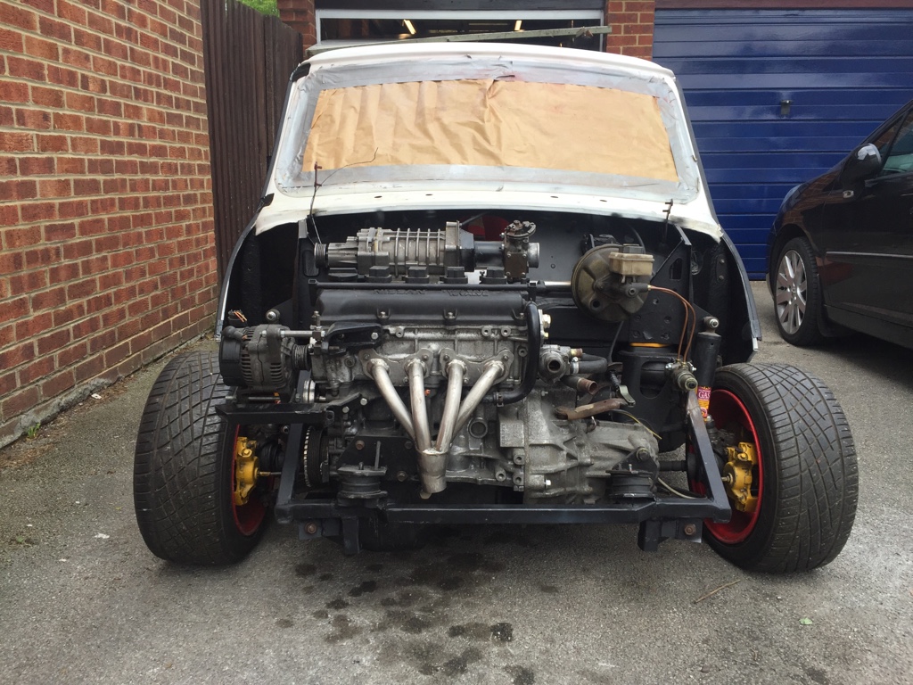

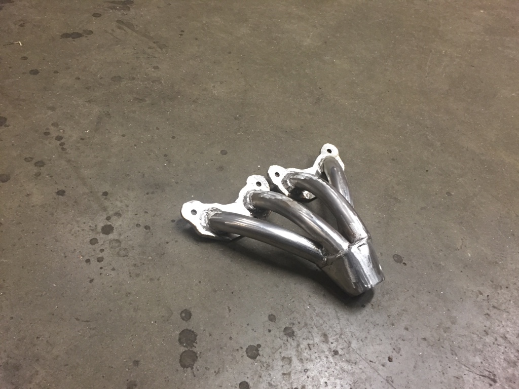

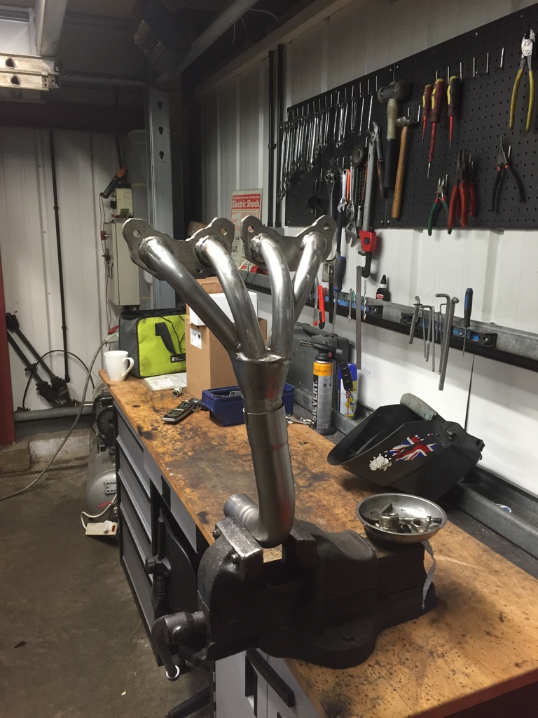

Exhaust almost done
Ooo shiny

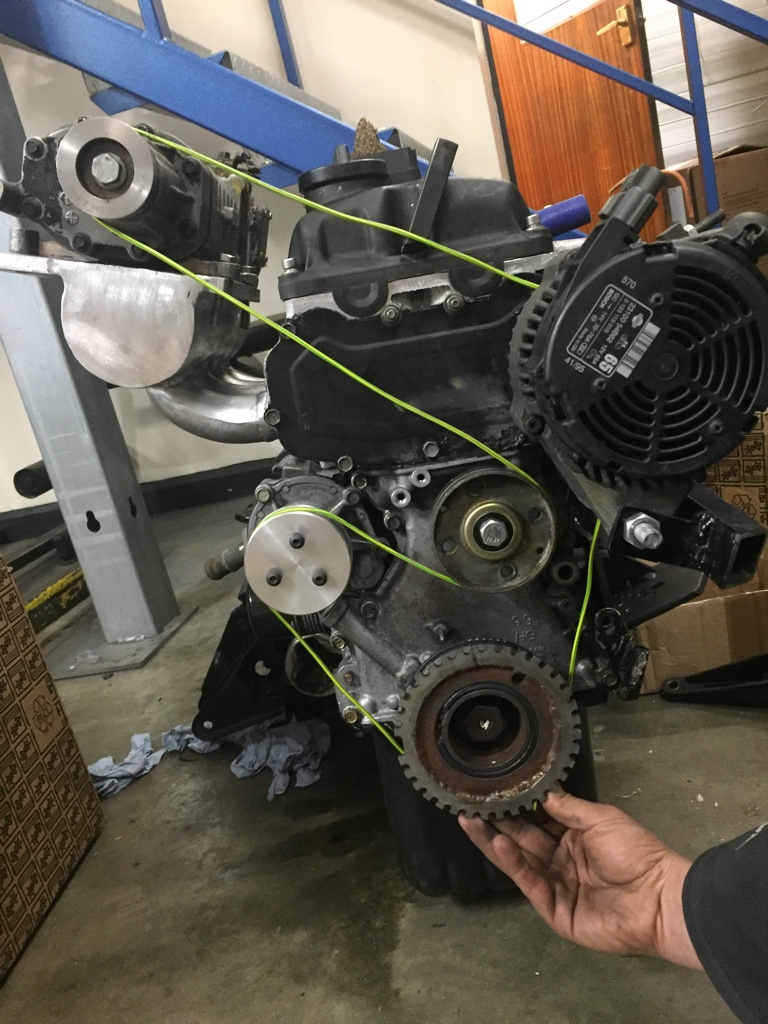

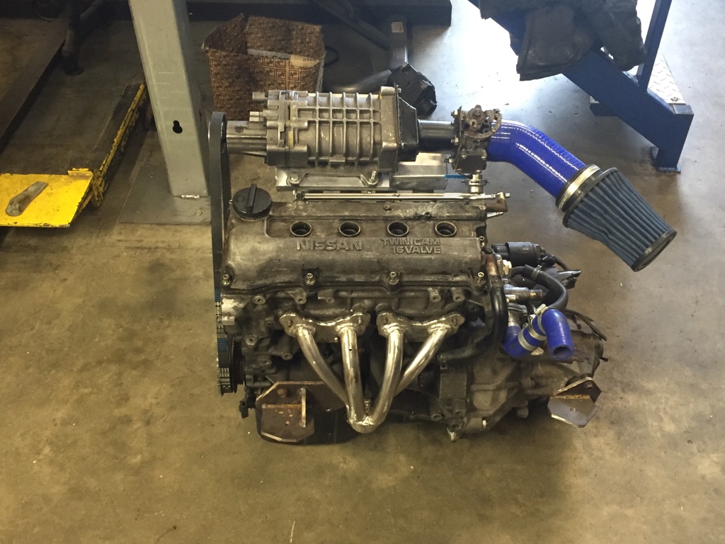

Beings as there's no space, I'm gunna need to run the water pump of the larger pulley on the crank
Will the pump be ok?

I can't use the water pump tensioner coz it hits the subframe, so I'm having a pulley Made that will be inline with the larger crank pulley and hold the wider belt.
The black pulley in the pic is roughly where the alternator will go and tension the belt (albeit tucked in the wing of the car and ran backwards)

Charger pulley aligned, and charger mounted into place, did try cutting the outlet hole in the manifold with a jigsaw, but snapped the blade lol
Just waiting on new water pump pulley to be finished

Cover painted, alternator brackets finished and cutting hole in manifold for charger outlet......massive chore!!

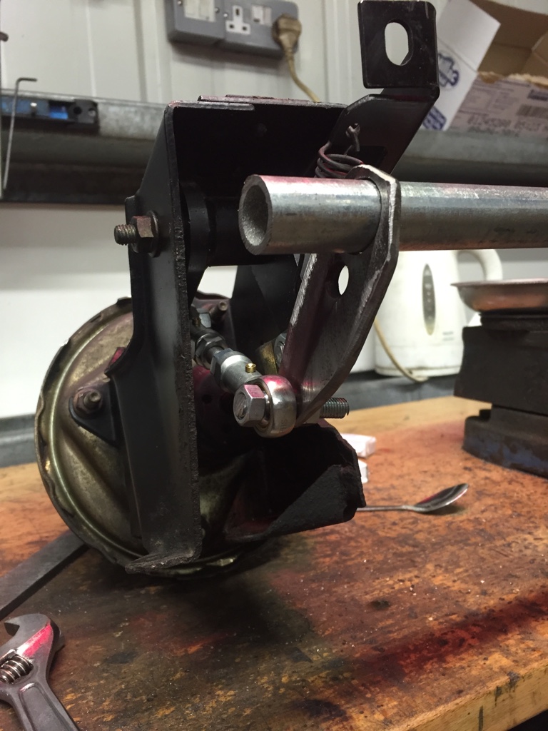

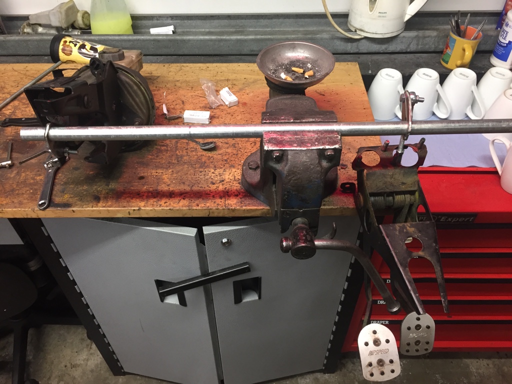

Brakes servo relocation sorted out, operated by my beautiful assistant lol

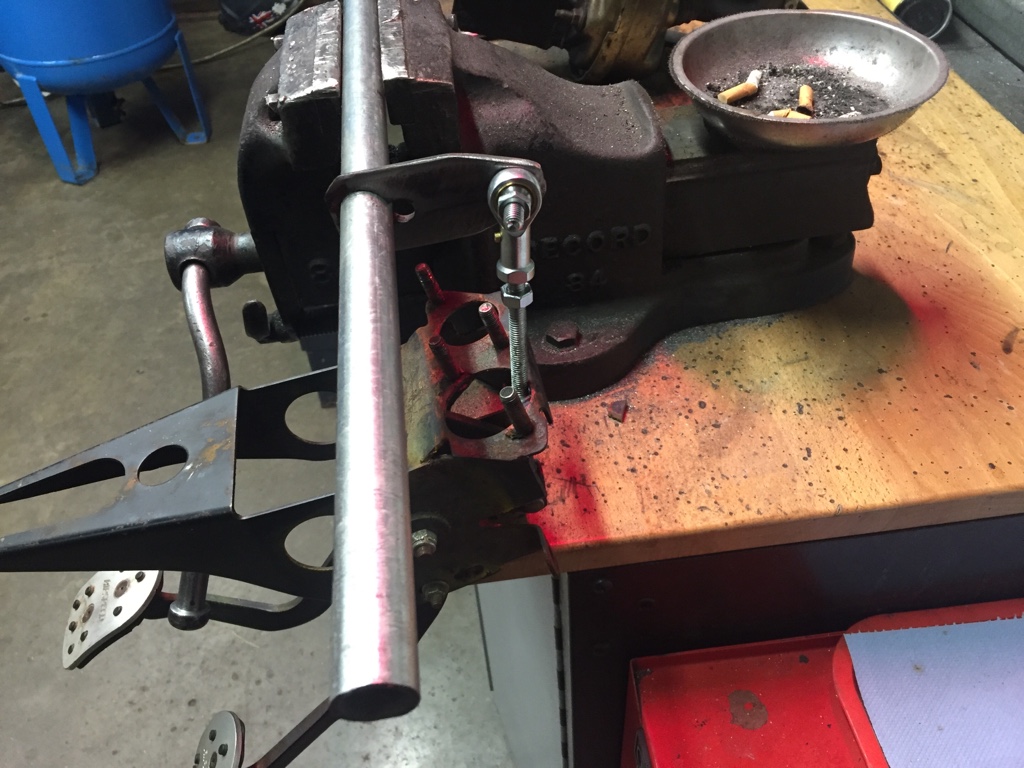

Clutch pedal made too

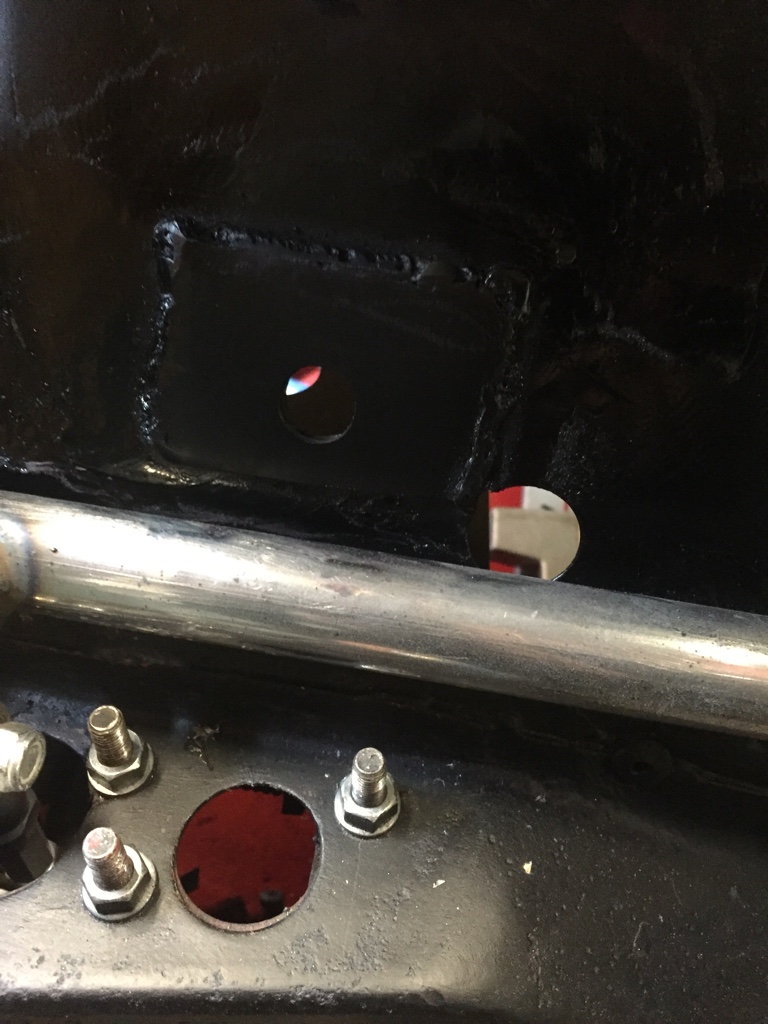

Well, the 16v mini site has had a boo boo, and lost everyone build threads, good job I've kept one her otherwise I wouldn't have a record of anything!!

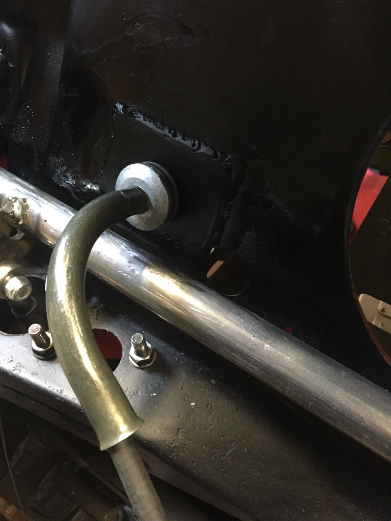

Anyway, clutch cable sorted, used a k10 cable coz it's got a nice bend in it which clears the charger nicely, had to weld on a plate to the bulkhead to stop it flexing......plus I drilled the first hole too big lol!!

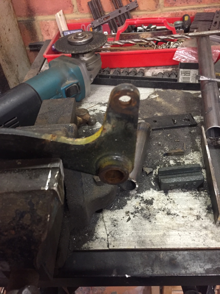

I'm doing the gear stick next, it's a cg10 stick
Is there any sort of rubber bush I need to attach to the car
All I've got is the gear stick/selector/steady bar, I bought it of eBay so didn't get s chance to see how it's mounted
I used one of the small mini rubber cotton reel exhaust mount rubbers on the back of the gearshift arrangement with a bracket picking up 2 of the three bolt holes I found in the tunnel (probably from remote/rod change).

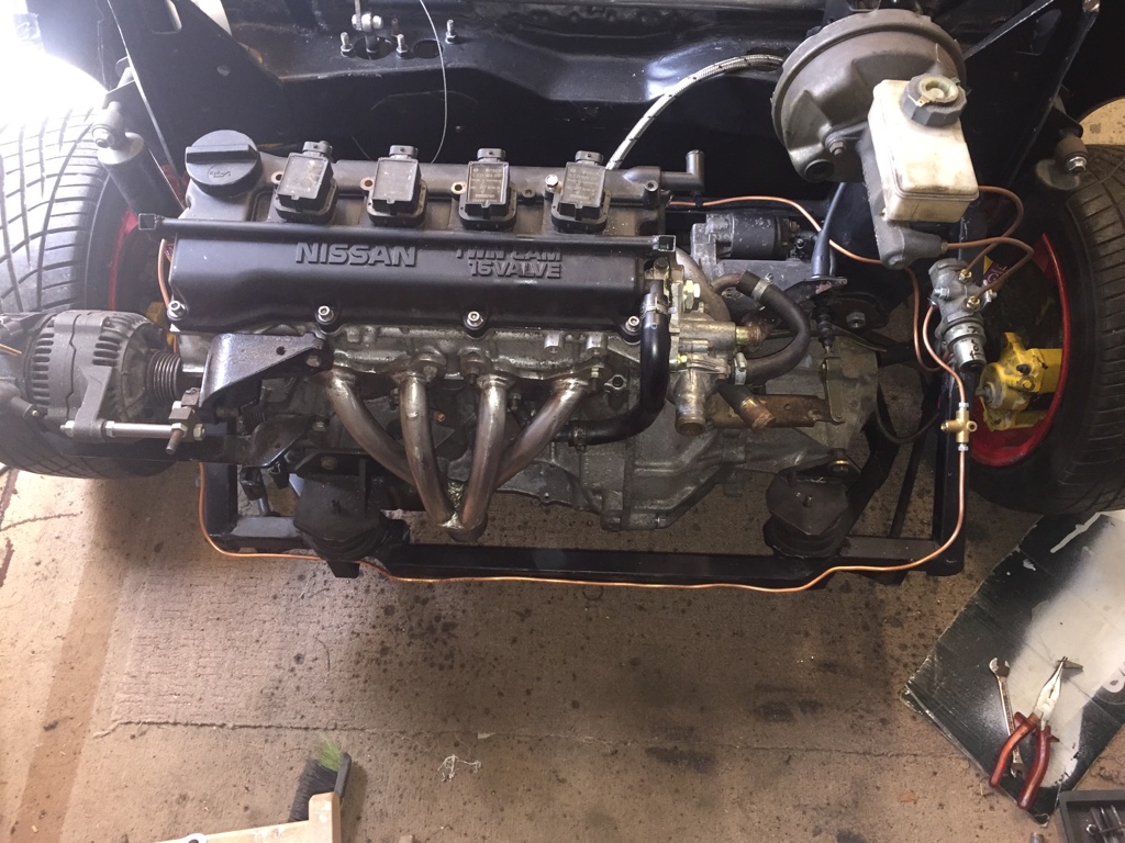

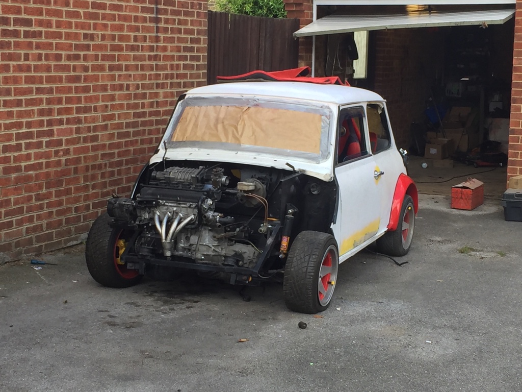

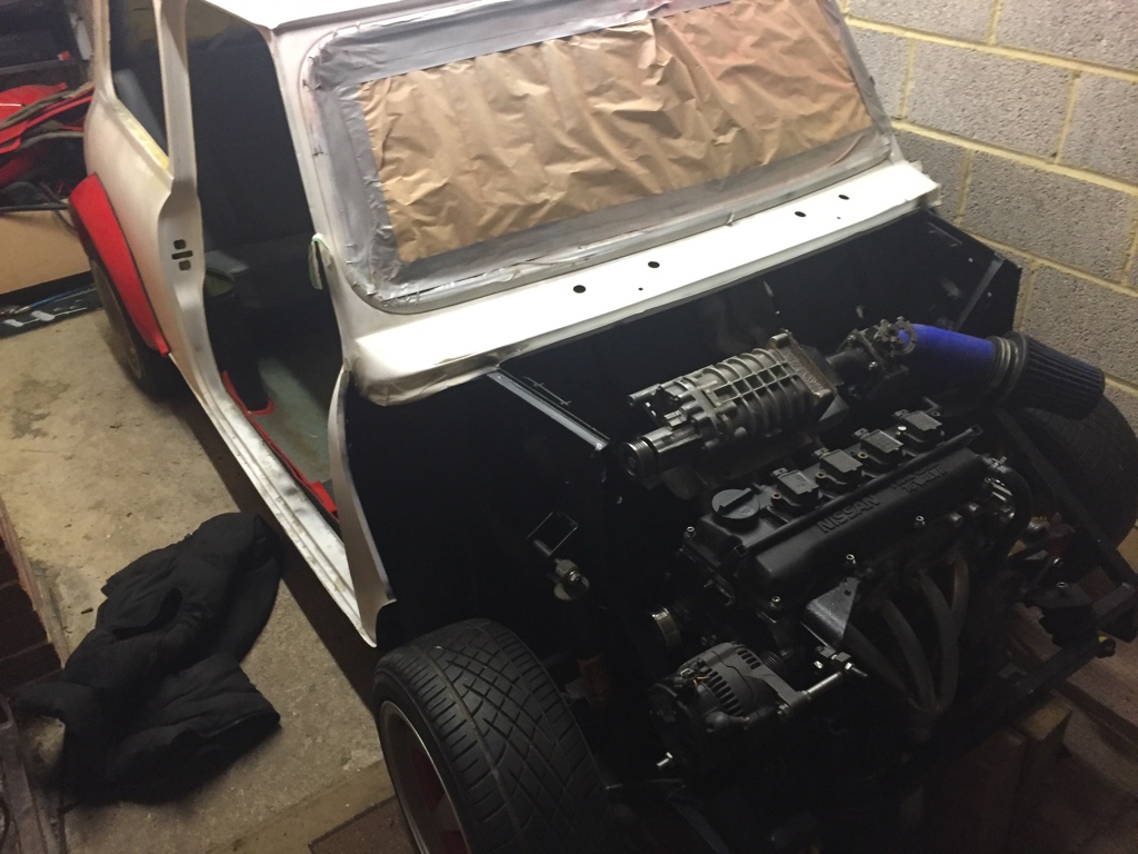

Inspired by all the cool minis at retro show at Santa pod, decided to pull my finger and get back on the car

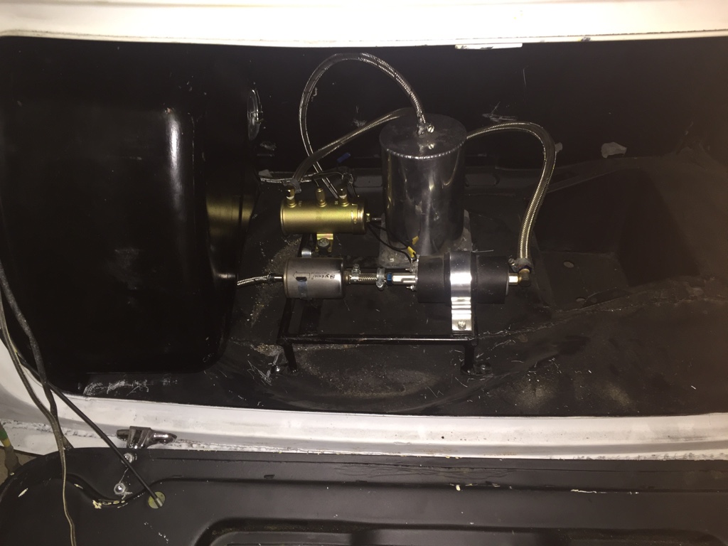

Injection pumps and stuff sorted with return welded onto the tank
Brake lines done
Should have this soon too

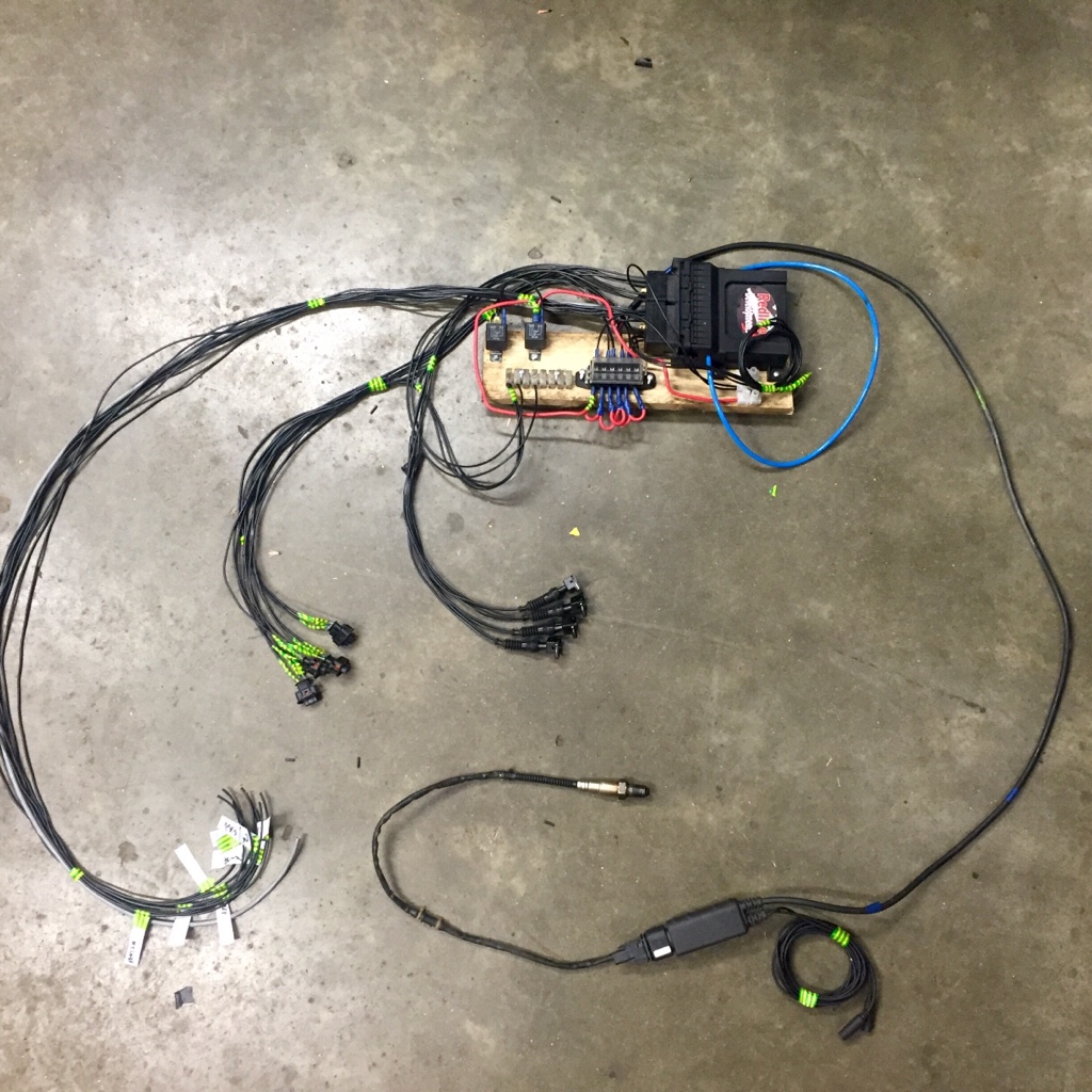

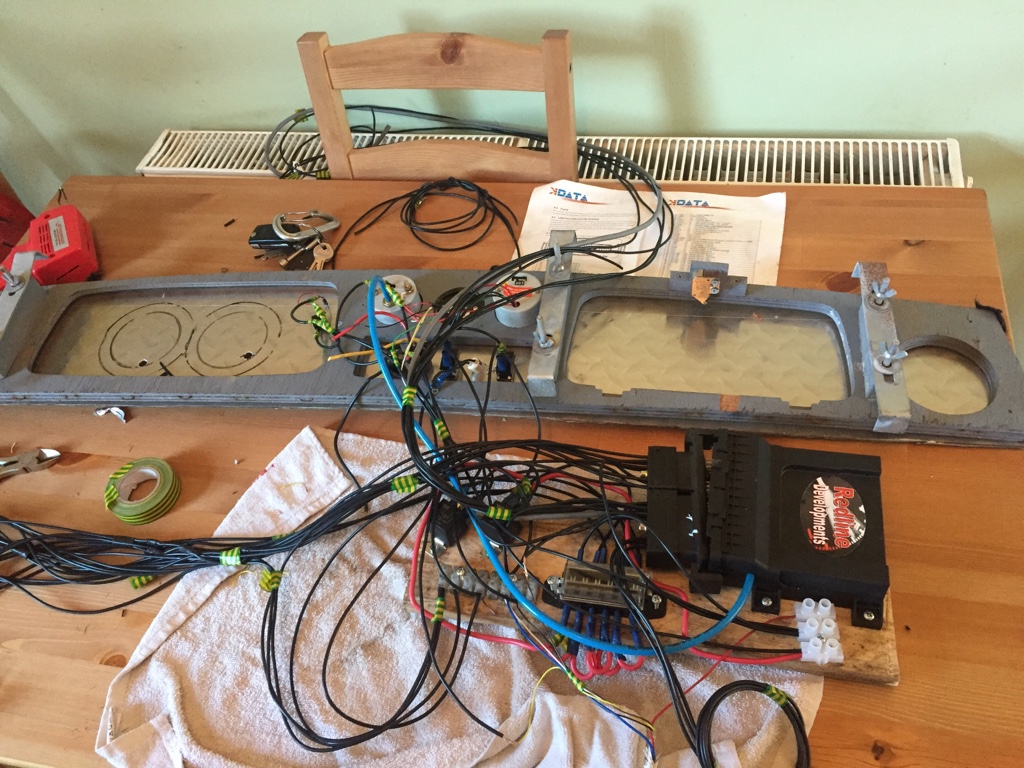

Ecu wiring 99% done with relays fuses and switches
OP
OP
pork
pork
Tonight's activities........maybe should of used more colours lol
But the black was free

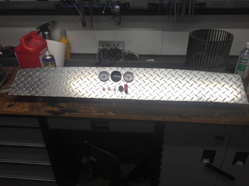

Gauges in and dash done

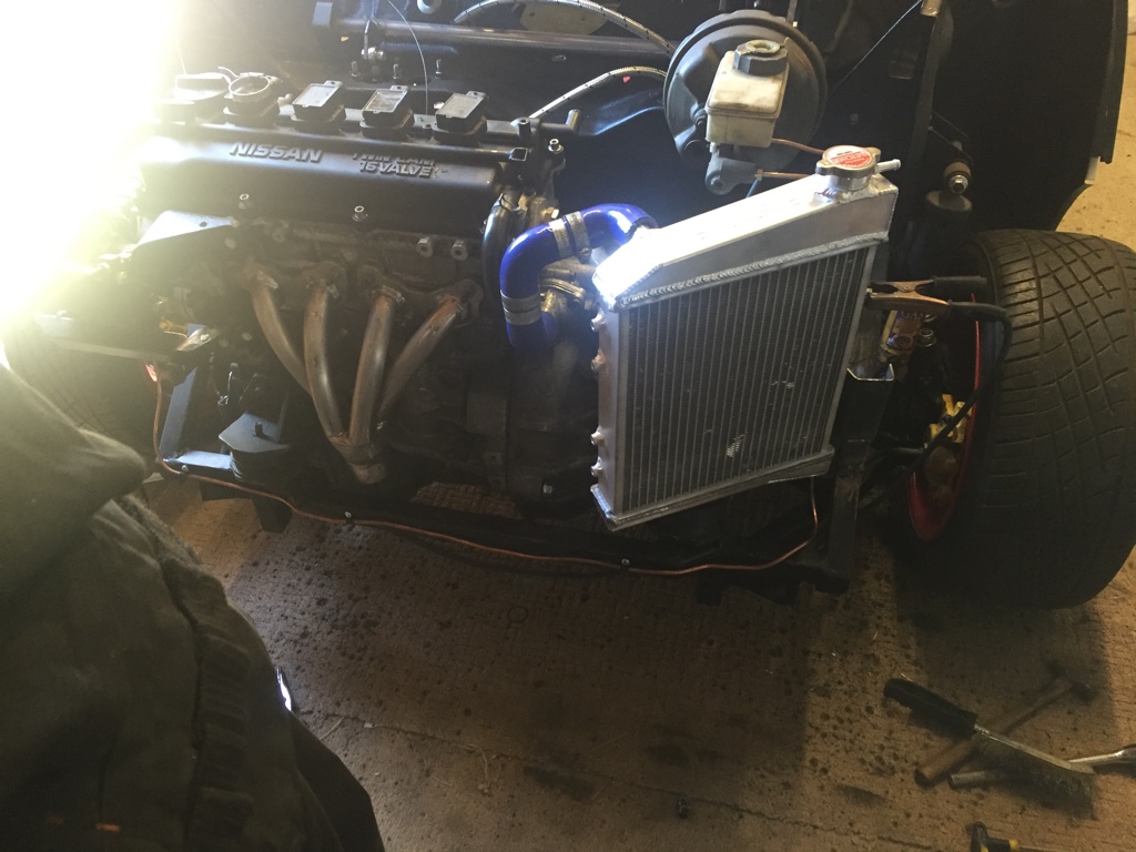

Rad on
Just dropped off mini/micra shafts to engineer bloke to make up some sleeves for me :)

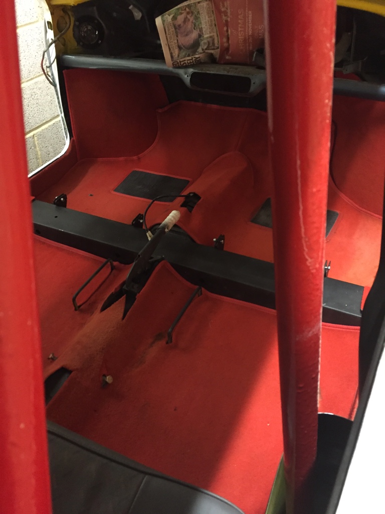

Gear linkage done, took a lot longer than it should
