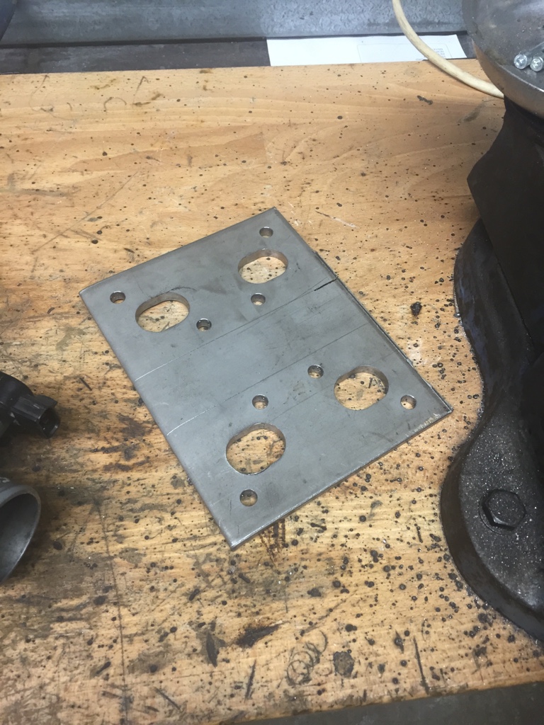

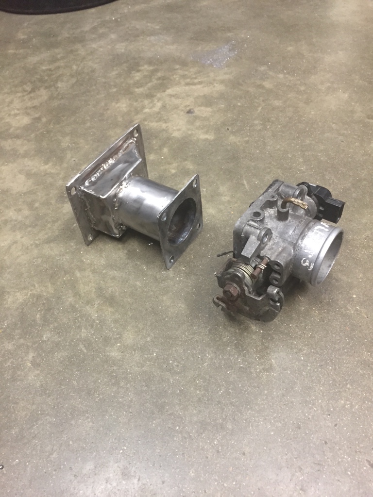

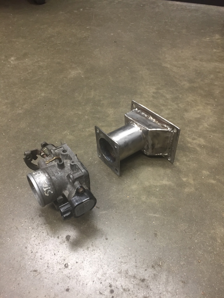

Had a spare hour or so for first time in ages
So drilled holes into stainless plate ready to be mounted to the manifold pipes
And finished of the throttle body inlet

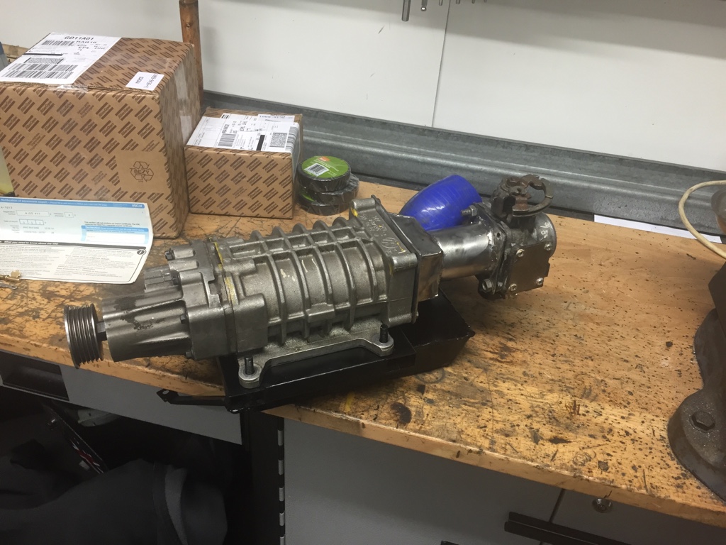

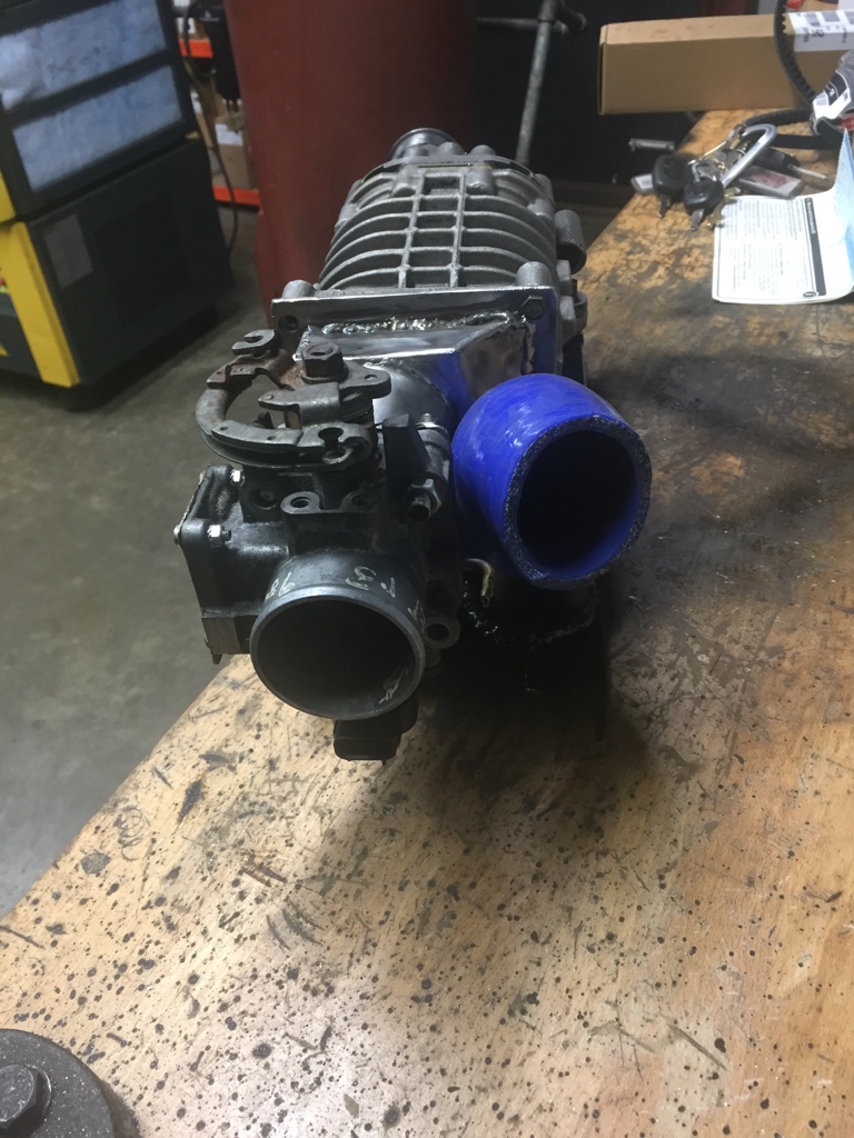

Quick look of how things will look.....will be putting charge cooler between charger and inlet
