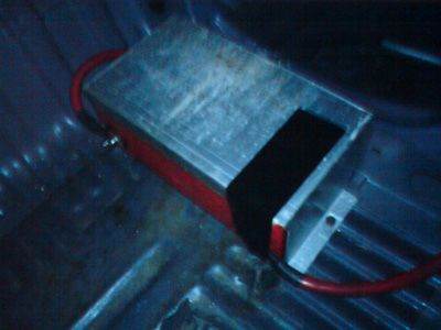

Paul, have you relocated your battery? - cant tell by your recent picture.
If not it might help make these easier when changing engines
