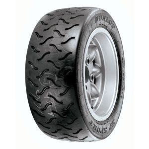

Unless there is a LOT of standing water, then performance in the wet is all down to the compound of the rubber and not the tread. Tread helps the rubber move and thus warm up the rubber. At Brands this year, I ran full rally slicks i.e. 17% tread in the wet and reasonable amounts of standing water and had no issue as the compound was very soft (X22) so soft when cold you can move the rubber with your thumb...
Library image for reference
I agree - at the trackday today I was running Road legal semi slicks, however there was just no grip and no heat.
Last rally at Blyton was slightly drier admittedly, however I ran soft tarmac rally slicks (like the above pic) and had a shed load more grip than today
