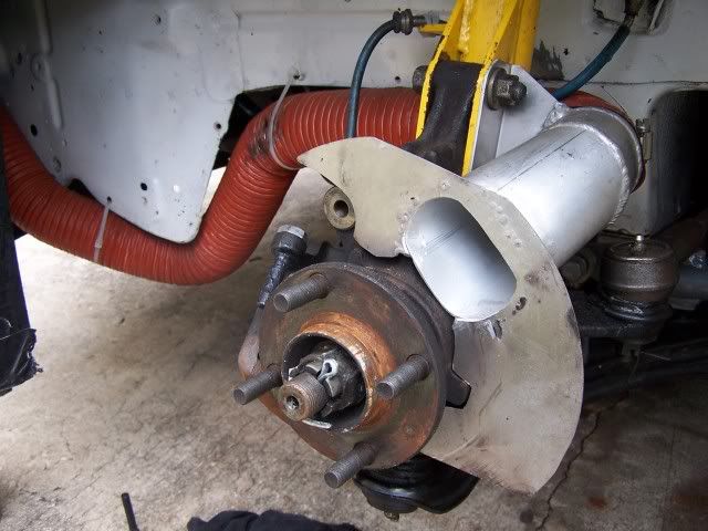

Looks like you need to construct a brake cooling duct asap! :D
Maybe something like this?
aye, could do that.
even better if they're an active/thermostatic ducting (rather than overcooling 24/7) so it only delivers enough cooling once the disc is above it's optimum temp range just like the coolant thermostat.
if only the front calipers were positioned at the rear of the hub like on high performance cars so it's easier to get airflow straight to the hub centre intake of the vents
