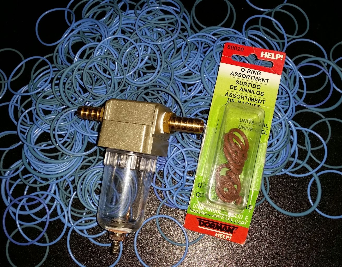

ok to keep things in order on topic,
on my last post about the catch can, I reprinted the mount with the screw tensioner at the far end to make it more rigid. Mounted it on the morning before setting off and it’s a lot stiffer.
After blyton park I thought it would catch a lot but found not a lot had condensed?
Investigating further, what I found was that for the hot oily vapours to cool & condense inside the cans, the metal cans themselves would also need to be kept cool in the first place, like breathing on a stone cold windscreen in the morning, simple physics.
Now previously I briefly tied the PCV catchcan near the cooler area behind the LH headlight while the PCV breather catchcan was mounted on the boost pipe behind the hot radiator.
The hot air from the radiator would actually heat up the PCV breather catchcan and so if the can was no cooler or actually hotter than the oil vapours, nothing would condense inside.
Meanwhile the PCV catchcan in the colder airstream behind the headlight away from the radiator stream was a lot cooler than the hot oil vapours therefore 25ml of oil vapour had condensed on the cool walls after 300m
On the current configuration mounted down low right behind the rad, both cans would be heated up by the hot air on or off track
so when I opened them afterwards, the PCV catchcan only caught a little bit
and the PCV breather catchcan none at all cos they were both too hot
The weak fibrous strands of 3d prints doesn’t work very well with slippery oil vapours and would break apart so I’ll need to look into a more solid construction.
Thought about using this glass coffee jar which was the right size n shape and can see the content through the clear glass. The flat lid will have a 90deg elbow screwed on to clear the bonnet.
Either mount the pair on a metal bracket here behind the headlight
Or best place is in front of radiator to get really cold and condense as much vapours.
