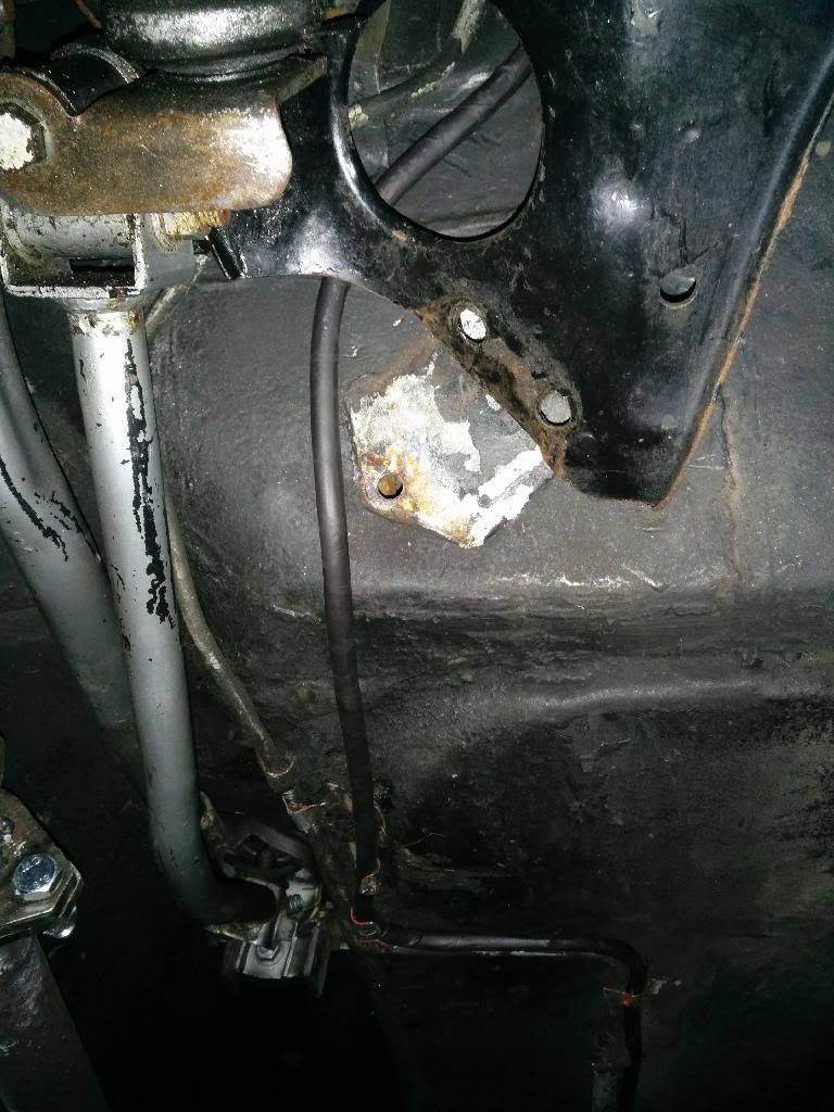

along the sill then through the front of the rear seat well
where it pops along the inner side of the trailing arm mount
and straight into the rear brake point

Here's a few photos of how I did Alex's
Glad you've gone for that grommet in the end its a safe secure area of the car
Added joins here for his future bias valve. A good join is as good as a solid line :)
I use ptfe on the very top of the unions (not for thread sealing as the compression of the copper holds the unions together similar to how a spring washer would) it stops dirt ingress to the threads and seizing :)

Thx for the handy pics. Been thinking I'll need to move the union to make it easier to fit the bay lines. Also reminds me I should redo the fuel lines cos they're getting rusty, what u using?
That ptfe sounds handy especially for the well exposed join to the flexi brake hose that's usually seized. I think perhaps cover it in hot glue or putty after fitting to stop moisture etc getting to it?

flared ends of the pipes
wrapped in tape
and all fitted
secured to the chassis
