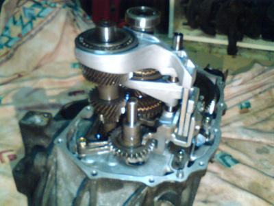

to decide whether to replace the input bearing, a non-scientific way of checking the amount of bearing play was to slot each input shaft into the bellhousing, anchor the measure tape and read the amount of give from wiggling the end side to side.
the current shaft with the worn 5th gear has 1.5mm of play while the prev old shaft (which I believe also whined) has 2mm of give.
I think the best option is to replace the bearing to be safe.
the NSK 6305 ball bearing is like £8 and getting a local shop to source n fit the bearing is prob a doddle.
buying a £10 gear puller and hammering the new bearing on myself just ain't worth the risk of damage.
measuring the other end of the shaft to see how much its worn, the current shaft with worn 5th is 28mm dia while the prev old shaft is 28.01mm dia so is newer.

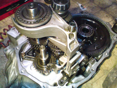

Paul any chance you could nab some pictures of how the the 5th gear selector fits in with the other two selector rods. Not sure if mine is correct

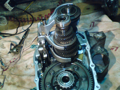

oh bugga, only just realised that the 3pc gear puller won't be able to remove those tapered bearings off the diff or gear shafts since the fingers r too bulky. oh well, but I'll be able to do the essential input bearing.
OP
OP
pollyp
pollyp
3pc bearing puller arrived
before I could pull the bearing off, needed to buy a flat snap ring plier at machine mart
snap ring removed
the larger puller just fits but it was very hard to tighten the screw by bare hand, need to secure the puller
clamped the puller on a vice and now I can crank on the screw
and the bearing slowly pulled out
this obviously ruined the old bearing. awaiting the new bearing set to arrive.

new input bearing slipped on
needed a tube with a 27mm+ inner bore, found this off an old push scooter
slip it against the inner bearing race and hammer it down
till I was able to fit the snap ring back on. spins much smoother
now to reassemble the LSD. retapped all the bolts & threads clean from threadlock, reinstalled the plates dry cos I know they're only gonna clean n inspect everything anyway.
bolted up hand tight n repackaged to be posted off.
