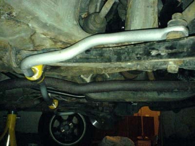

got a pack of m10 nuts bolts from BQ
drilled a hole through the collar to try tap more threads. its a very solid metal to tap cos the tool kept binding/stuttering so I tapped far as I dare without snapping the tool
making some slim nuts rather than buy some. first mark the cut with a dremel on a drill
hacksaw off and smooth on a grind wheel
done
slim nuts now on both left/right threads to get the most available adjustment
trim the bolt length to the original
lubed & ready to fit
regrease the swaybar bushes with CV grease
all fitted
greased bush
to fit the swaybar, the RH link had to be extended this much till it was slack. I just have to turn the middle collar 1/2 turn from zero slack and could feel it begin to resist as the swaybar begins to twist, so it's real handy for ensuring the bar ain't pulling to one side. the upper bolt required two nut spacers to keep the droplink upright.
the droplink can freely twirl about it's rosejoint under zero preload till the body touches the bolt edge so I suspect this might cause some noise at one point, the next test drive will answer that.
abit worried the link might be adjusted too far at it's last few threads, readjust soon.
the LH link is fully retracted.

We just need to figure how to replace the squishy front rubber swaybar links with solid adjustable ones andy
Already looking into it but enuo isn't far off :) we can have a quick look on saturday and see if anything becomes apparent when its in front of me
I've got those spacer for you if needs be, they'll prevent any knocking from the joint, looks fairly close to the bolt head already

driving to work and around country tday and no knocking so the rose joints fine.
front swaybar mounted like this
k750-88-jpg.31386
I got idea for the rose joint front linkage, gonna draw it later on. how many rosejoints you got left andy? prob just need two and fabricate the thing on saturday

measured bout 35mm between the front swaybar and the lower arm to fit the rosejoint, just enough

regreased the swaybar mounts

bent some U shaped brackets for the front swaybar rosejoint only to find I've wasted afew hrs work cos the whole assembly is 45-50mm whereas the current linkage only has 30-35mm space so this won't fit :rolleyes:

I'm all in for novel upgrades but I think it would be better to keep it simple and just upgrade to a set of polly bushes.
drand
1st Micraversary!
Strongflex do them in fast road & track hardnesses. You could make some nylon ones if you wanted even less play i suppose.

axial joint could fit if the female threaded end was shortened but to adjust it's length requires fitting washers so it ain't easily adjustable.
poly bushes are nice but the main issue we're resolving is how new or old swaybars become slightly twisted relative to the position of each wheel when the car is level. This means the twisted bar would be applying slight amount of uneven preload while the chassis is level which affects the final corner balance.
I need to design a linkage with an adjustable length, preferably on-car adjustable like the rear rosejoint, so that after the coilovers are perfectly corner balanced on a level platform, I can reinstall the swaybars and adjust each linkage till there's zero tension across the bar therefore won't upset the original balance.

during fitting I can feel the front swaybar ends have a 5-10mm difference even though the chassis and lower arms are level.

the twisted front swaybar transfers more load from the FR to the FL wheel, reducing crossweight to 49.9%
noting the binding damper seals affecting the readings, I rejiggle from the FL to get this
and rejiggle from the FR to get this
seems the front swaybar really needs adjustable links and the sticky dampers & maxed out scales means trying to achieve the last 0.5-1.0% static crossweight is pointless.
