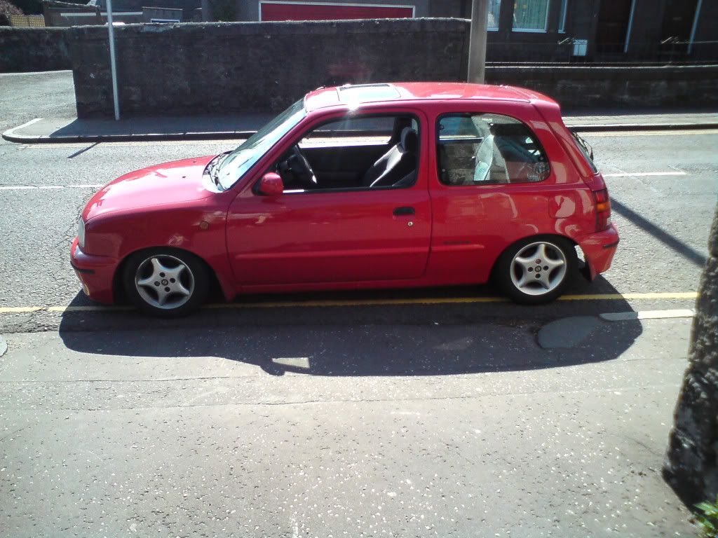

Ha cheers believe it or not i drove to blackpool and back like that. Bouncy bouncy!! Ordered new springs the day i got back lol
I don't think you can really call that a "comfy" suspension setup that you can use day to day :laugh:. Blackpool and back, though? And you still had your front bumper and the underside of your car in one piece? Mine is bouncy and scrapes as it is, and it's only been lowered about 90mm :laugh:.

Been a while since I've seen those pics stani, very low indeed, had mine lower though:p but only for an hour lol was crazy low, it's now a bit taller but about the same as yours there.
Dan I use mine everyday and the comfort is ok, glides rather than bounces over most bumps, but you do notice more bumps on the road so on very bumpy roads it can get a bit shakey.

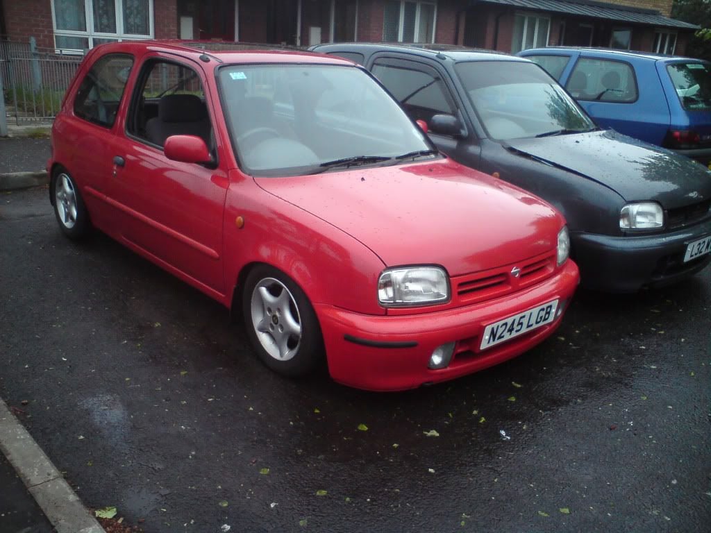

The comfort on mine is pants. I was running 50mm Apexi springs and shocks (only shocks on the back), but decided it wasn't low enough and lost a coil on each corner, making them 90mm lower than standard. So now it amplifies every bump and pothole, rather than ironing them out.

Euro what suspension you got because that had no rear springs and the front ones sat loose
It couldnt go lower
Corsa coilovers modified to fit, I'm only sat about mid-way on them, so I still have some dampering. And it can go much lower without hitting bump stops.
