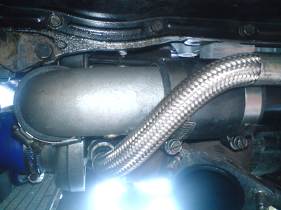

h701micra Deactivated Account Jul 18, 2014 #7 Partly threaded barb fitting with dowty washers and a nut. Job done
pork Club Member Jul 18, 2014 #8 Welded on a 1/2 inch bsp socket, then used a 1/2 bsp to 1/2 hose tail fitting, for pipe I've used a length of hydraulic hose lying about
