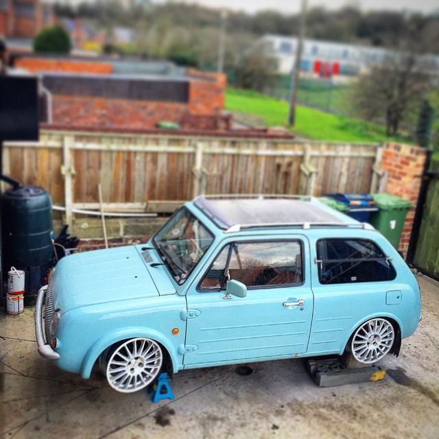

Cheers I'm finding it hard to find a k10 5 speed so k11 is looking more likely I'm busy sorting wheels and ride hight at the minute , got some gaz ultralows for the rear and Lupo units up front

Looks in great condition :D

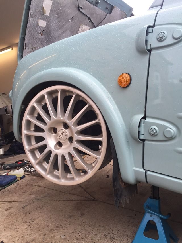

I've just bought a 5speed k10 so I will have everything at hand, tonight I modified some vw Lupo front coilovers to fit and I'm happy with the drop
