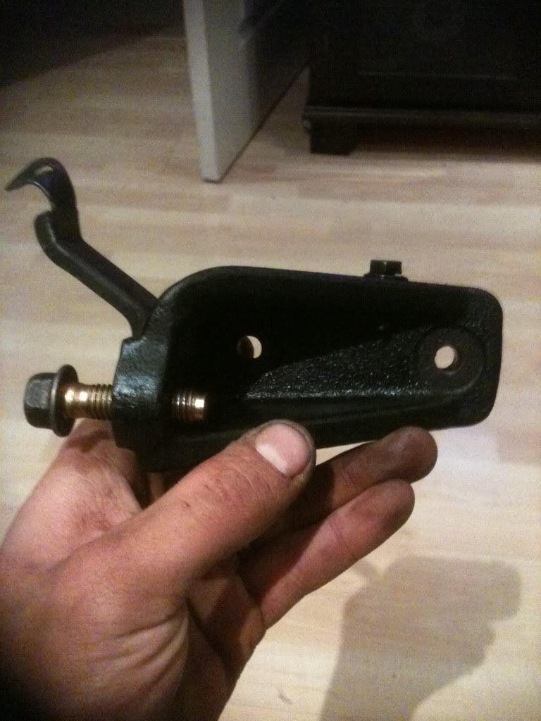

need a alternator bracket top mount!!! micra k11
hello need a alternator bracket do i can mount my alternator at the top part of the engine having problems with my down pipe fouling with the alternator
looking for one that come on the aircon models as the alternator sits at the top if you got on please get back to me as a i need one asap

There are some models without aircon that use those brackets too, for the alternator sit in higher position.
And the one on the link is the right one.

but i still need the top bracket to hold the alternator as well then this only hold it from the bottom
Just been up to martin's house, Im pretty sure he has what you need. Not sure if he wants to part with it though or how much he wants for it...
Il get him to look at this thread...
The belts are different, the air con belt is longer.
You will also need the tensioner for the air con belt as the alternator bracket doesn't have one built in.

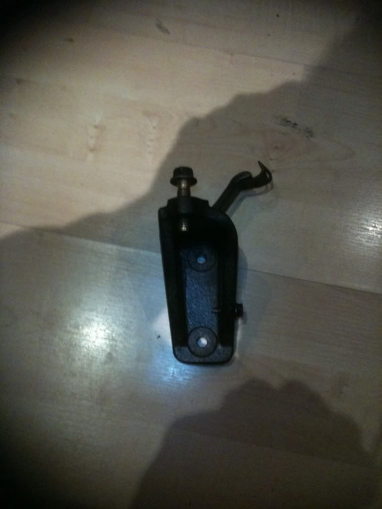

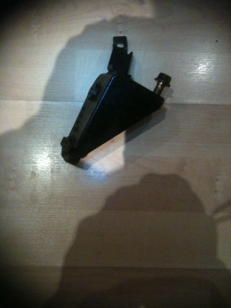

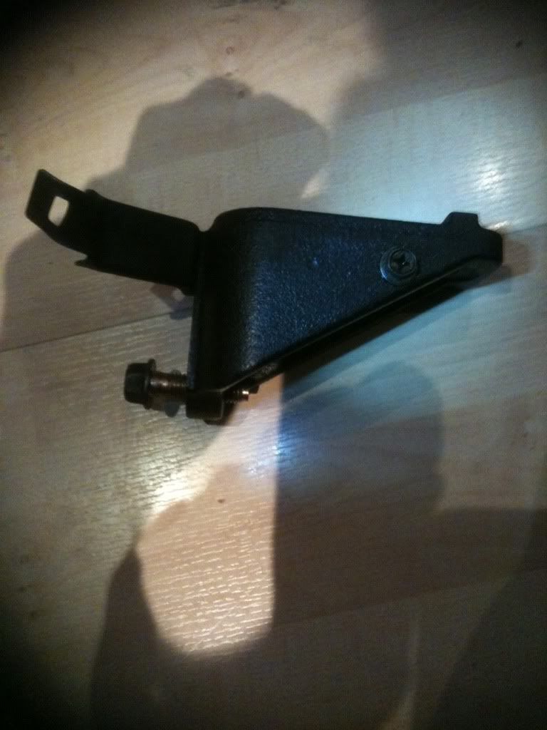

is this what you need mate?
