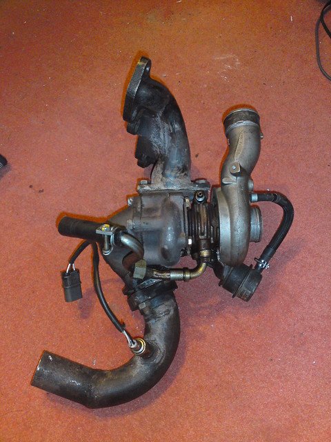

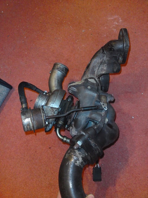

Turbo & Manifold
Bought from Martin, it's a Garrent T20 with internal wastegate. The manifold has been modified by Frank. And together it should bolt-up and fit in the engine bay easily.

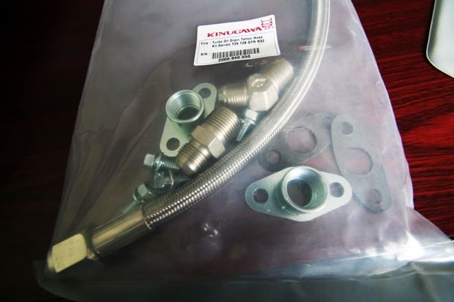

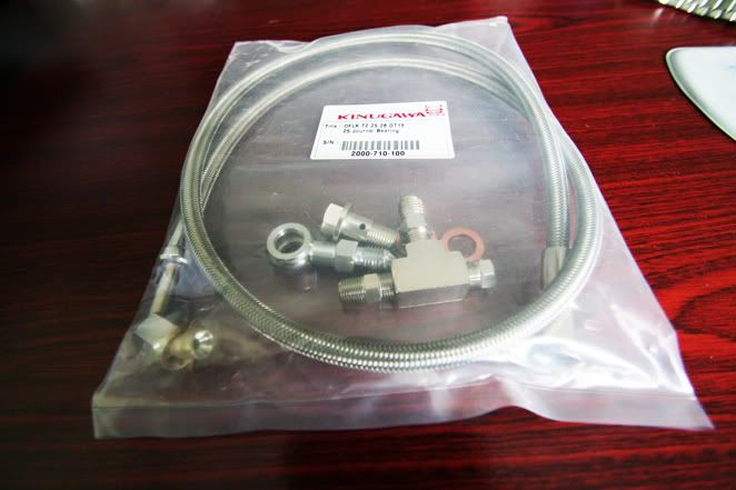

Oil feed kit
As far as I know consists of:
1/8npt to an-4 fitting
an-4 hose fitting
an-4 hose
an-4 hose fitting
an-4 fitting to turbo banjo(have)
Oil return kit
turbo flange pipe(have)
hose
sump flange pipe

With a turbo that size and a small intercooler, youll see no lag. That turbo is perfect for what your intending.

just for your info matt you need these to complete the oil setup
http://cgi.ebay.co.uk/Oil-Drain-Ret...arts_Vehicles_CarParts_SM&hash=item33681782f1
you need a 1/8 npt to 4- an fitting to screw to the head feed
http://cgi.ebay.co.uk/4-AN4-04-1-8-...arts_Vehicles_CarParts_SM&hash=item2563ad5b79
and a 4-an oil line, you only need a 25cm one as its a very very short route mate
may have to be custom order or make your own, you can still have a 1 metre oil line if you wish but i didnt want it wrapped around the engine bay
http://cgi.ebay.co.uk/4-4-8mm-I-D-T...arts_Vehicles_CarParts_SM&hash=item2307b5e12b

Hey Martin, thanks for that pal, pretty identical as what I got bookmarked-
Head Feed adapter
Hose
hose fittings, either these or these. (would think these are needed right, one to connect from head adapter, and one for the banjo?)
Oil drain sump pipe
Can you cut those braided hoses? So I could buy just the one 1meter one and have myself 25cm for the feed and 75cm for the drain?

Matt you don't need anything for the oil return other than the fitting I tagged
You already have a return with hose, just get the fitting mate
Yeah you put tape around the braided hose and hacksaw mate :)
Ah so that pipe will reach the sump, I was thinking it was a good 30cm or so away:wasntme:
Does the sump fitting need to be welded on, or will the gaskets, silcone and the nuts and bolts be enough?
