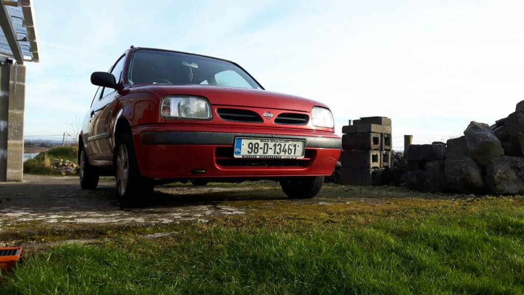

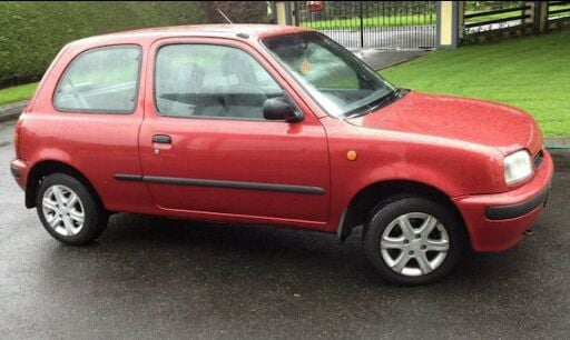

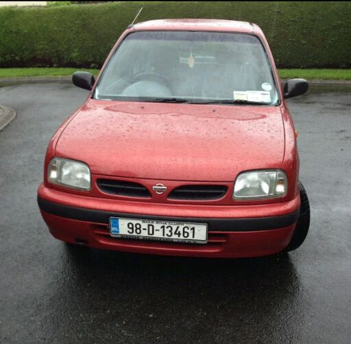

Hello everyone. My name is Liam and I'm from the Midlands of Ireland. I recently got my first car but I've been looking on these forums for a while now. It's a 1998, 1 litre with 90-ish thousand miles.

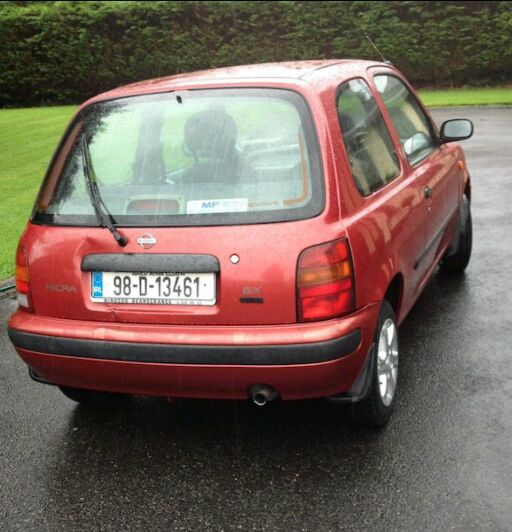

It has its fair share of little scratches and dents, and a big one on the bootlid and the bumper. Mechanically, it's very good though.
I'm really looking forward to owning this car learning how to do things on it, because so far they seem very easy to work on.
I have a rough list of things to be done over the next while
~Clean up the paint removing all the stupid little dents and scratches.
~Replace the bootlid and repair the rear bumper from its little crash.
~Add a few parts from higher level cars, (parcel shelf speakers, rev counter etc)
~Also add some parts from Marches like rear lights etc.
~Lower it a bit, I think roughly 40 mm with 14 inch wheels looks just right on these.
~Eventually, find a 1.3 engine and swap it, but these are a rare beast to find in Ireland
Here's some pictures as well.
