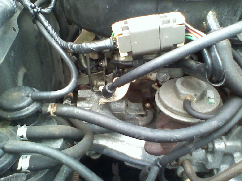

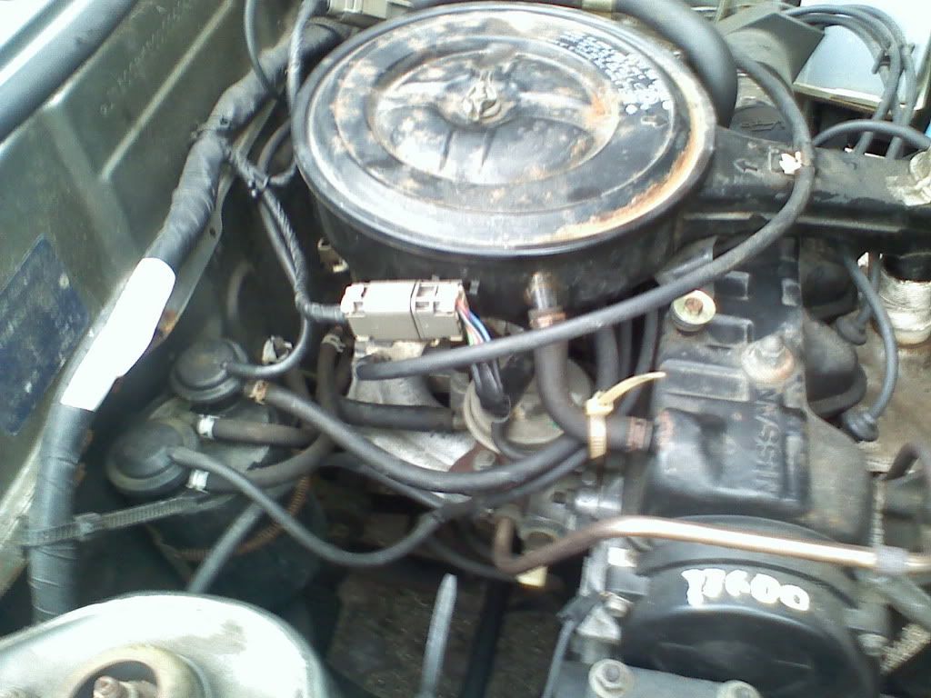

here are some photos:
gtsnissanb
Official MSC Trader
WTF is that under the airbox mine ain't got that? Pardon my ignorance saying that mines a 1 litre is it some kind of radiator inlet heater or something

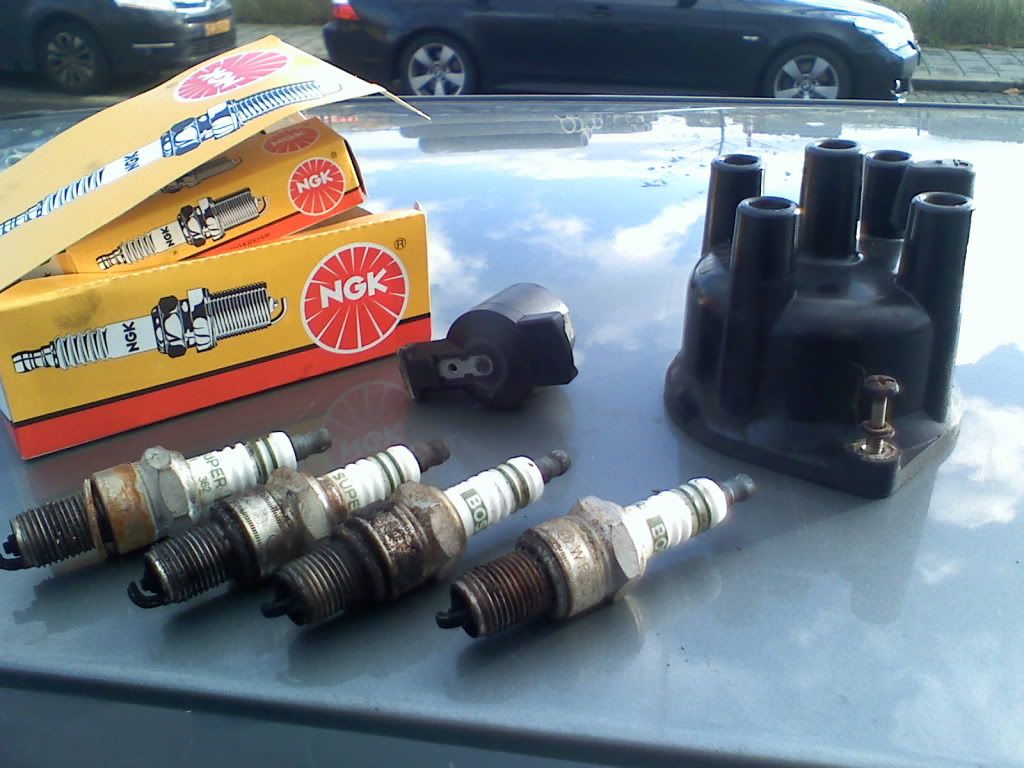

today I've replaced spark plugs, dizzy cap and the rotor, also i spent 10 - 15 minutes spraying plenty of DW40 on the carburettor, guess what, it's the same !!

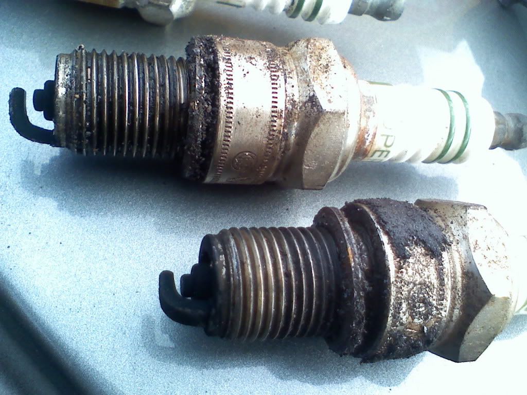

after i took out the first plug, I said to myself " thats it , i got it" the plugs were BLACK and very dirty, so i thought this may be the cause .
but after I changed the plugs, dizzy cap and the rotor, i took the car on the motorway for a drive, in some way it's worse, when i take my foot off the pedal, car hesitating or jumping (even on motorway) grr, the high revving still there (after engine gets hot):down: and every time i slow or stop the engine dies, but strangely when cold i dont have these problems,
but i'm still not finished, i've bought the vacuum pipes & fuel pipes , also i don't think this will sort the problem but i really don't know what else can be done. please help ...
ANYONE GOOD WITH SPARK PLUG READINGS?

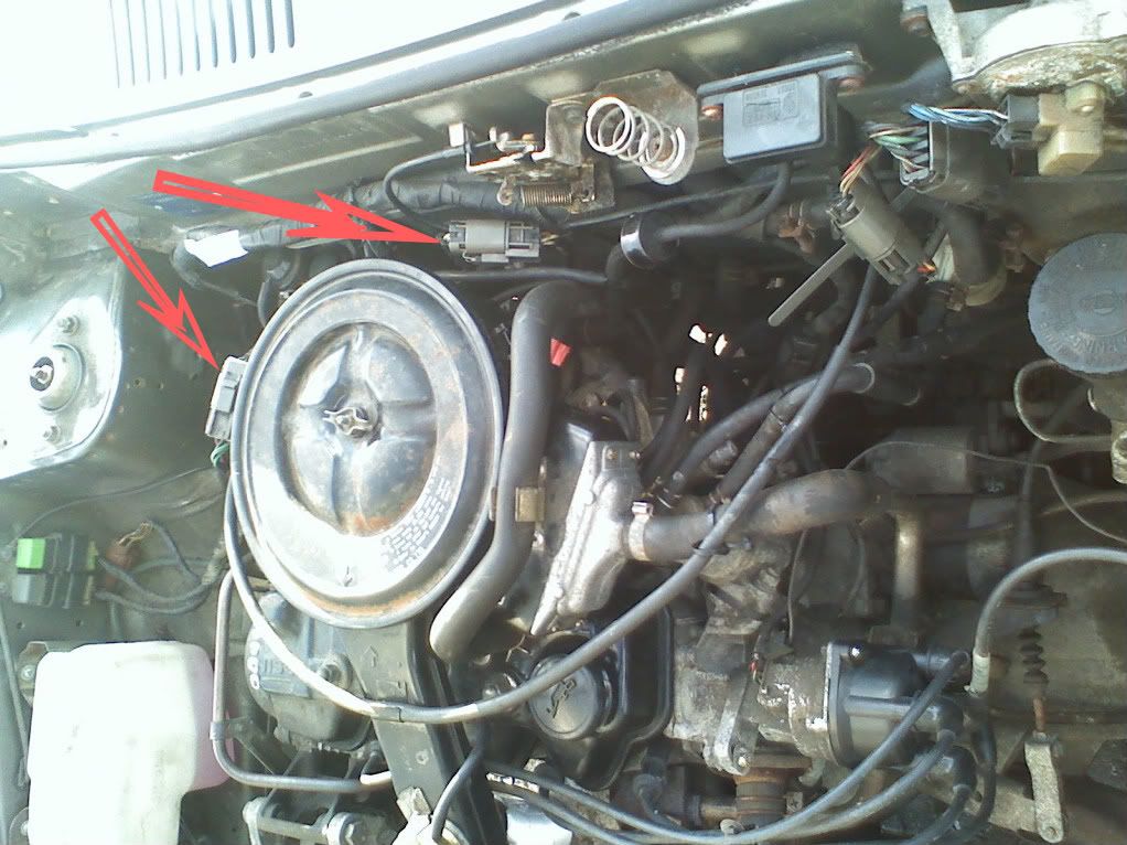

and when i disconnect these (while engine running) nothing changes! is that normal?
plugs look like you are running a little rich. about the disconnecting, did you try to drive the car with it disconnected?
i see you got the late EGR engine, sounds like the vacuum lines or that little black box with the line going to the inlet (normally on dizzy) is faulty. forgot what its called

The plugs are sooty black which means that your engine is running with too much fuel. There is an excellent on-line manual for the 1.2 ECC MA12 engine, which is what you have.

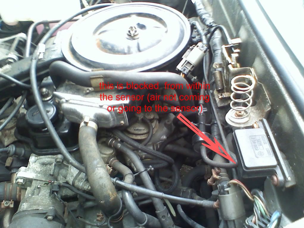

today i've been driving the micra witout that "Boost sensor" and i noticed no change . but some thing i noticed which i think is not normal. the pipe from the boost sensor is blocked!! here is a picture can explain more ( sorry my English is not good)
