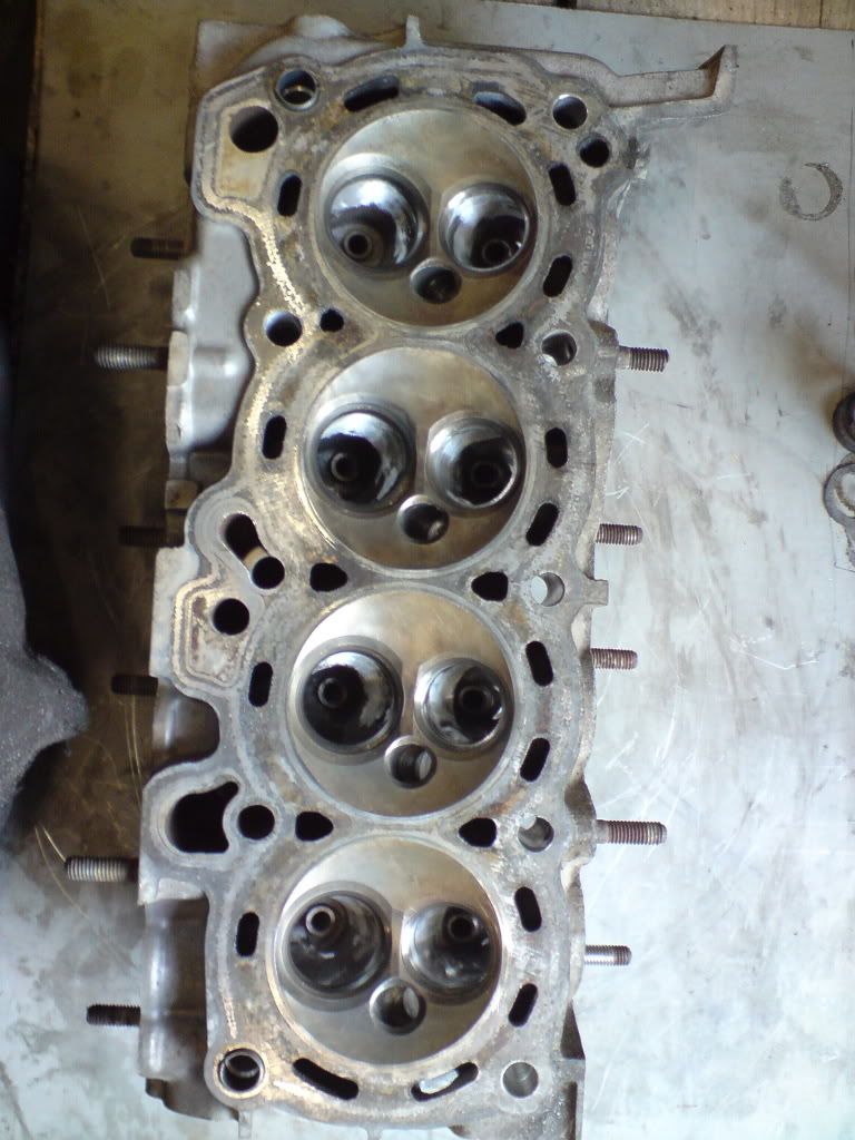

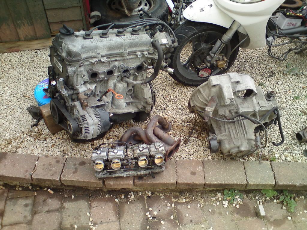

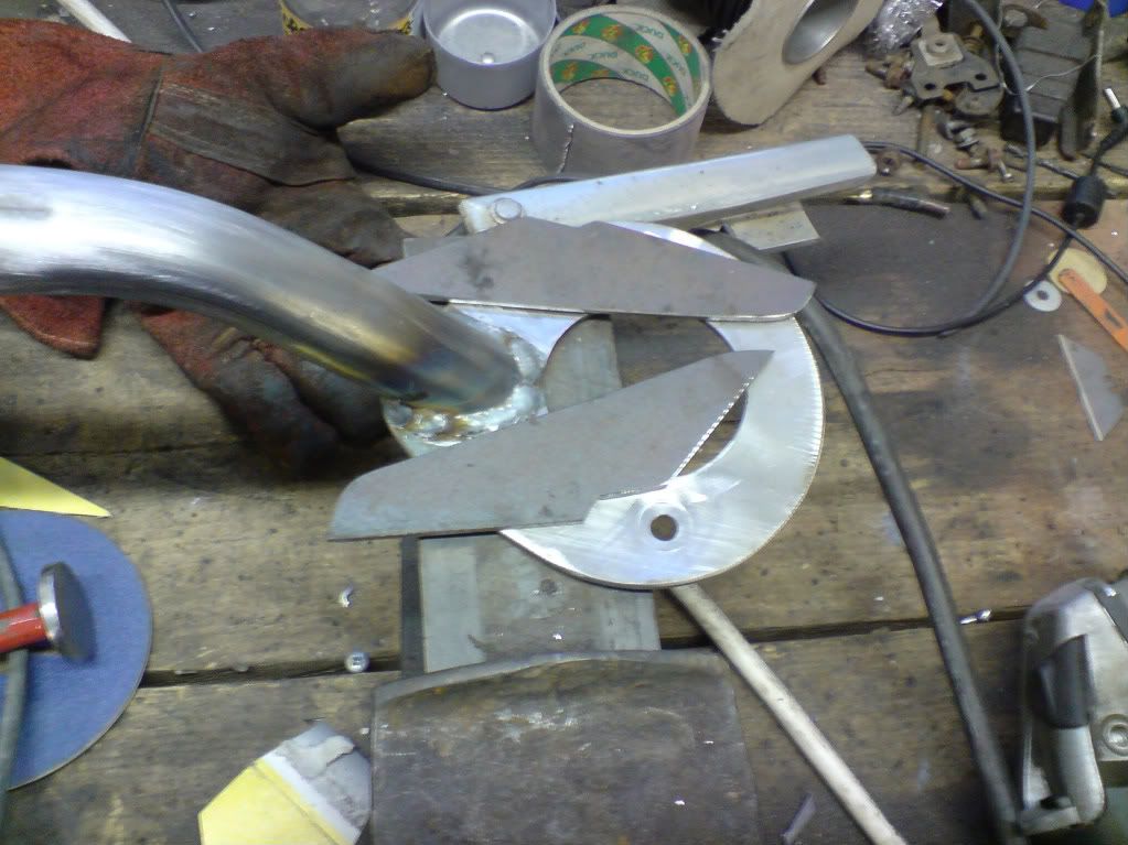

Inspired by a picture in bigchief36s DET mini thread, when I got the engine I also got myself a manifold and downpipe off a Rover 25.
So here's a 'how I dunnit'

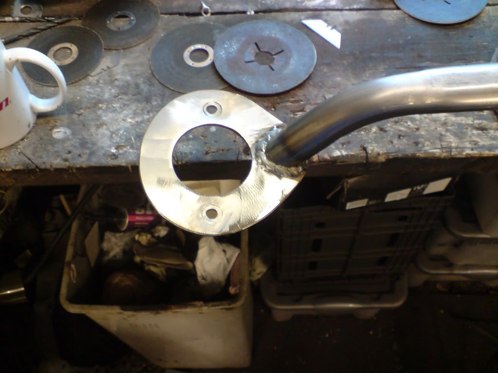

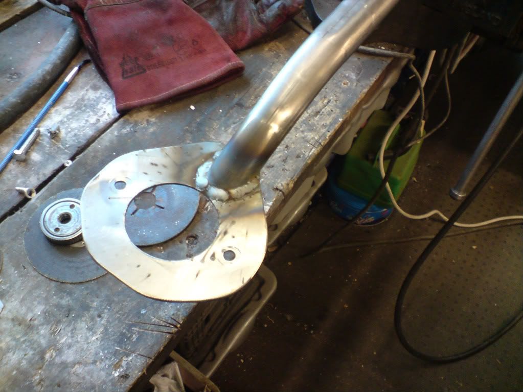

Cut off the original flange
Make a new CG flange out of 10mm plate
Chop the outside 2 pipes about to make them fit the CG port spacing and attach to flange
Remove downpipe flanges and modify downpipes to follow the sump shape, weld inner and outer pipes to manifold
And add accumulator and stainless flexi that's been kicking around in the garage
Bolt back onto engine

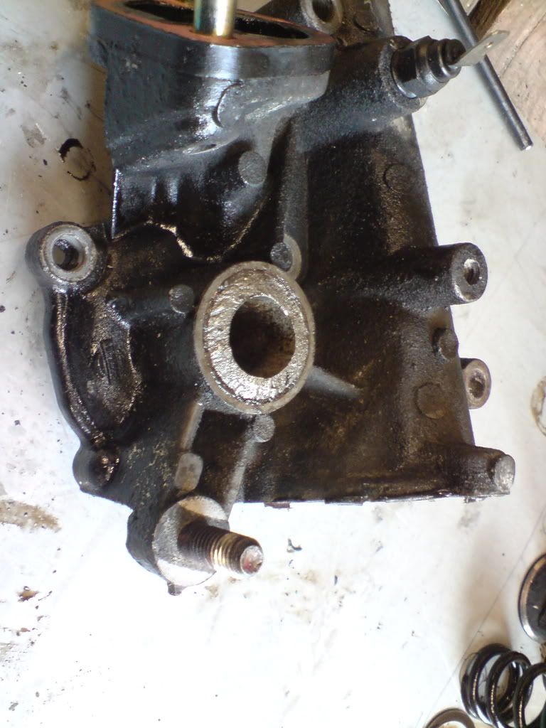

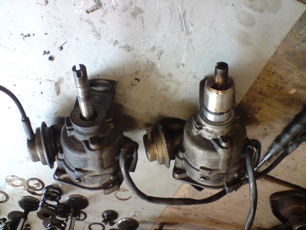

Number 1 was the distributor. I went and bought another K10 dizzy so I could sort that side of things without disabling my car.
I immediately discovered 2 things:
1. the K10 dizzy is 6mm smaller diameter where it it fits in the head.
2. the K10 dizzy is female slot drive whereas the K11 is male slot drive.
I've thought long and hard about how to get round this and have formulated a plan.
I'm having a collar machined up at the moment to locate the dizzy in the head. Annoyingly, I'm perfectly capable of knocking one up myself but can't get access to a lathe outside my working hours so I've had to farm it out to an old boy I know. I'm waiting on a phone call to say it's ready.
I'm gonna get round the drive issue by chopping the end off the K11 spindle and having it TIG'd onto the (cut down) K10 dizzy.

Picked up the collar Monday night, seen here in situ
Took the dizzy to work Tuesday, guy that was meant to be doing it forgot to do it. Nevermind as SWMBO picked up the special order exhaust bends for me from the local factors. Came home all excited expecting to be building my inlet manifold only to find that they'd ordered the wrong size. Spent the evening in the garage rebuilding the garage computer instead.
Today was better, got the bends ordered through work, they'll be here tomorrow. :grinning: Guy at work did the dizzy :grinning:
My hybrid dizzy

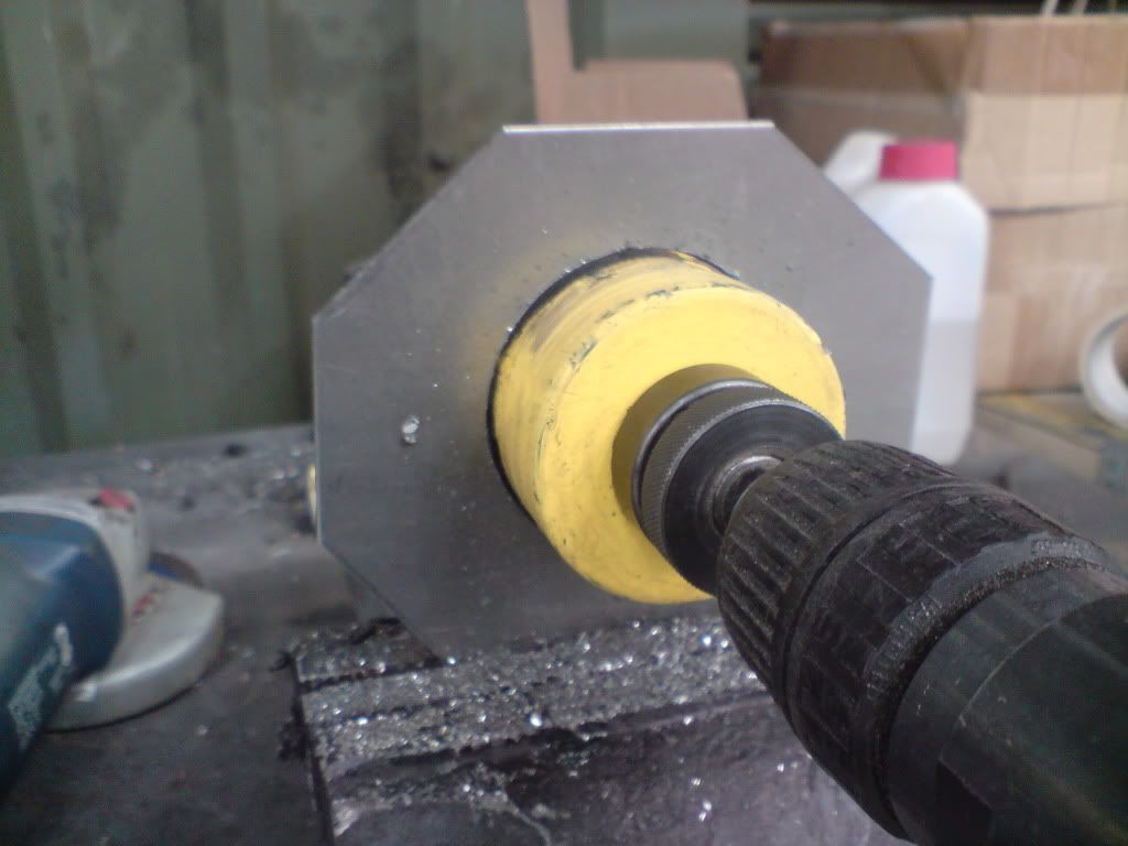

Today I took it to work and spent my breaks welding and die grinding the inside into a nicer, curvier shape (round pipes, weird cloud shaped ports)

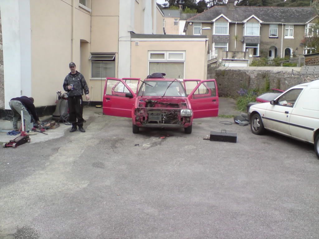

After spending a great day up at Area 52 yesterday, I got the garage sorted out so that there was space for my car in there.

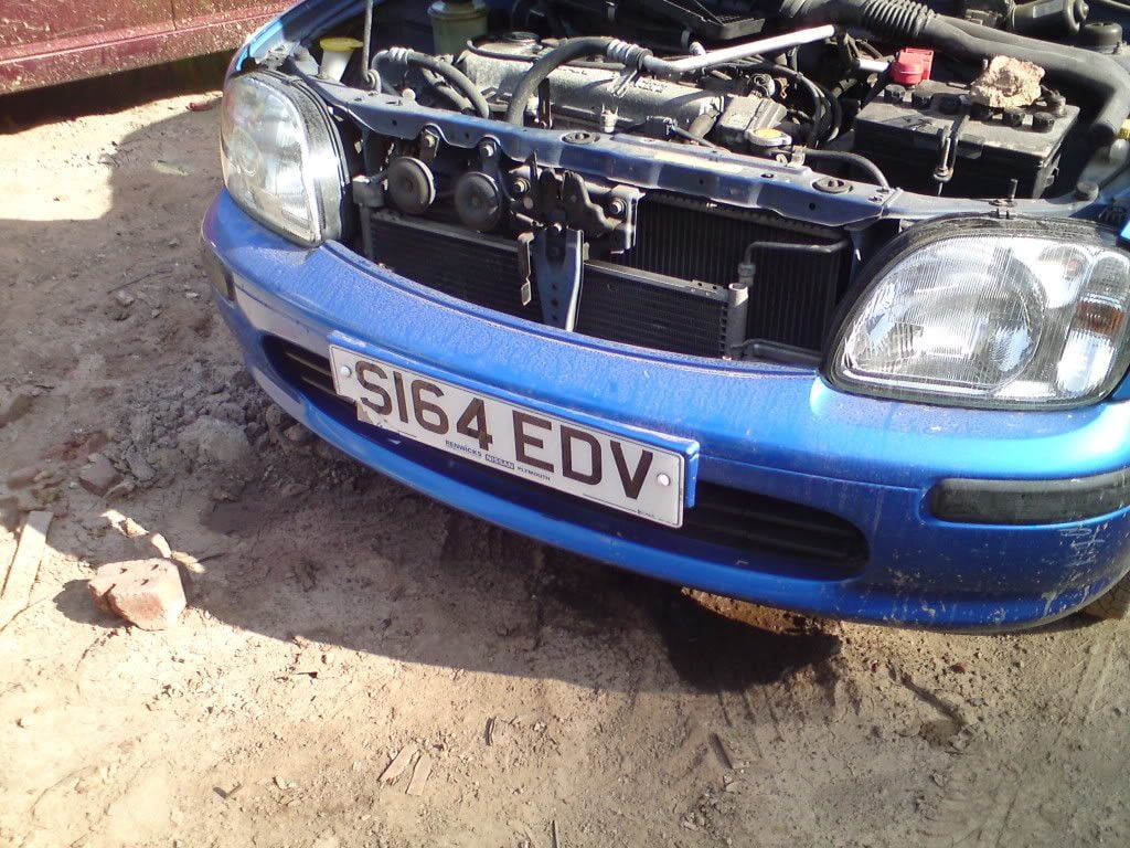

This morning 24vster and myself dropped the coolant and removed the rad out on the road, so we wouldn't have to work in a puddle all day. With the car in the garage work commenced on getting the very tired MA12 and all the front hubs, wishbones and driveshafts out......
With all the excess stuff out of the way we got the K11 hubs, wishbones and track rod ends on. Of course I don't seem to have taken any photos of them but the only thing that didn't fit was the K11 ARB which is gonna take some more thought once the exhaust and gear linkage are sorted.

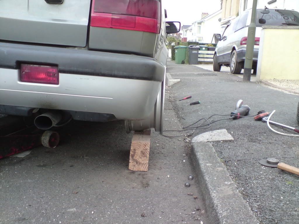

Exhaust done, probably not the ideal set up but I don't want it to drown out the carb noise and I can't afford to build a new rear section from scratch. Probably best to give it a bit of back pressure too.
............and fitted

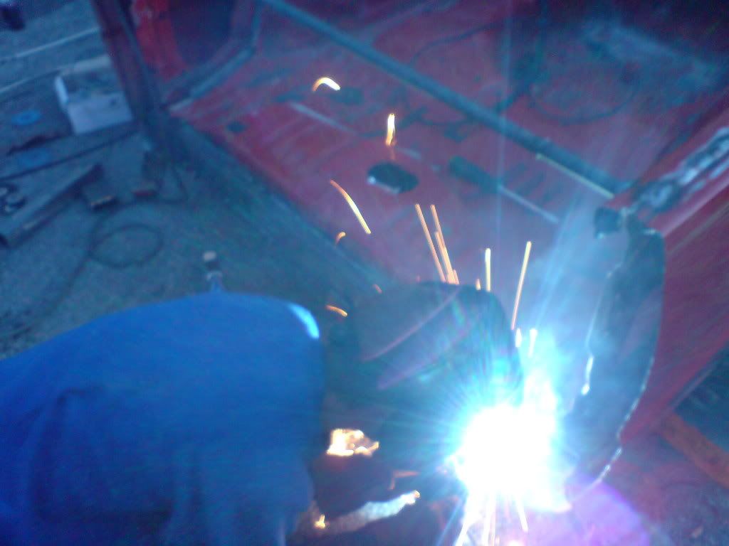

Today I started welding up the area behind the wiper motor......
.........and started welding up the excess holes in the inner wings and chassis legs..........

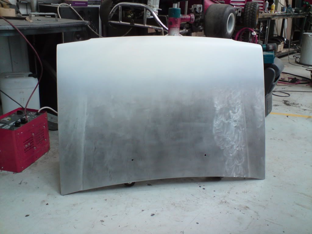

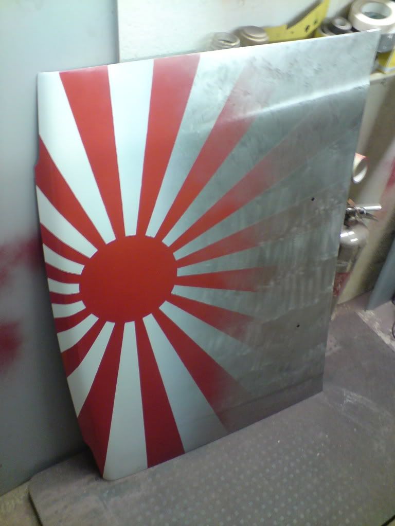

Today, after a rainy ride over to my mates on SWMBOs moped to get some scotch pads and some 400 discs, I got to work getting some filler on the welding and flatting it all down.
Took a short break to fit a towbar to a friends Audi during which my mate turned up and started masking and getting some primer on. After dinner we were straight back out there, here's Charli putting the first coat of basecoat on

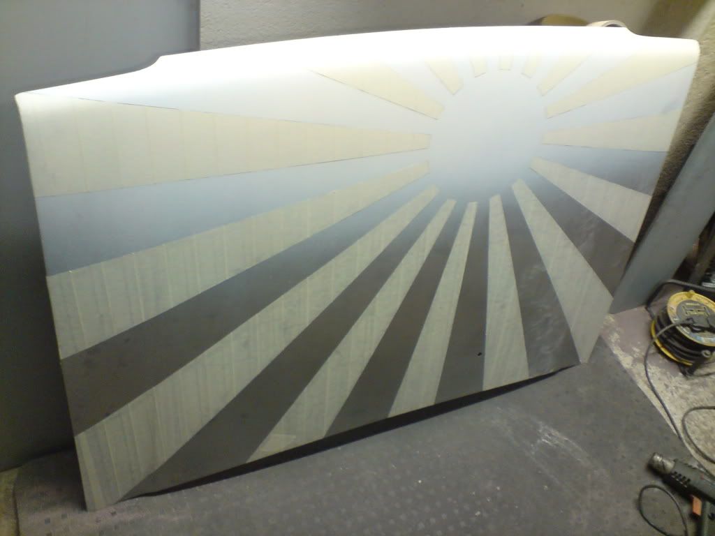

Second coat of basecoat
Ist coat of topcoat
And partially demasked after the second top coat!:grinning:
So stoked, thank you so much Charli, you're a ######ing star! (Y)

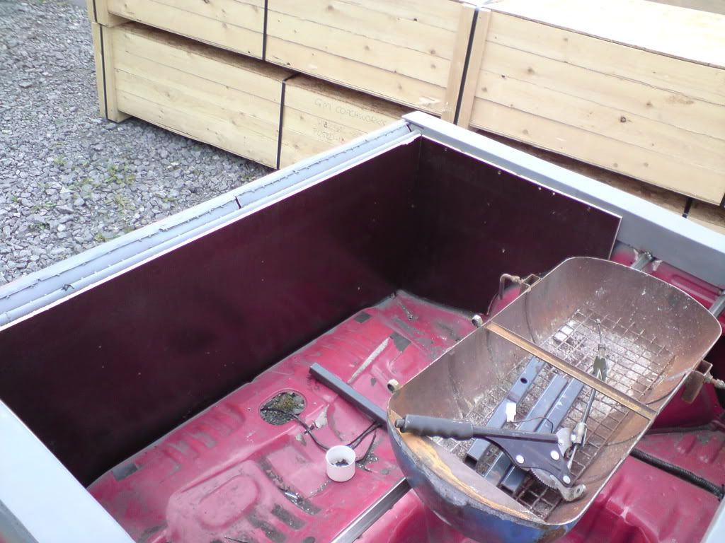

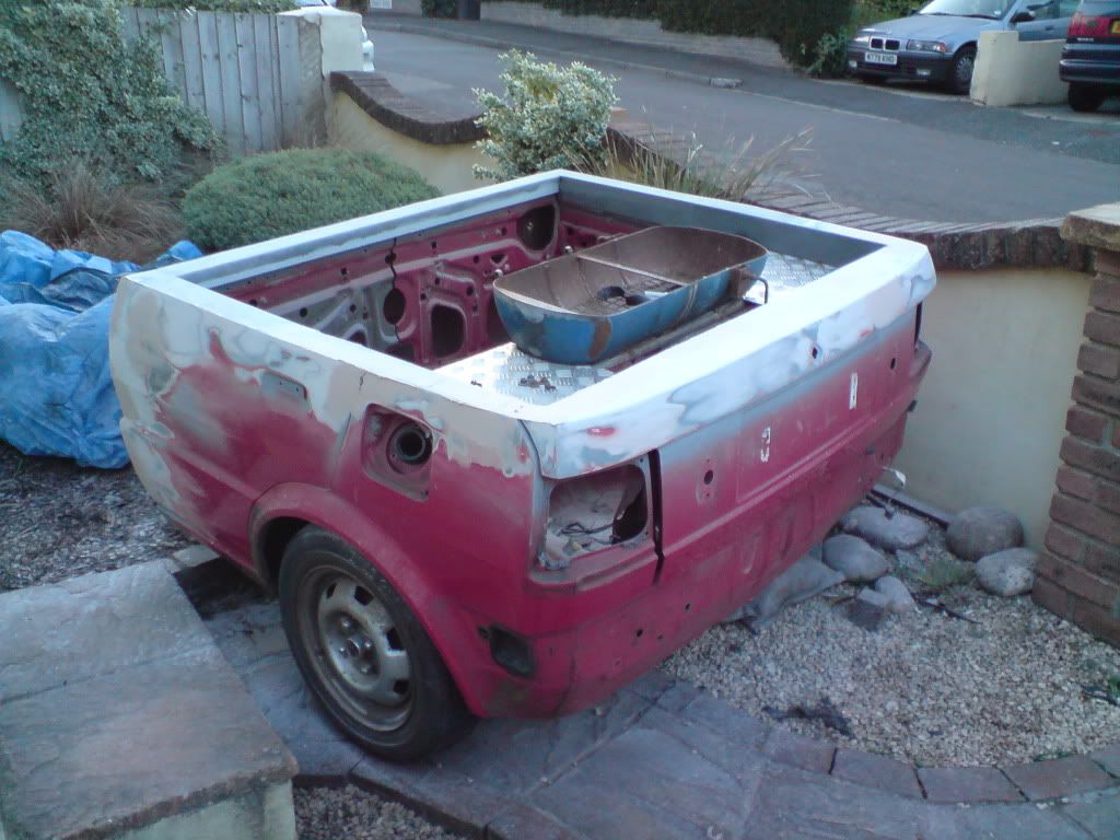

P.S. what plans do you have for the car-b-q ?? :)
OP
OP
B
More stuff to clean, more stuff to paint!
imp124 - Steve, your wish is my command :grinning:
nexussteve - At the moment I'm gonna say yes, This weekend should see the carbs set up (hopefully) then I'm gonna try and do a cheeky rolling road sesh to find out for sure. It feels a heap better already with the bigger slow running jets in it pulls really strongly from low revs and the noise makes me grin like a loony :p
