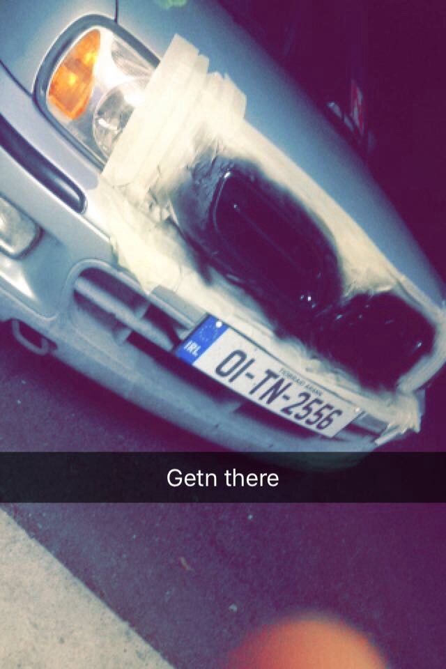

Did the Joey mod today, not sure if that's what it's called on a Micra but that's what everyone called it when I had a Golf :p Basically just involves painting the non reflective parts inside the headlights. I'm not a fan of smoked lights or anything in your face, I like mods that look like they could have been done stock. After seeing a few people that have done it on MSC and spotting a few Primera's / Sciroccos with this style lights stock, I decided love how these look!
First step was to remove the lights, which I found stupidly simple on a Micra. Here's a quick not very clear picture for anyone wanting to do it themselves:
Remove bolts 1 and 2 (Both the same, just can't see 2 in the picture) along with the obvious one on top of the headlight.
3 isn't a bolt, but you'll find when you try to pull the unit out, it's being held in by a plastic insert type thing, just wiggle it out.
Step 2, pop the 3 metal clips that hold the glass to the unit with a screwdriver. Whack the whole unit minus all bulbs and rubber in the oven at 200c for just under 5 minutes, then pry apart the glass from the plastic with a screwdriver and your trusty Nando's card. I found I had to start it off and then return it to the oven to get it all the way off.
After that, the chrome insert just pulls out, then you can pop the orange indicator cover off with a screwdriver and mask up the reflector for painting. I personally didn't bother masking the sidelight reflector as it's not really a reflector and it would be a pain to get right.
Painting involved sanding down to the primer already on the insert and then I did 3 coats of gloss black and 3 coats of clear lacquer to give it a nice shine. After that it was just a matter of using some silicone sealant to ensure the seal was as good as when I took them apart and re-assembly is the reverse of removal! Test everything still works and then wicked cool lights :cool:

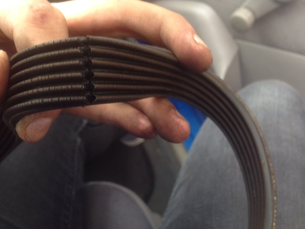

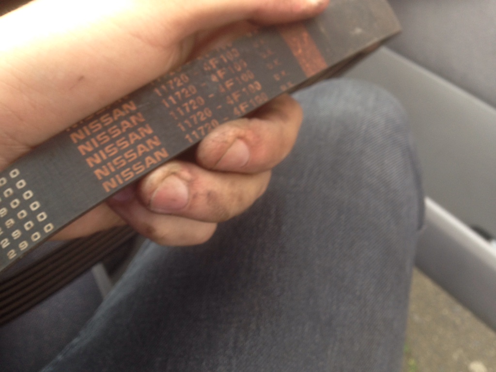

I half replaced the drive belts today. The alternator belt was easy, but the water pump / PAS belt I couldn't get off. The face lifts don't have an idler tensioner. I THINK I can see a tension adjuster on the back of the PAS pump, but not too sure and I didn't have a spanner that could get to it or the locking nut.
Also found out that the crossmember is worse than I thought. With the splash guard off, I managed to poke a large hole in the right third. That will be a job to replace soon! Can't be much harder than getting this bloody belt off.
The alternator belt was Nissan, presumably from factory!
