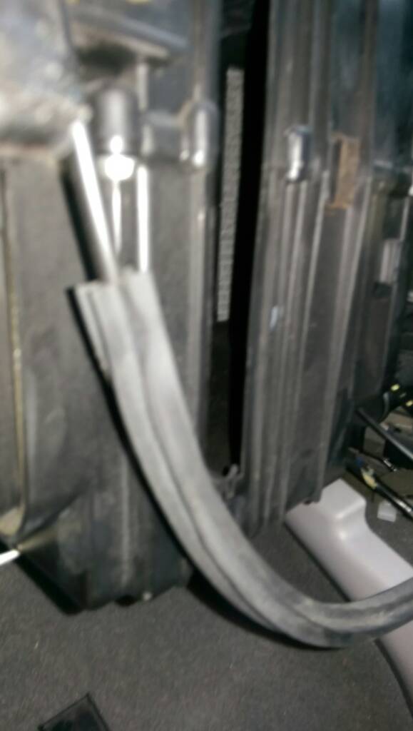

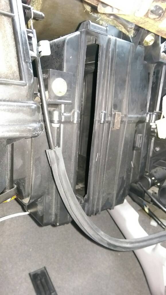

Is it possible that mine doesn't have a pollen filter? I mean it has air con but I cant seem to find the pollen filter where it is meant to be...........am I missing something?
attached are few pictures I have taken.
Mate i have the same car and havent found a way to change it yet
Weird, if it's meant to be behind that thin strip that slides out, as I have nothing there. No AC either. Then again I think I have a unique model that Nissan threw together with all the spare parts.
Did you cut that plastic thingy? I also have K11 1.4 x reg (2000) without the AC and the pollen filter if hidden behind the plastic in pic 1
The part everyone else has been cutting out? No, I had the entire dashboard out.
There's a tall black strip that slides off (attached by a metal clip) but it's empty in there. At least I think. I'm going to have another look tomorrow when it's light. There might have been a filter in a different location.

I've got a 1999 Nissan Micra and just done the same thing!! Cut mine and looks like yours. No opening to fit new filter!!!
I've got a 2002 K11 and I have the same thing. There is a filter but I don't know if it possible to change it. I removed the clip and screw (IMG_1364.JPG ). I couldn't open entirely for the moment. However, I saw a large filter inside the box.
