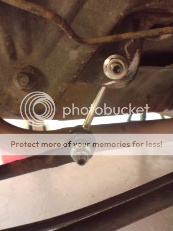

Another question :) Since mine is a Super S and it has antiroll bars can i swap all the Super S parts into a normal 1.0 micra including rear sway bars? Im guessing the 1.0 doesnt have these so i would need to weld them on?
