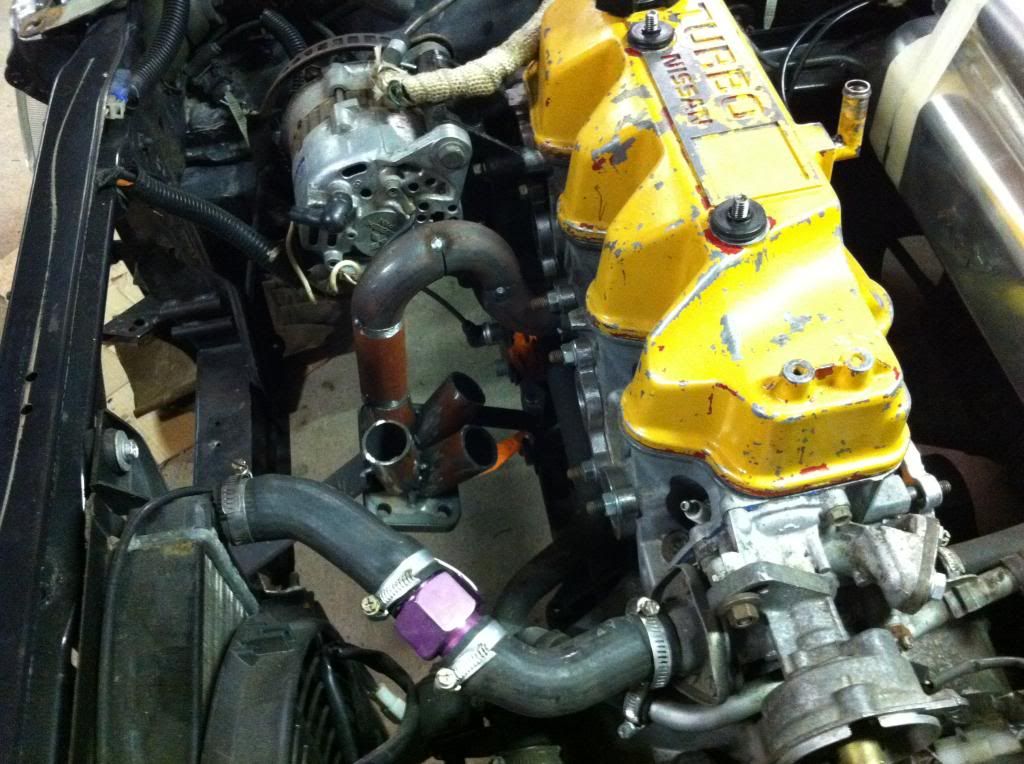

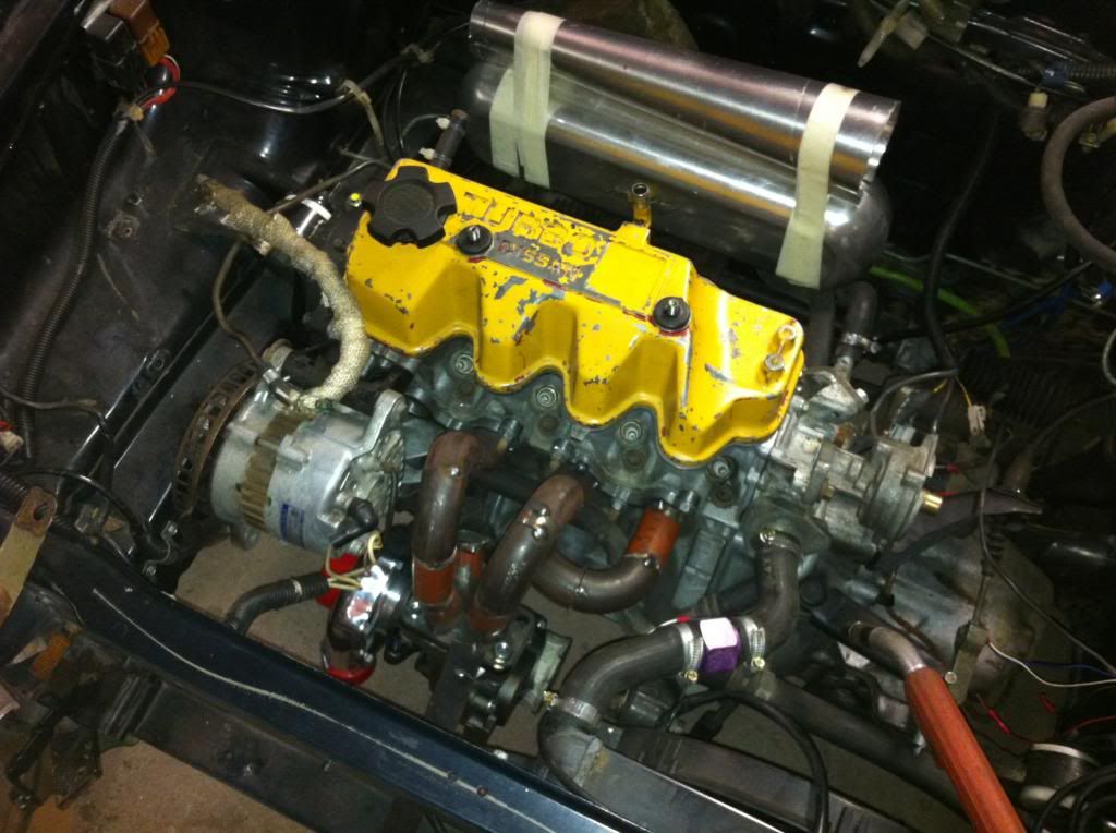

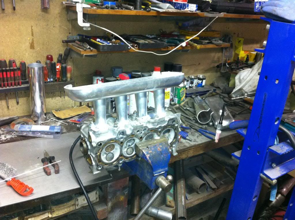

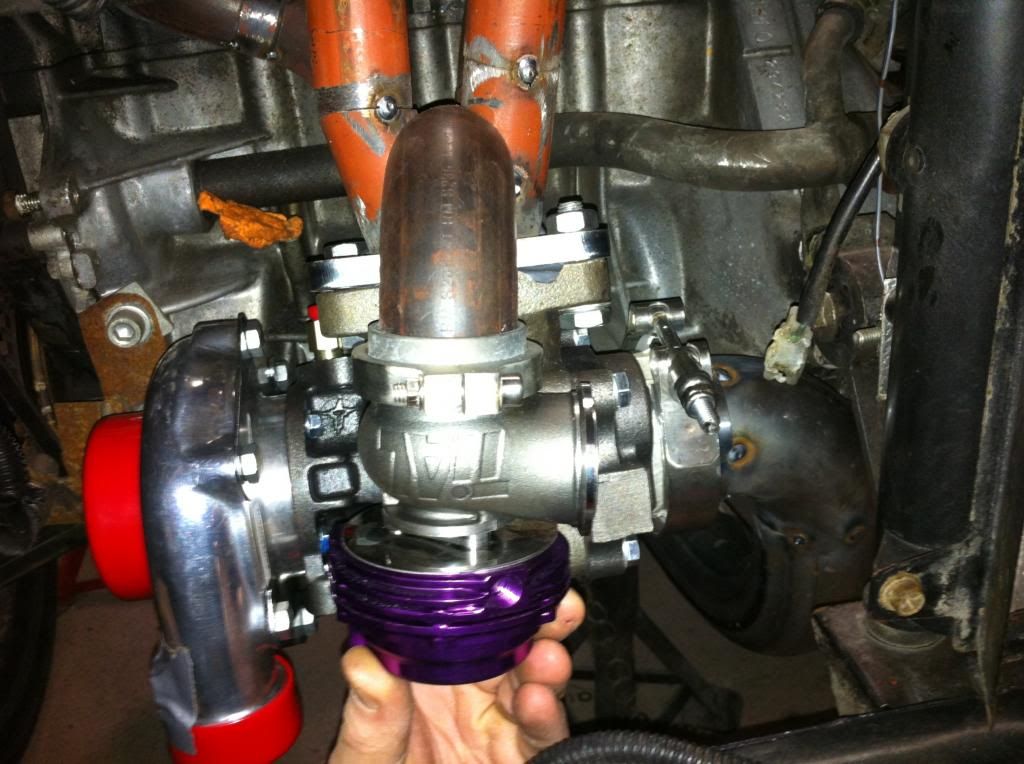

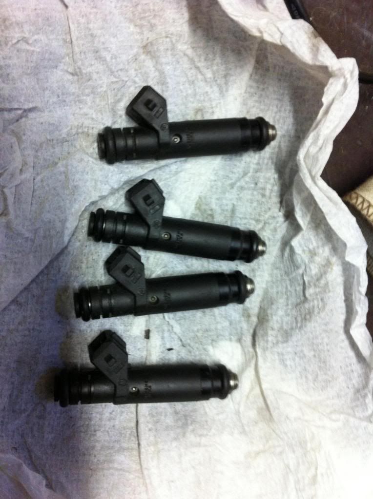

its a turbo head and inlet manifold the rest is self made. ive bougth new injectors and going to try E85 next season an try how much the engine can stand, hopefully getting 180whp ?? time will tell :)

I'm building a turbo k10 too, but I'm using bike carbs and a t2 turbo

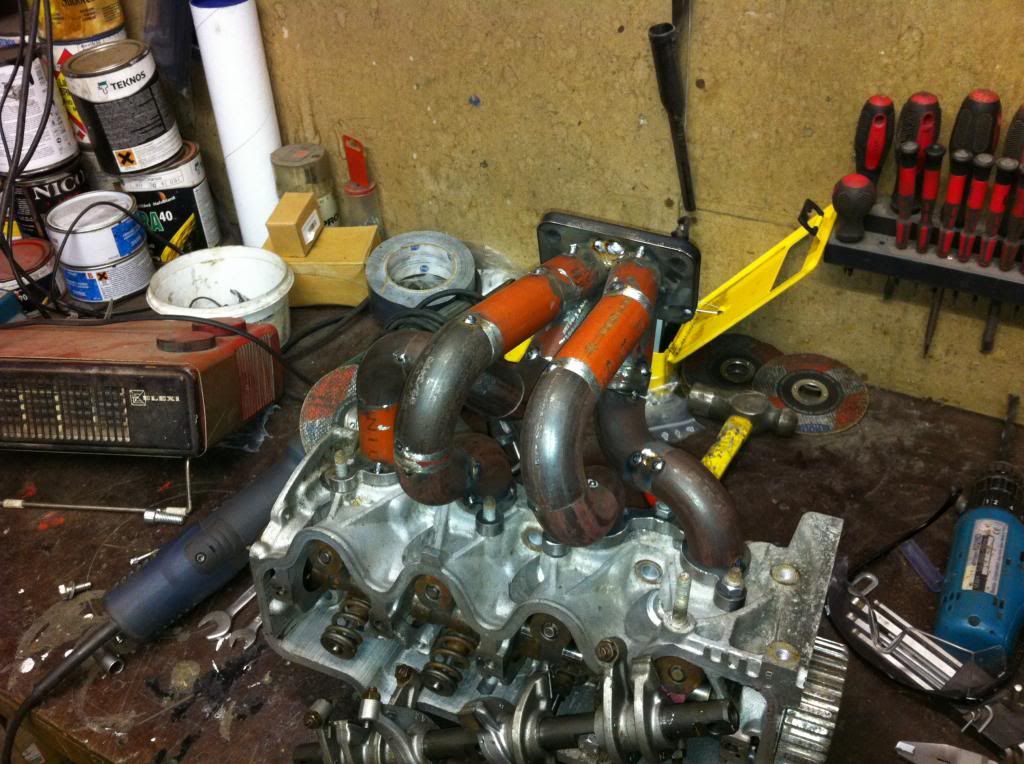

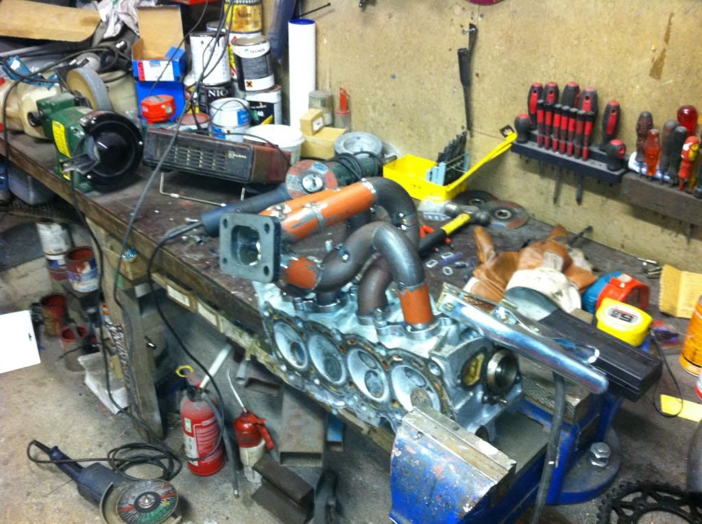

Good luck with that. Engine wont last a day in my opinion. The head will be lifting off the block lol

That was on my mind too?

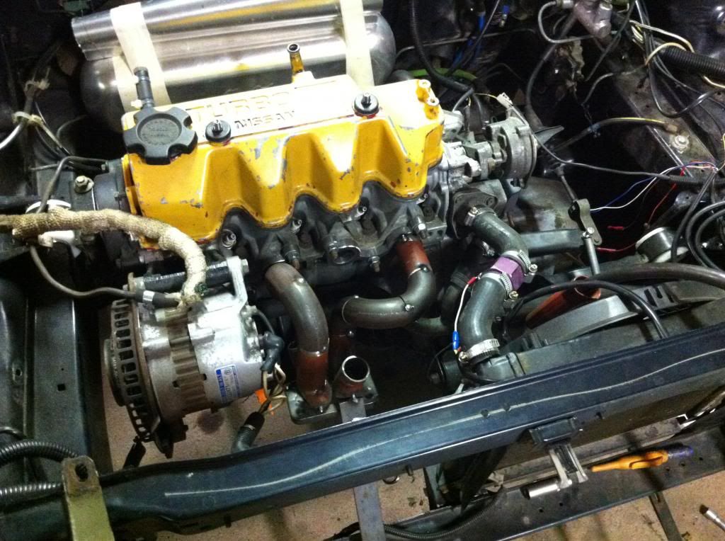

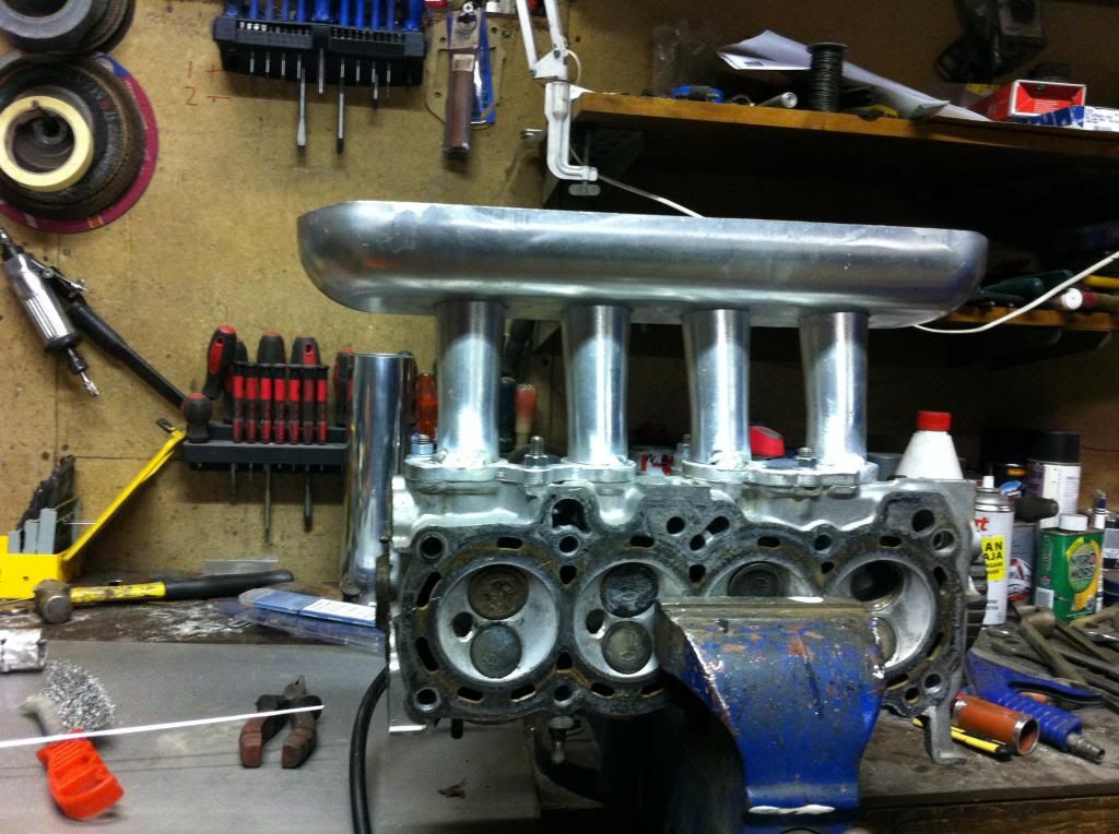

Where did you find the head, intake manifold and the injection unit?

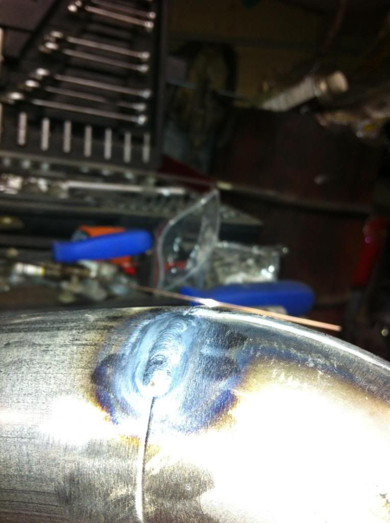

its 1mm piano wire.. the manifold and the head came with the yellow micra when i bought it!
what is an injection unit?? :)

the main its a walbro 255 and for secondary pump i have a volvo 740 witch feeds the catch tank.

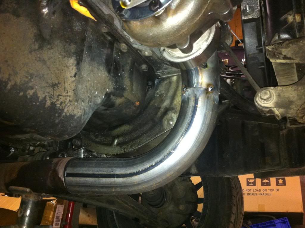

the catchtank is for the oil ? (because of the low slung turbo)
and its a stock K10 gearbox ?
OP
OP
E34 RRT

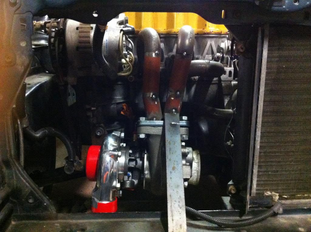

the thing is i have a "catch tank" under the turbo too because i have a pump that suck the return oil to the engine!
and the second catch tank is for the fuel so that the main pump gets the fuel its need in thigt turns etc..
and yes the gearbox is stock :)

Have you dry sump system on this ? And a fuel swirl pot to stop fuel surge? That is seriously cool man
OP
OP
E34 RRT

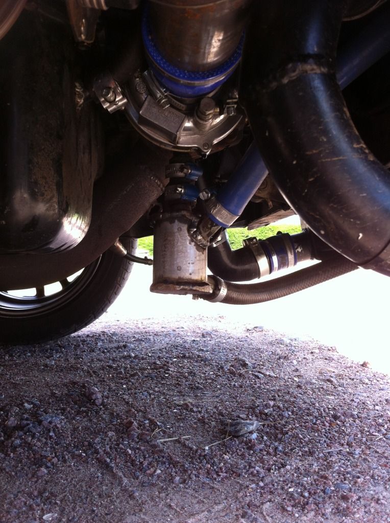

no not dry sump,but an oilpump that´s pumping the turbo return oil to the engine.. because my turbo is installed below the oil level....
yes i belive its called - fuel swirl pot- you can drive without this system but you must have over half tank all the time then....
a picture of the oil system,there is a blue smaller hose there is a breather filter, to eliminate underpressure in turbo.

Hi, what pump did you use for the oil return from the turbo

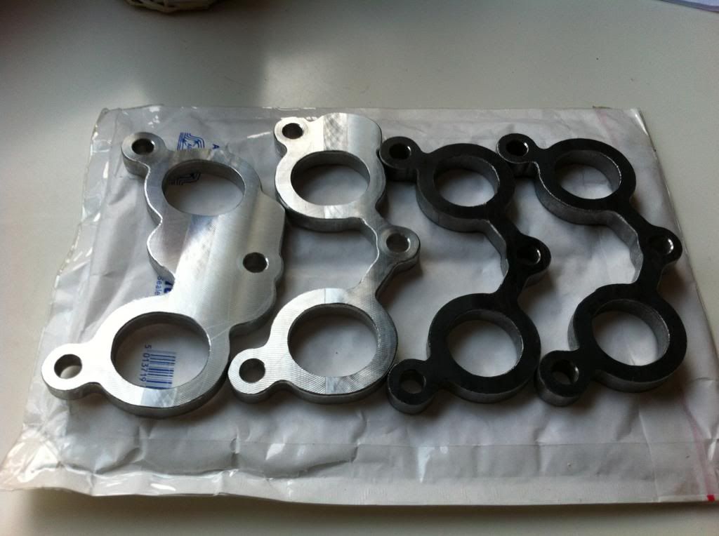

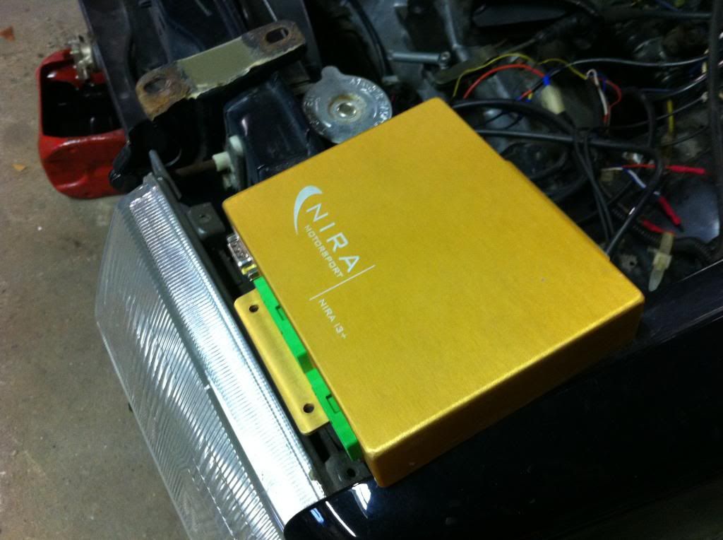

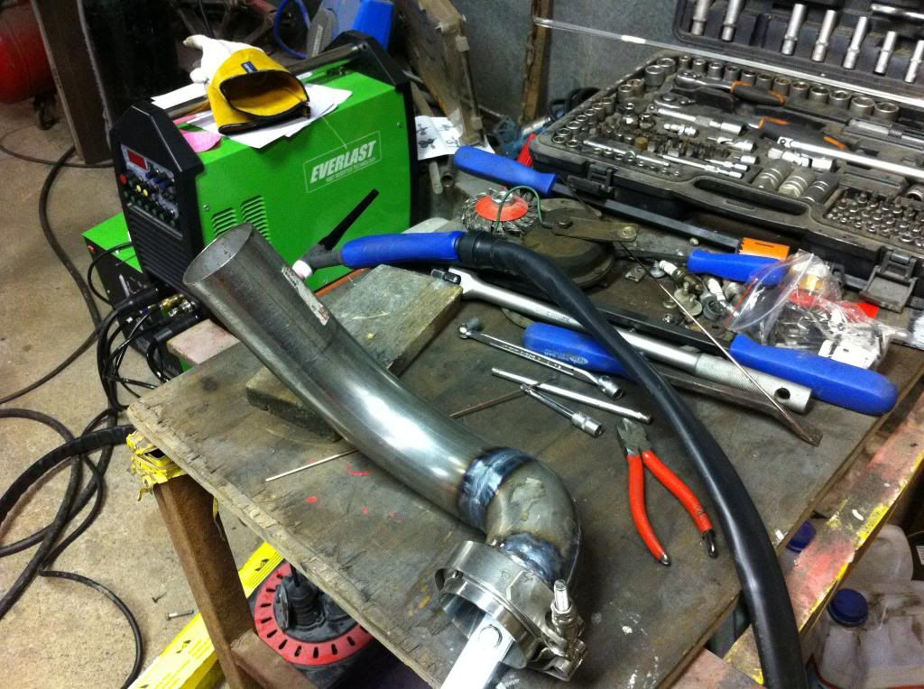

i have bougth some new parts..
WRC-type inlet manifold,NIRA i3+ ECU,630cc injectors, and some other parts thath will bi comming soon.
some pics are coming upp soon..... stay tuned.. :D
OP
OP
E34 RRT
today is all the elektric work done and the weekend is planned to do some mapping!! :)
so lets hope everything is working propperly!!
