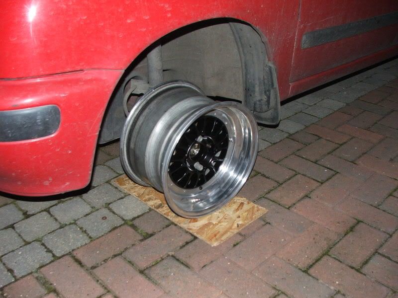

i've managed to fit my bbs 13 over the gtir setup so certain 13 will fit the gtir setup
i doubt it (not calling you a lier though lol) but the GTIR setup with the 14'' wheels is very very tight, theres only a 5mm ish gap bettween the wheel and caliper!! it would deffo rub on the alloy with 13'' wheels...
Agreed GTi-R wheels barely leave room for a Rizla between the caliper and the rim.
Are you sure that those BBS are 13" and the brakes GTi-R?
ye very sure took the brakes off a gtir myself and they have the right codes on the callipers aswell.
here it is

Nissan GITR / GTI Sunny/ pulsar / Almera calipers fit a k11 and can only fit a min 14" (above picture exception to the rules) I know because I have fitted them to another micra!
