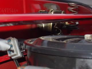

The other little job i did this weekend was to replace the Drivers side Door Pins and bushes,
so the door now shuts and opens without dropping...splendid! :)

I managed to aquire some off fleabay. But they should be quite cheap at your local Nissan dealers. You'll need 4 Fozzy-Bronze bushes, 2 pins and 2 clips. It shouldn't cost more than a tenner....hopefully :)
The Bushes need to be pressed in with a vice, if you can get the hinges off then it makes the job easier.
The Hinges can be bent out of shape if hit with a hammer as i've found out in the past.... :down:
The edge of the wing did get in the way of the Bolts holding the Hinges on but i sorted that by just pushing back the inner flap on the wing half an inch or so...
The Bushes are slightly bulged (see pic) so when they fit in the hole they squash slightly making a it a nice snug fit for the pin.
It can be a bit fiddly...all good fun tho' :)

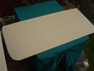

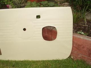

Door Cards re-covered
On with the Show! :grinning:
Decide to re-cover the K10 Doorcards from the original Grey to a lighter colour.
After that came the obligatory Hole cutting.....
...and fitment of said re-covered Doorcard...without the speakers...i had bought some speakers earlier on in the year, very nice 'Fury' ones but found that they don't go into the speker Hole as the fins that hold the Speaker up are too wide.... :doh:
So i found some more speakers, this time they were from that white Micra i had (now gone)...went to fit them and found that they were too small!!! :doh: :doh: :doh:
(Mark on the Seat is from the reflection from the Camera Flash bouncing off the Window)

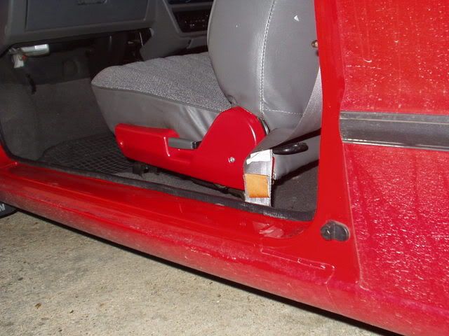

....decided to spruce up the plastic cover on the outside of both Seats...
....more to follow... :)

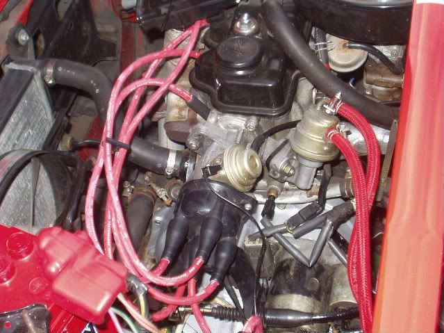

How did you clean the engine bay up that well? (Unless it was already that clean...)
When i first saw the bay i noticed that it was covered in this hard grease stuff...so through a bit of hard work, replacing old for new Bolts and lots of time thus the result ...so far... :)
It is in no way perfect as i've to replace all the Rubber Pipes and Clips, get the Carburetter polished, re-paint the Bracket just behind the bottom of the front Bumper, front and rear Strut Braces and also getting a few bits Anodised and generally keeping everything neat :cool:
I think the Engine bay gets dirty quickly especially if you don't have the plastic guards in place.

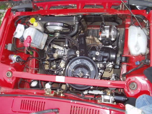

After reading the Figaro strut brace thread i felt compelled to get one....so i did! :laugh:
It fits perfectly and the handling has improved the 'squishiness' in the corners :) Bloody quick delivery too....2 days :wow:
Plenty of room to remove the Air-box Lid :)
that engine looks brand new!! what did you change when you got it....
luckily i had some sort of protectant covering the engine bay...in fact it was everywhere! lol! So to get it all off i used Gunk, Brasso, Poorboys SS1, Barkeepers cleaning powder, Meguiers(sp), Autosol, Petrol, Autoglym, Wheel cleaner and...er....some Furniture Polish.....also i got through alot of Rags...oh and you find one arm gets bigger than the other! :laugh:

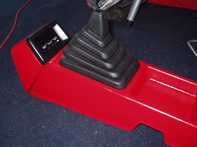

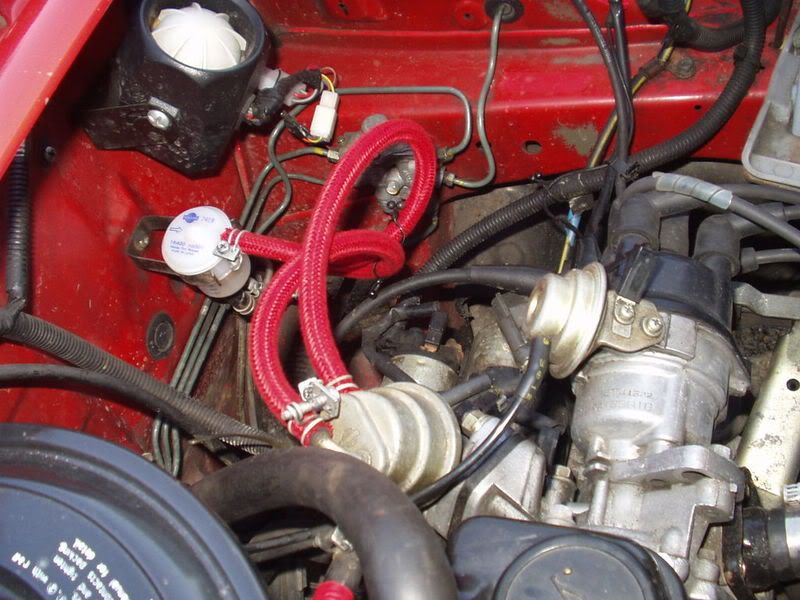

Centre Console painted in Toyota Red and Laquered

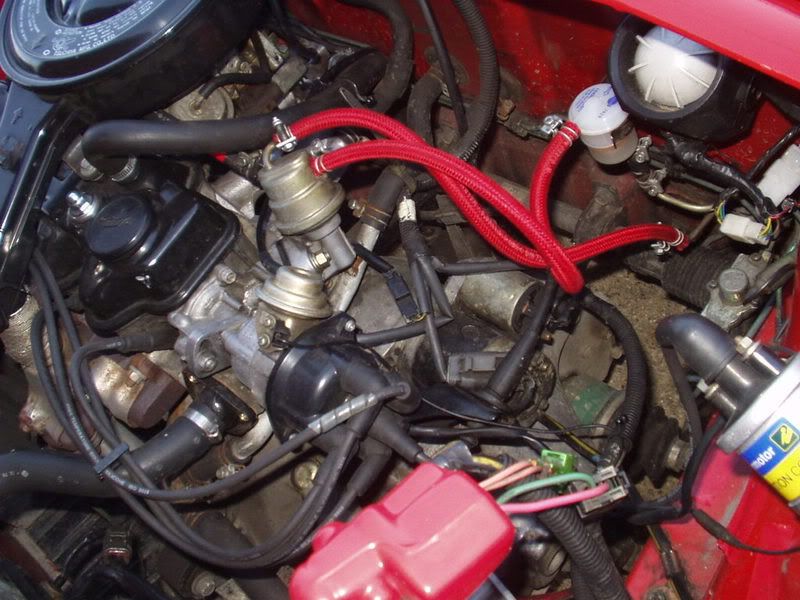

Petrol pipe off Ebay, Nissan Fuel Filter and Rocker Cover nuts and washers :)

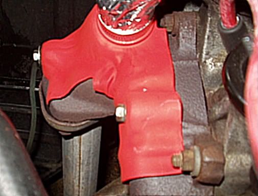

Paint front Engine Mount

More bits added
I havn't done this for a while so an update is in order.
Carrying on from the Console i decided that the back Brakes were on the low side so i replaced them. Cost was approx £20
Then the Water Pump and Timing Belt was changed which cost £90
We had a recon Gearbox fitted which looks very nice :) a New Clutch, New Clutch Cable, even though it bites a little early on take off i'm sure we'll get used to it as it wears in over time...cost of Fitting inc VAT
Also delivered yesterday were the Triple Silicone Red HT leads which cost £7

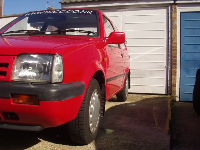

Micra 110, tis a lovely looking car you've got there! The only thing I'd say (and this is just my taste I suppose) is try to avoid colour coding everything, it can make a decent car look a bit cheap.
I know what you mean, i am trying to keep it conservative honest! :laugh:
I think that's the problem with modding, keeping it in perspective and not going OTT. :grinning:

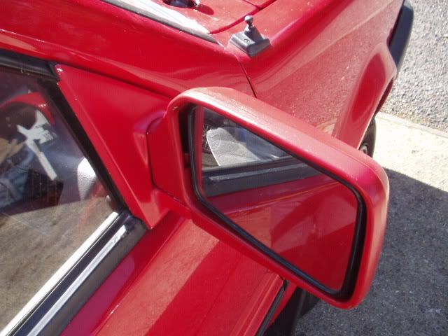

Seeing as my last posting was rudely removed by the Hackers i shall do it again...
As i said before it's been a while since I've done anything on the Car but last week I decided to Paint something a little different to the norm.....
I've also replaced the Bumpers with a colour coded 525 paint job. :)

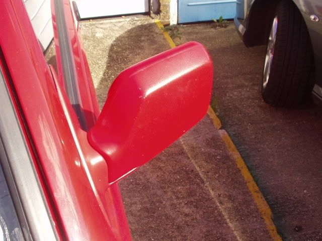

Flamin' eck! i hadn't realised how long it's been since the last post! :eek:
...Anyway, I've been doing a few things over the last couple of months, I finally fitted the rear Top 'Super S' Spoiler after overcoming a few problems.
Replaced the Wipers with the Bladed ones and polished the Wiper Arms.

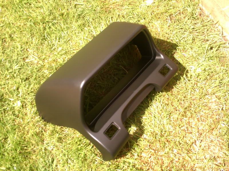

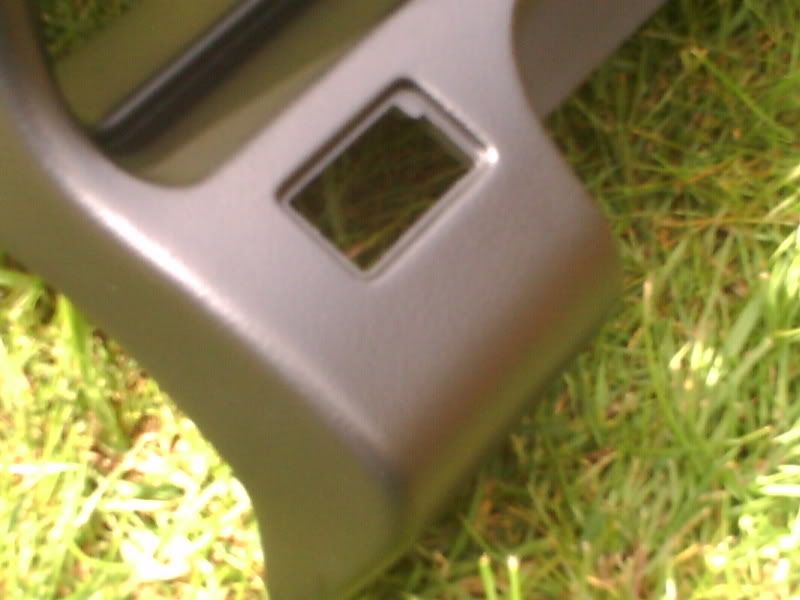

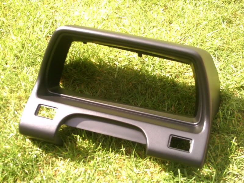

After salvaging the Speedometer Housing I decided to turn it from the Grey to Black. I did the usual sanding down, washing, sanding down, washing thing and got to work on the painting.
The finish isn't too bad, looks a little like imitation leather but the photo's don't show the colour, it is Black I can assure you ;)
I'll get some more pics up later when I can find some...lost in my comp somewhere :doh:
I've still to acquire some Wheels, preferably 14" with low profile Tyres, Lowering Springs which would make a 35mm drop and some side skirts. I need to replace the exhaust sometime in the future (4-5 months) so I'm thinking Stainless downpipe and straight through to the back with twin outlet (£350) ?
The exterior could do with a look at too so I'm booking in a bloke to give it the works (£100) for total clean and polish. the swirls on my Bonnet are horrendous! :eek:

Good job with the housing (Y)
