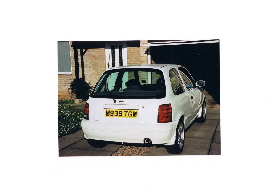

well the project started back in june 2001 when i bought a 1995 micra lx 1.3 as my first car, it was white, had colour coded bumpers, and side strips and was in pretty good nick. i paid £2200 for it which id saved up with my jobs since leaving school 10 months earlier.
the car stayed standard for a couple of months, with the first mods being a k&n induction kit, clear side repeaters and some 15" almera gti alloys.

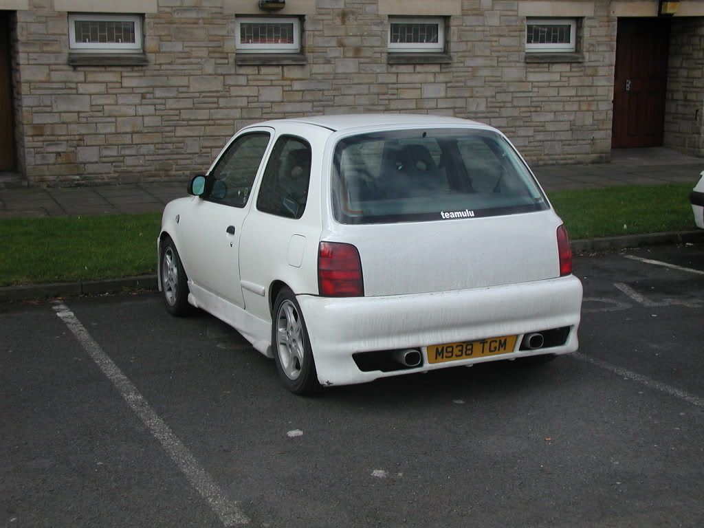

next up was a flush tailgate, again done by hadrain coachworks, i also did a bit of messing about with one of the side strips id removed and smoothed them into the rear of the skirts! the car by this stage was painted 3 different shades of white as i knew i was going for a full respray! also added was joey sheks old dual exit exhaust off his silver k11, i think this would of been early 2002?

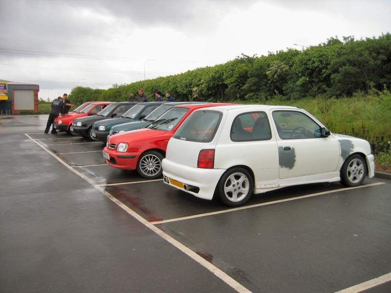

heres a pic i randomly found on cisco's site of the 1st ne meet...

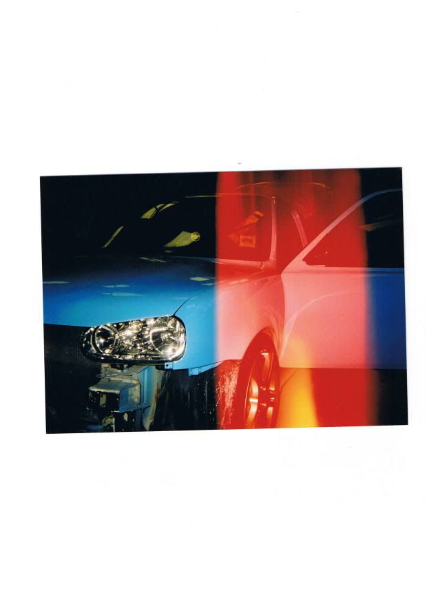

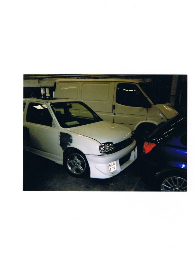

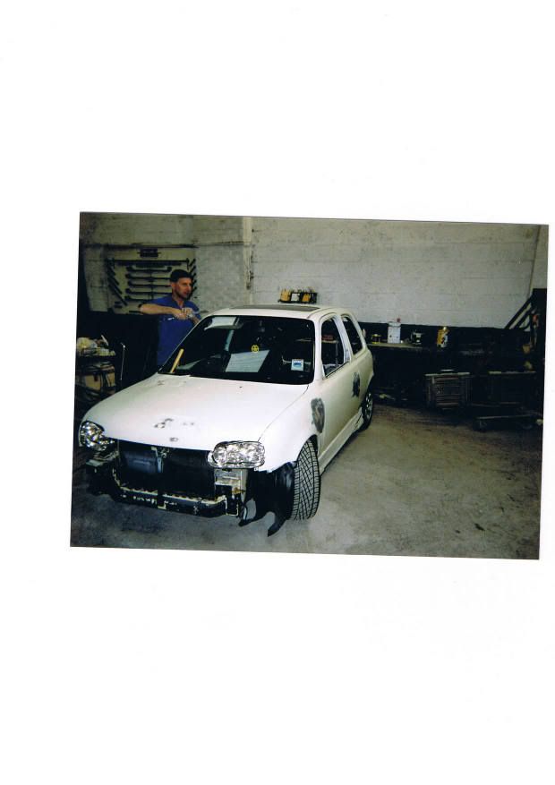

a few months went by and i had a plan to fit mk4 golf headlights to the car, this was when conversions were rare! so me and alan at hadrian gave it a bash over a few nights, it went really well with the only hitch being the wiring, as the micra ran a dim/dip system and the golf lights were seperate. this kept us baffled for a while, with one headlight coming on with the sidelights, we eventually sussed it out!! no pics of it in this state, but it basically had a standard bonnet which didnt fit the lights and a grille with the 2 upright legs chopped off! the golf lights caused a stir down at our old local cruise spot 'spillers'.

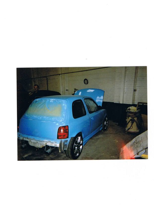

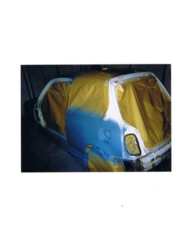

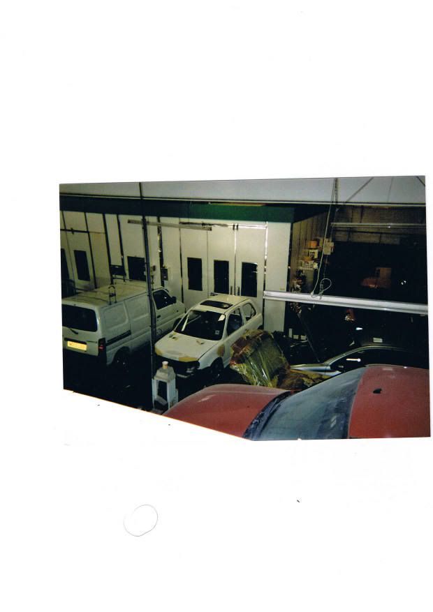

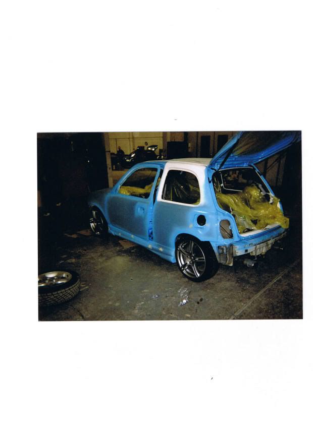

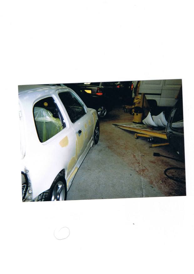

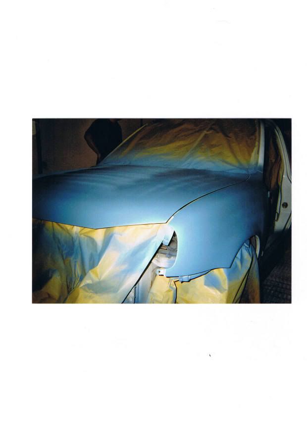

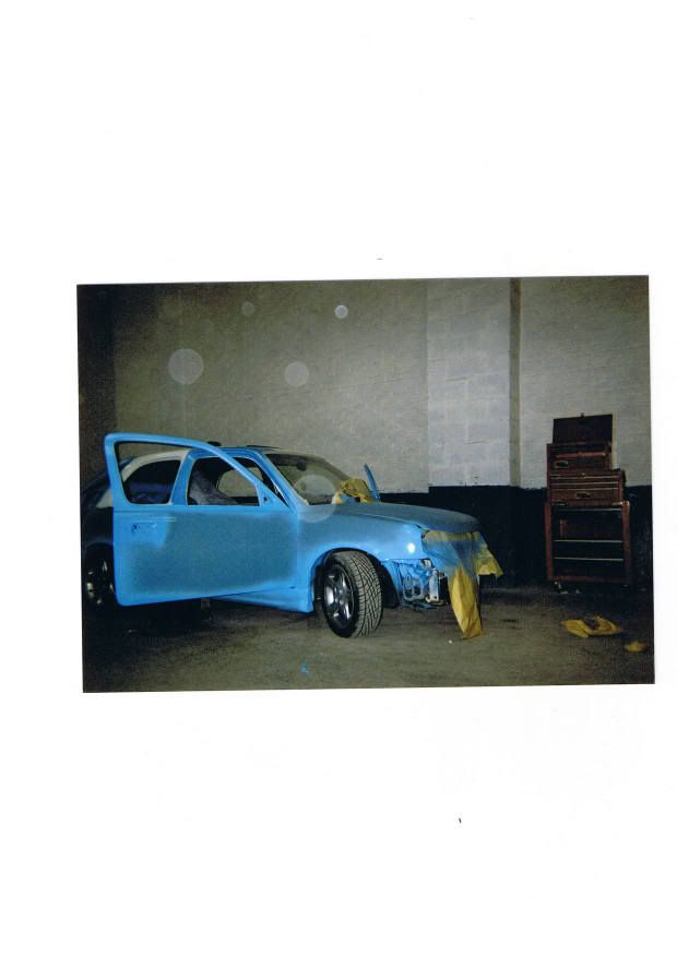

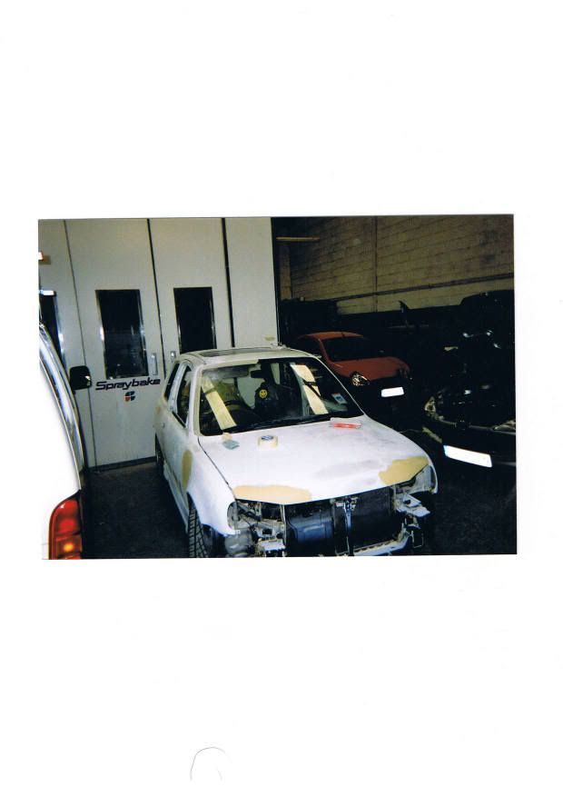

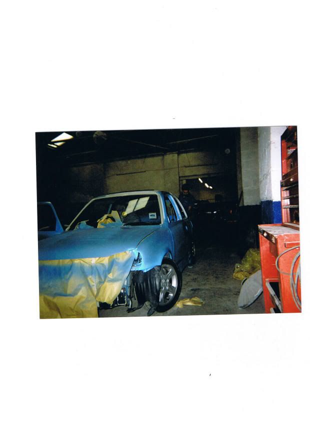

not long after this it went in for the respray, while it was in i got all dents and dings removed, the ariel smoothed off, bonnet bad boy'd, and made a grille to suit the mk4 golf headlights.

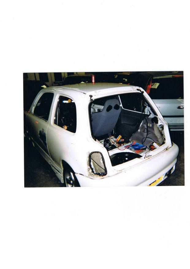

general prep...
add a bit primer...

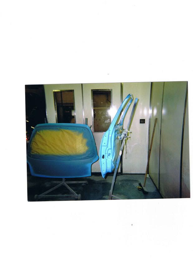

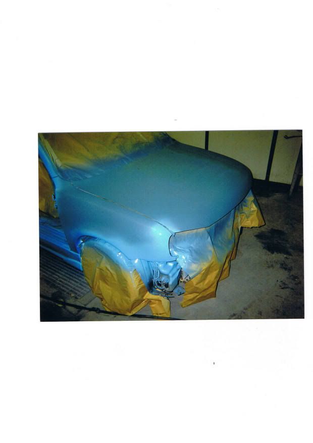

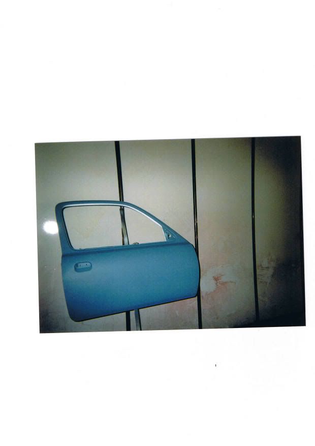

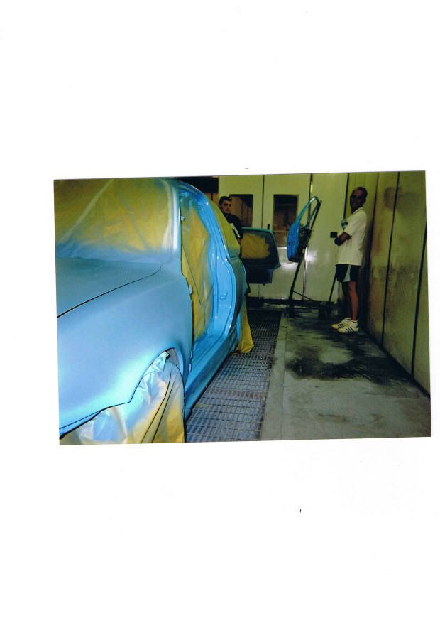

then the paint! wasnt sure on it but was loving it when it was on the car!
almera gti alloys off, 17" boss xts on...

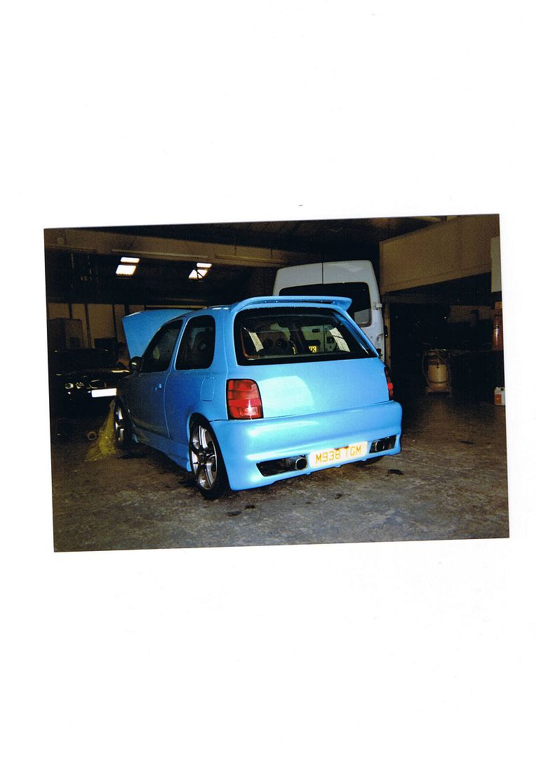

and final paint and put back together!...

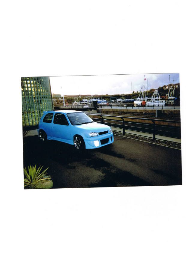

and some arty pics!...

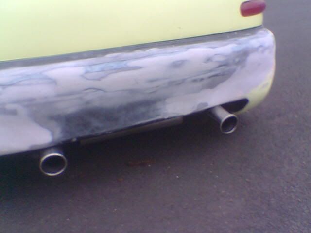

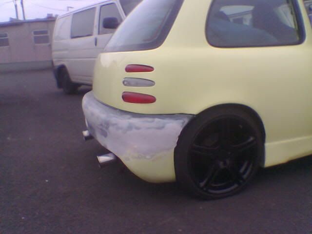

it was a 1950's english motorbike which spurred me on, after he politely drove into the back of the car! that smashed the back bumper and scratched the tailgate.

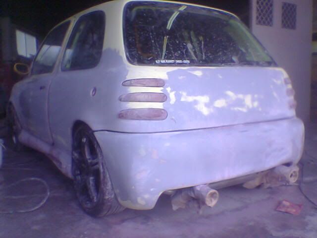

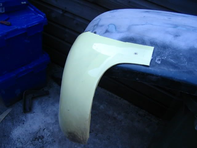

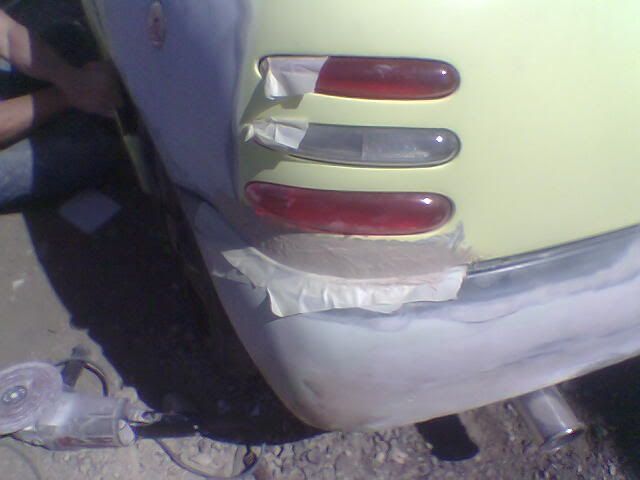

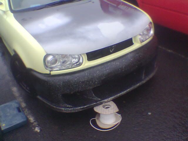

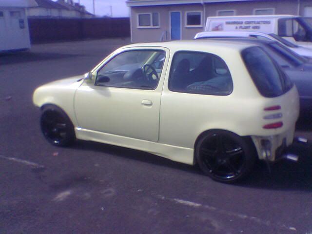

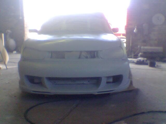

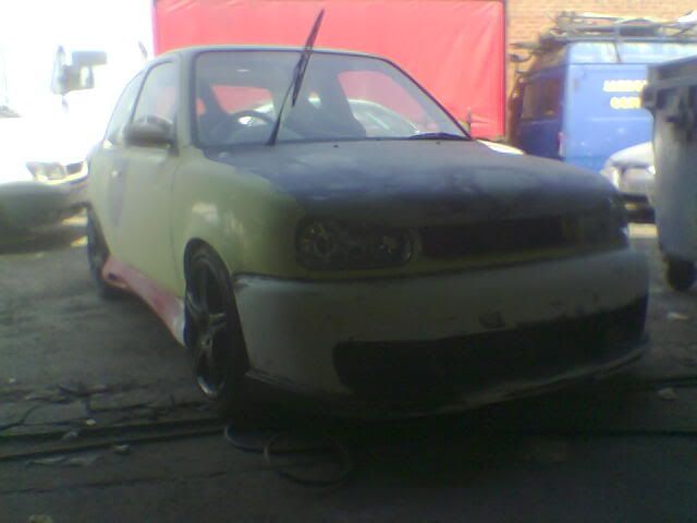

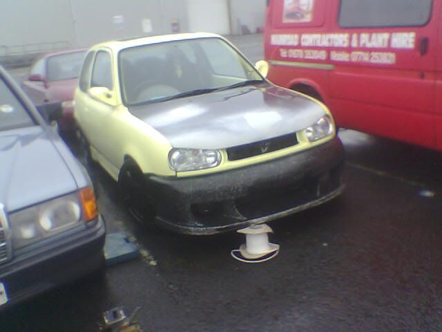

so off came the bumper and after a month of choppin, 'glassin and fillin' it was nearly there, the extended bonnet was binned for the 'normal' bad boy id done for the wide arch k11, the front bumper went the same way and was replaced with pink princess's nippon item.
heres the w.i.p pics at the minute, there will be plenty more to come aswell!

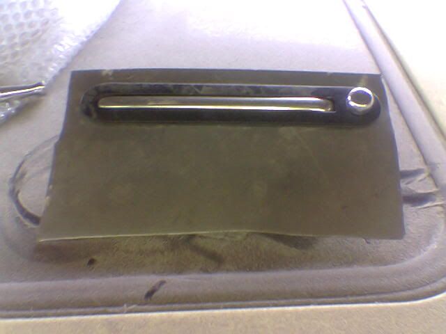

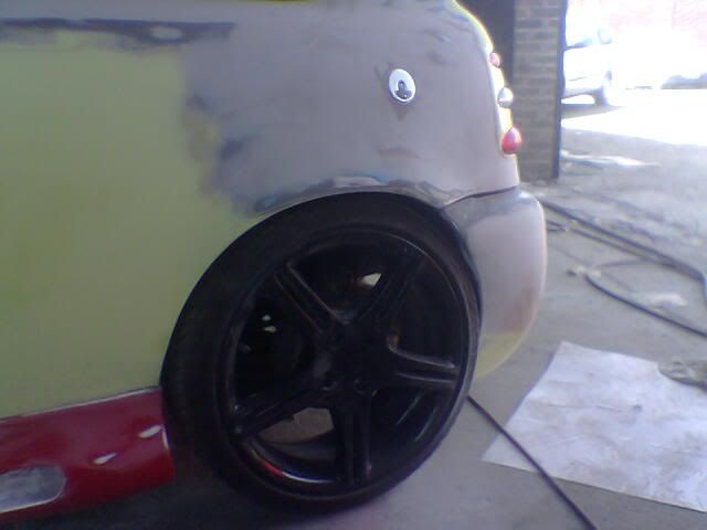

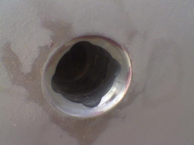

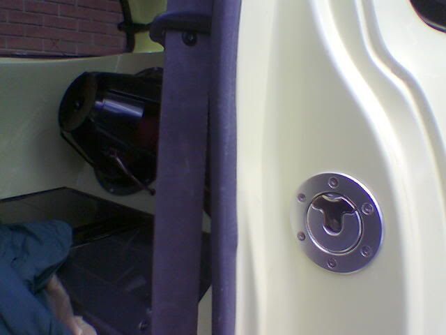

as a few of yous know i relocated my filler to the passenger door shut, and it never really worked. the reason for that is a mystery but now its impossible to work on it because of the fibreglass 'build!
all work is being carried out at mel horn, east cramlington ind est...
so ive decided to put it in the original postion, with a little twist, which wont look standard!
was scary, but heres the before and now w.i.p!!

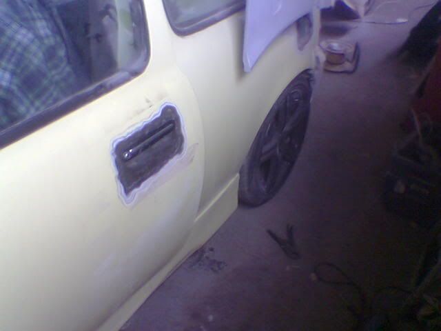

spotty dog mate!

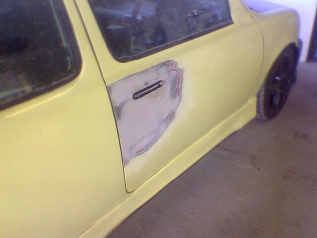

press the button in which opens the handle out slightly (enough to get youre hand in) then pull it more to open the latch mechanism.
in reality i think the latch might open when the button is pressed but that makes no odds!

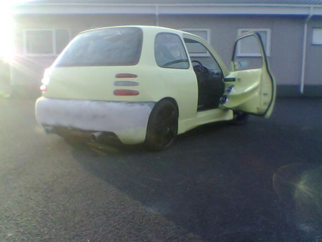

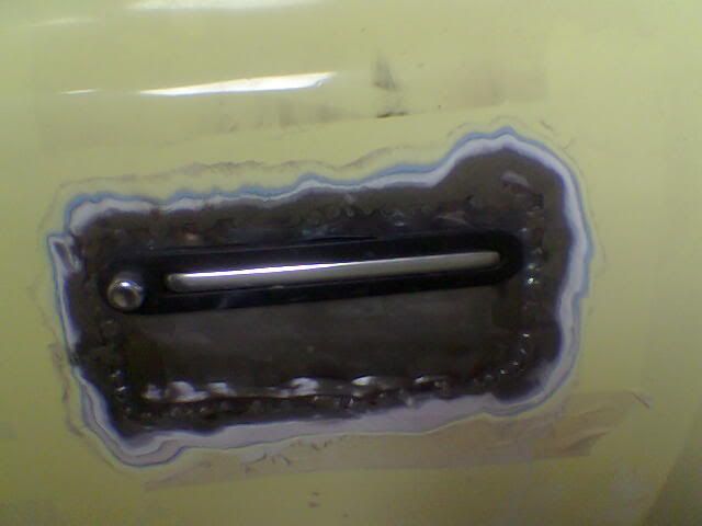

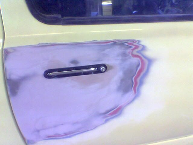

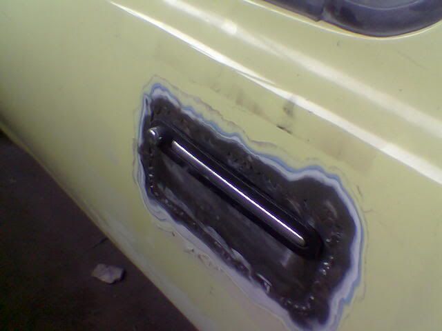

been waiting on a custom milled filler surround for 2 weeks which is holding everything up! couple update pics none the less...handles done.

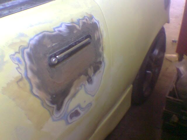

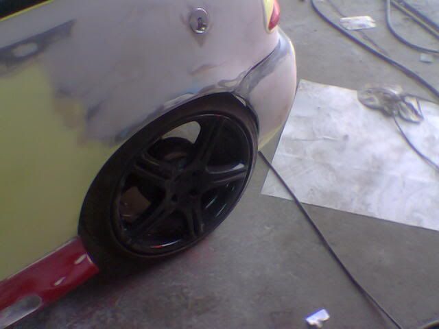

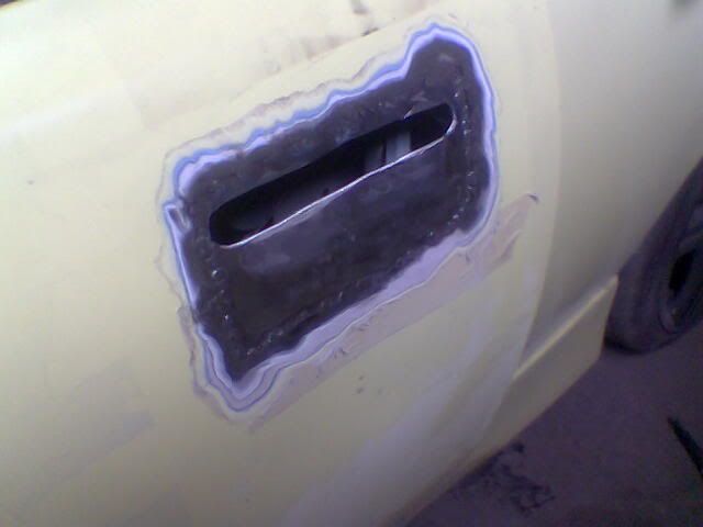

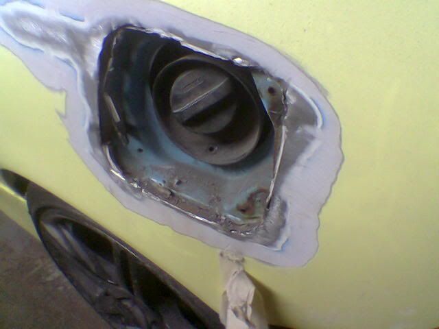

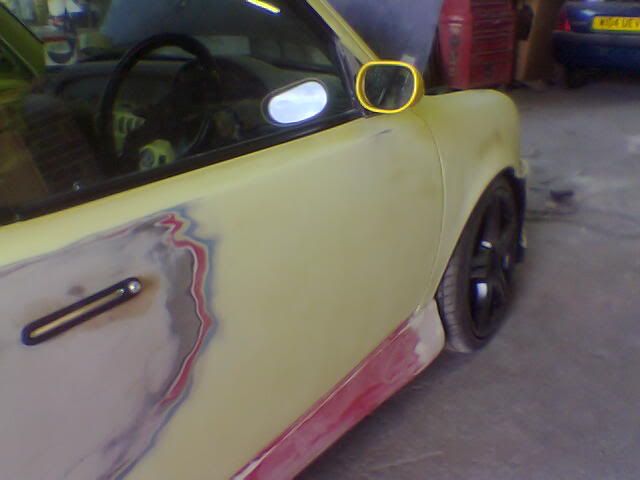

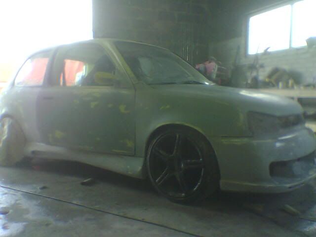

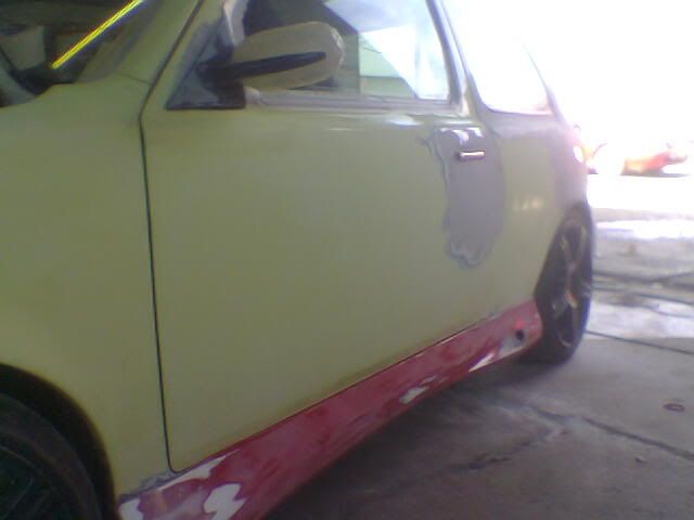

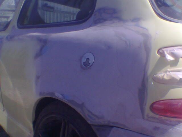

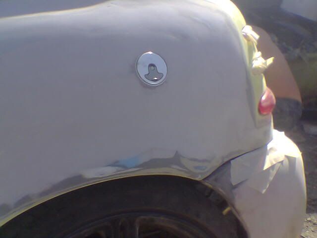

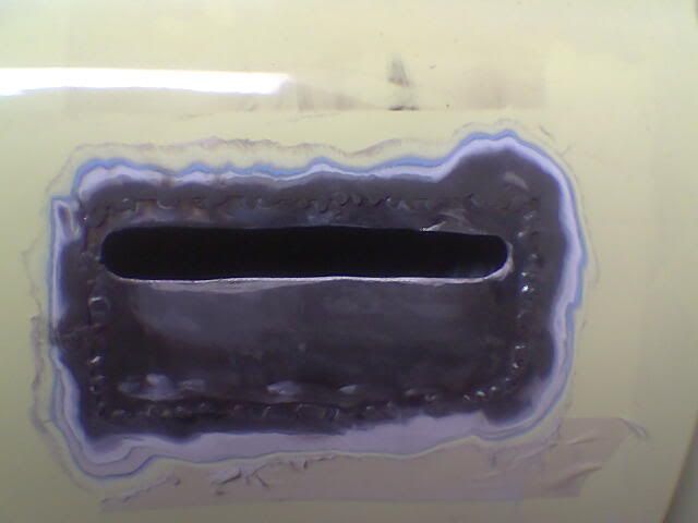

well the custom milled filler surround didnt turn up so it was decided we would make our own and fanny on for a bit getting it right!
that was welded in , ground down, 'glassed and filled...and everything seems hunky dory with it so far!

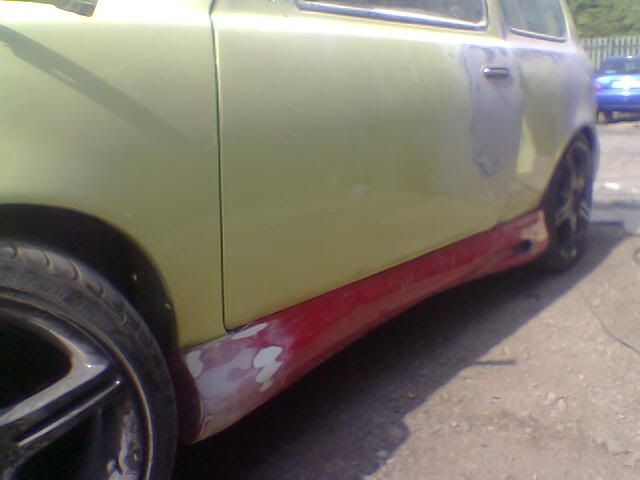

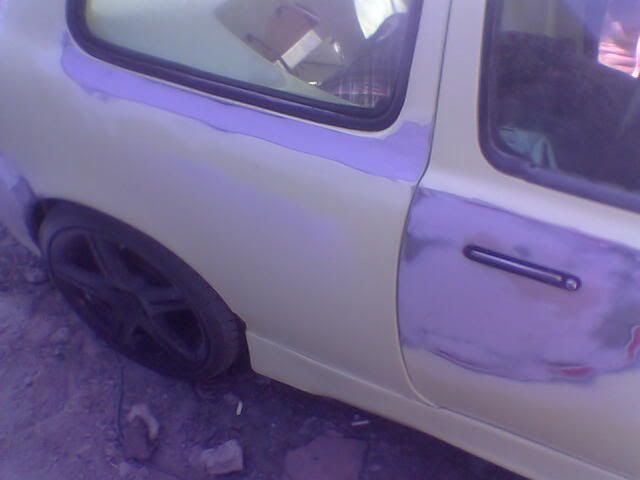

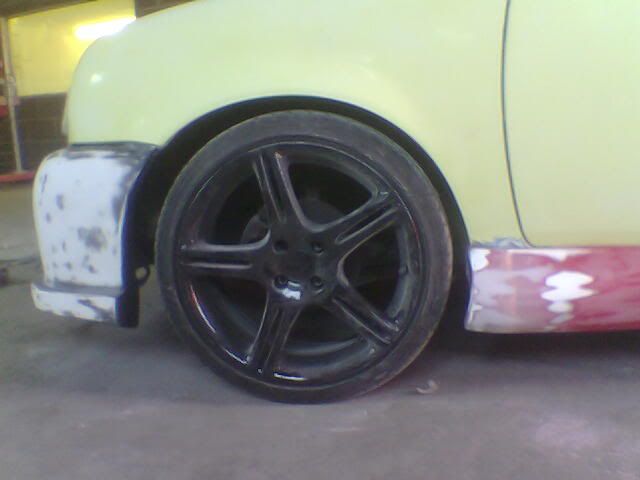

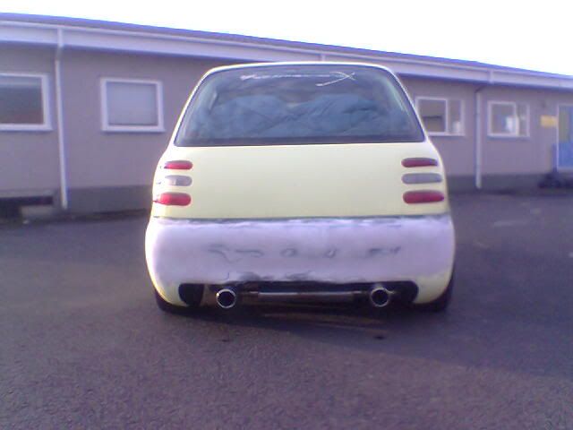

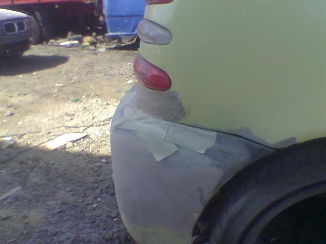

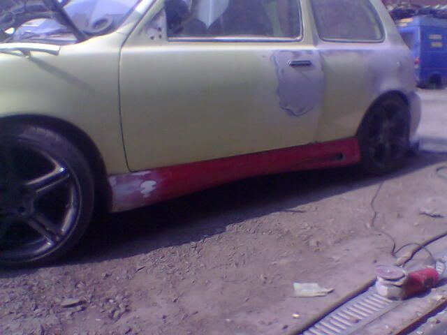

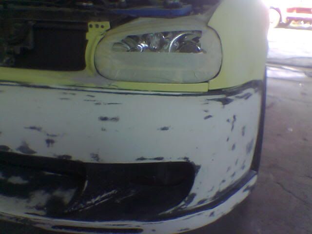

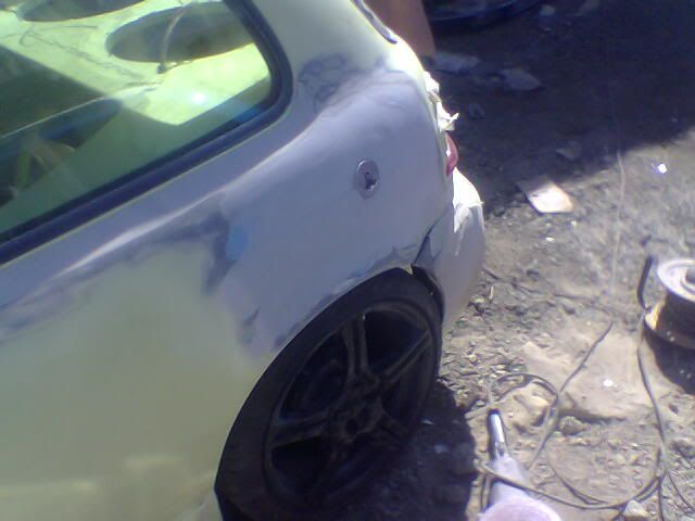

a couple other prep jobs were done like bringing the body line back in under the rear side windows as i want it flushed out at a differnet point. the rear bumper and back panel have been mated closer together to give a nice panel gap aswell.

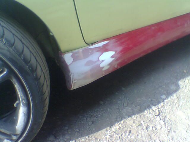

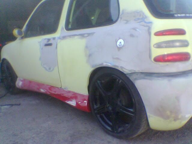

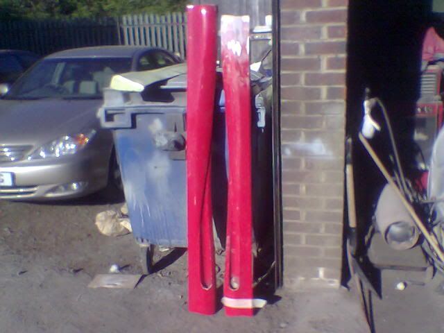

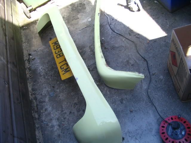

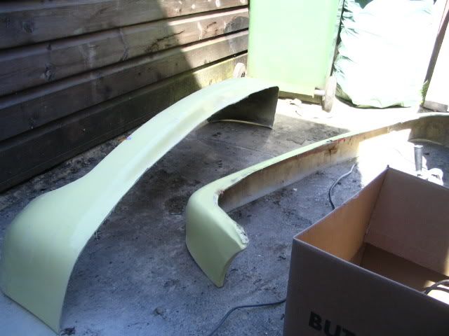

bought some second hand fiesta sideskirts at about half 2 this afternoon and had a bash at shortening them to fit. passenger one is ready to go on now, drivers one is another job for after work tomorrow!!

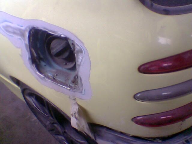

filler cap....
bodyline and bumper...
sideskirts....
getting there!!

micra man - nah didnt leave the surround off the filler cap, wouldnt have anything to turn and lock it into then! bought a weld in one from atl only to discover when it came it was all aluminium! no good to weld to steel eh! thats where the 2 week delay came from, a guy said he could mill the sleeve in steel but when he brought it over it didnt lock and looked a load of ####e tbh!

new filler is now connected back up to original filler and breather!

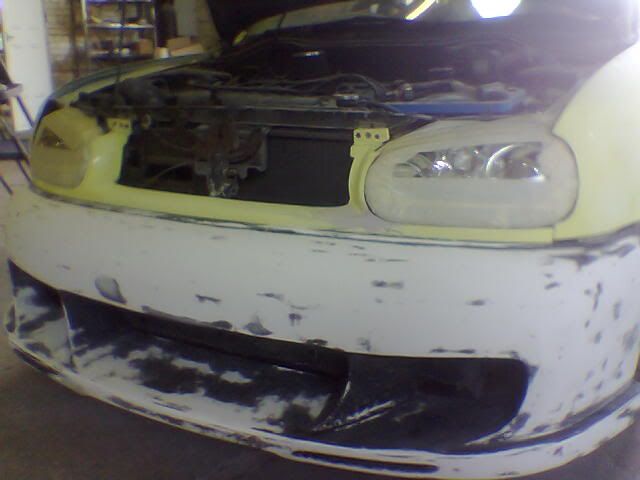

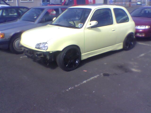

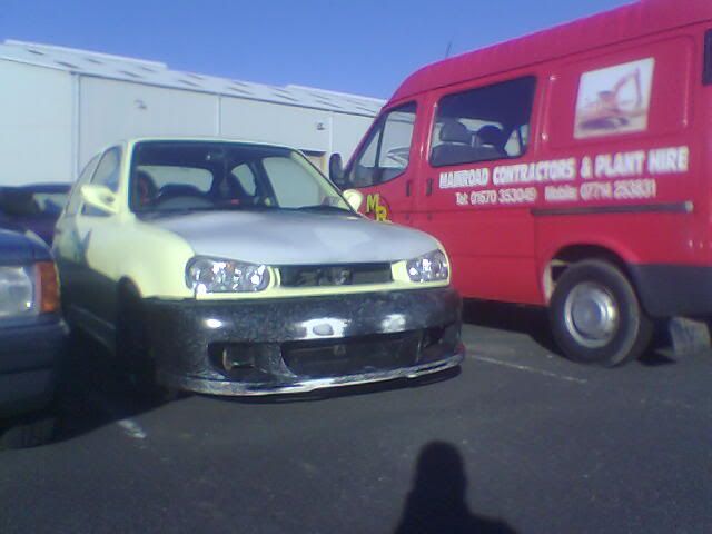

more progress!!
side skirts fitted,
fiat coupe wing mirrors fitted,
grille rebuilt and fitted,

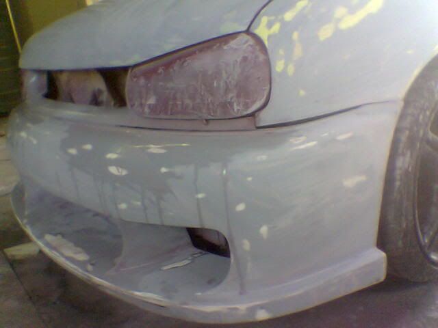

general prep...
getting primed later...

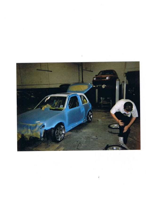

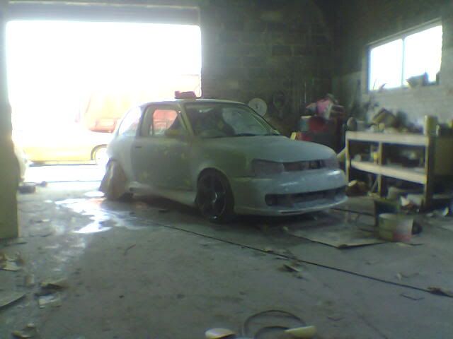

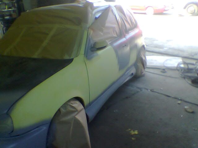

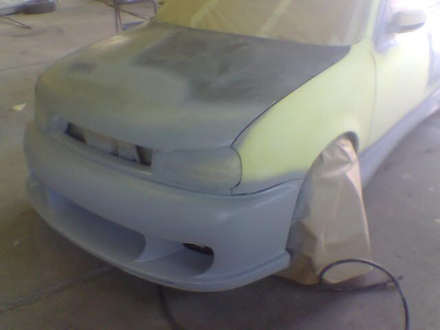

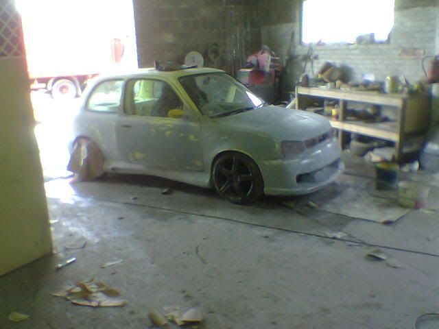

whole loada primer whacked on just before...
flattening down tomorrow, so should be paint on thursday...
then its a mad rush of new discs and pads and refit all ice ready for a car show on the weekend!

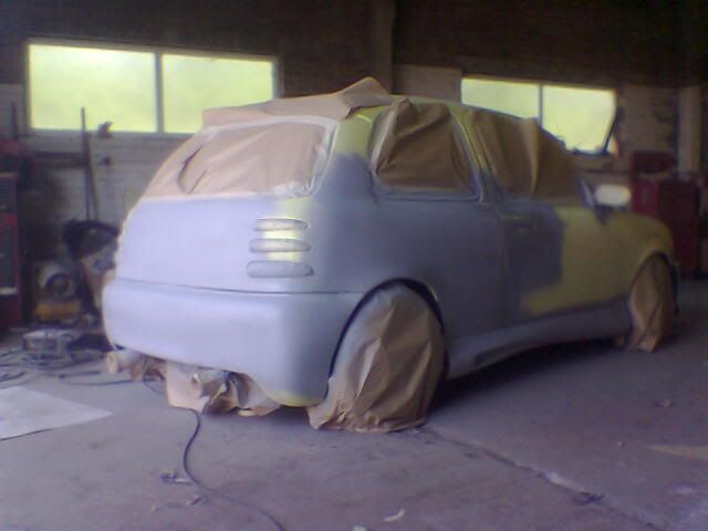

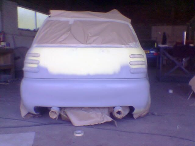

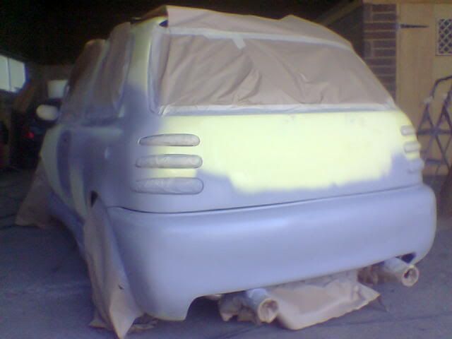

todays progress saw:
prime,
d.a flat back,
stopper,
guide coat,
hand flat back.
more or less ready to mask up now, should be masked and papered by 11ish tomorrow.
then if the paint comes, painted in the afternoon.
few more pics, mainly guide coat and hand flat...
actually getting excited by it again!!
