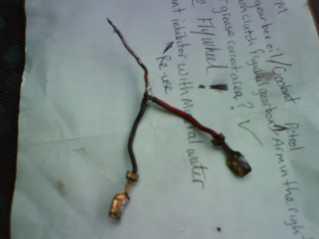

my 3 way wire

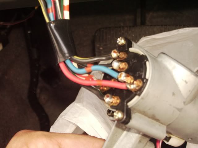

Dude, i have a March too and im talking about the correct colours. European K11 have 5 wires for the ignition switch, the March has 6 wires, like on the pic i posted.
Wires on the March ignition switch to the March loom:
White/Red -> White/Black
Blue -> White
Black/White -> Green/White
Red -> Brown
Black/Green -> Red
Black/Yellow -> Black/Yellow
