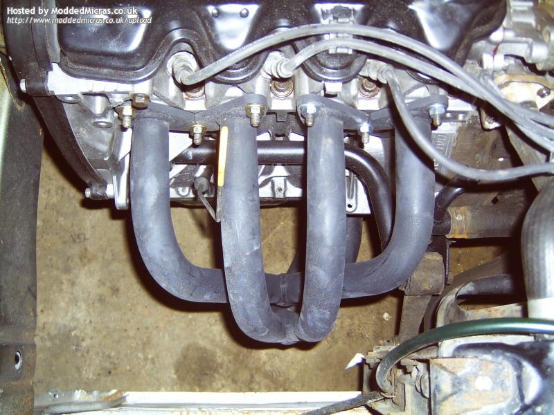

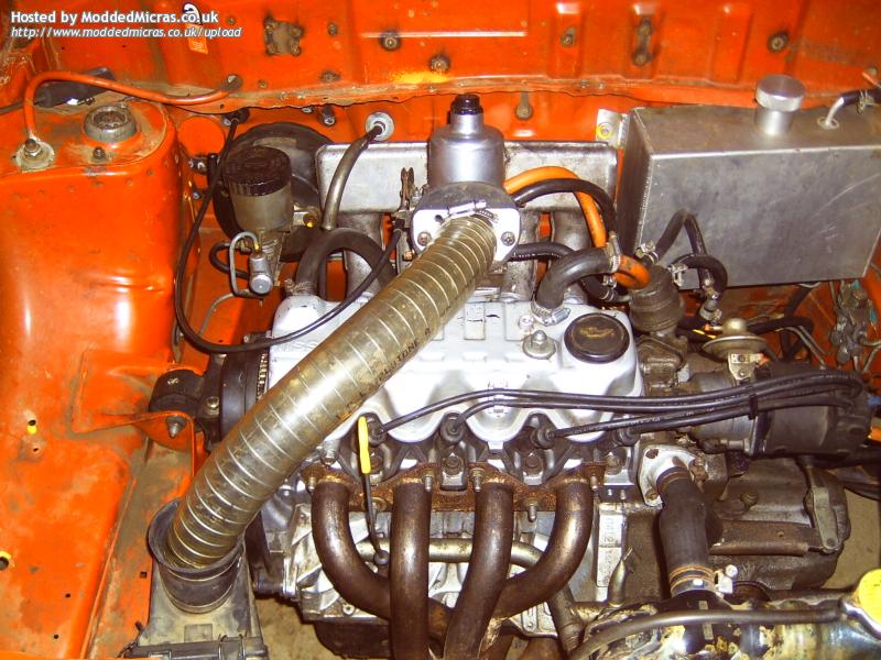

I think it should be possible to modify a k11 manifold yeah, although it's quite some money to fiddle around with. Need to make yourself an adapter plate for the engine and would need some work too on the exhaust connection I guess.
At the moment I'm trying to make an exhaust manifold myself, making the flange on the engine is already quite some work (although when using an exhaust manifold gasket you get very nice outlines how to make the flange).
When that's finished it's time to weld all the pipes together with the corners and the 2-1 parts etc. Once it's finished (which will take some time since I don't have much time) I'll surely post pictures and results
Anyway, getting one pre-made might be quite expensive because I don't think there are any aftermarket ones for the K10. And making one yourself might take some time and hard work. And adapting a K11 manifold might be expensive ánd some work
You made a new flange for the k10 or cut off the flange from the exhaust manifold? Because the existing exhaust manifold didn't look like good welding material to me, I thought it would splatter all over the place
Cutting the flange off a k10 manifold would be much more easy when it's good for welding.
Can someone clarify that the janspeed k11 manifold will fit in the k10bay with some space? next thing for my car (once everything that is half done is complete!) will be an exhaust manifold and i figure someone should try adapting the k11 one! also the next student loan installment comes through soon! could someone with a k11 and k10 handy give it a quick rough measure please.
i said i intended to do it, i wouldnt use either flange off the manifolds id get a k10 flange laser cut in steel or something like that then weld that on to the k11 janspeed (IF i did it) which i have not.
does no-one read? read my replay it tells you exactly what is required.
the k11 janspeed will not fit the k10 modification is required like i have already said
