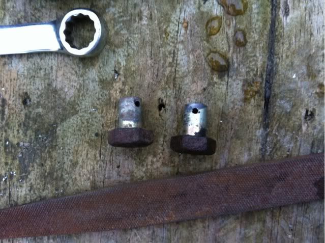

I don't like the plastic ones, the genuine ones won't rust thats why I've fitted them now.
damn so they were fake after all... that sucks, you might have to go for those flush plastic ones, at least they wont rust.

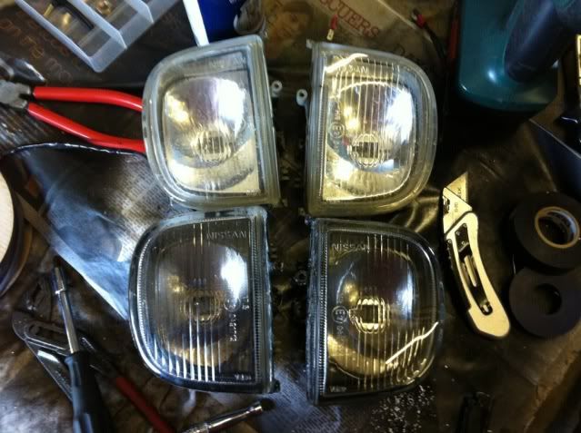

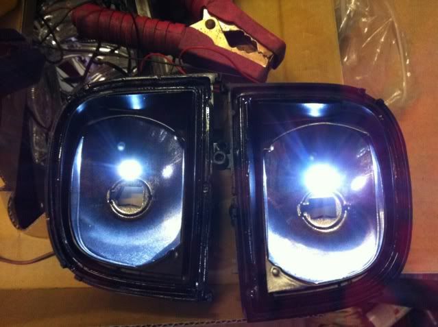

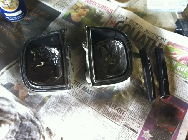

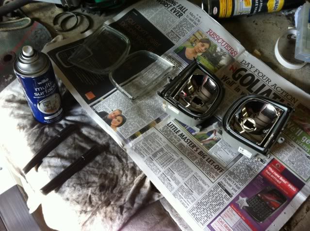

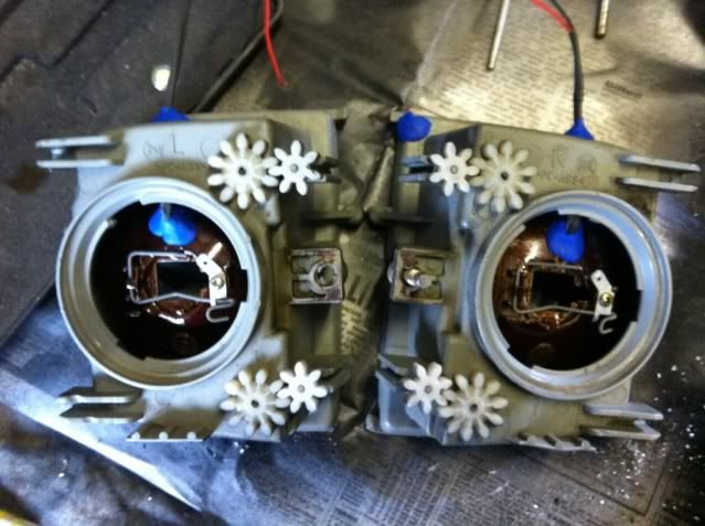

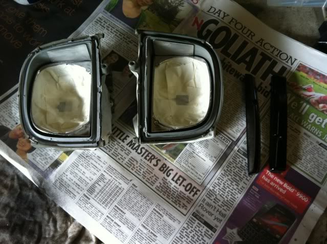

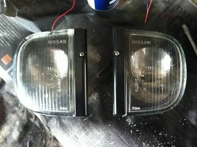

on the fogs, i spend ages with wire wool, cleaning the glue off the glass and silver paint off the plastic bits, then used black silicone and tinted the inside of the plastic bits, looks really factory,
Yer, I still have the set of driving lights and trims that are on the car now to fiddle with once these are on as I wouldn't mind fitting the indicator strips I have into them.
the worst part is trying to get all the silver out so it doesn't look messy when it lights up. also the LED strips might need a regulator, my LEDs have gone dodgy (LEDs should never be wired directly to the battery, as the battery goes from 6-30v at times, they should have a regulator on them so they will actually last)

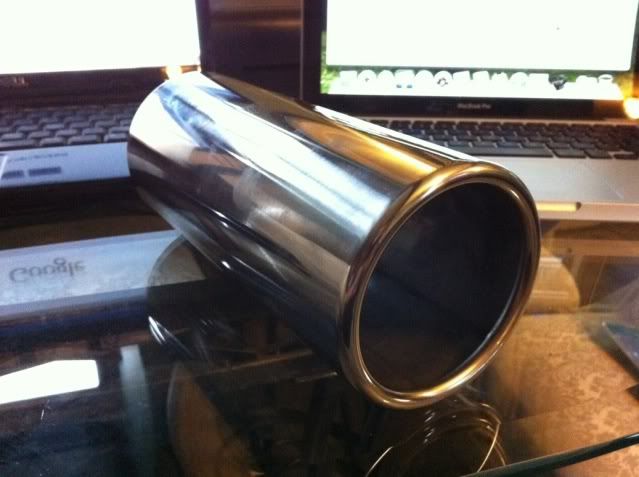

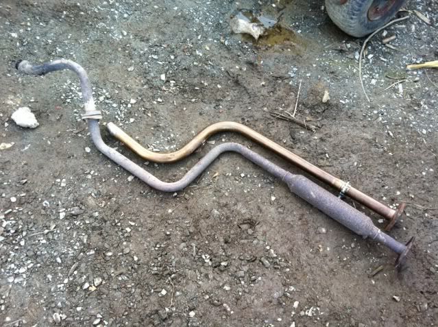

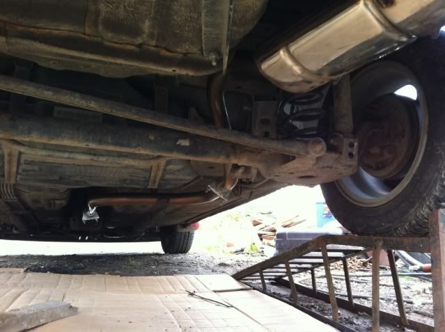

Stainless Janspeed exhaust turned up today,
New VS old:
Fitted:
Will weld on the 3.5in tip when I get some stainless mig wire.

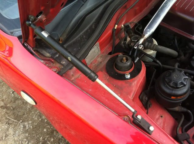

And I also bought some mitsubishi Gto bonnet lifters as they will look a bit better than the chrome ebay ones that always rust!

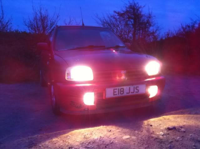

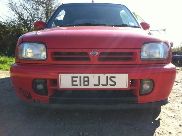

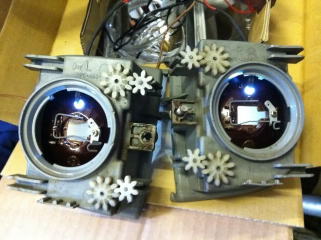

Fitted the driving lights today:

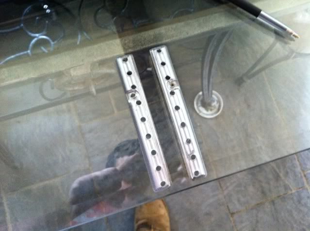

Also got some LEDs to do some indicators in the trims sometime.
led's for the homeboy phonic win
if they was bright enough could one be used in the front wing, would look mad one tiny led stikin out the wing instead of whats on mine now

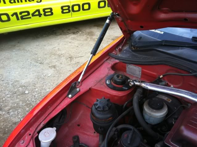

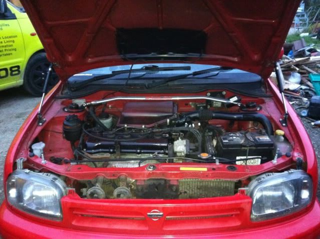

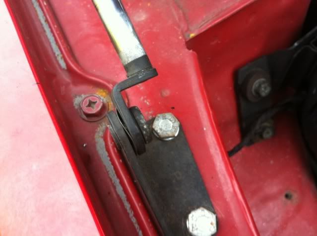

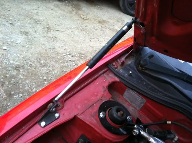

Fitted the bonnet lifters tonight:
Unfortunately the brackets brought them too far in so they fouled the bonnet:
So I made some new fixings:

stealing my ideas again :p i like the bonnet lifters, maybe you should make that into a guide? the rear lights are looking awesome!

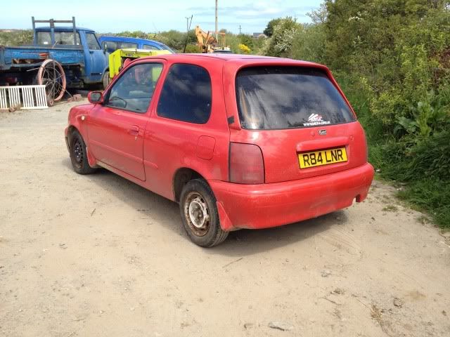

Just started work on the car again today, its been off the road since april since I bought the Audi.

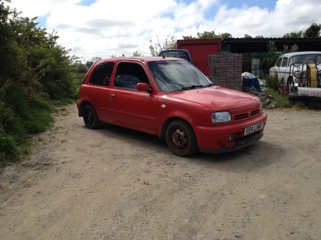

How the car stands now:

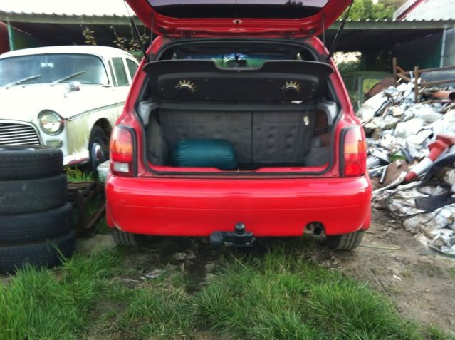

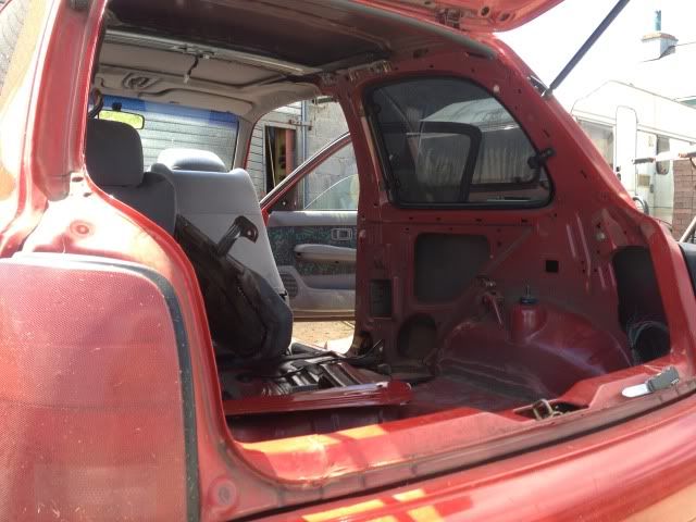

Started work stripping the rear of the car out ready to cut the back off and turn it into a BBQ in time for JAE :)

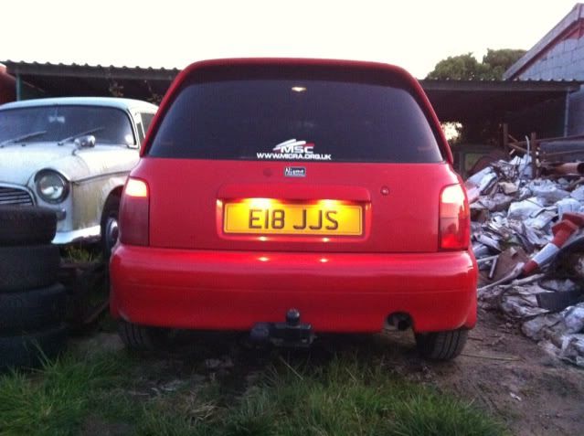

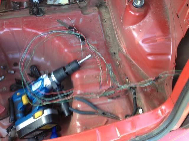

Stripped the wiring back to basics to be wired to a tow plug:
Most of the rear stripped out:

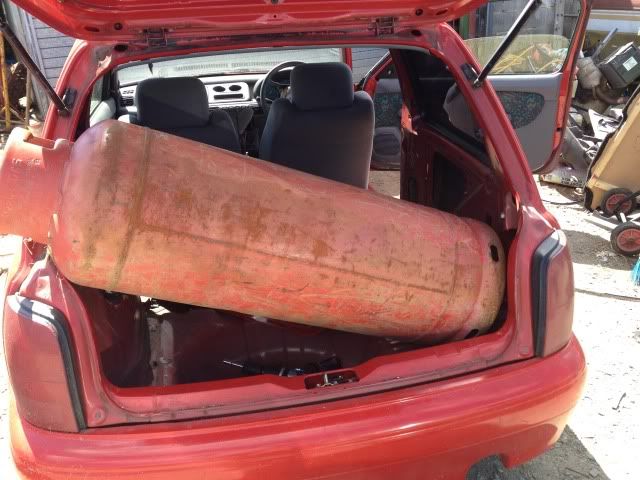

The Plan for the BBQ once the gas bottle has had the top cut off and been chopped in half:
I'm going to try and crack on and get this done in the next few weeks :)
OMG will JAE actually have a finished Micra BBQ for once?! :D
Yep, I'm planning to get the 12inch Stihl saw out tomorrow and chop it up :) and I have an old trailer that I'm going to get the tow hitch off so I have pretty much everything I need.

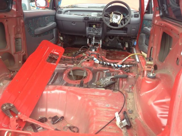

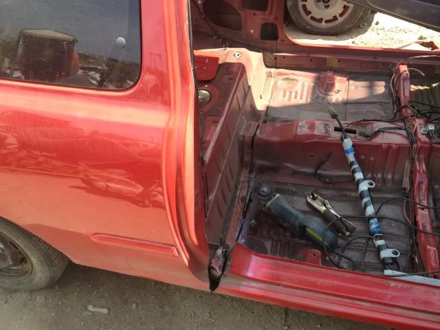

Stripped out the rest of the interior and petrol tank today:
One of my tools of choice:
Started cutting it up, but the pull cord went on the Stihl so I'll have to carry it on tomorrow.
