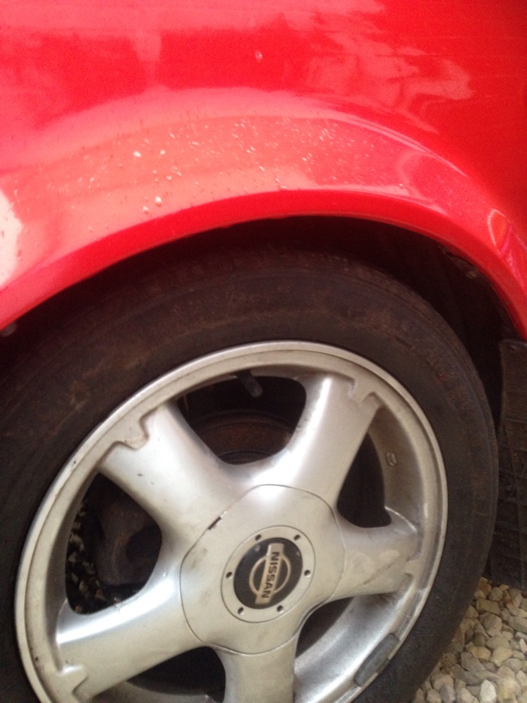

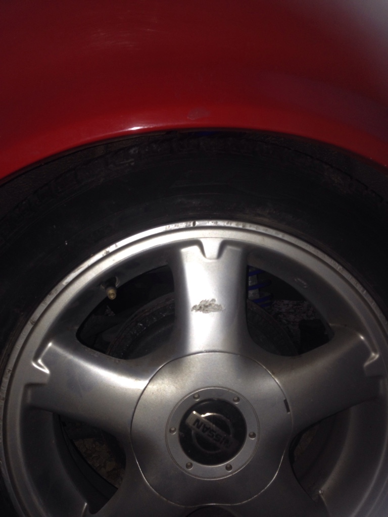

14 inch Nissan alloys ( if anybody knows what they are off please say)

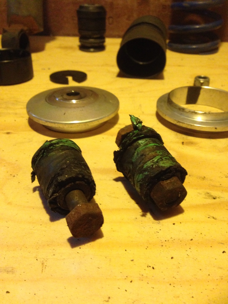

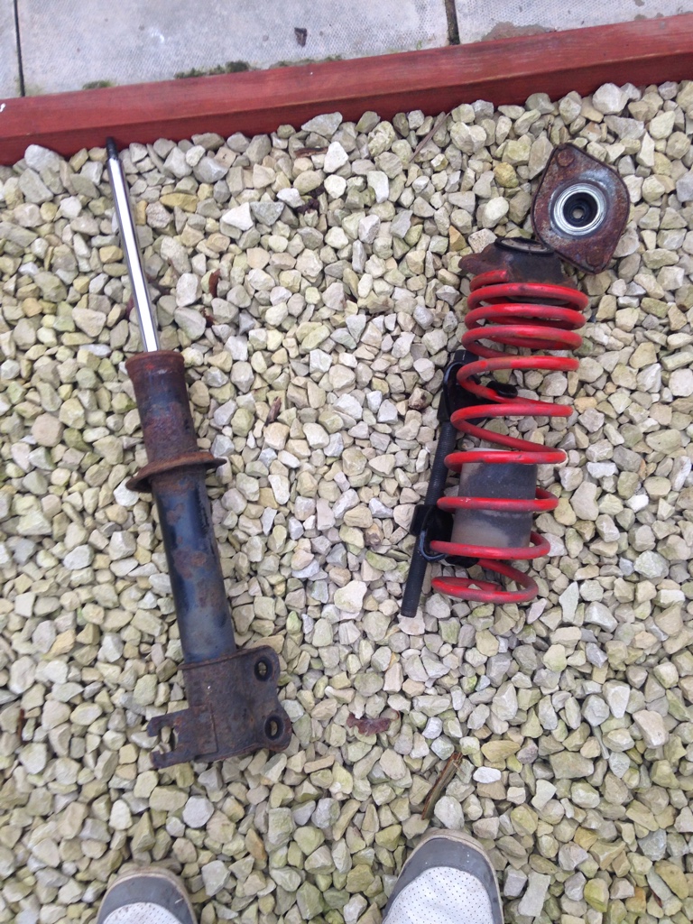

Tonight i took the coilovers apart.
Used my new birthday tool
Clarke 1000w impact wrench
Was £60
Really good at stuff like wheel nuts hub nut ect but wouldnt do coilover top nut. I guess because the shaft was spinning with it.

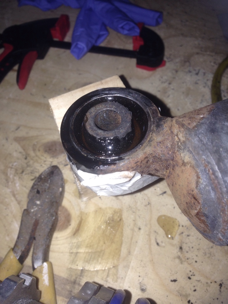

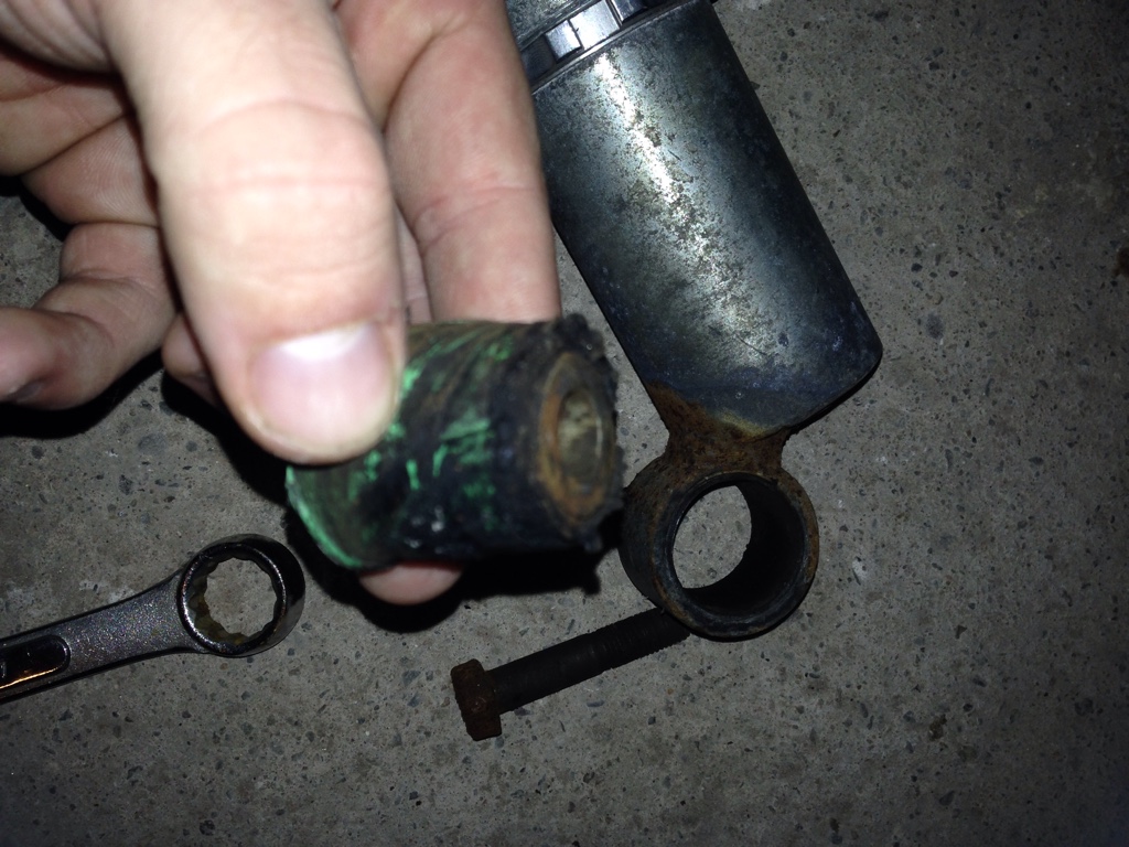

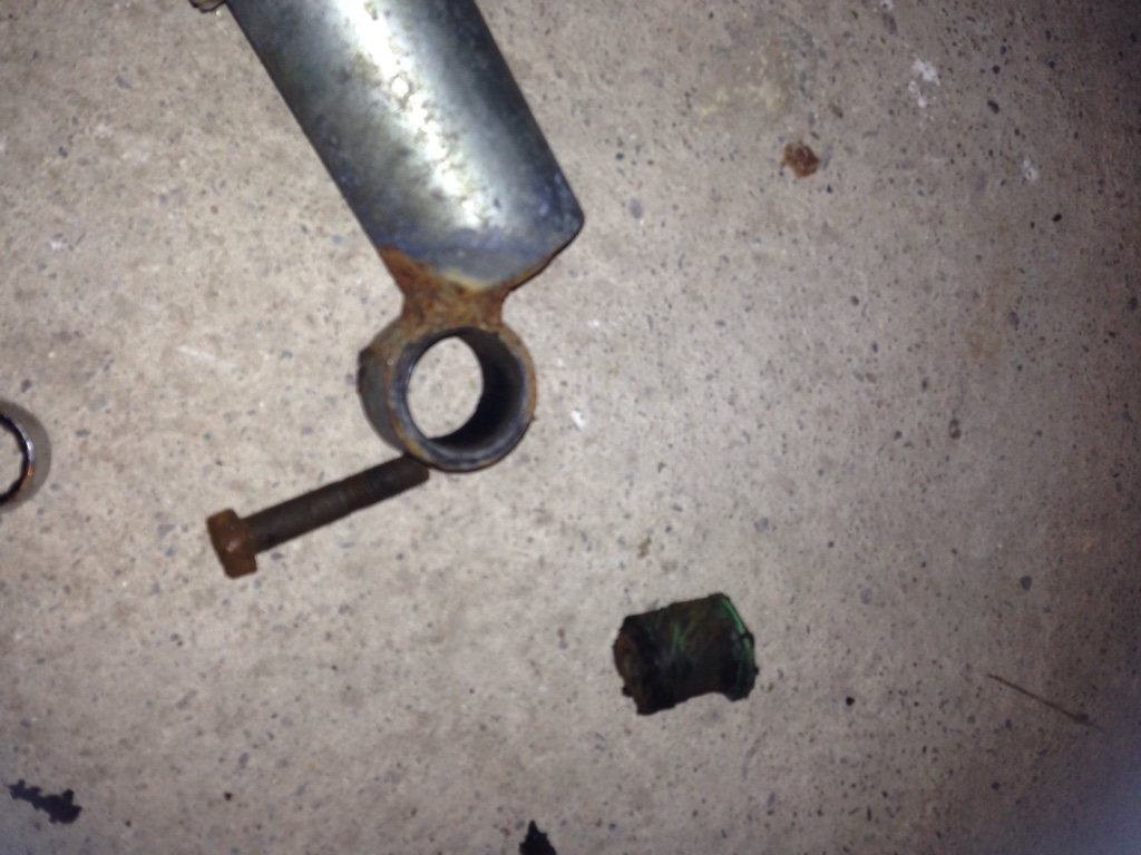

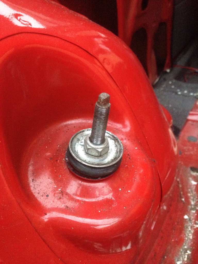

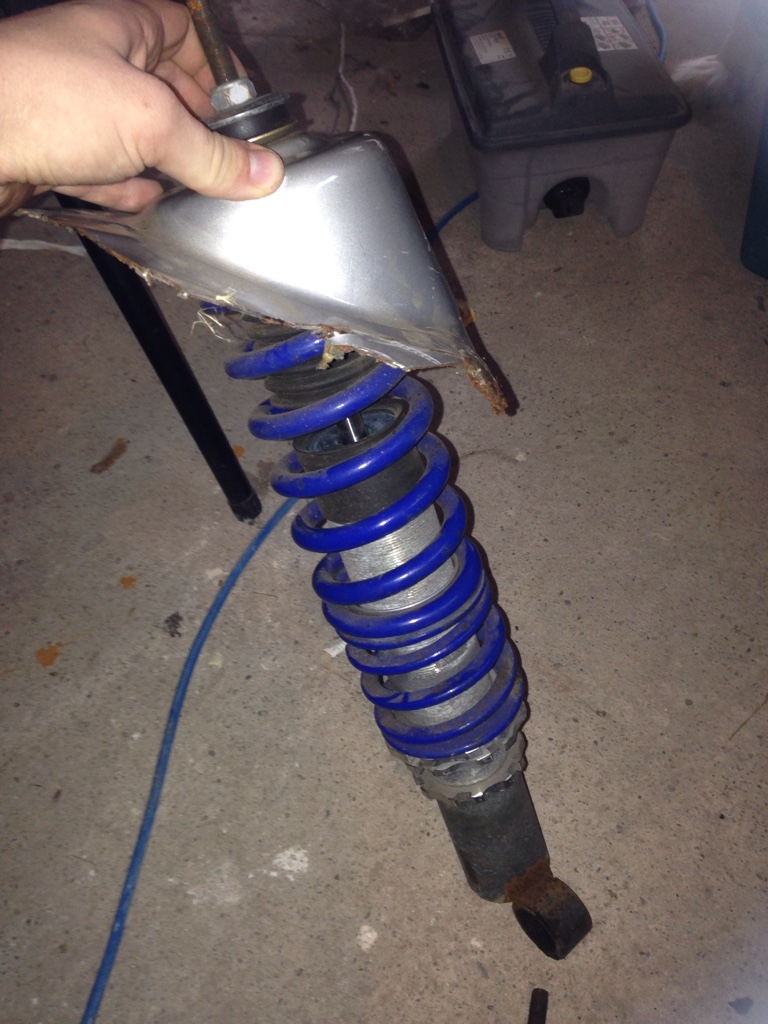

Coilover cut out from last car.
Bottom bush fell out of shock. I thought what is goin on here?
Closer inspection i found the previous owner of these had wrapped green electrical tape round the bush, which had failed miserably.

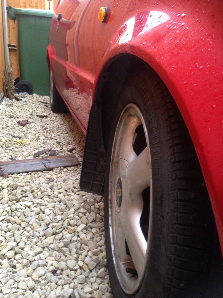

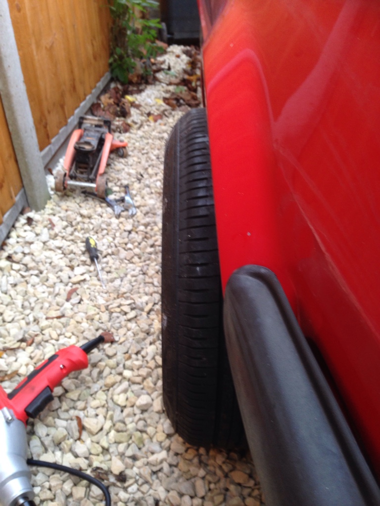

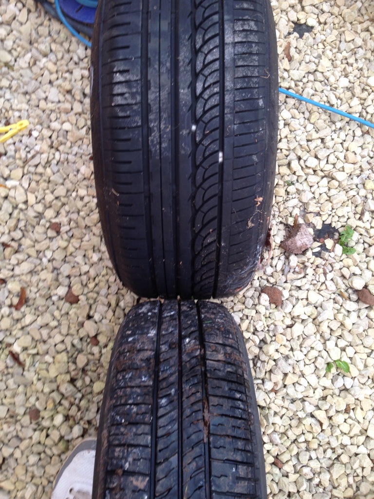

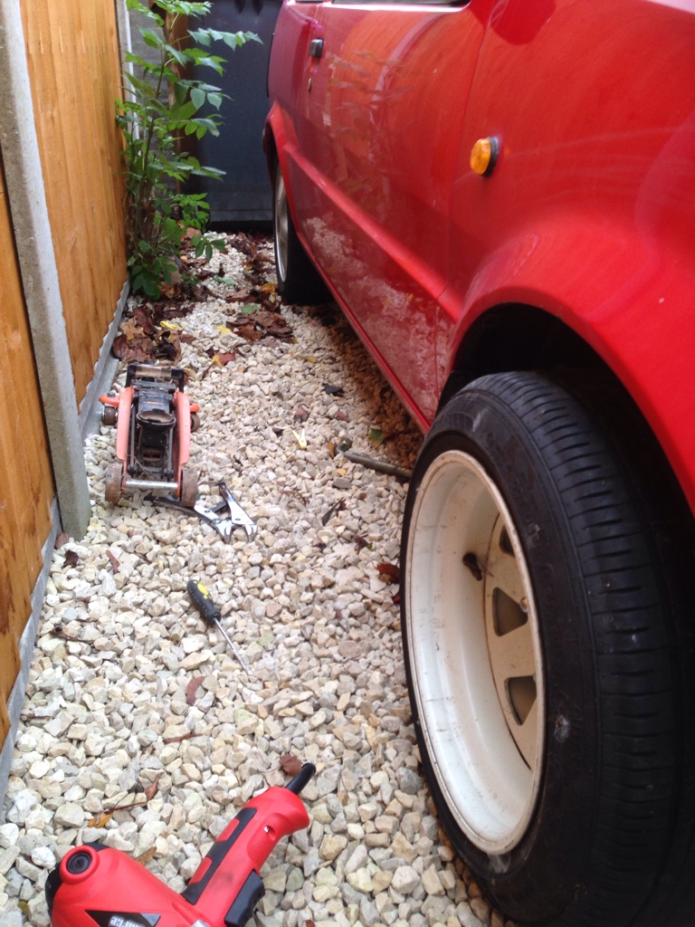

Tried the wellers on for size
They stick out a bit. So will have to get an arch roller and have a go at streching them.

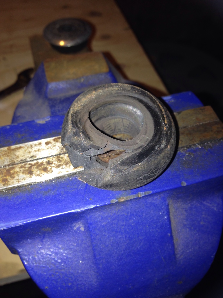

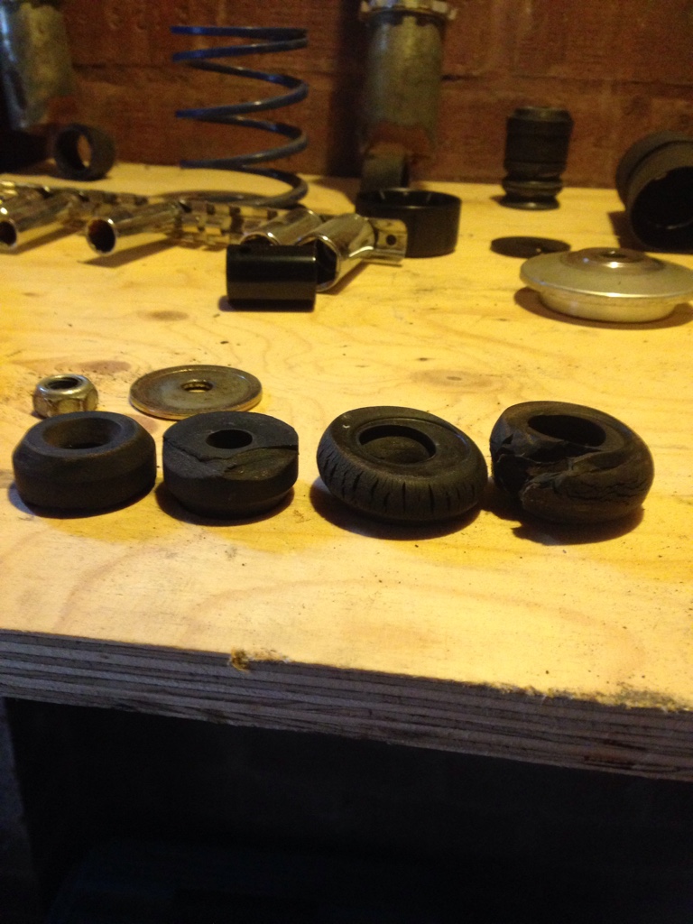

Rubbers from the coilovers had torn.
Anybody know were i can get any more of these?

Them wellers look awesome!
Yer i love them. The only thing i dont like is that they are redrilled. But one day i will get the holes welded up and resprayed.
Just looking at getting the arches rolled as much as i can because i dont want to get arch extenders if i can help it.

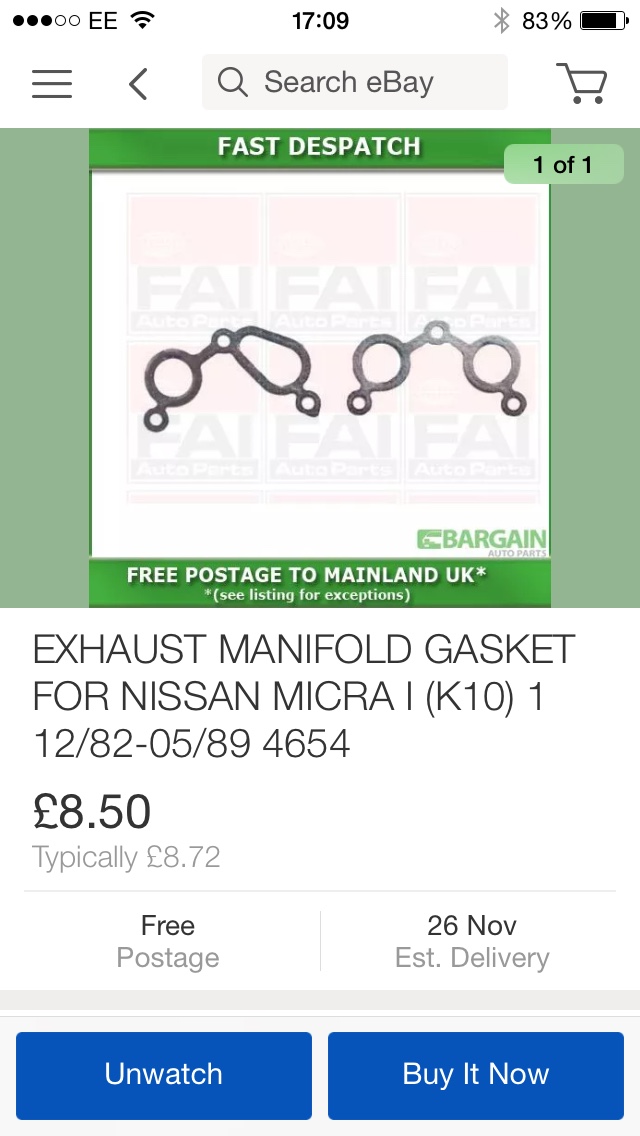

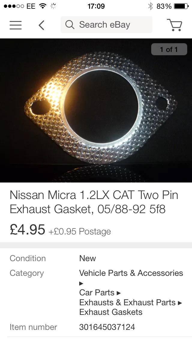

Previous owner said exhaust was leaking from underneath. Actually found it was coming from the manifold to exhaust join.
So ordered these
Couldnt remember if it was the rubber gasket or not so i ordered both

My K10's exhaust was leaking from the join between the manifold and downpipe when i first got it, turns out the bolts were loose!
Yer this one has got so much exhaust putty around it i suspect its got no gasket

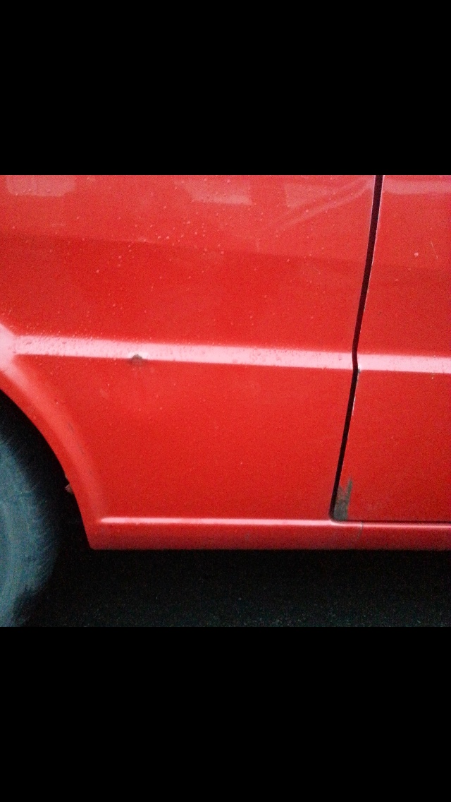

A few more pic of the car after a wash. Have to say im pretty pleased witb the bod work. Needs looking at in a couple of areas but its not bad

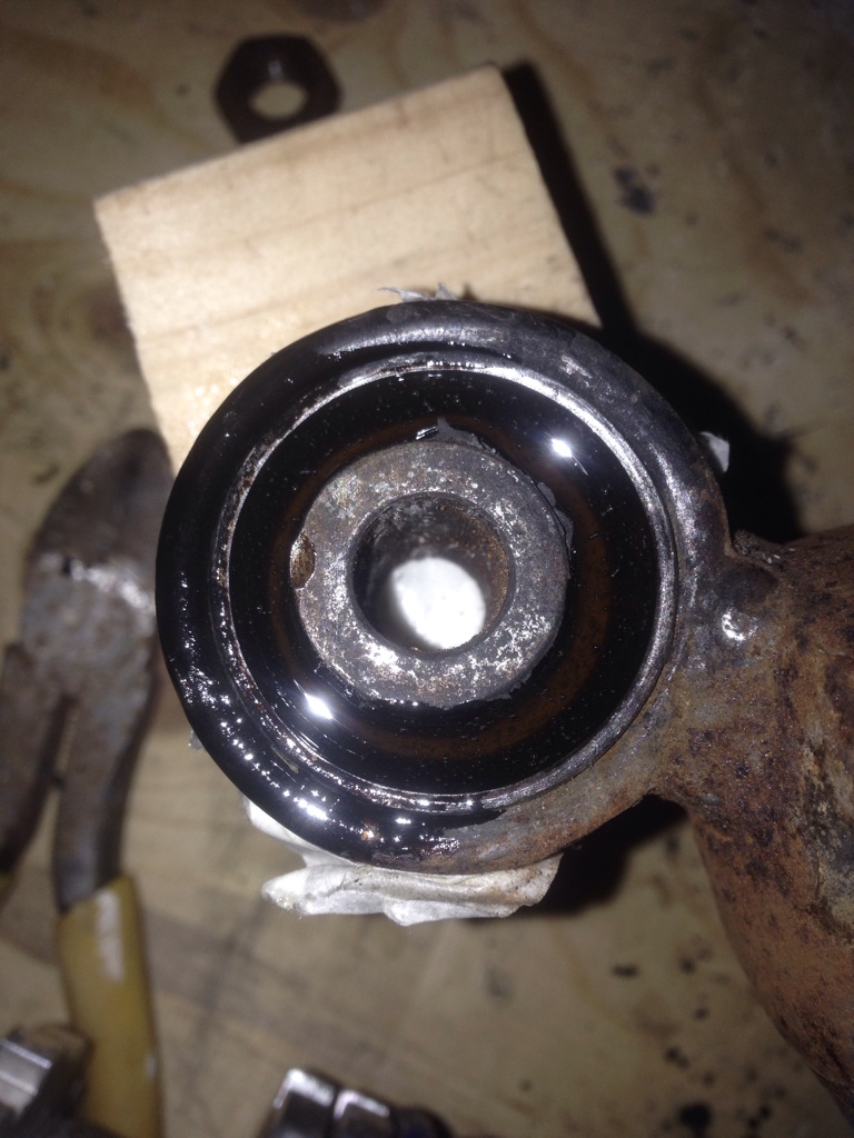

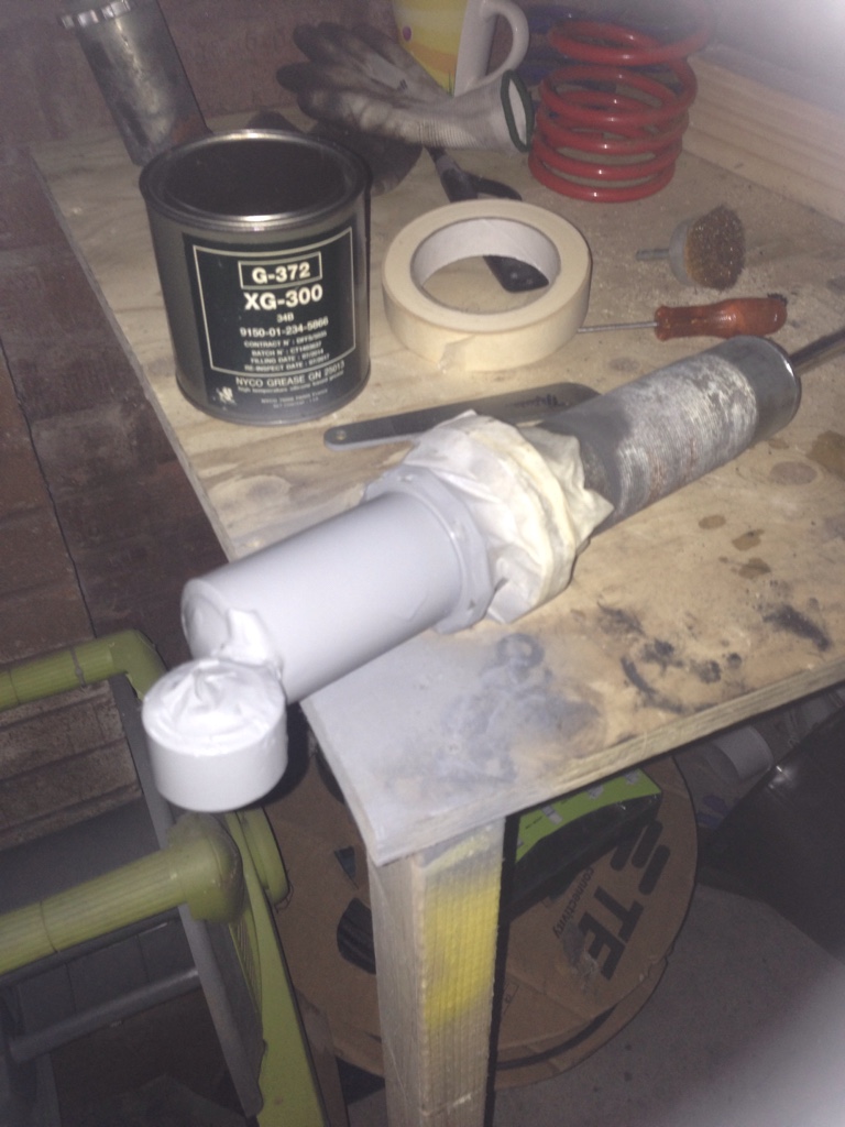

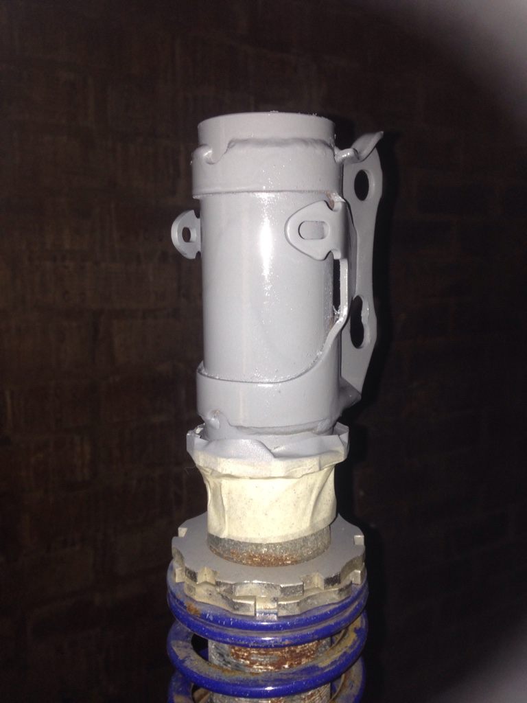

This weekend i started on the lower coilover bushes which were cover in tape.
Started with 2 part mix which is amazing. If anybody is in any doubt its about £20 and you could prob get 10 or 15 bushes made out of it. Quality stuff tough, durable just what i needed.
OP
OP
jamieccc
jamieccc

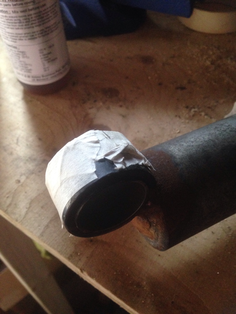

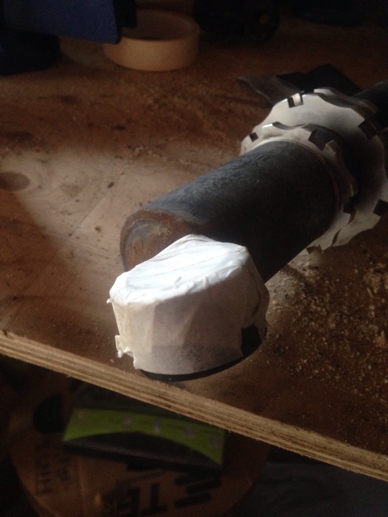

Then i taped the lower mount up
I then put the metal collar into the middle of the mount and poured the mixture around it.
The mixture went off within about 3 hours but to fully set needs 24 hours

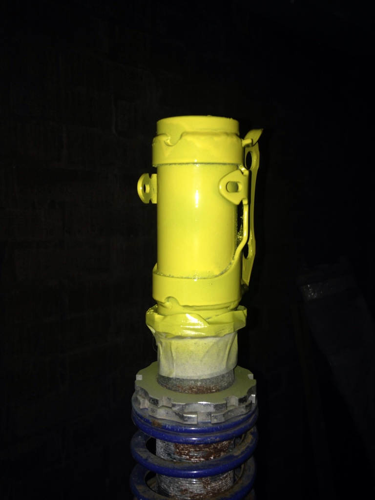

Sprayed them up with a lovely yellow
Might change the colour yet

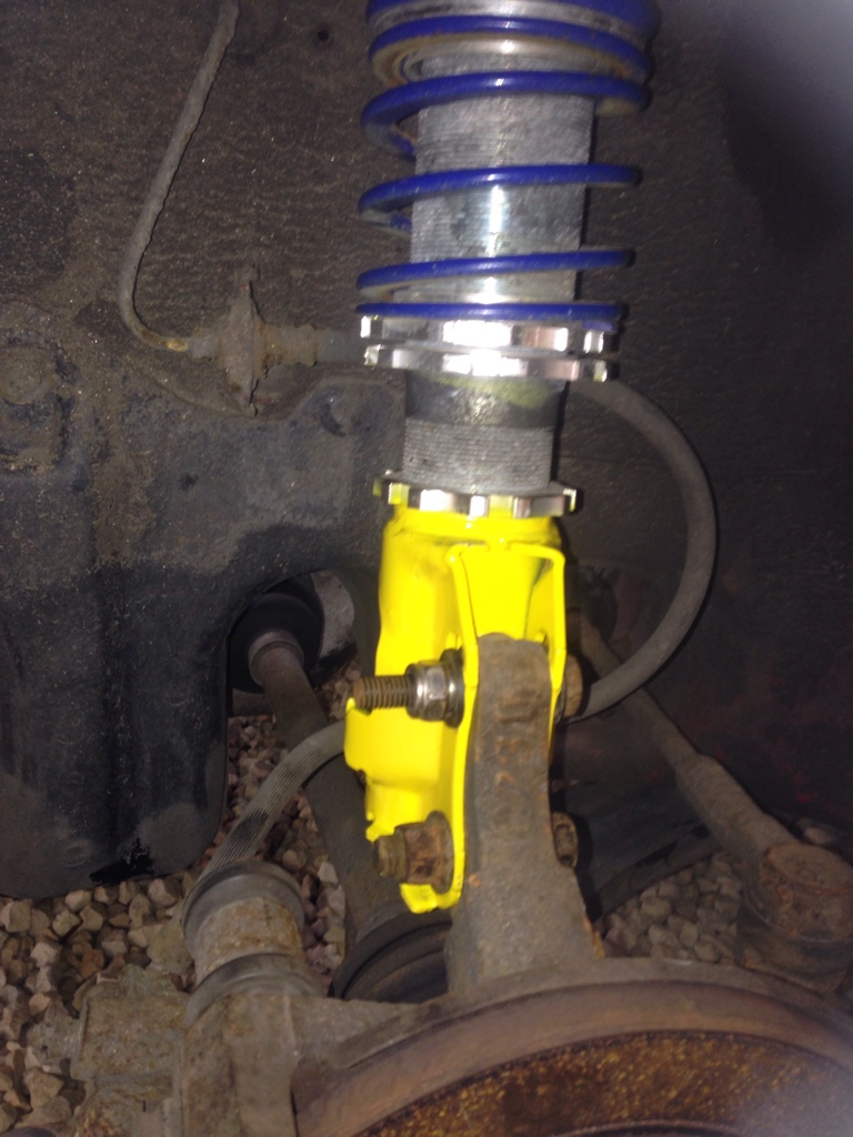

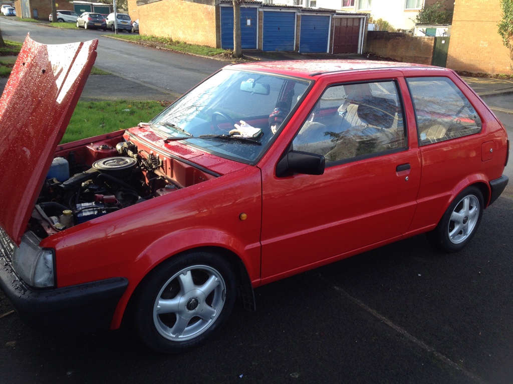

Then fitted to car
If anybody is interested they are polo 6n coilovers adpated to fit the k10.
OP
OP
jamieccc
jamieccc

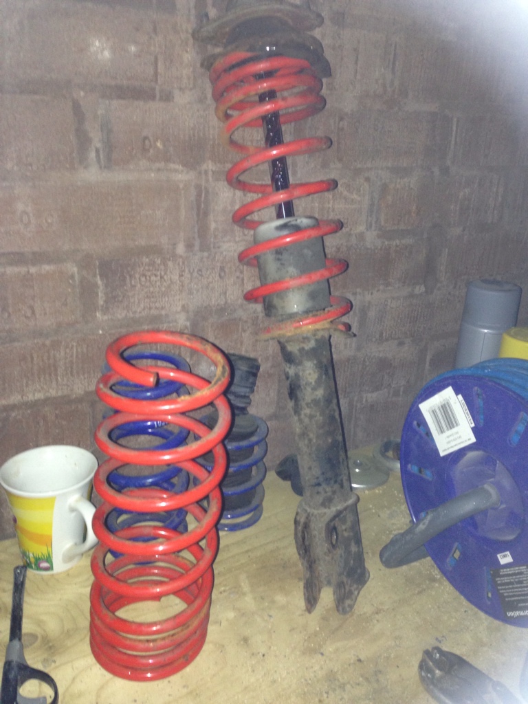

Standard shocks with 35 mm lowered springs on them. Springs in really good condition. So if any body wants some 35mm springs to buy or go swap for something give me a shout

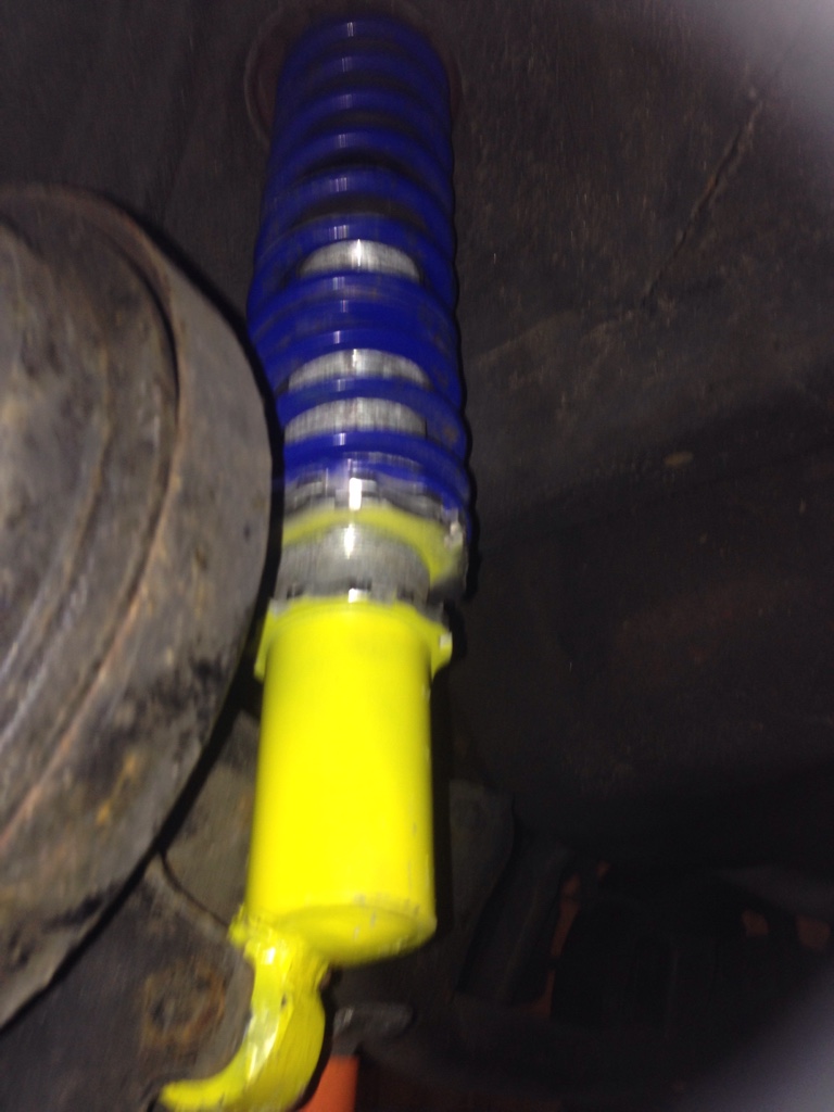

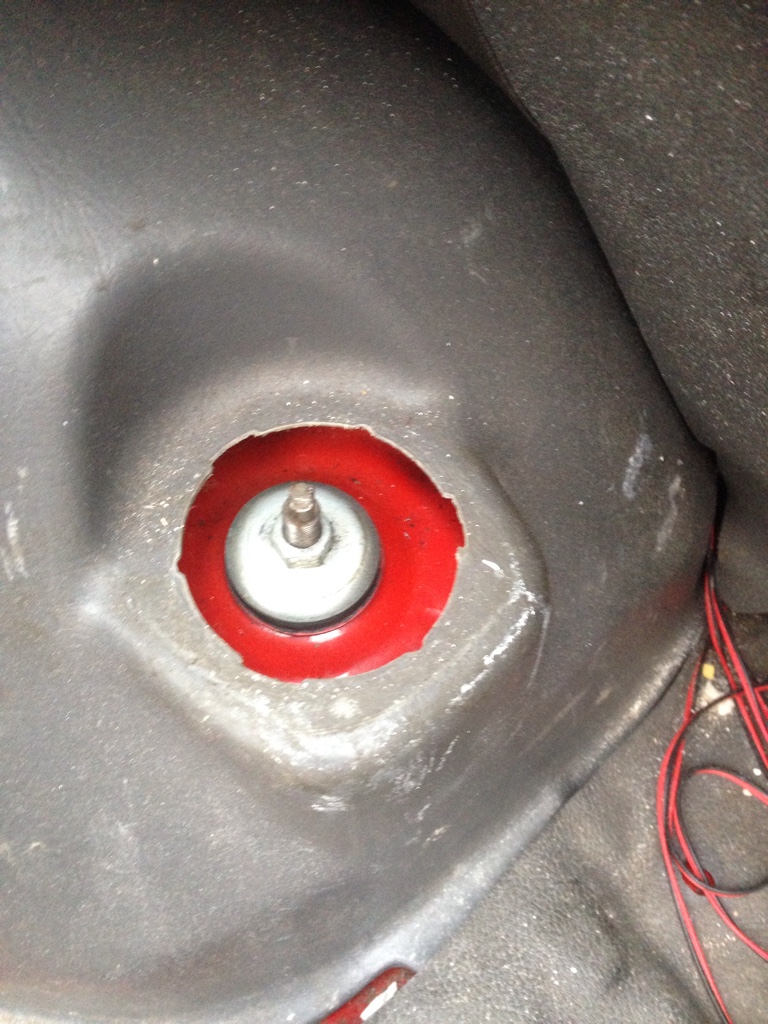

Started with the rear coilovers today.
Started by priming again then went for yellow because its all i had sitting about.
Top mount before with original monroe shocks. Does any body knownif monroe are uprated shocks?
Then after with the polo 6n coils
Original shocks with 35 mm springs
Then coils fitted
Only fitted one side but the ride height is now slammed.

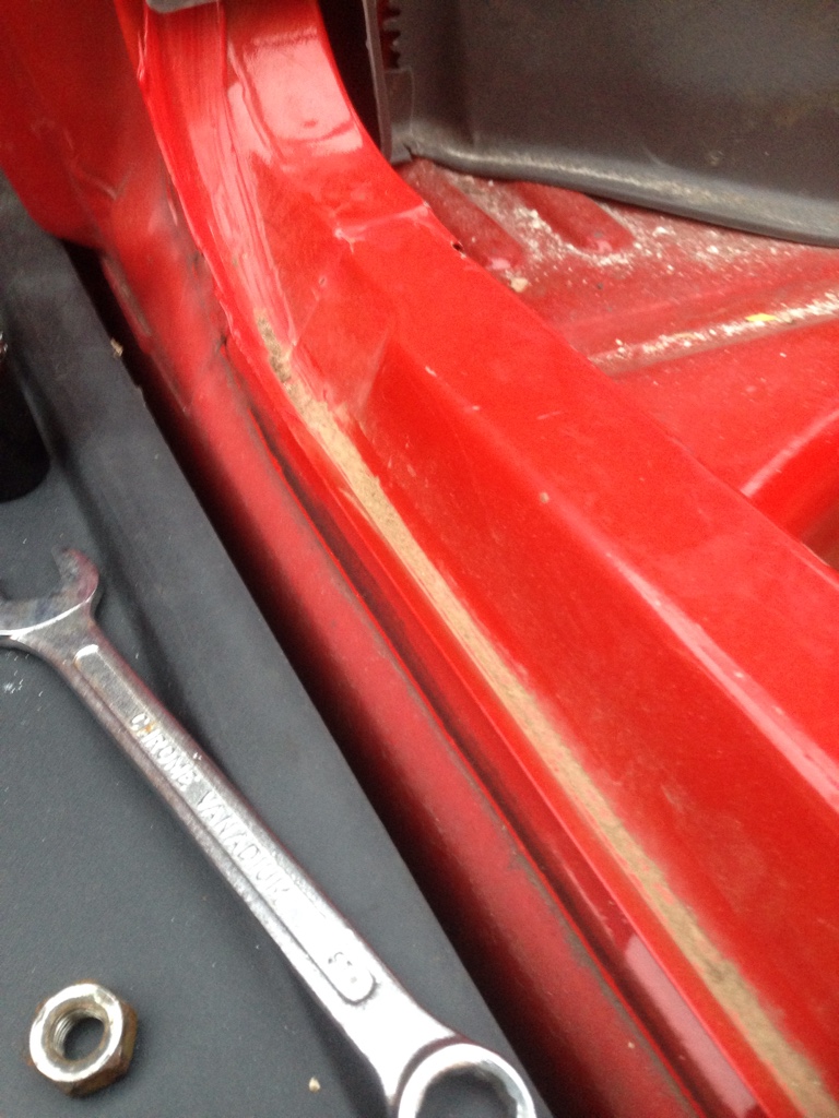

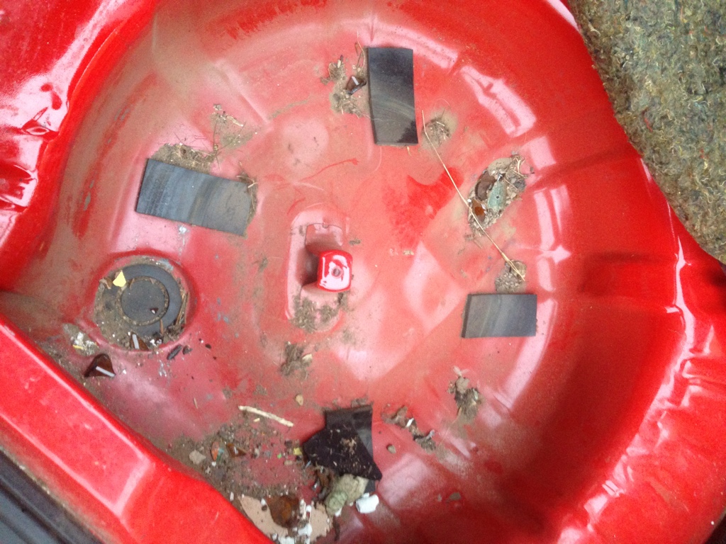

Body work is mint. Just dust here no rust
None here either

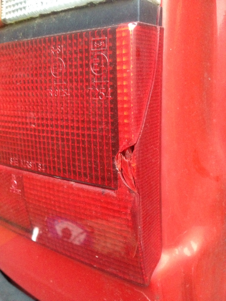

Did find this though. I might have a go at trying to repair. Seems a shame to chuck away
