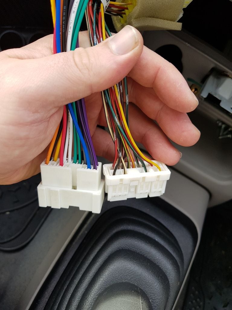

When I took the dash apart and removed the original unit the iso cables don't match the ones I picked up from Halfords PC2-76-4
I took pictures of the wires on which I need the iso for.
Any help would be appreciated.
Thank you.

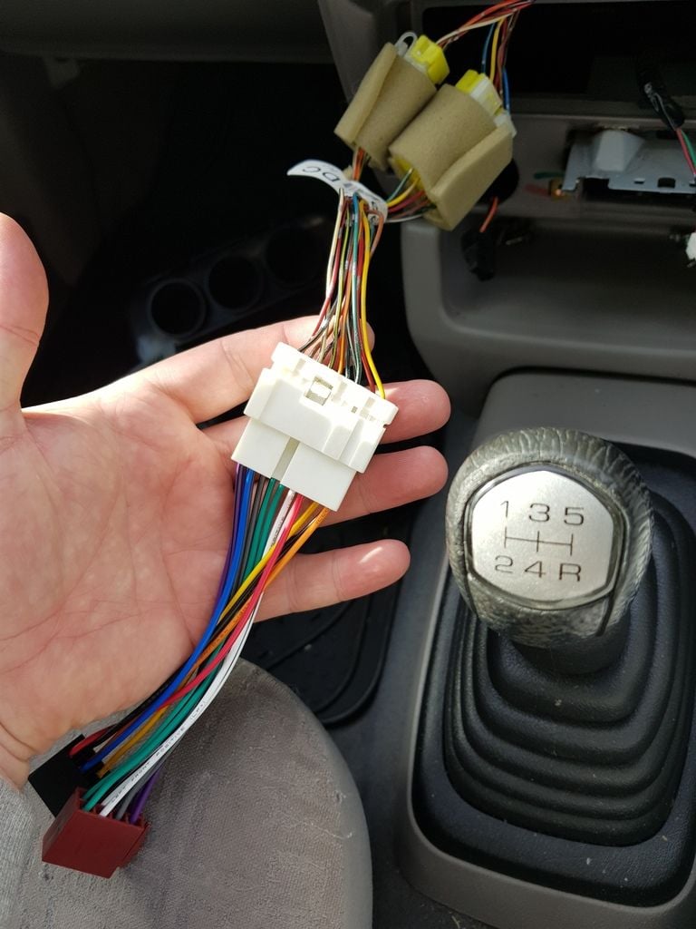

After looking around. I may have looked at it wrong. The words from the car connect to two separate box's which then connect to one rectangle box which plugs into the cd player. After looking around there is a Micra iso that is a rectangle shape. I'm thing the new iso will plug to that rather then the two.
Iv ordered one off eBay and should be here in a couple of days. I'll let you know how it goes.

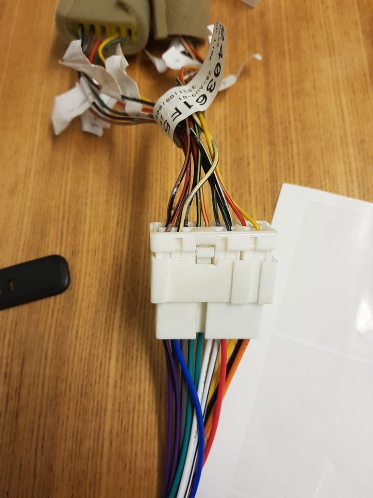

So after searching the internet I come across another type of ISO cable this time instead of removing the first ISO you simple add another to the one from the original CD player.
However if only life was that simple.
I still can't seem to get the player to work I have swapped the red and yellow wires as I know with some cats they're wired differently but still no power. After look at the new fitting the wires don't seem to match up.
Does any body have any ideas?
If anybody digest hard wiring can someone please share a link on how to do that?
Thanks again
The top left orange cable matches the top right yellow cable just to help you see what matches what.
As you can see the black and blue cable matches to nothing and the yellow with black cable on the Micra matches to nothing.

Ok so I downloaded the PDF of the Haynes manual. After looking at this diagram I have now labelled my cables so I now know which is which.
After a reconfiguration of the pins
I'm now left with a yellow and black cable from the Nissan iso over. And the black ground chassis cable and blue remote cable over on my iso. So I plugged the y/b cable in to the ground chassis that didn't work and tried the cable in the blue remote that too didn't work which now leaves stuck.
I have no idea why it won't work.
