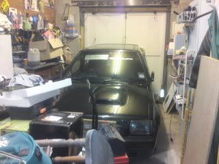

The ST is slowly getting built back together, but seeing though its going to get a bit icy / snowy / damp, i have decided to move the car into the garage permanently (much to my old dears anger) :D
