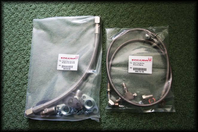

Oil line kits arrived today,extremely quick delivery!
Also some photo whoring:
i didnt expect the kits to arrive so fast! I ordered them about a week ago and the auction said 13-25 day delivery! Cant believe how big the braided hoses are!

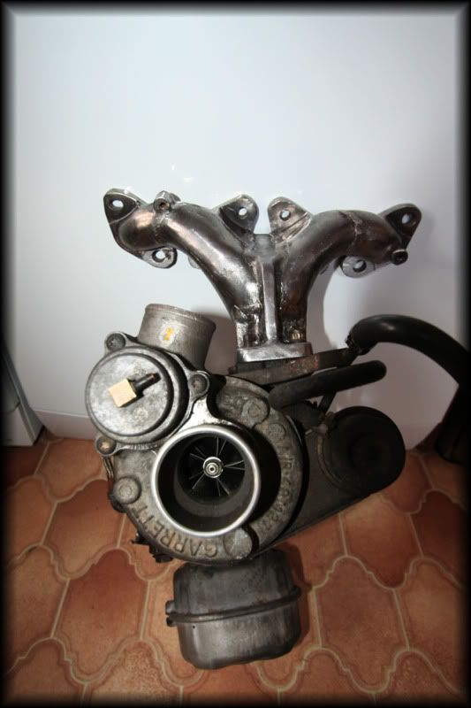

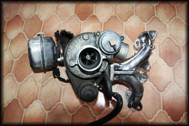

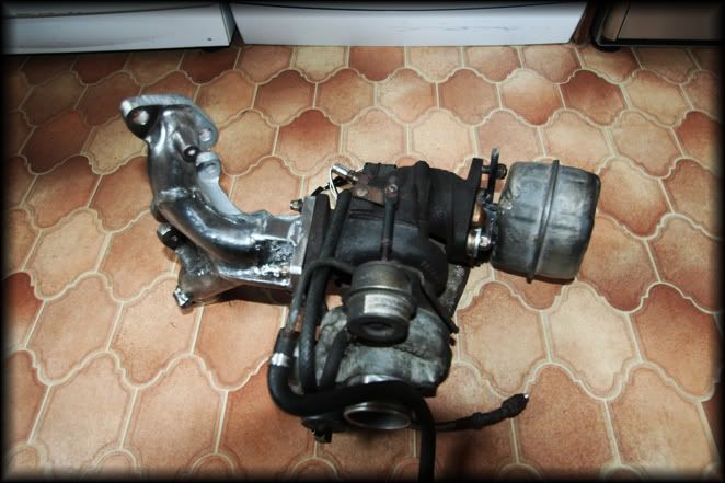

Just noticed Frank,doesnt the Turbo have to sit parallel with the engine block? In theory the turbo would need to be turned 90 degrees right?
thats how martins is mate, its the only way they will fit between the alternator and rad, and it brings the exhaust outlet in the same place as before (for a conventional downpipe)
yeah mines the same hooded :) its actually alot better poistioned as nothing needs to be moved at all
downpipe is straight down and makes for a much neater fit
if you want something like youve seen you got to go down stanis route of moving everything to fit
leaves more room this way though mate :)
and frank.... top notch work yet again me old mate!!!:laugh:

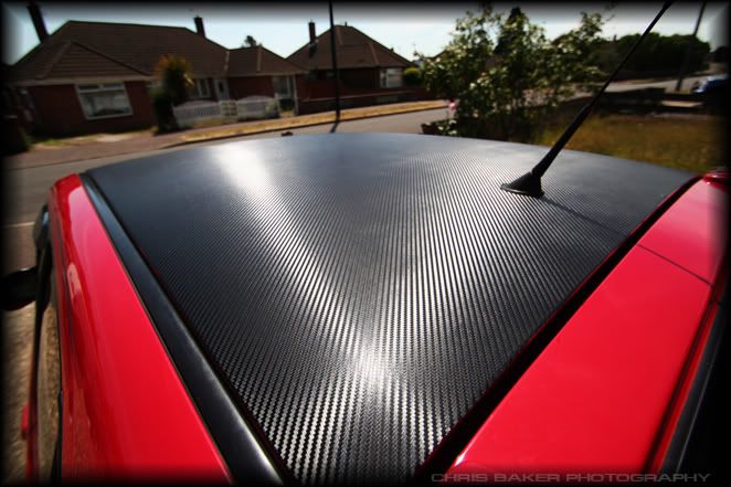

Went over to a mate's house today to have my roof wrapped,came out pretty well :)

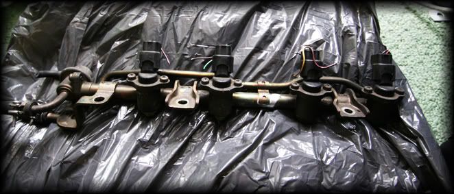

Almera 1.6 Injectors & Fuel Rail

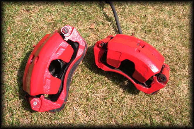

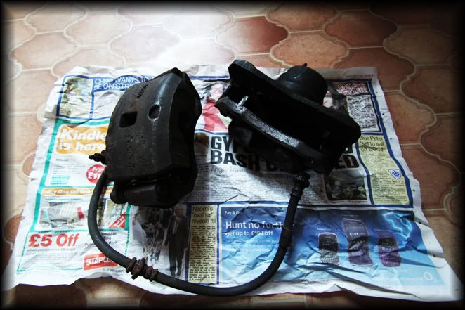

Pulsar GTiR Calipers (currently being painted!)

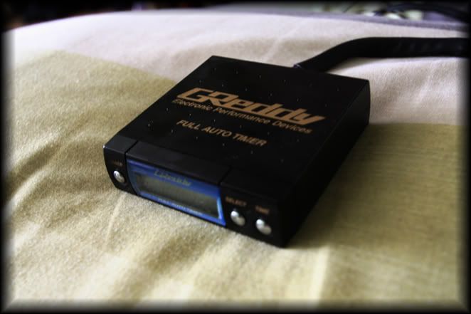

GREDDY Turbo Timer

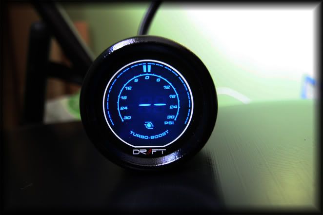

Boost Gauge

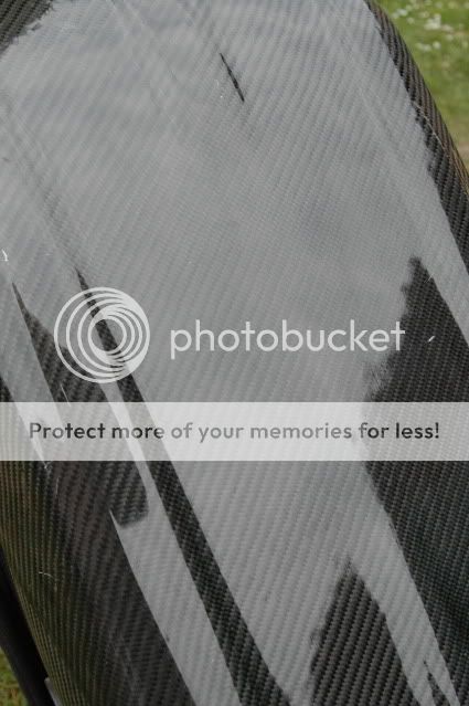

Hey, Chris, as much as I love your roof I have to say that I'm a bit sad :)
I ordered a vinyl black matt sheet to cover the roof of my car and you have already done yours... ha-ha...
At least the color will be different :p
dude you know what will be awesome....
setting up the turbo times to keep the engine running for 30secs after the key is out its cool!!!!
also helps the turbo alot due to it allows and ensures the turbo has finished spooling and lets everything settle while ensureing any built up boost has gone.... i must admit i annoyed one at work by hitting the throttle when i got out the car
I bought a roll of carbon vinyl (big enough to the do the roof) from a vinyl stand at Mod Nats and it cost me £20.00 (my mate didnt charge me to fit it...so thats a result!)
Calipers are all painted now...

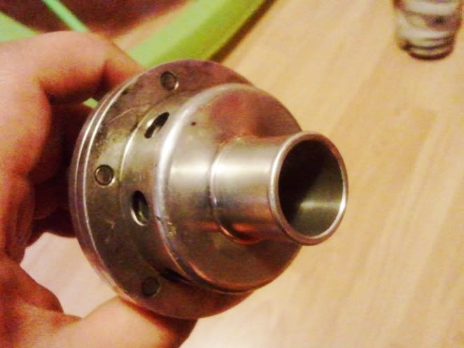

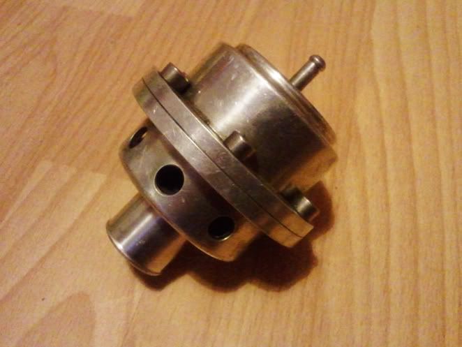

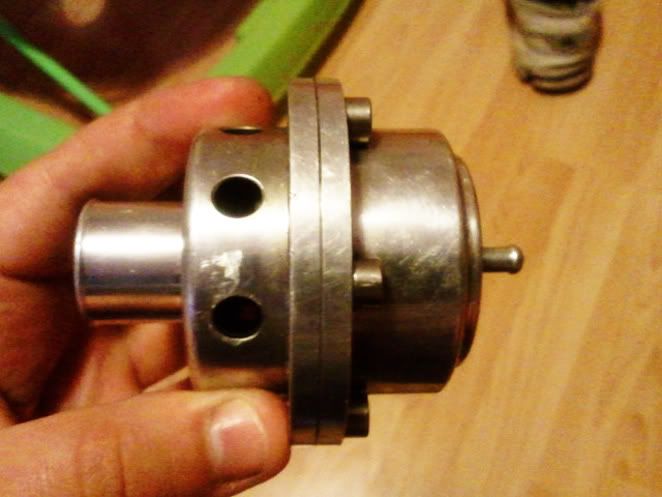

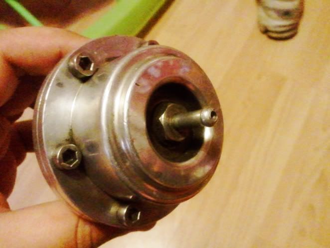

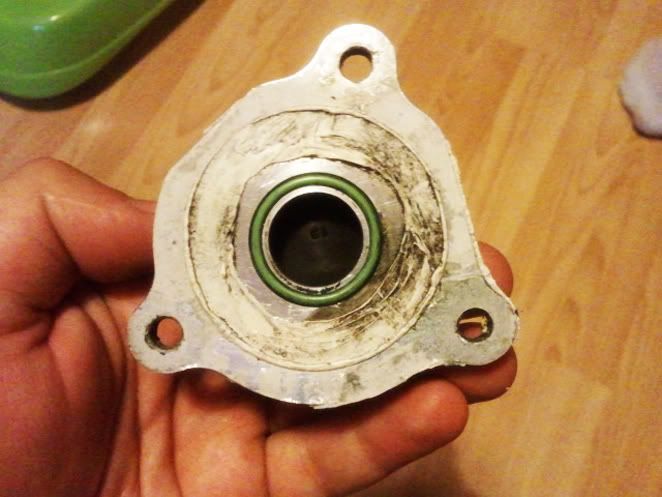

Looking for a dump valve,and the friend who sold me the T25 Turbo,has got these. Which one will be best?
In-line with pipe work:
Bolts onto Turbo?

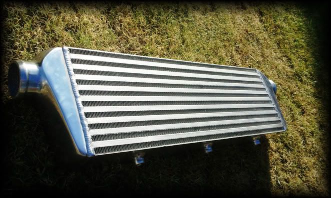

Bit the bullet today and bought my front mount intercooler...
Next month should see me getting the intercooler pipe work and walbro fuel pump. I've got TAX due end of the month so thats £130 for that alone. Plus i owe some money. Fingers crossed it'll be August time when it gets all fitted and mapped. Estimated time of completion is 3rd-4th week of August in time for JAE :)
